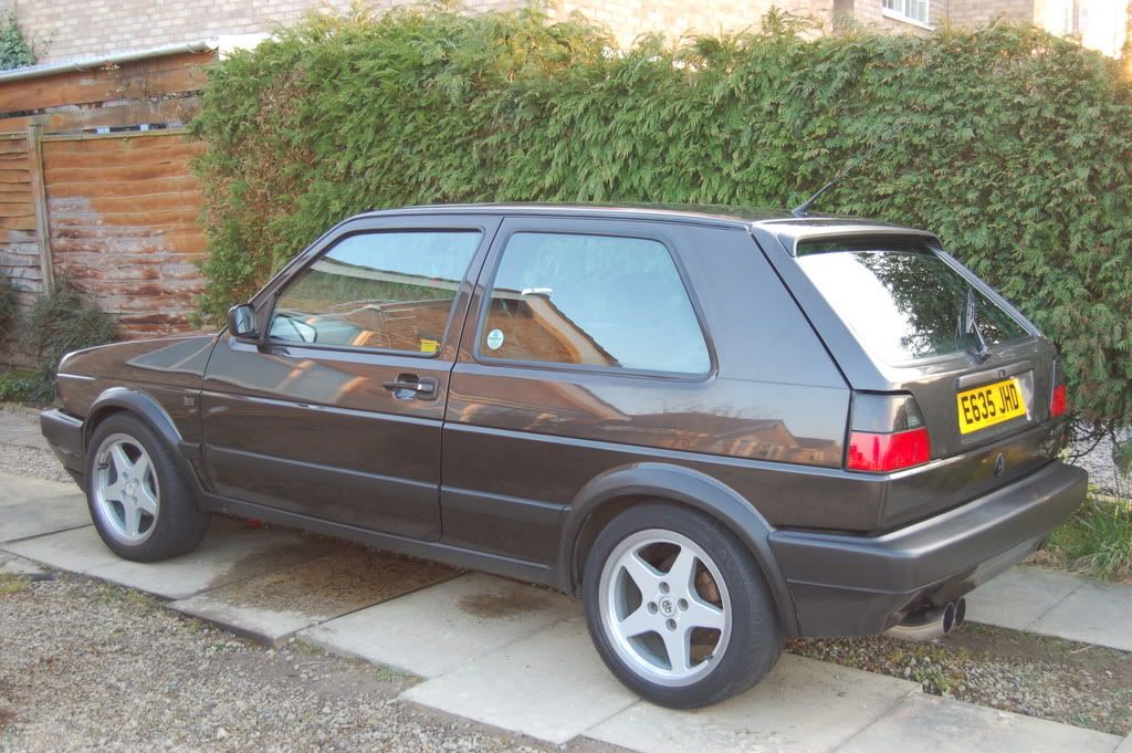

sweep wrote:Does anybody have a set of mims that look like d6dph has on his car in the picture? 16inch ones?im after some,a frend of mine had some on his lowered chromie years ago and it looked ace!
You mean these ones? :)
sweep
Posts: 10112
Tue May 26, 2009 10:45 pm
No mate the spokes come to a point where they meet the outer rim.and dish in slightly to the centre cap..

Apologies for the OT but Beemerlad, thoses 5 spoke Mims are very nice. I want a set, are they rare?

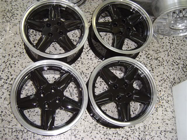

put them in the bin and get some real rims winkeye
or the only real five spoke rims for an E30...
seriously, did they try rotating the tyres on the rim to match high and low spots??
the BBS copies then came on my sport were super wobbly, tried to balance it out with weights but no use, then i found one place that used a laser sighted balancing machine, they checked the rim and the tyres on each wheel, then rotated the tyre on the rim to find the best possible place.... and hey presto no more wobbles!! this ofcourse does not work if the rims are bent left ot right, but just to give you an idea my rims had a run off of about 0.7cm, but after rotation they run fine as speeds upto 140kph.

clarko74 wrote:Apologies for the OT but Beemerlad, thoses 5 spoke Mims are very nice. I want a set, are they rare?
Not seen many about, only problem is one of mine is bent so I need to get it repaired. They were on the wife's golf when I bought it "wheels just need a balance" said the seller :roll:

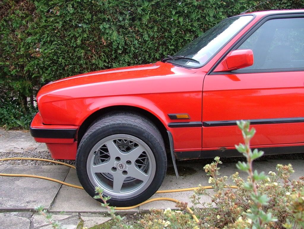

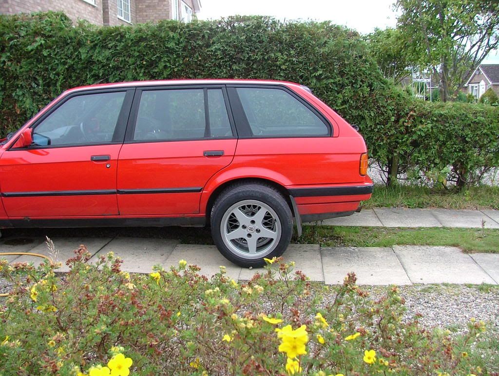

Dave,
I had 2 sets of these at the same time, I made the best set of the 2 and flogged the others for a fair whack from memory. he was going to put them on an Alfa with wobble bolts. (4x108) The ones I got off Simon did have flat spots, but they balanced fine and are on the golf now.
Look better, but my tyres are a bit on the small size!
