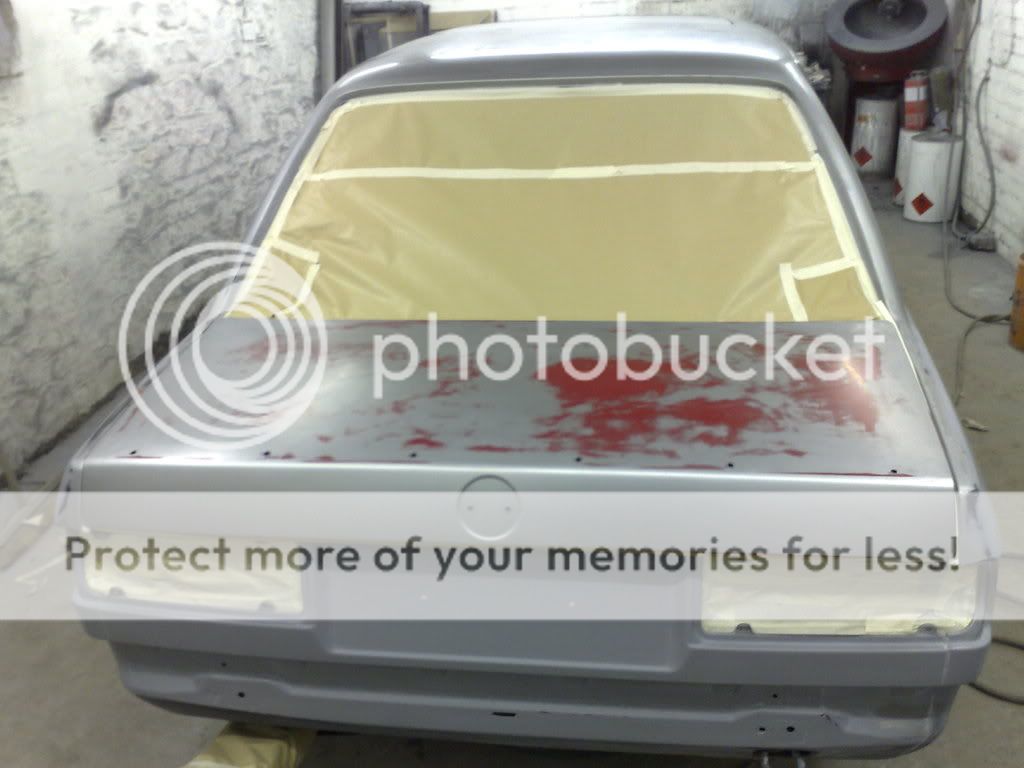

Whats that red stuff around the paintwork??
Im currently doing my own restoration and Im wondering if theres anything that can provoke the rust from reappearing apart from hammerite???

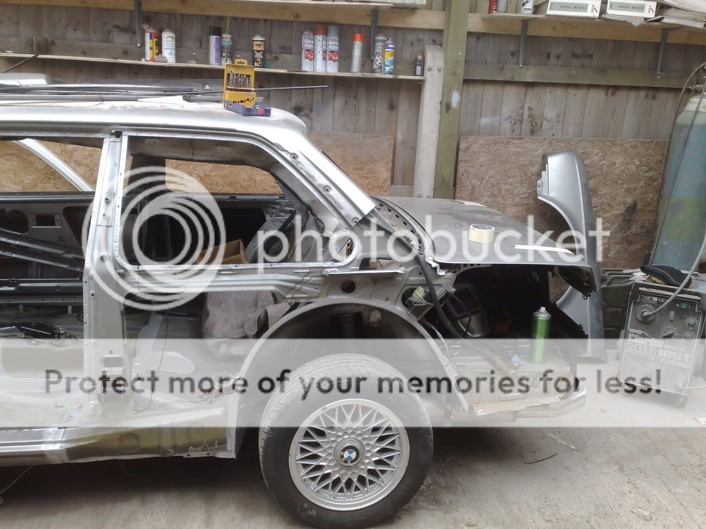

the red stuff is red oxide paint just to stop the air oxidising any bare metal .
But i will also seam sealing all the joins and plenty of wax oil .
But firstly a weld through primer was applied

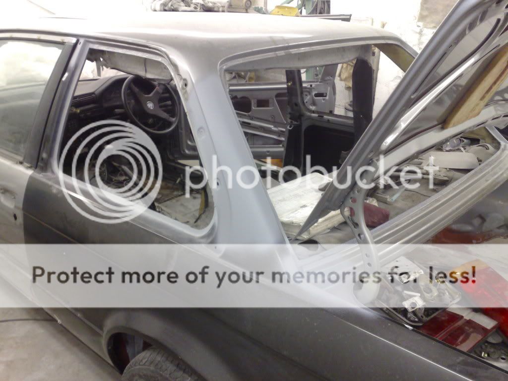

Finaly got my internet working so i can now update you.
Got the rear panel off new one on n/s/r quarter off n/s/r inner arch off and new one on . Sorted the front inner arch out so the car is looking like a car again
Just sorting the gaps and then a bit of welding and braising and hopefully it might have a coat of paint by xmass.

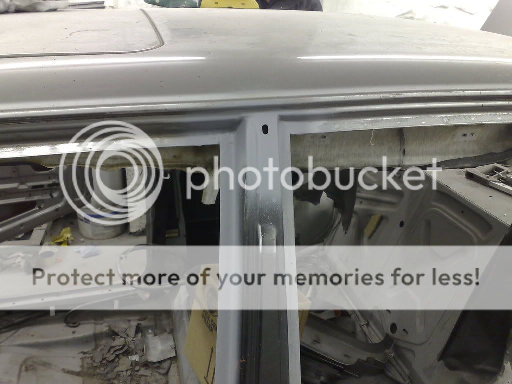

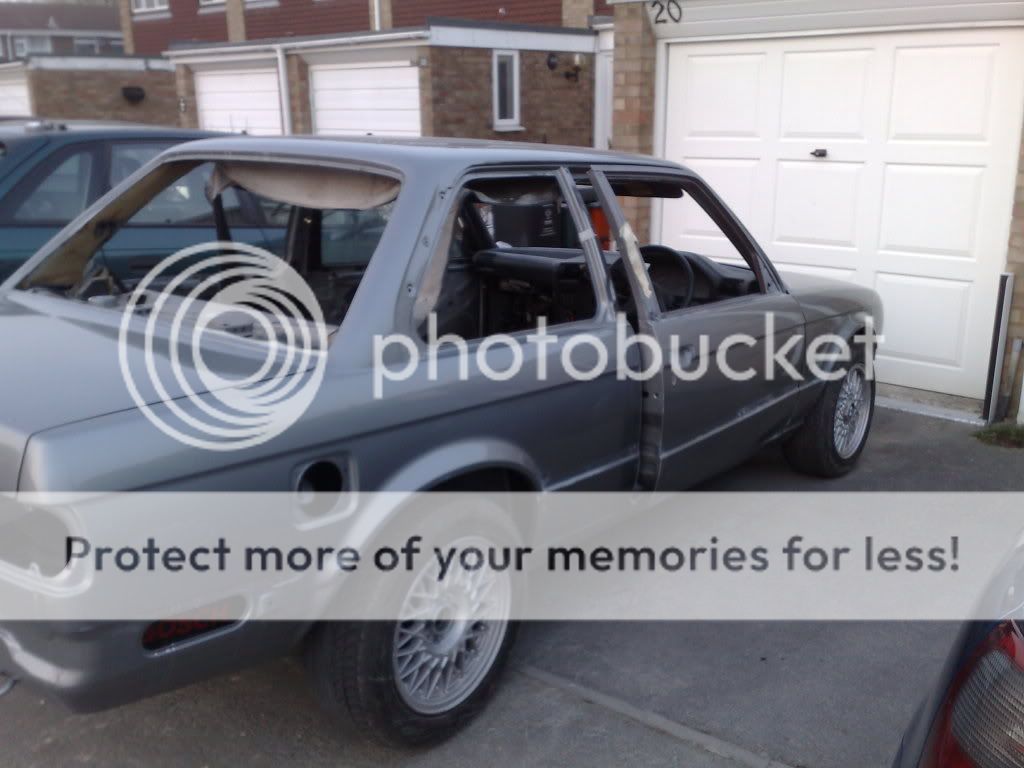

just a quick up date all the panels are on and inside the boot has been painted no pics of that but hear are some of just random stuff not far off now tho
now just got a hole lot of sanding and prep work will take more photos as we move on cheers for readind . Oh yea love the new zone!!!!!!!!

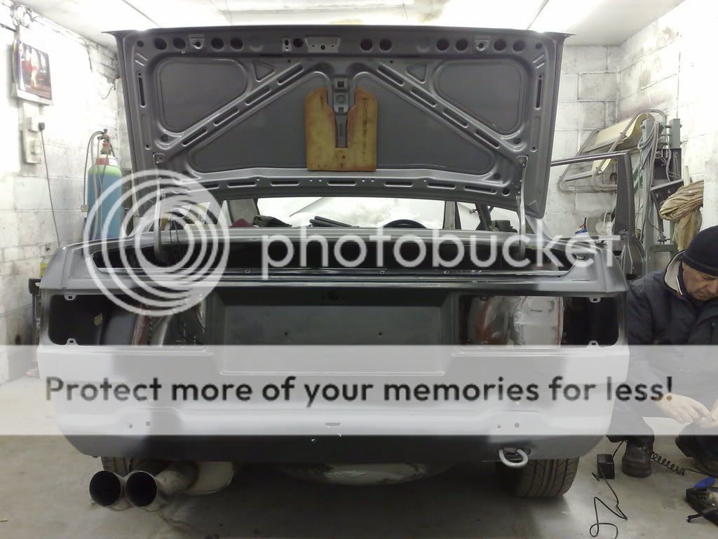

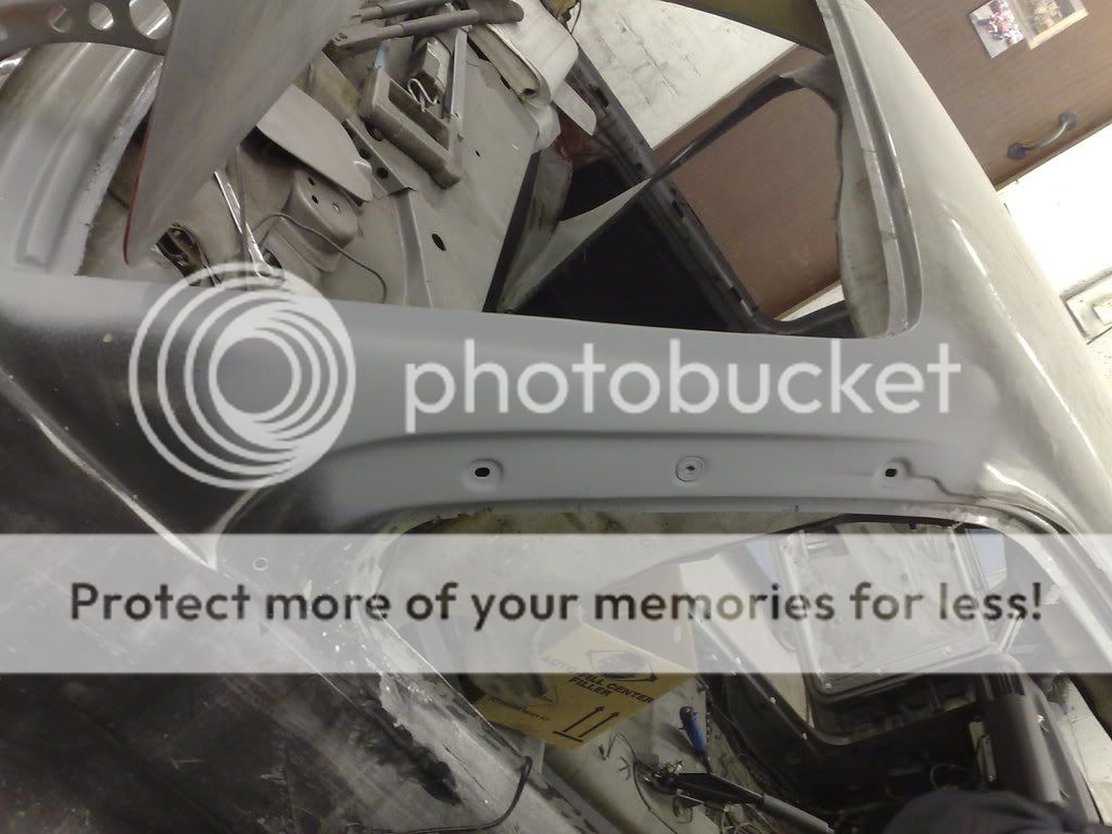

Just looking at the work there and cant make out how he welded the new back panel on by the lamp eatch side. im assuming he welded it as opposed to braized as it would of been originally? Im guessing he welded the 2 tappering edges where they meet on the inside of the boot? This was the way im gonna tackle mine when i get round to it. Excellent work btw!

All the back panel is braised where it was originally braised and migged where the old spot welds were
I have tried to keep all work original just like the colour lachs silber
Thanks again for all the comments any questions might as well ask me now while its all fresh in my head

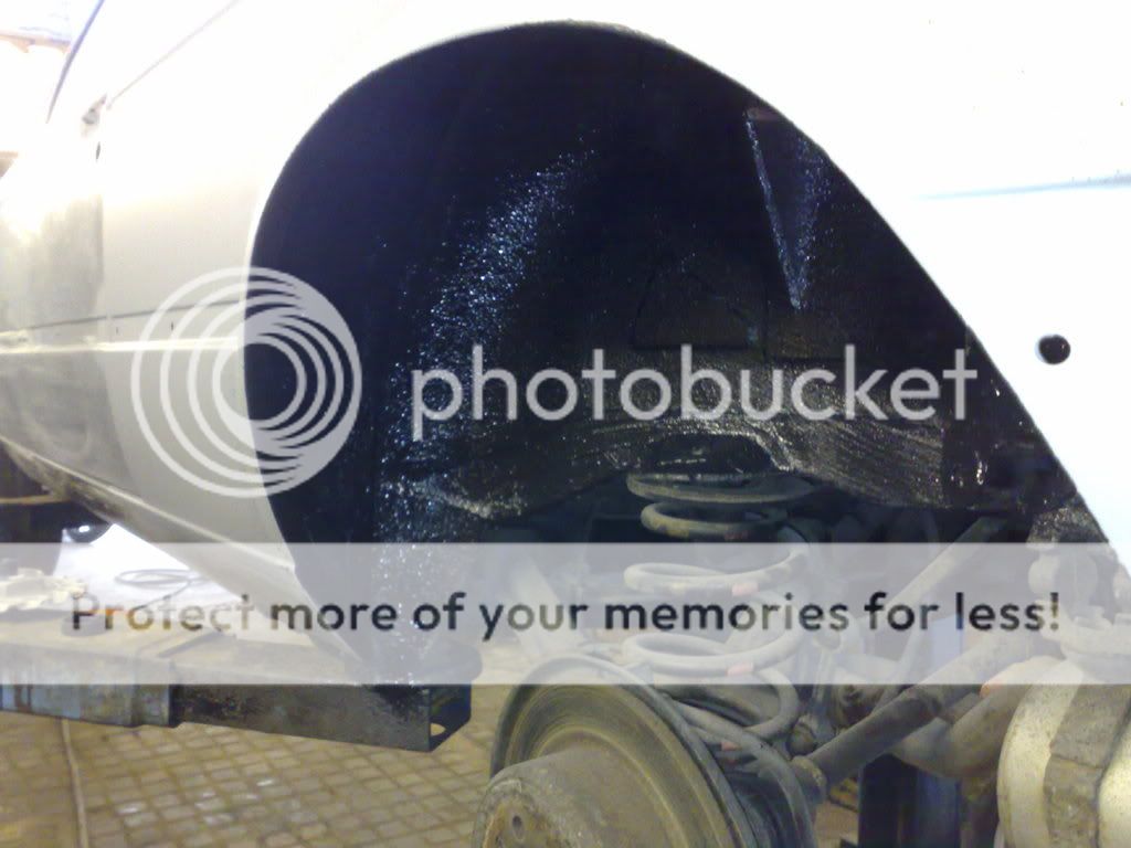

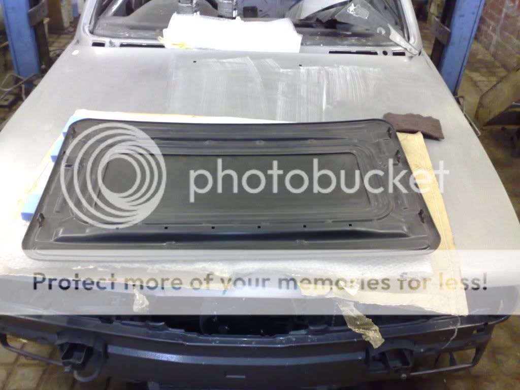

a few pics first of a brand new sunroof £117 from bmw and a couple of the arches under sealed and in side the boot

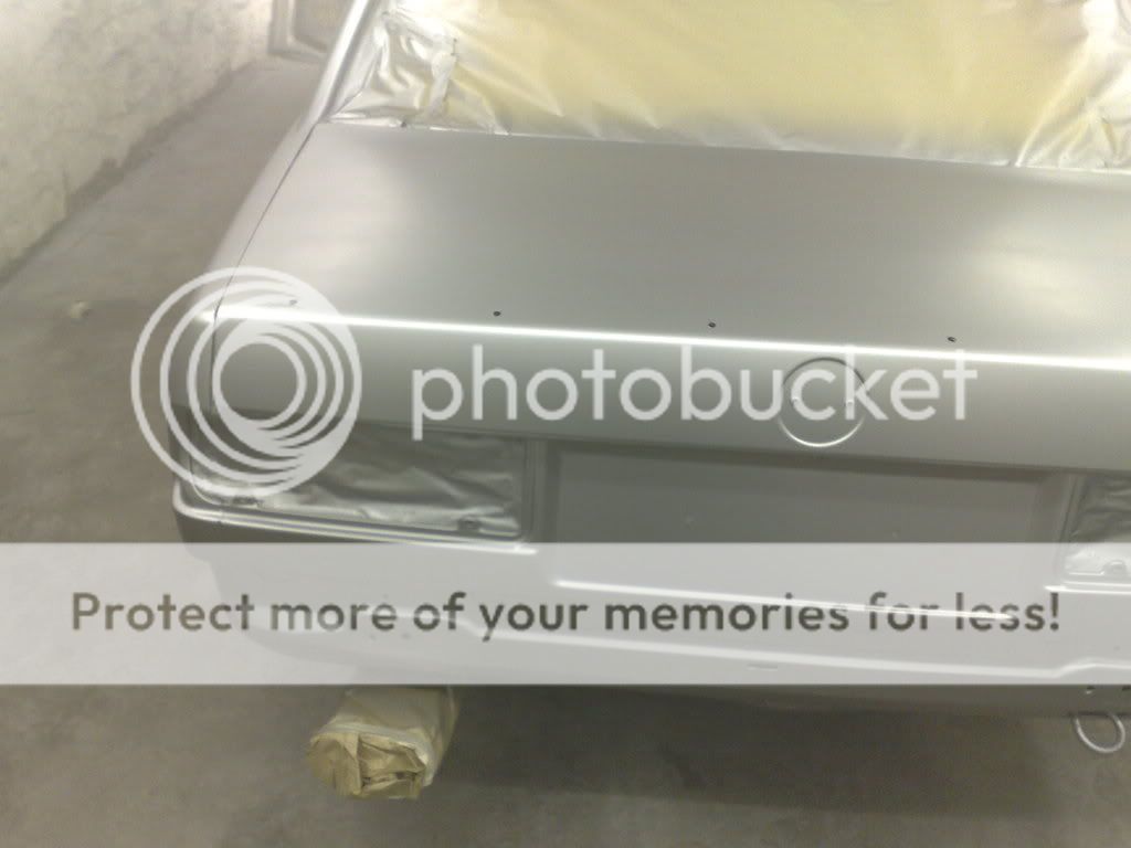

Sat Mar 07, 2009 4:27 pm

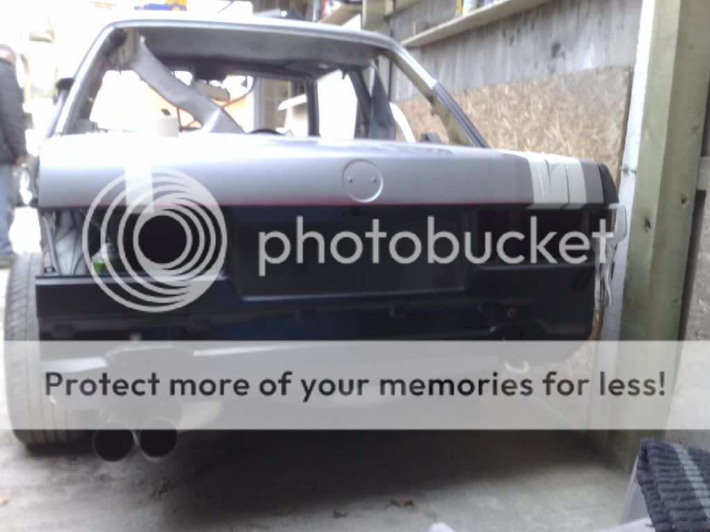

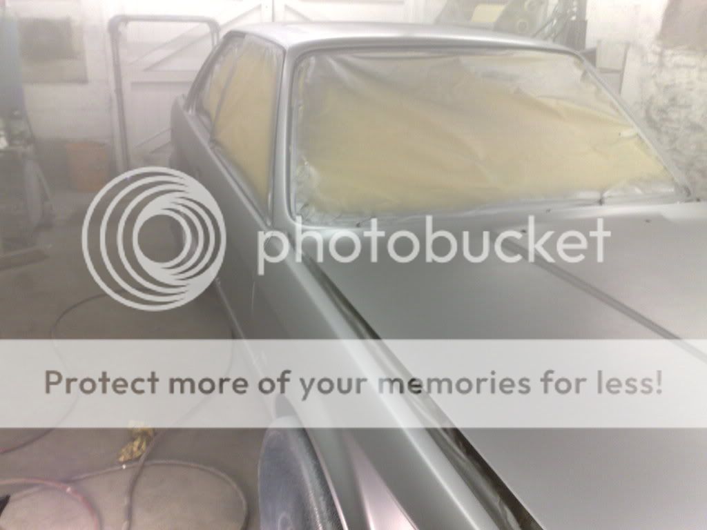

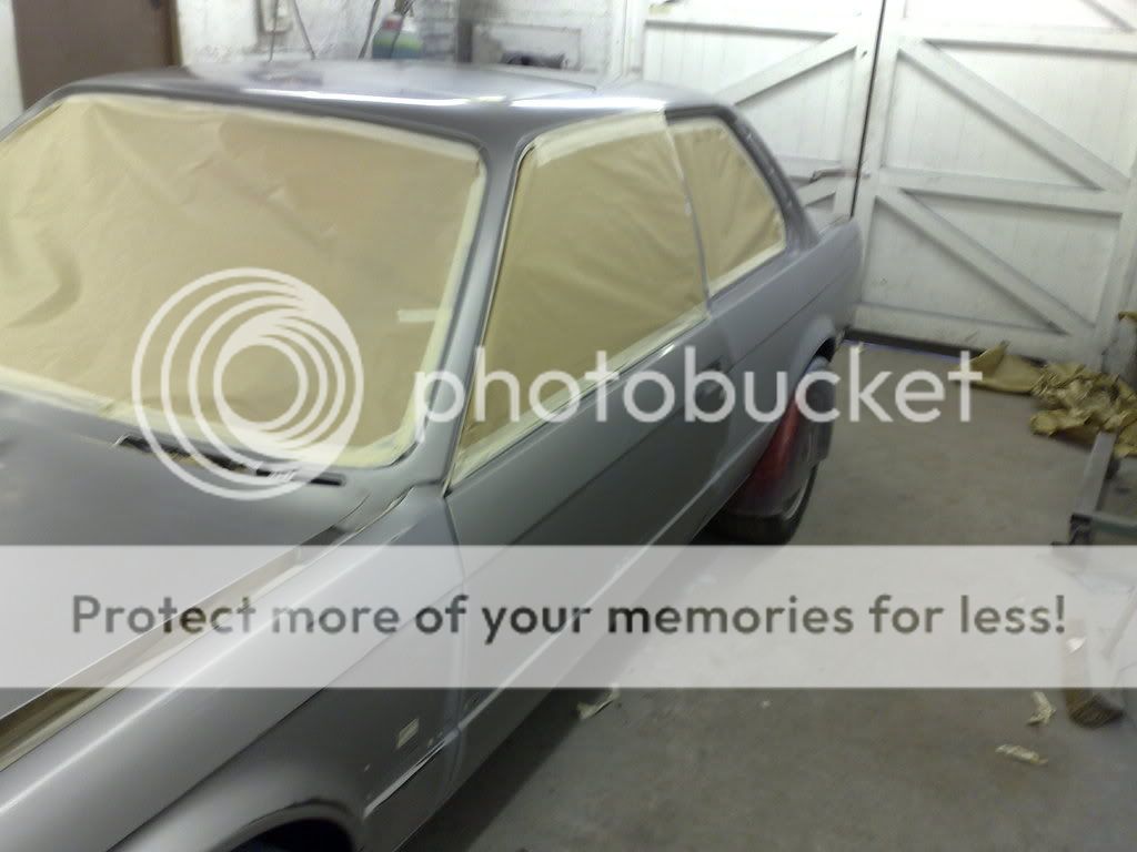

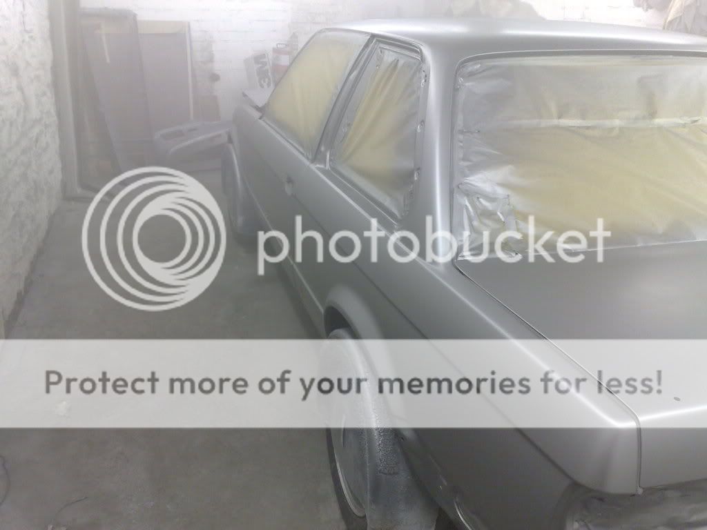

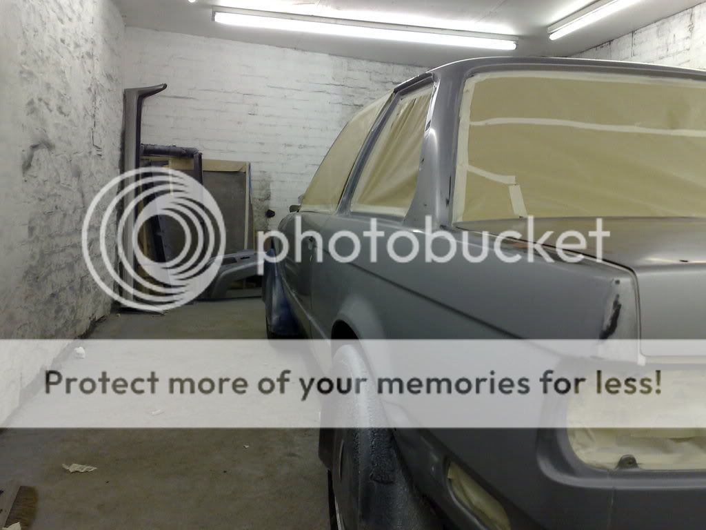

Finally my car is all one colour .
We have put a base coat on the body just to help show all the little inperfections.
Next we will be wet sanding the hole car again with 1200 wet and dry to get that nice glossy look .
Then a few more base coats and then on with the lacker .
I cant tell you how exsited i was to see it all one colour after months of welding sanding ect ect its all starting to come togeather.
Here are a few pics .
many thanks for all your comments and thanks for reading

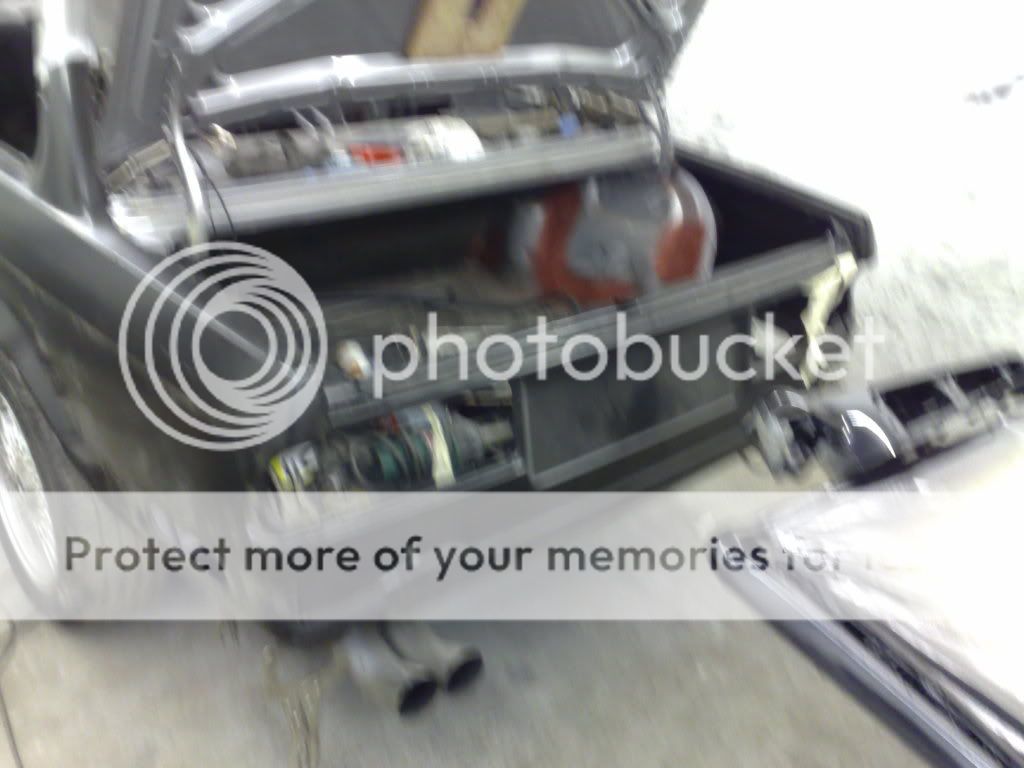

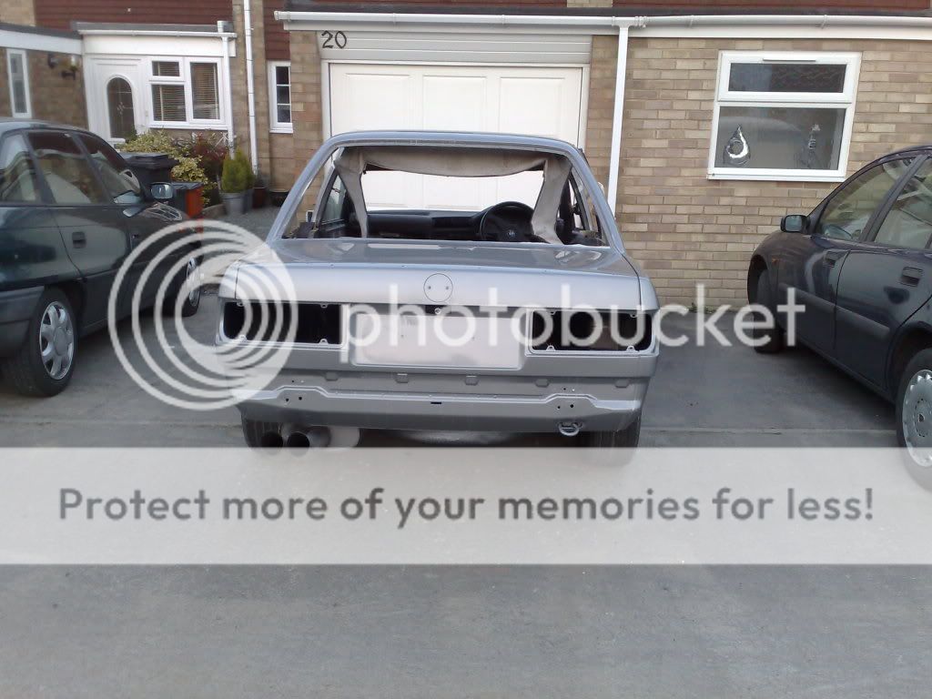

Thu Mar 19, 2009 8:52 pm
Got the car back today. All i need to do is put it back togeather.
here are a few pics Image
as always i will keep you up dated

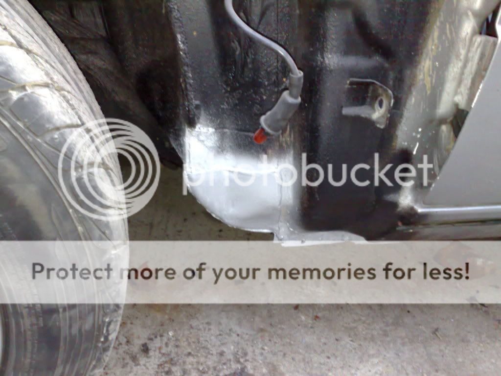

Tue Apr 21, 2009 10:24 pm
getting there slowly. nearly finished the out side now just got the sun roof seals and front lights to put on but just thought i would share a few quick pics with you. Image

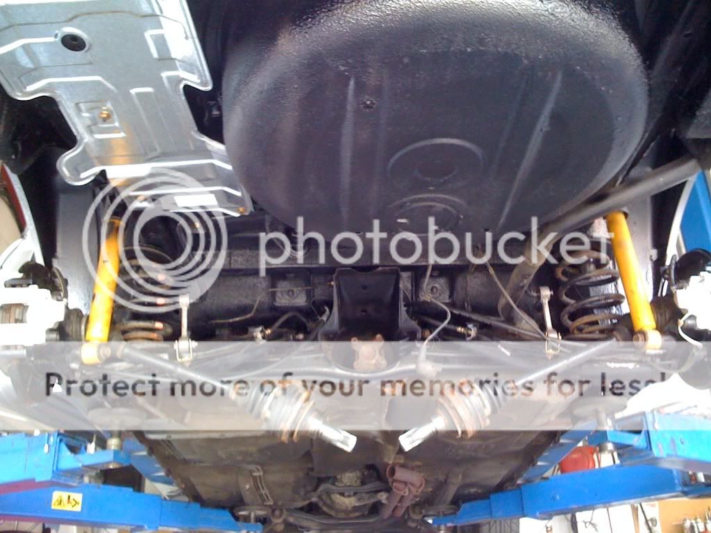

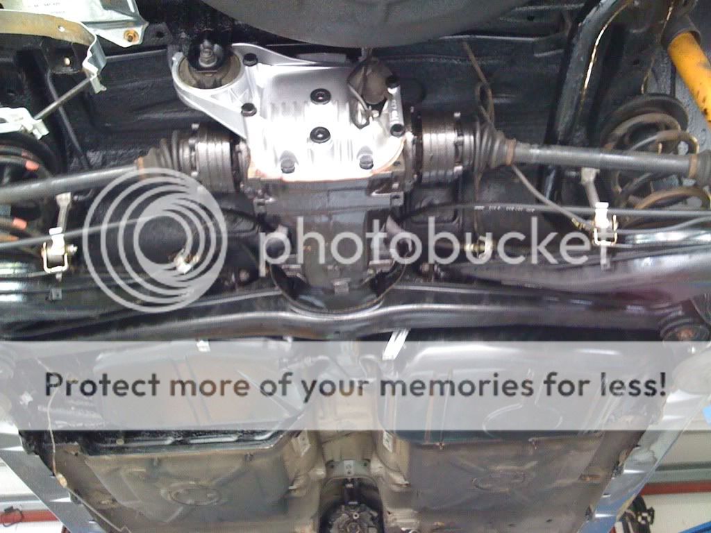

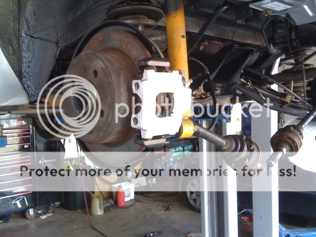

hi just quick up date progress has been a bit slow due to work but I'm still finding a bit of time to do a few jobs .

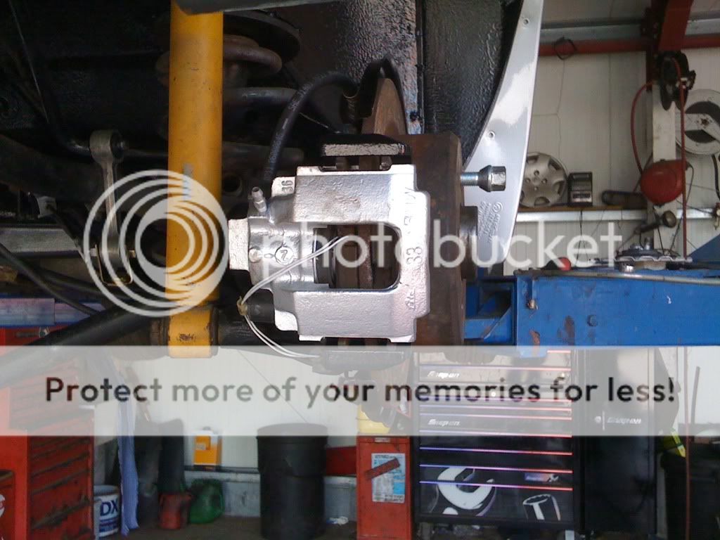

I have been rebuilding the rear end . what a job that was but its done thank god here's a few pics

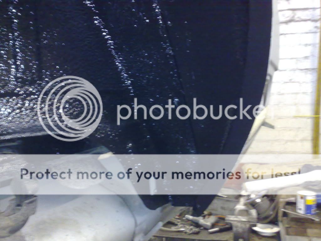

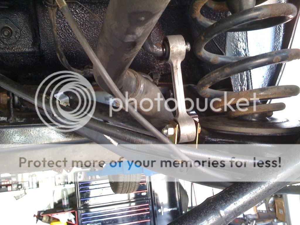

as you might see i still have few bits to do on the back end but its nearly there should be ready for pod.new parts include wheel bearings /back plates /brake hoses /hand brake shoes /fitting kit /hand brake cables /roll bar bushes /drop links /sub frame bushes /trailing arm bushes /steel brake pipes /shot blasted calipers and caliper carriers /also it will have new rear disks and pads i just need to refurb the diff casing and replace the bush then ill be on with the center of the car ill be replacing the front to rear brake pipe and fuel pipes refurb the prop replace the clutch lighten the flywheel renew the clutch hydraulics and then ill be on with the front end
dano0
Posts: 708
Location: swindon

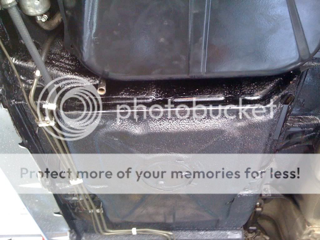

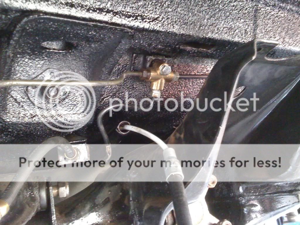

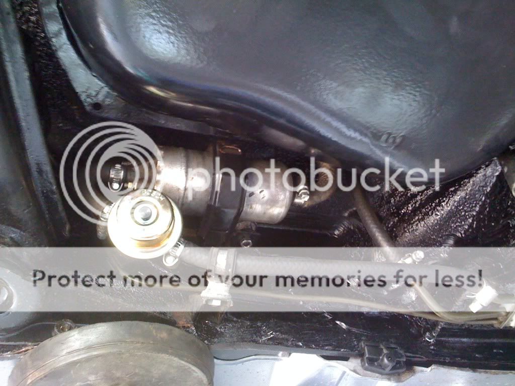

Sun Aug 16, 2009 8:33 pm

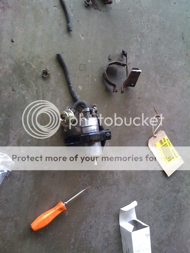

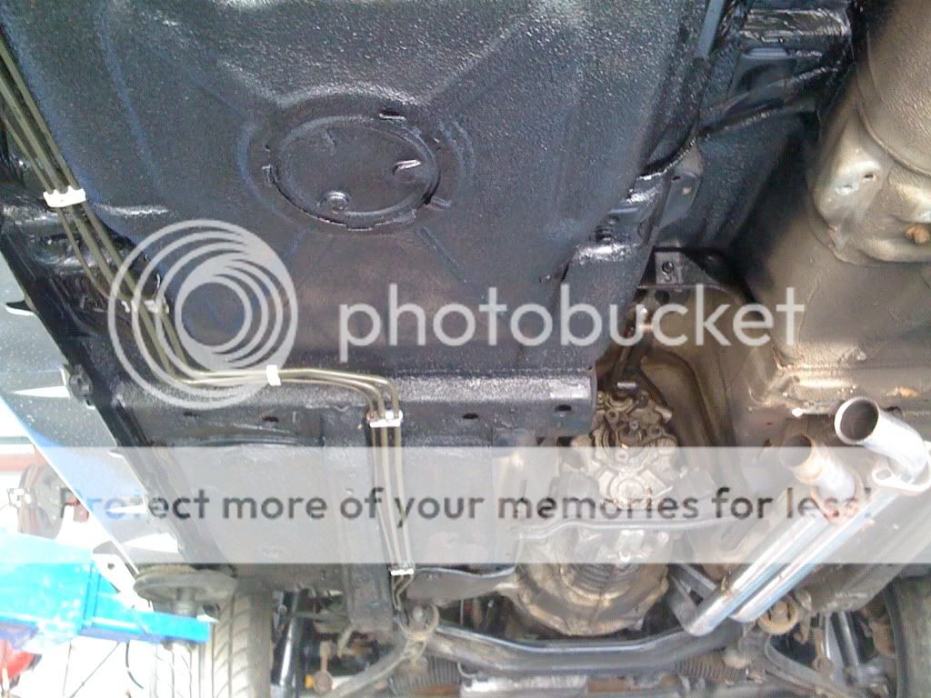

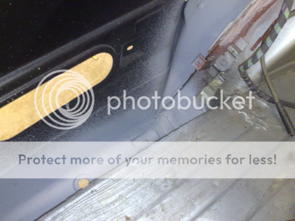

im nearly there with the underneith. ive just replaced the front to rear brake pipe and fuel lines. also removed the fuel tank and gave that a coat of paint. also been wire brushing the sealer and repainting with black underseal witch i think looks awsome .ive been trying to refurb as many parts as posible to keep costs down but some parts just dont look good unless there new like the fuel damper witch is connected to the fuel pump bracket .
but ill let the pics do the talking
Image[/img][/img]Image
