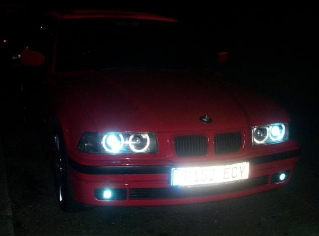

definately a job worth doing and in my opinion i would go with 6000k on the e30
my e30 with 6000k
my e36 with 8000k
