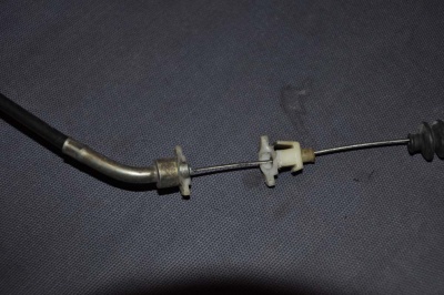

So here's the original cable. As you can see, we've got the two most common breaking points on the same cable; the first is that one of the plastic mounting tabs for the cable clamp has broken off which will weaken the cable assembly, and secondly the entire mounting collar has snapped, making the cable useless.

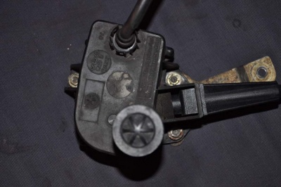

To begin the removal process, we need to dismantle the actuator. To do that, we need to separate it from its mounting bracket by undoing the three M6 nuts that hold it in place. You can just about see them in this picture.

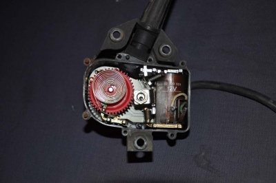

With the cover removed you'll have a good view of the internal mechanism. This picture is provided as a reference, as you're going to have to remove most of the spring and gear mechanism on the left hand side. The cable is connected to the bottom of the big red cog...

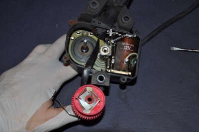

...so gently prise out the spring, the brass latch and then delicately prise up the red cog. You'll find attached to the cog is a thick rubber band. Don't try and disconnect it; we've just popping the cog off its spindle to loosen that band.

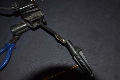

With the cable separated, you'll be able to pull the rubber band out until you see how the actual cable connects to the end of the rubber. You may need to tug firmly on the rubber until the clasp is visible; the other end of the cable will prevent the whole thing from sliding out, so you may need to use a bit of force. Just don't pull the rubber too hard.
When the clasp comes out, you'll see that it's little more than a barrel fitting that slots into a hook at the end of the rubber. All you have to do is pop the barrel out, discard the old cable, and pop the new barrel of your new cable into the hook.
