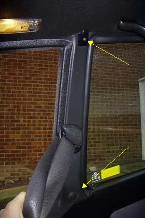

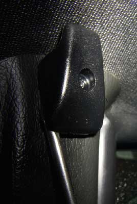

1. Locate and remove covers over window fixings, bottom one pulls straight off easily

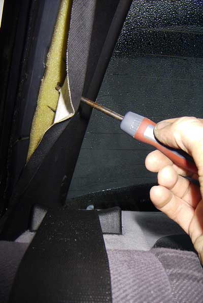

2. Remove screw from top hook, carefully lever off. Push flat bladed screwdriver up from underneath, go gently, you don’t want to slip and rip the headlining!

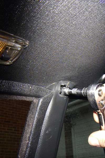

3. Use a 8mm socket and remove the nuts.

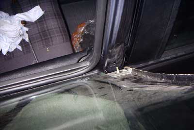

4. You need to gently push the window, working from one side at a time, not quite as shown in the photo. Might help if you have a 2nd person helping from the outside.
5. Half way there now!
6. Next you need to peel back the headlining and remove a section of the padding behind it: -
7. Slip in the body nuts!
8. I replaced the padding previously removed and push a hole through the headlining, lining up with the body nuts behind.
