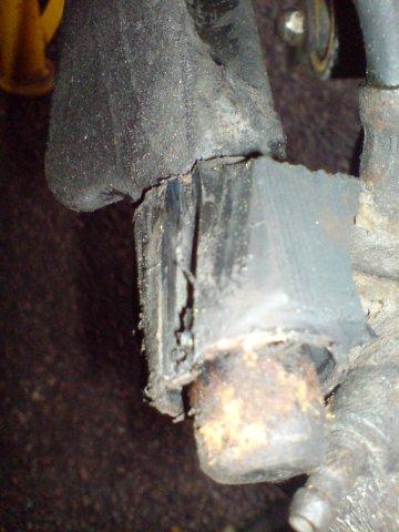

You should then be left with this on the end of the wishbone...
6. You will really struggle to pull this off as its rubber wrapped around a metal ring with rubber inside press fitted over the wishbone. So to make it easier to pull off you need to cut it. I chose an angle grinder (my weapon of choice) you may be able to use a hacksaw but angle grinders are so much quicker... Any way you only need to cut through the metal ring, and be very careful not to mark the wishbone itself.

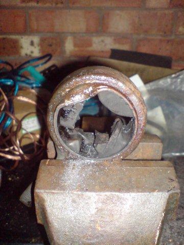

8. Now its time to remove the remains of the old bush from the lollipop. To do this you will need to cut through the metal outer ring with a hacksaw (angle grinder won't fit in there), again dismantle your hacksaw and reassemble inside the lollipop if necessary...
Cut through the bush outer ring only, don't mark the inside of the lollipop!!! Although you don't actually have to cut all the way through, just weaken it enough for the next stage to work
9. Now get a big drift and a big hammer. Mount the lollipop in a vice and where you have cut, give it a ruddy good clout...
The ring should split if you have cut it enough and start to collapse on itself, it should then be relatively easy to knock it through the lollipop with a hammer

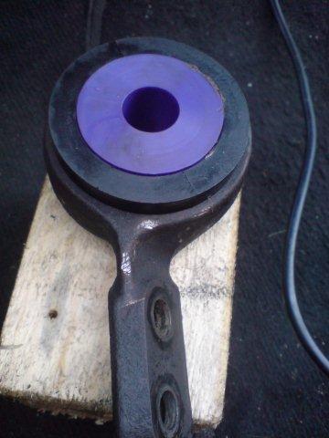

12. Now apply plenty of copper grease to the ridged part of the puple inner bush (do NOT use grease if you're using rubber bushes!). Then press in to the centre of the lollipop so you have this...

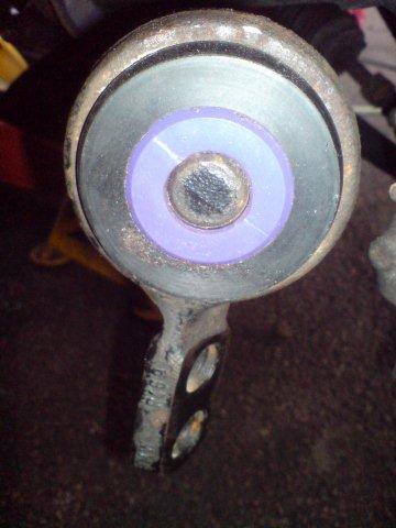

13. Apply a liberal coating of copper grease to the wishbone where the bush is pressed on,
and it should now be relatively easy to push the lollipop/bush assembly back on to the rear of the wishbone. I used a block of wood and a hammer to knock it on. Make sure you knock it all the way on or it will be very difficult to do the lollipop bolts back up again.
Note: if fitting M3 Lollipop bushes, pay attention to the placement of the hole, relative to the lollipop shaft.
14. Now bolt the lollipop back into position, refit the ball joint, ARB drop link etc, and you're done!!!
