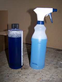

In this article I will be using Chemical guys Premium blue wheel and rim cleaner. This is a concentrate that you dilute 3:1 so the 1 litre bottle will make approx 4 litres, so this works out to be a very reasonably priced product.

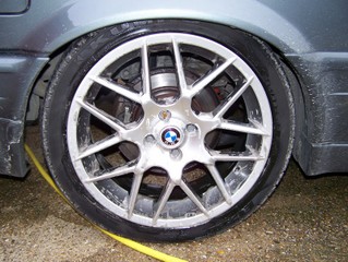

Using a spray bottle and a small soft brush (1" paintbrush is ideal but please tape the metal section to avoid scratching the wheel) I start at the valve spraying a small amount of solution on to the wheel, working it into the corners of the spokes with the brush. Continue this all the way around the wheel, leave for 2-3 minutes then rinse with a hose/watering can.
Before:
During:
After:
That's pretty much it. Very easy to use and gets the wheels clean with little effort, My kind of product!
The trigger spray bottle was full to the brim when I started, and it used that little doing all four wheels, The concentrate was full too and used roughly 1/8th of a bottle to make 500ml of solution.

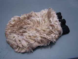

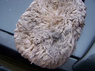

This is the before and after shot of the mitt, top is before rinsing and bottom is after
You really don't want to put that back on the car like that!
The colour of the "clean water" will probably shock you!

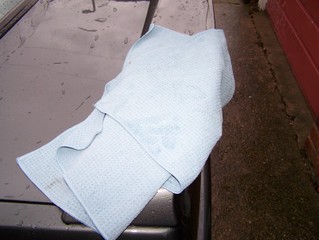

Step 6: Drying the car
Using a high quality micro fibre drying towel (Poorboys do a reasonably good quality one ~ Available from Serious performance)
Start from the top and worth methodically around the car drying each panel properly. Pat the panels to dry them rather than wiping, This helps reduce the chance of inflicting swirls.
After a while, You will learn your particular traits, water traps and tricky areas, and you can keep an eye out for them.

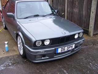

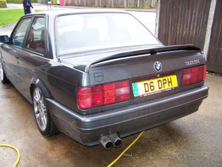

Here are some before and after shots, But I forgot to clean the exhaust!
Before:
After:
