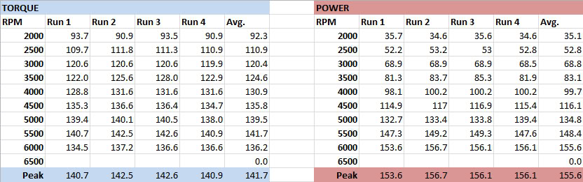

OEM Filter
K&N Panel Filter
K&N Cone Filter
And a comparison between the averages:

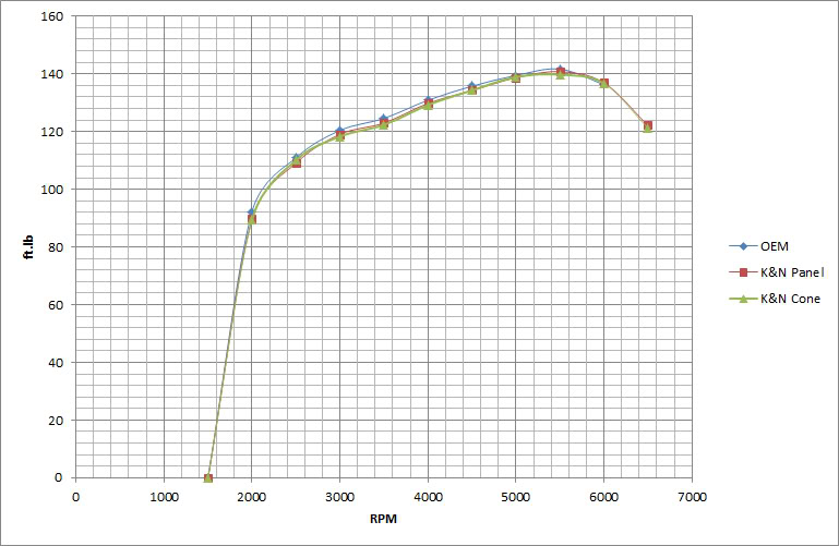

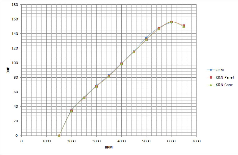

As you can see, there really isn't a lot in it. Put onto a graph for comparison it gave a fairly surprising reading for me.
Torque
Power
I'll let you make your own conclusions, but it's pretty clear, if you're worrying about 1-2 bhp and a few ft.lb's, that the OEM filter gave the best result throughout the whole RPM range (if you're willing to lose ~1 bhp peak).
