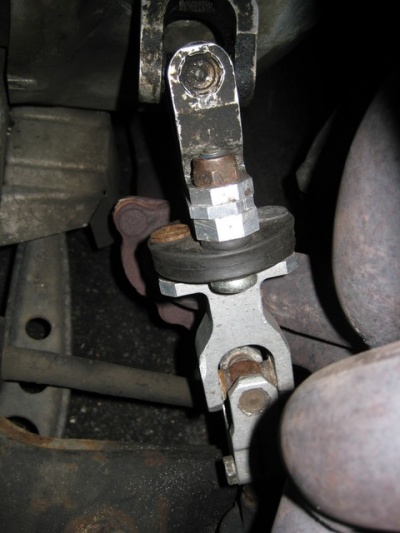

I have fitted an E36 rack in my car with modified link between the column and rack. It's fine on the road but on track days the exhaust manifold can come into cantact with the lower UJ and you feel the vibration through the wheel. This modification gives extra clearance between the steering link and exhaust manifold.

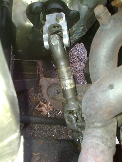

Here's the old set up for reference. As you can see, it's pretty ropey and certainly not a BMW-quality solution.

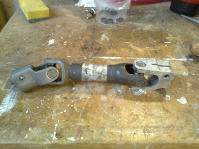

I bought a Corsa C link and separated the top universal joint, keeping the bearings and rollers.

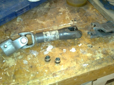

Then swapped the top piece of the E30 link back onto the Corsa link. I reused the bearings saved from earlier and re-staked them into the aluminium with a punch.
