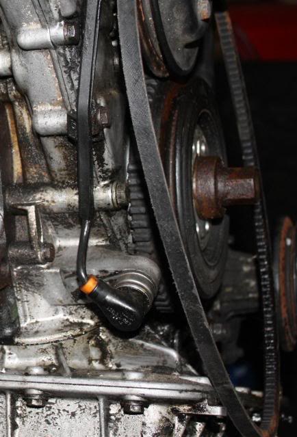

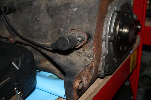

The M42 engine is found in two cars; the 318is versions of the E30 and E36. However, the E36 318is was later "upgraded" to the M44 engine, which is not as desirable for a simple swap due to its increased complexity. To make sure you're getting the right engine from a donor, the most obvious way to identify an M44 engine is by the crank sensor being at the rear of the block, not the front timing case:
M44 crank sensor location:
M42 crank sensor location:
