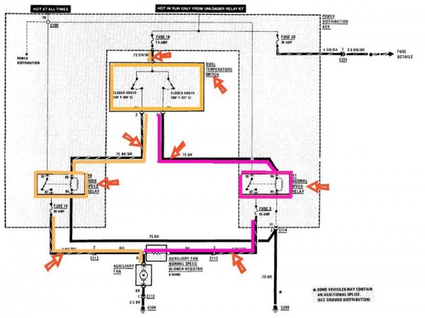

Power leaves the fuse box via fuse F19 and goes to the input side of the temp switch. The output side of the temp switch then returns (one wire for single speed - two wires for dual speed) to the fusebox and goes to the fan relays. Relay K1 is the low speed relay, and K6 is the high speed. The return wires go to relay terminal 86 (If you are wiring a single speed fan, you only need to use K6). Pin 85 of the relays needs to be connected to GND. You can just run a wire to any suitable GND point.
Once the wiring is installed as above, you will find that when the temp switch closes, you will get 12v leaving the fuse box (via F19), and returning to the relay which will close. If you have wired both the low and high speed, then the relays will switch at different temperatures. Initially the low speed, and then the high.
You now need to wire the output side of the relay to the fan. The high speed is on F18, and the low speed is F3. Just run a wire from these fuses down to the fan +ve wire. If you are going for a dual speed fan, you will need a low speed fan resistor to give the slower speed. This should already be present if you are using an E30 A/C or M3 electric fan.
What you basically end up with is both the high and low speed wires connecting to the same +ve fan wire. It's just that the low speed wire needs to pass through the resistor before it connects to the fan. The -ve side of the fan just connects to a suitable GND point. There's a good one just behind the passengers side headlamp assy.
Diagram
Your E30 has some of the wiring in place in the fuse box to automate the fan. The diagram above is if you want to add to the OEM wiring. The bits/wiring you will need to add are arrowed. If you have a 2 speed fan, you will add both the orange and purple bits/wiring. You will need to add the female spade terminals into the fuse box for the relays K1, K6 and the fuses 3, 18, 19 and the wiring to the fan/temp sensor.
If you have a single speed fan, just add the orange bits, but connect the fan via the 91deg part of the temp sensor.
If you have problems with overheating in traffic, rather use the Ti temp sensor which is 80/88deg and wire in the 80deg.
