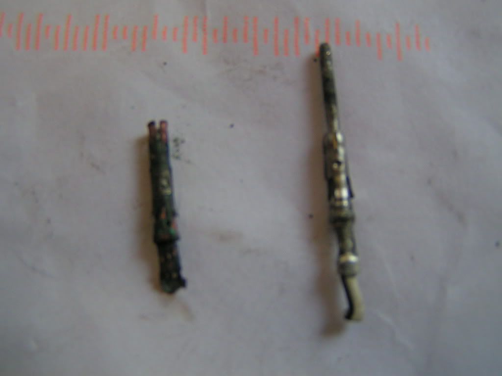

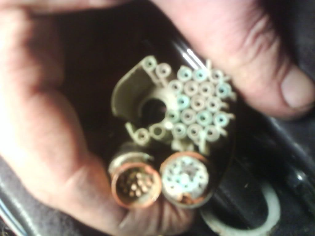

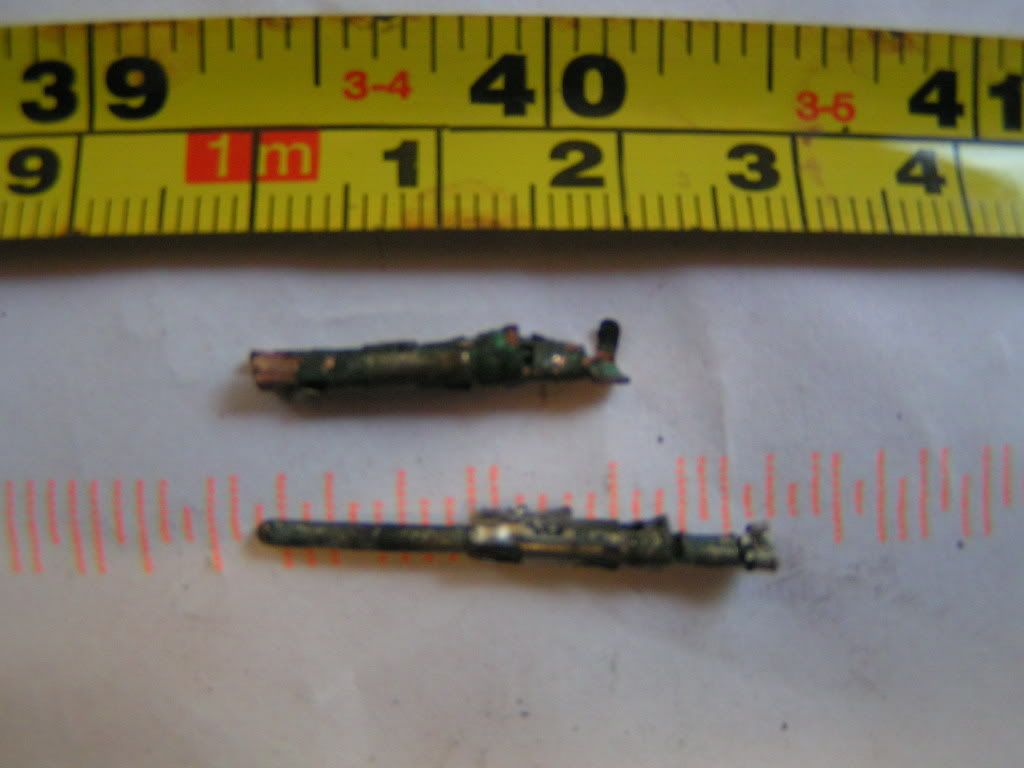

Glad you didnt pull out the connector on the door i did and my connector is SH*GG*D !!
So dont pull out unless its vital!!
All my pins look like this
And connector notice rotten green that brianmoooore is on about
Zimmer is hopefully going to help me
so far i need new connector which is about £5 + 21 female pins and 21 Male pins
Total cost is £Â£Ã‚£Ã‚£

You only need to fit around twelve pins to the average E30, to work the windows, central locking and mirrors.
19 wires in myne i dont know what they are for though if you only need 12Brianmoooore wrote:You only need to fit around twelve pins to the average E30, to work the windows, central locking and mirrors.
The round connector above i ripped out i think it was part of original bmw alarm i have 2 locks on drivers side these wires were running to that.

So, do you have any progress to report on this? Did you completely replace both parts of the plastic connector, and all the pins?bigbird76 wrote:Glad you didnt pull out the connector on the door i did and my connector is SH*GG*D !!
I have some bad connections through the connector, and have completed the Red & Black mod, which partially solves some of my central locking problems, but I know I have a poor connection for the pin (I think #1) for the Mirrors. Is it possible to replace just the male and female pin for this wire?
