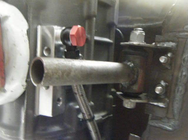

Sump is off an e36, theres space to go about another inch and a half back but would mean the gearstick would be way too far back so decided its staying where it is.
- martinpallot
- Posts: 352
- Joined: Sat Aug 04, 2007 11:00 pm
- Location: Jersey C.I
cant shorten the bracket on this

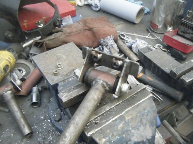

Engine mounts done today, complete ballache of a job but its done now. Ended up making new chassis mounts as I realised using the old ones just wasnt practical, also got it moved back another 3/4 of an inch without affecting the gearstick position as much as I thought. Now sits much more snug againt the bulkhead
With this offside mount, I want to brace it higher up the block somehow. Will give it a go once the engine is back out so that access is a bit easier. As it is at the moment I think the angle of it puts the lower bolts under a lot of strain, especially as this is the 'heavier' side of the block

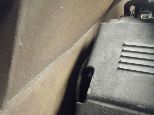

Whilst clamping one of them into the vice I realised that the cast piece at the bottom can be made to flex quite easily , so I got a bit of 3mm steel and plated it a bit. I didnt want to wedge it completely and with thick steel as I think it needs a bit of give to avoid potential breakage somewhere else along the casting. We'll se how it goes. Also drilled the bottom ball joint taper out to 5/8ths so that I can use the rose joint arms. All they need now is alick of paint

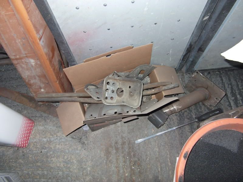

The box of brackets/rust traps removed from the underside so far. This lot on its own weighs about 2 kilos with the spring perches
