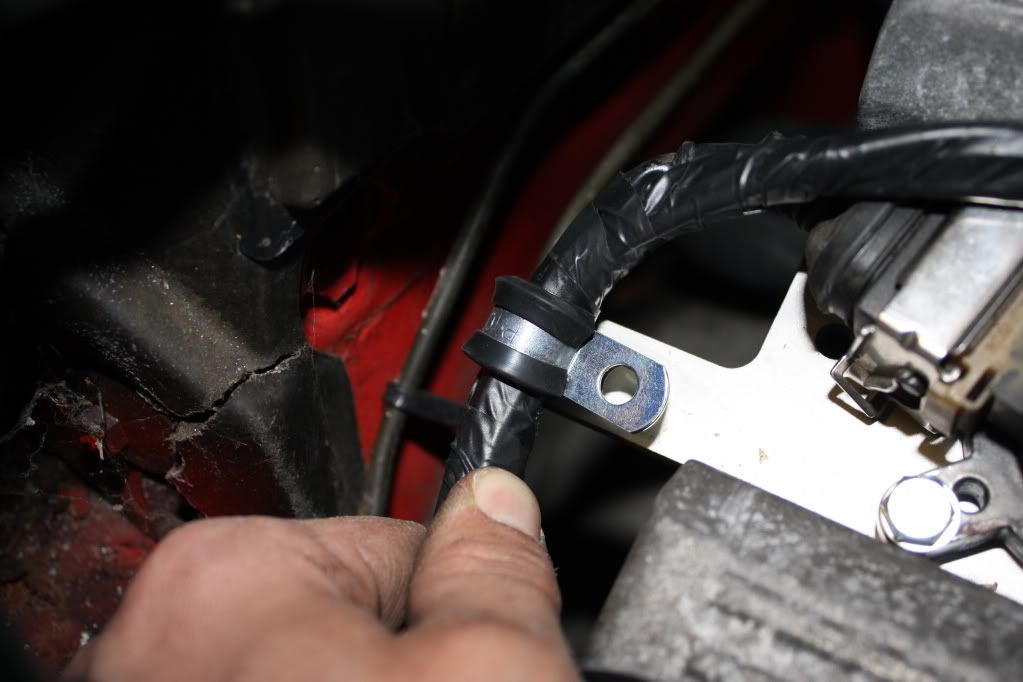

I then decided I will use a P clip bolted to the sticky outy bit to hold it in place.

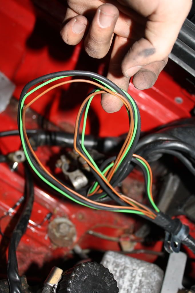

Trouble is I’m left with all this:
Not sure what to do, whether to cut it and them crimp it back together but I feel all shuddery doing it due to the job they carry out, what’s the thoughts?
