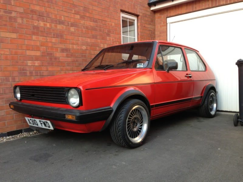

Time for a few pics on the new rims;
Don't worry, the nasty badgeless grille will be going as well. It's just a temporary thing since what was on it was broken and missing the ends and this was in the boot.

Those wheels and a good interior clear out has transformed the look of that car 8)

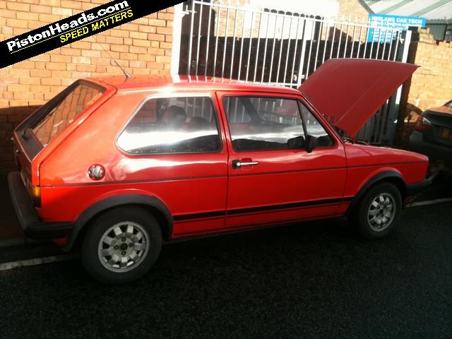

Theres a genuine 1983 A mars red GTI parked up in the yard at my workshop. My mate has tried to buy it as he's a gold wrongun (with a 2.0 16v Mk2) but the owner wants silly money for it.

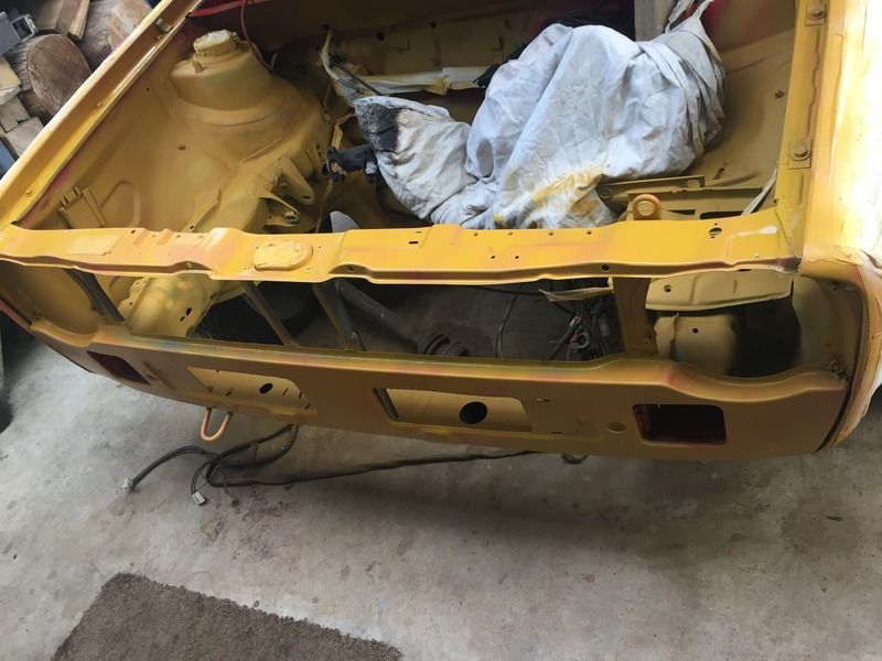

So I've now bitten the bullet and pulled out the tired old 280+ mile 1600 and set about giving the engine bay a quick spruce up before the 2.0 is then fitted (still need to bolt the ancillaries to that to). All scabs have been dealt with, POR15 has been applied liberally so it should be very well protected now. Just need to finish off with the primer and final prep before laying on the Mars Red.
Engine gone, not a bad job, even without an engine crane.
After its most recent coating of high build primer, wasn't originally going to do the front panel, but just got carried away this morning.
Ideally I want a new engine loom, condition of the old one is probably only just about functional. Getting the impression that the only option will be to make my own though, should be interesting as I've never done anything like that, but the current one will do to get it back on the road ASAP.

Final coat of primer went on today, so all being well it'll be ready to flat down tomorrow and I'll have it painted by the time I'm back work on Saturday.

Engine bay is now painted, just needs a quick flat and polish, and then will crack on with giving brake servo and all that gubbins a spruce up.
