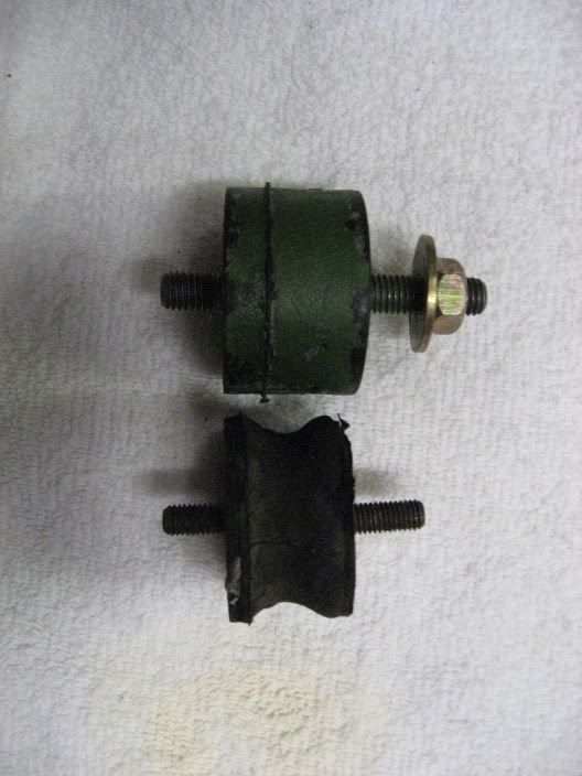

i replaced my broken mounts with some rubber mountings from RS components. a direct swap and only about £4 or something each.
you'll have to measure up first though and choose the size that fits
Thu Apr 08, 2010 7:47 pm
They are about £9 each, 10mm studs instead of 8mm

DanThe wrote:Cant see the physical sizes listed Gareth :?
it's a massively un-user friendly site.
you have to download the pdf datasheets to find the size you want then try and find the part number from the datasheet on the website (you can search for manufacturers part numbers)
