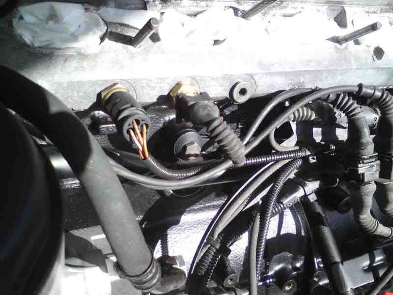

You need to replace the black e36 gauge temp sender with a brown e30 m20 one... The blue one is the ecu..
Standard Sachs clutch will be fine..
No need to move the servo over, just use the Clio one..
Tue Oct 27, 2009 8:47 am
Dont take the black sender out, the ECU needs it also, brown E30 sensor needs fitting alongside
Ive never had a problem with standard M20 clutches, even second hand covers
Tue Oct 27, 2009 9:41 am
DanThe wrote:Dont take the black sender out, the ECU needs it also, brown E30 sensor needs fitting alongside
Is that different to the M50 then? Sure I didnt have a 3rd hole n just replaced the black sender with a brown M20 one? :?

Yep, M50 has two sensors, one for the gauge and one for the ECU like E30's
M52 has one twin sensor
The third hole blanked off is the outlet for the throttle heater

DanThe wrote:Yep, M50 has two sensors, one for the gauge and one for the ECU like E30's
so in my case i just put in the m20 brown sensor and leave the other one in too. what about the wiring for it? is that on the engine loom and will still be there when its modded?
'88 e30 328i M52 track bint.
Tue Oct 27, 2009 10:48 pm
Its not on the engine loom, I add the plug when modding
