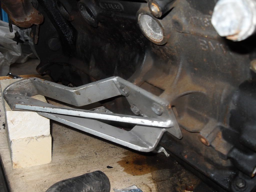

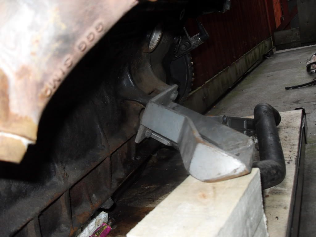

My mounts bolt in the middle of the block on the inlet side (when in an E34 the mount is further forward and sits under the oil filter)
Couple o pics
Standard E34 mount
E30 mount.
Standard E28 mount
Exhaust side E30 mount, (E34 block)
Standard E34 mounting points (different to E30)
Standard E28 mounting holes, best pic i could find :( although seems to be quite a few mounting holes to choose from.
Im guessing if the holes are there in the E28 block my E30 mounts will fit?
