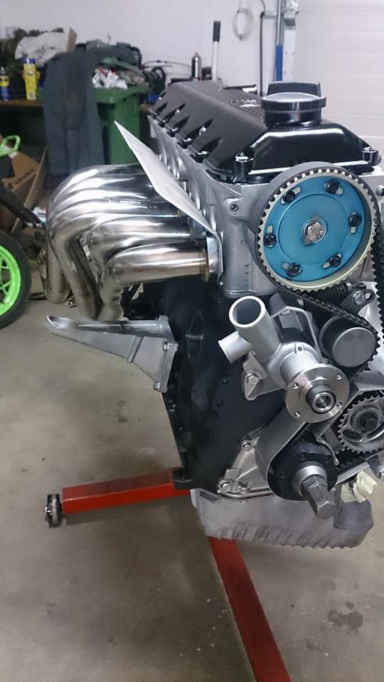

I am in the process of building an m20b20 engine for the production bmw championship. The engine needs to remain stock so no porting, no 325 throttle bodies or inlet valves etc
Boring the engine to a piston size of 80.48 is allowed, I have taken into account a very helpful comment above reffering to rod length etc etc... Luckily I have a few engines so I am hoping to find a good matching set.
If someone could please explain the difference in the m20b20 heads between the years, some say that early 84 (1984) heads perform better in terms of torque etc.
Bullet nosed valve guides......any benefit?
Expansion : given the fact that we are running at high revs especially when downshifting, what would the optimum compression ratio be (without skimming the block...not allowed) be before valve to piston contact?
All comments and thoughts appreciated,
Fine tuning in a one make series that offers little modification is a real challenge
No clever ecu mods allowed unfort Speedtouch
