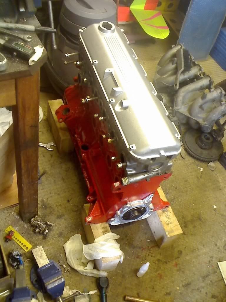

I fitted my inlet manifold to my rebuilt head 2 days ago. I was abit pee'd off after neatly trimming my gaskets to fit the D shaped head inlets to find the manifold tubes where oval and didn't remotely match the head.I would suggest that matching the ports here[and on the exhaust side which I believe Alpina did] could show abetter result than messing with the chamber shapes?
If it aint broke don't fix it!
Standard m20b25/885 head and manifold[out of interest the engine ran beautifully ,despite cracks through 5 of the camshaft journals.... mind you it did deposit about 2 litres of oil into the coolant on the 240 mile journey home when I bought it]m_jermyn wrote:What head and manifold where you using?

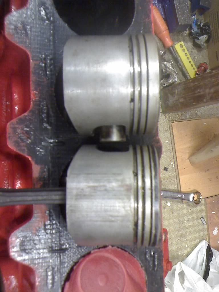

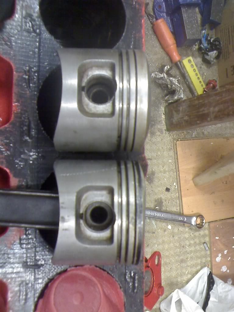

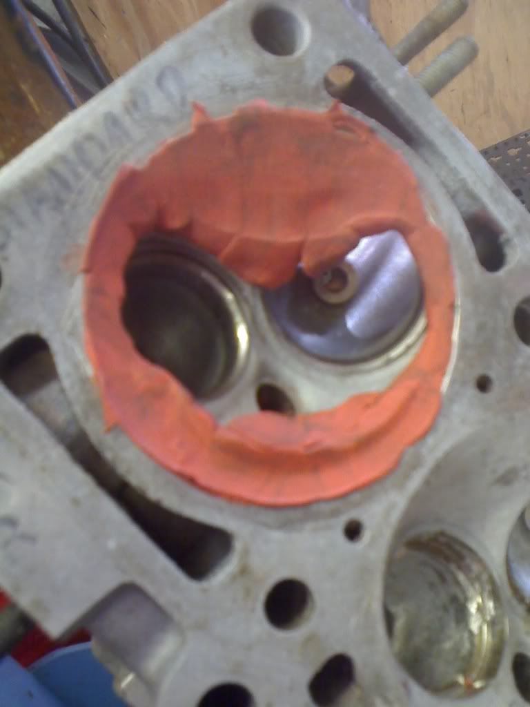

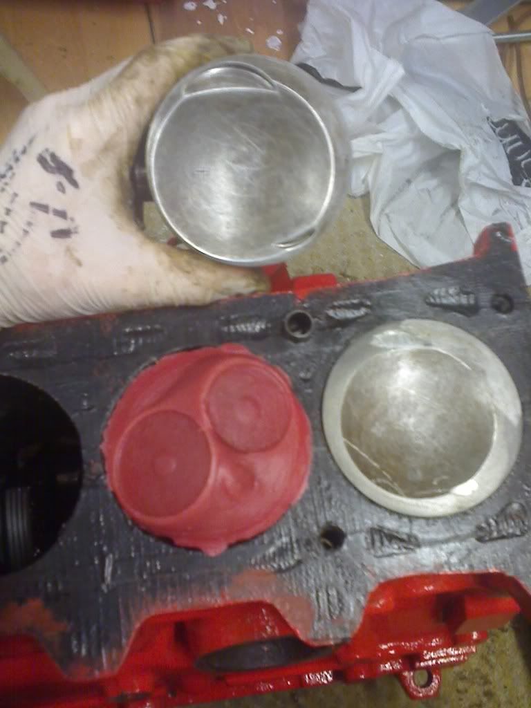

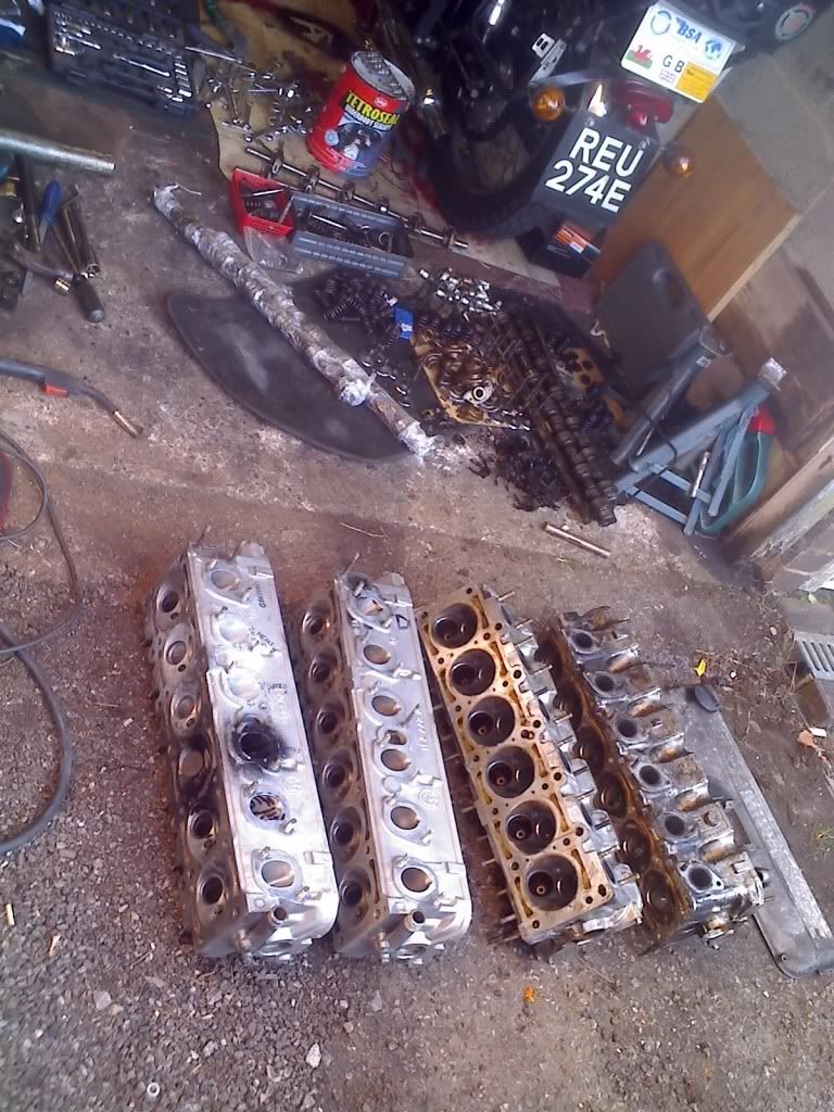

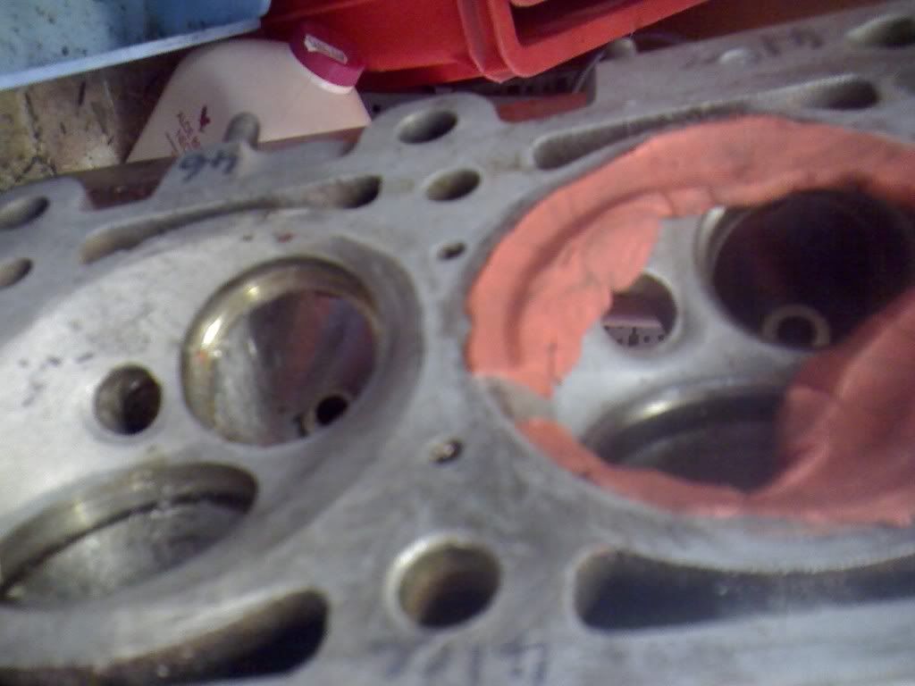

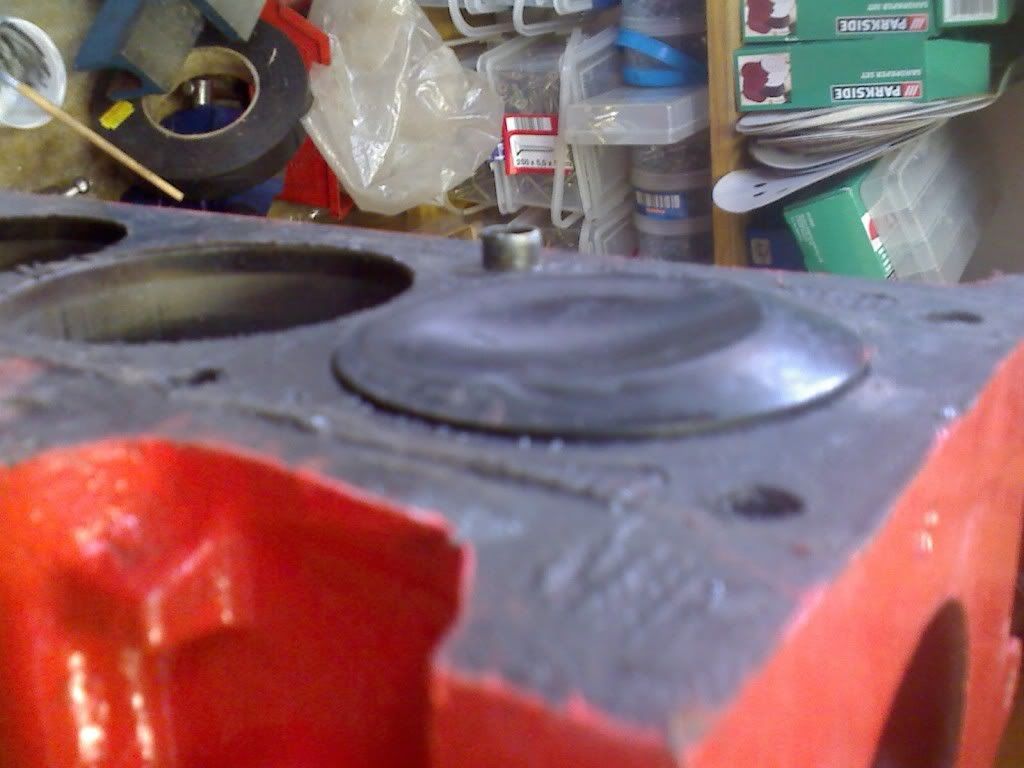

right epic update time, iv been fiddling with things all week and done a fair turnover of work.
got the dummy build donor bottom end from a mate of mine, stripped it down, cleaned everything up and gave a few bits a coat of paint.

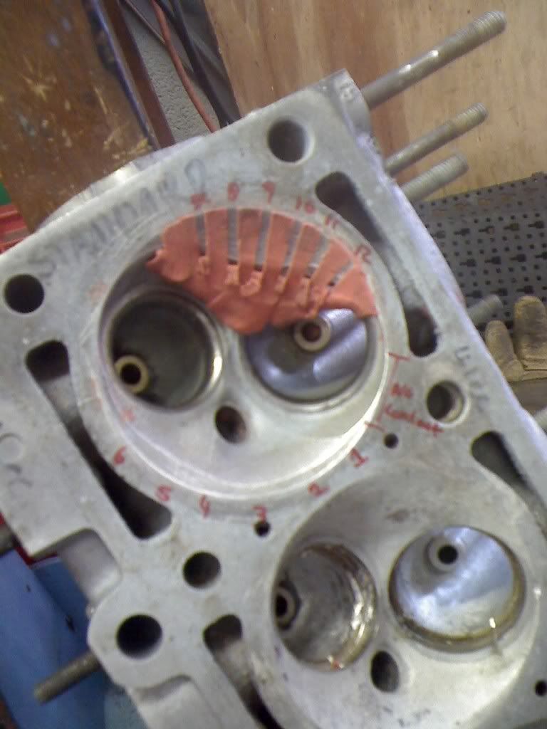

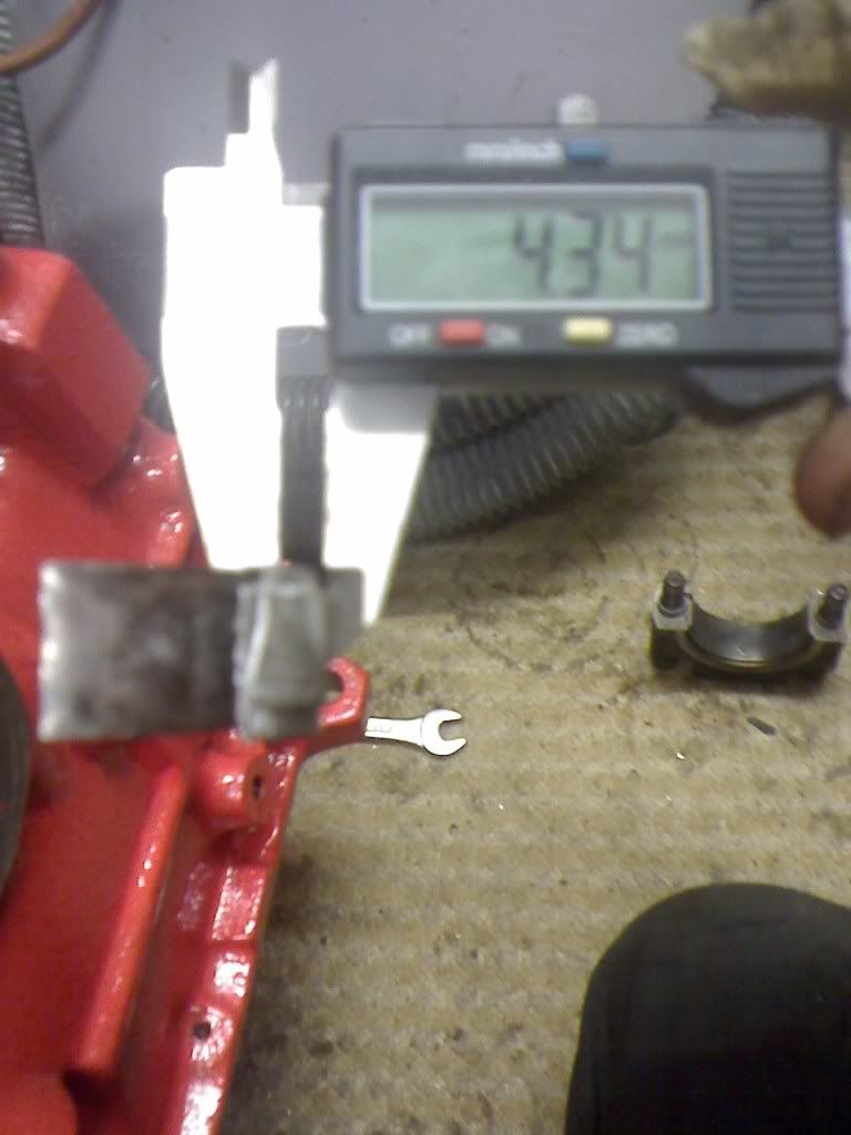

got some clay out and bannged it between the piston and the head to measure the clearance to the head around the squish band.
found it was about even all the way around and at ~1.71mm which im led to believe is too much, as it wont quench the charge properly and can hold end gas.
took a mould of the chamber to work from
measured a piston up and found theres a hell of a lot of meat on these stock e30 pistons,
ill get the figues up when i have my note pad to hand.
what it ment was i could take some meat off the top to get them to work in a stroker.

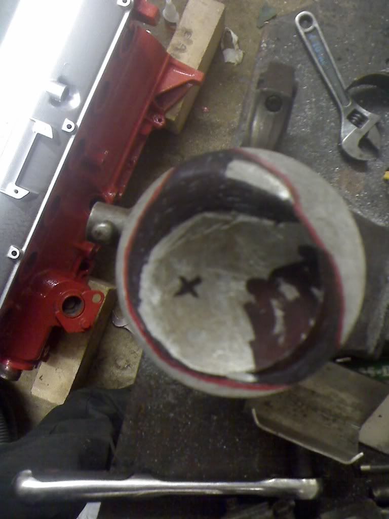

as dans pulling the crank and pistons from a b28 for me as we speak i had to improvise a little to put the piston at the same height, que a 4.5mm bearing spacer.
it was actually 4.34mm after being squashed flat and glued in place so ill have to take a little more off the pistons later on but meh, it will do as a test.
in actual fact i made a 3mm spacer for the 2.7 stroke as well and did a 2.7 piston first...

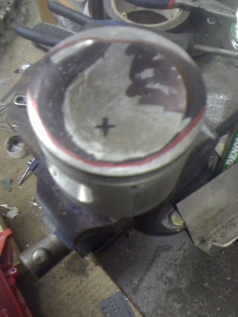

more than enough meat on these to go down 3mm, once iv tested a set and pit the valve pockets in (both of which should be fine, i have been doing my homework on these) there should be no more need for anyone to ever get 2mm decked from there blocks.
once that was done i went full bore at the 4.34mm chop.
from the top of my head the top ring land was 8.something mm thick, and 0.5mm needs removing from the head clearance to leave 1.2mm squish distance
the top ring land is now 3.85mm thick which im led to believe will be fine and a thermal coat will allow the thing to last as well, the bowl in the centre of the piston is still standard thickness.

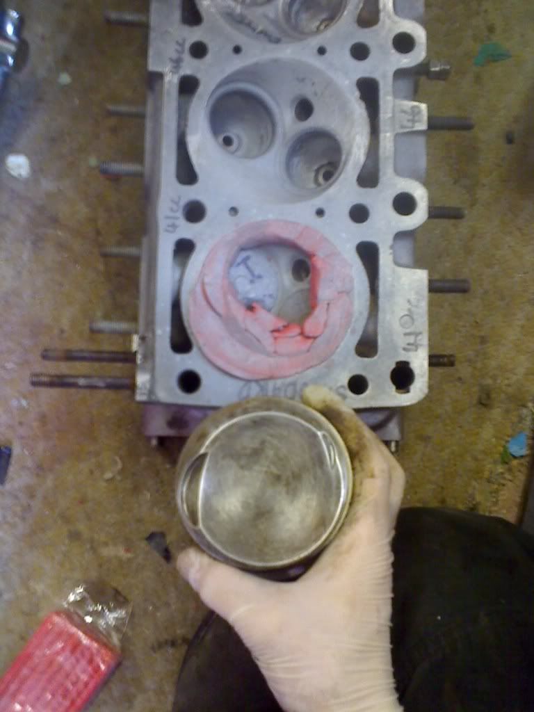

i need to reduce the ridge around the edge as at the moment this one is making 12:1 compression
the red line around the top of the piston here indicates what bits of the piston are at risk of contact with the head and the bits in the black are dead meat that can be worked about however to give the desired combustion chamber shape and CR.

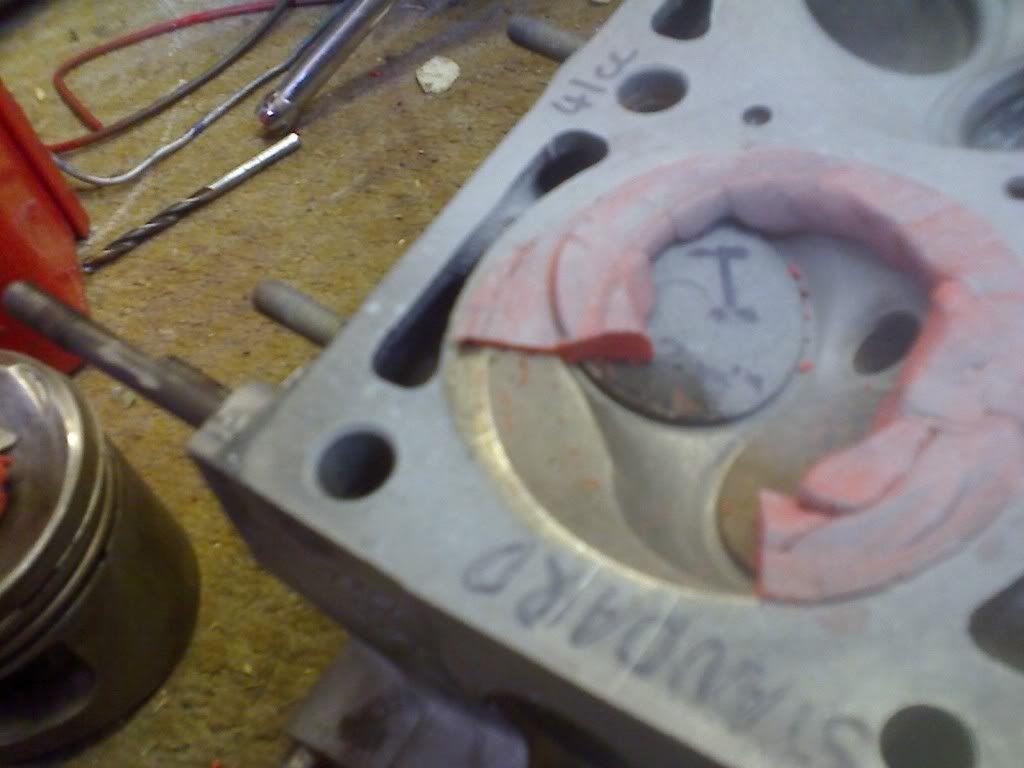

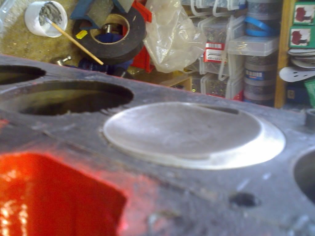

again bunged some clay in there and checked the squish
as you can see its now shoving the clay well out into the chamber compared to the before.
iv got the measurements of the clearance written down as well but not to hand, its around 1.1mm at the mo so a little more of a skim will be needed.
next post will be a 731 head, different seats and valves and the porting taken to its logical extreme conclusion, both of which will be tested this week.
HairyScreech
- Engaged to the E30 Zone
- Posts: 6265
- Joined: Sun Jan 21, 2007 11:00 pm
12:1 on lpg or e85.
ill try and get down to a more sociable 10.5:1, theres still plenty of meat on the piston, i cant believe how thick they were up top.
the height of the top ring land is my biggest worry, how well this will work for a 2.8 depends greatly on the quality of the alu in the piston, the ceramic coat will do it untold favours but if the alu isnt up to it then the top ring land could hammer out.
the biggest problem with a lot of this is its all "may, might, if, possibly" as theres no hard and fast rules. one piston may be fine with a 3mm ring land and another may need a 5mm minimum.
and theres no easy way to tell which is which, as it depends on material grade, burn rate and pattern, fuel grade, chamber shape, head thermal conductivity, heat loss to the bore walls, oil squirts or not,
it is possible to calculate it but i wouldnt like to bet my nuts on it.
what is dose mean is forget decking your block 2mm and having a vernier cam pully, get the pistons machined for higher comp, better squish and less side thrust.

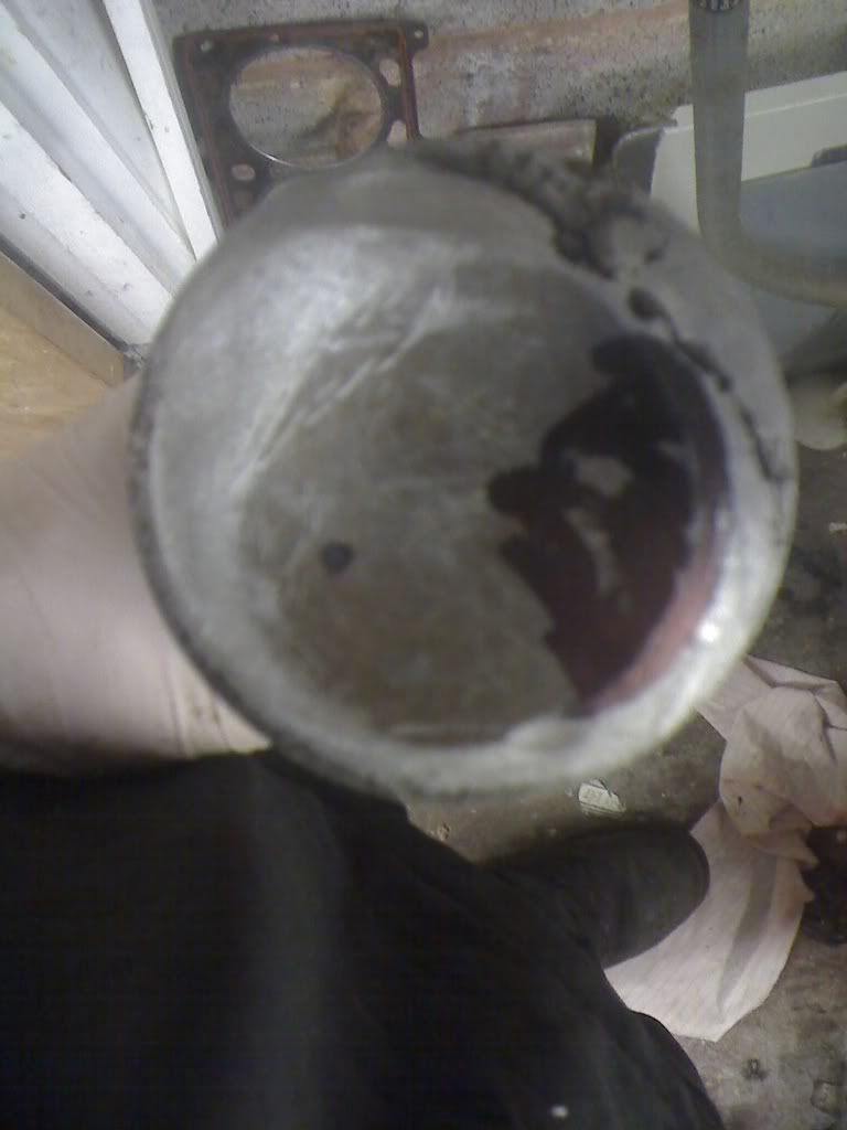

right, quite a few responses this morning, dont you all have jobs to do?
lets do this in order....
which i will be doing early next week.
im going to have to flow the no1 chamber with the manifold and then ill use the 731 head which has 3 unmolested chambers to see if theres any difference between each of the runners.
im fairly sure the manifold wont flow well enough, its just not got large enough runners and there far to long to do much up top. so initially the engine will run on the stock manifold and a proper one will be built later on, perhaps with throttles.
2. im not sure what you mean by " if all the pumping restrictions are gone, will there be more to find", in terms of pumping losses its always a compromise between gas velocity and flow, and i dont think its really possible on a 2v to be over valved.
3. your right on the 885, the best flow so far has been from narrowing the guide and working the port upwards a little either side, cutting the lower side of the floor to make the short side wider and working the back of the bowl a bit, to raise the height of the bowl roof a touch.
i have a feeling from speaking to a few people that the seat could do with a multi angle cut as said earlier in this, im going to sort out a 30/45/70 and a 30/45/65/75 cut and see what we get.
4. iv seen what you refer to, its something that is used in drag pistons quite a bit, the intention is to prevent ring flutter and help stop the seat hammering out, there like vertical ports just behind the top ring.
its worth looking into but im not 100% its of much use here.
the aim is really to take a proper look at the m20, its not a bad engine, but it is far from optimized, im using a lot of this for my third year uni project now (well i might still change my mind) so some things are going to seem a little pointless to the real world.
if you take a look about half way down the first page there is a few questions im going to try and answer and a list of things i think need looking at.
they really come down to improving the head flow, increasing the compression and the thermal efficiency, reducing the reciprocating mass, reducing oil and windage losses, tons of other stuff but iv got a memory like a sieve.
i dont know if im going to actually build any more once im done with this, it all depends on the quality of the results and the final product.
if things work well i might knock a couple of batches of pistons up, perhaps a couple of heads and maybe build a few complete engines if people want to pay for the work.
you should have 1.7mm to the head with a stock 2.5 piston, which by all accounts is a little slack, with 1.8mm extra stroke then you would only need to skim 1.2mm off the piston to get the thing back to a nice clearance of 1.1mm,
this is all done using a crushed standard gasket, i think its an elring one but ill check, ill also stick a vernier across the gasket and check the thickness,
if your going to use an mls then your pistons are going to end up closer to begin with so more will need to come off the crown.
the only reason i have a 12:1 static atm is the bowl is reduced as the edge of the piston in taken down, what i have done is cut the piston down around the 21 deg angle.
the reduction in the bowl also makes the thing a bit more thermally efficient. so thats a win win.
if your taking less off the edge of the piston then your static cr will be lower as there will still be more bowl.
the pics further back show this better than i can explain.

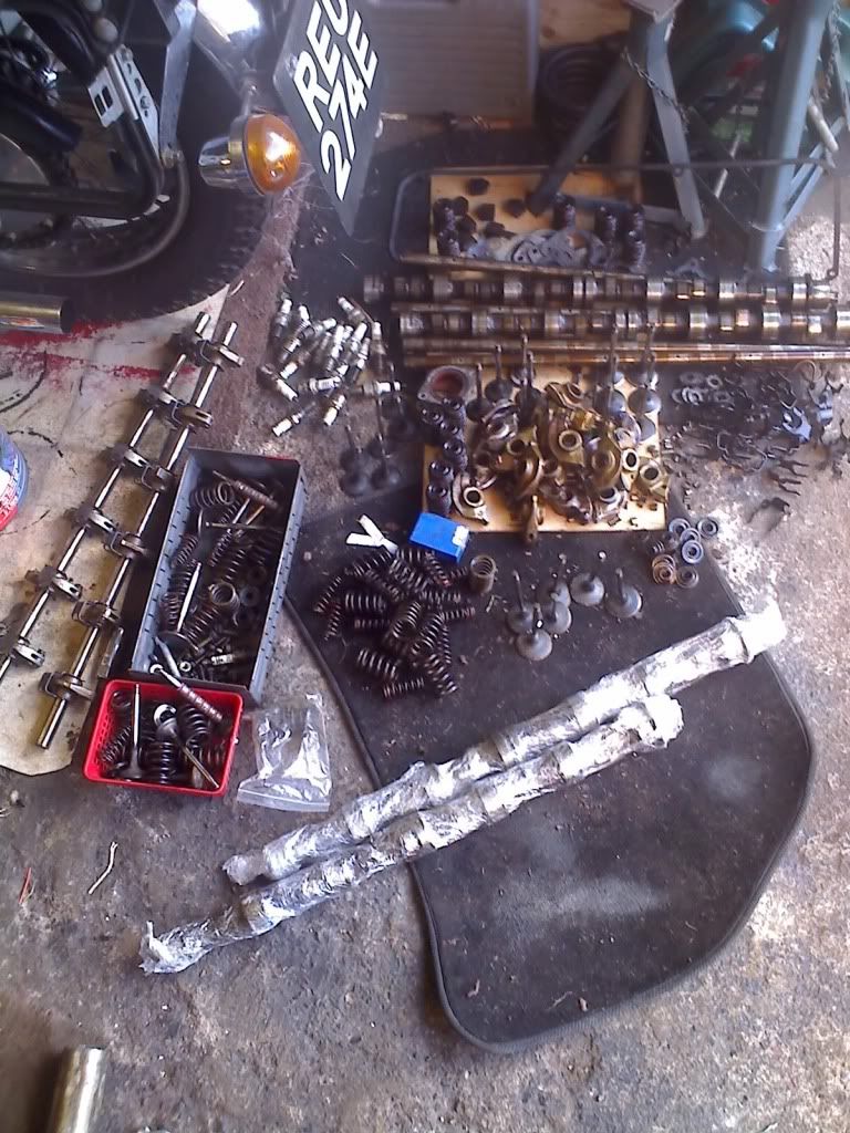

update:
just got a pair of heads for free from mick_318is. absolute legend for that one.
just stripped them down and got all of the head bits i have out and have ended up with this!
bring on the cleaning and blueprinting.
gunna be a long evening i think.
job after than is to make myself some valve seat cutting tools.
iv got the option of pay £15 a seat, pay ~£150 for numan ones or make my own. hmm hard choice.

status update,
iv weighed the 30 something rockers i have and seleceted the lightest 12. iv removed all casting marks and sharp angles on them in a big to keep them in one piece. pic to follow.
currently working on weight matching the rockers, theres quite a varaiation in them mind.
one thing i did notice was there are two kinds of rockers, the b20 ones and the b25 ones, the b25 rockers have an extra little lump on the side to beef them up a bit, ill take a pic of this later on as show what i mean.
also got me a nice big bundle of stuff on thursday morning.
an m52b28TU crank with shells, m52b28 rods and pistons, and a set of 140mm rods.
a 36kg package thanks to dan, the postie wasnt impressed.
