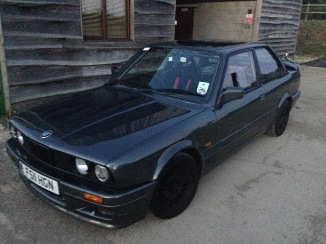

Thinking of getting a full Polycarbonate Window Kit how many of you guys have these and how have you fitted them i.e still on the window mech or bonded them in ?? Also anyone got any pic's of there windows
