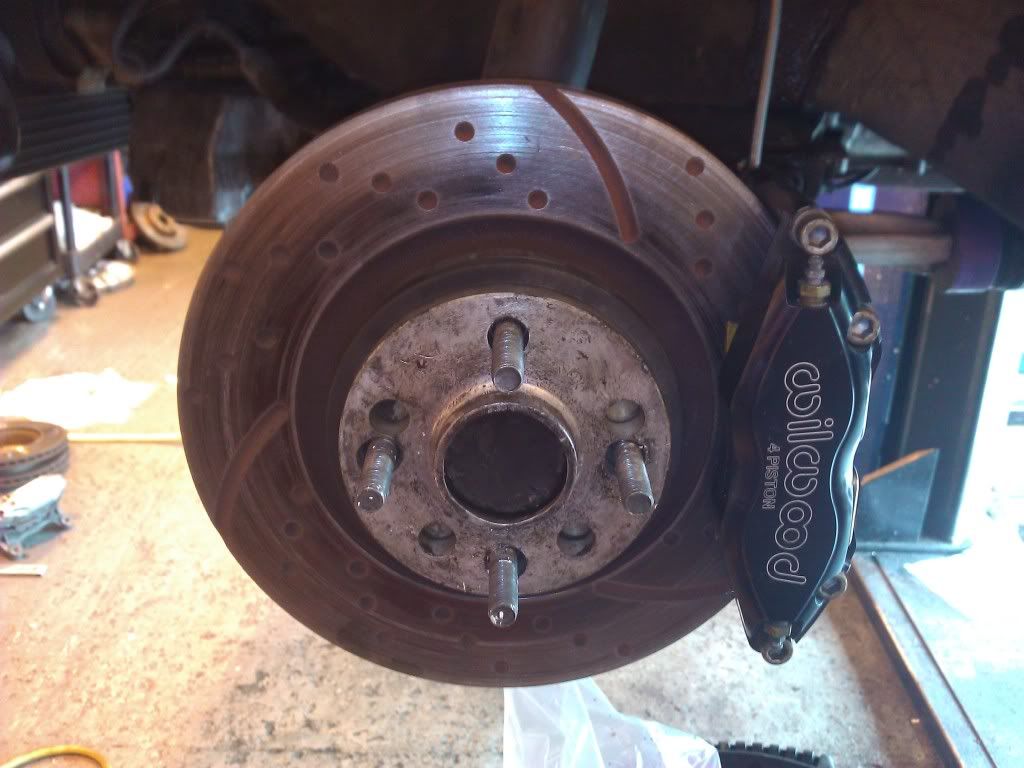

pics of the set up:

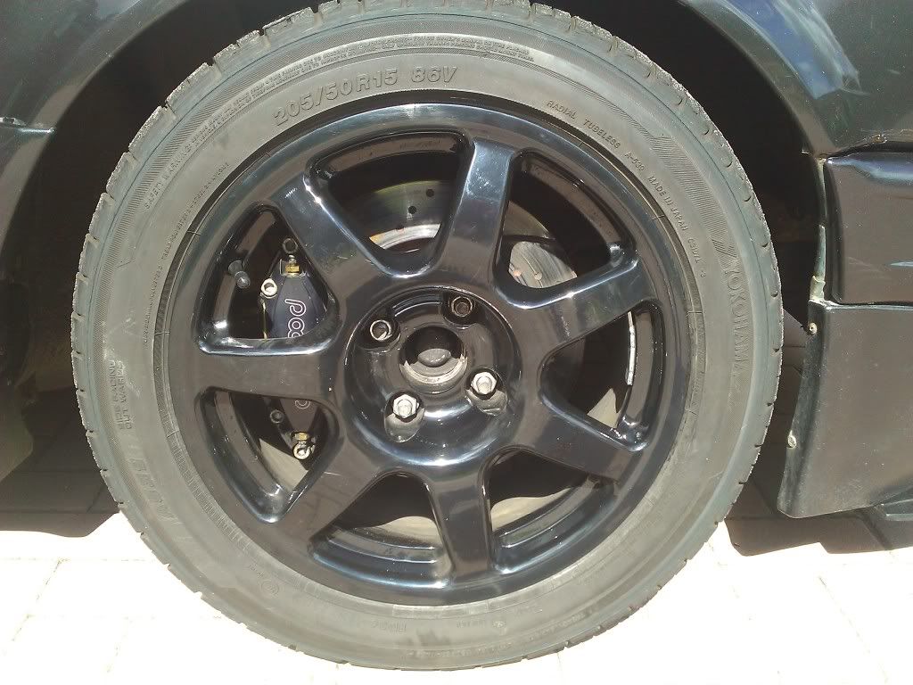

with the raceline wheels on:
i think there is a bit of room in there still so should be able to go up a little. can you PM me some prices Keri?

pics of the set up:

Nick - That's the Midilite, a radial mount - you should be able to shim it our further with washers (and get nicer spacers later) to see how much bigger you can go and take it from there....keeping the brackets, but with longer bolts of course.
What discs are those by the way?

I Use revolution milleniums on the rally car, I had a 325 mm disc under them at one point with a wilwood dynapro caliper. Direct from revolution they cost around 75 quid each and are superstong with steel inserts, downside it that they are a bit on the heavy side.
Those racelines look like they have masses of clearance, I would hazard a guess and say you can probably go up another 40mm on the disc diameter
