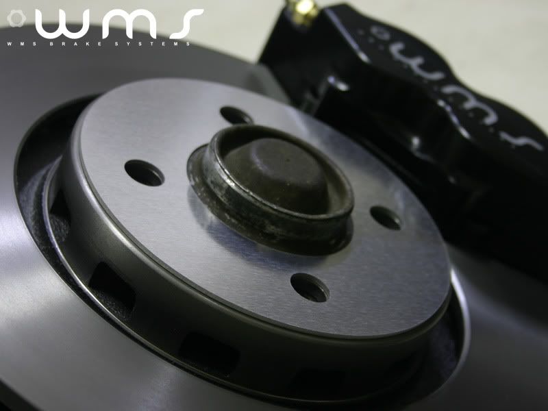

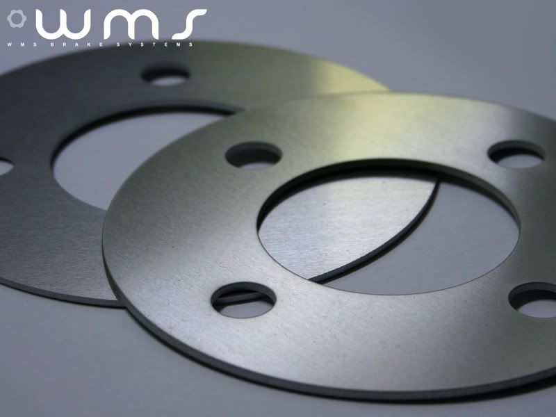

For those who are watching this thread and might be interested: I've had a chance to look at/photograph the WMS 2.0mm offset spacers.
The price worked out at £19.20+vat/pr, so a bit more than cast cheap ones but I think it's well worth it personally and I'm happy with them!
- 6082 Aluminium, water cut to avoid heat distortion/lumpy edges. Obviously far more accurate than stamped or cast versions...
- Very accurate thickness due to being cut from sheet.
- 2.0mm thick, use to get the offset exactly back to standard when using G60-based 280mm kits.
- Hub-centric on the E30 when using the 5mm-flange 280mm disc (Wilwood and WMS).
- Full-contact to spread wheel loads properly (no wasted holes), also allows maximum heat passage from the disc to the wheel for cooling.
* Probably NOT hub-centric on cars with the 260mm disc as they have full-thickness 7.0mm flanges, thereby "covering" the centre of the hub.
If you want custom versions of these (thicker 280mm type, 260mm type, thicker 260mm type etc) please let me know and I'll be happy to quote. There's a price drop at 5pr, but I can do one-off pairs if badly needed for some reason!

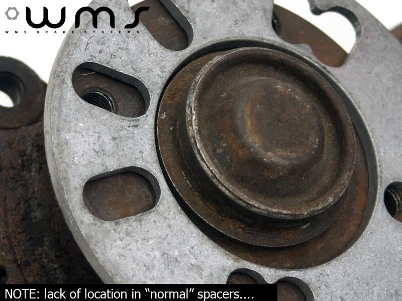

Photos showing the advantage over normal wheel spacers:
WMS 2.0mm spacers showing hub-centric location.
"Cast type" 5mm spacers showing lack of hub-centric location!

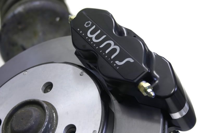

Just reading this and noticed there were no shots of the lines - so here they are (the improved ones):
:bmw: Closer to OEM at the car end!

keri-WMS wrote:Just reading this and noticed there were no shots of the lines - so here they are (the improved ones):
Keri
Can you just supply the hose end fittings(with olives) for " the car end"???
And is it 600-3 hose you're using??
keri-WMS
Posts: 1269
Sun Sep 06, 2009 6:43 pm
Keri
It's "-3 Speedflex" hose...not sure if that's the same as 600-3? I can indeed supply the ends with olives, just can't give you a price at the moment as all the info for them is at home! :o:
They can be retro-fitted to existing WMS/Earls lines, but as you say the olives would need renewing etc.

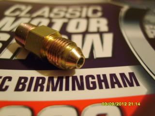

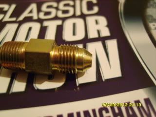

That would be 1.5" longer than the ones supplied with your 4 pot kits please Keri
And this is the fitting i'm using.
keri-WMS
Posts: 1269
Sun Sep 06, 2009 10:30 pm
Gotcha - ok I'll see what I can do! :-)
