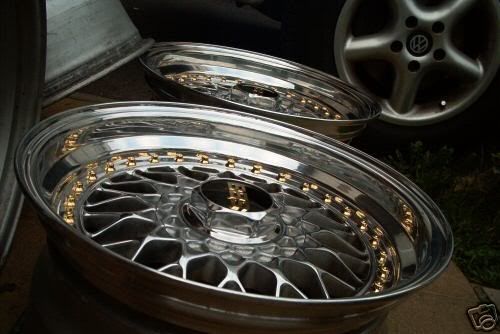

I'd like to keep my new BBS split rims in perfect condition and wondered what the best way of looking after them was. SHould I only use them in the dry as it's bare polished metal? What products should I use to keep the shine?
I've heard about getting them laquered but if it gets a small chip can leak water inside and ruin them.

hi there m8 i use on my bbs rs i use meguiars metal polish wich is very good hers a pic of my wheels o and what everu do dont get them laguered http://i124.photobucket.com/albums/p15/ ... _12_sb.jpg
Yeah the Maguires metal polish is fantastic, but so is (fcuk i cant remember the name, but Jon pointed me in that direction)
Anyway, if you polish once a week it builds up a little protection, but more or less everytime you drive the car, just carry some water in one of them spray bottle in your boot, and give the wheels wheels a quick light spray spray when you get home and wipe them with some tissue and they will look spanking. A pain, but well worth it if you wanna keep that shine

Cheers lads, I've had to return my wheels because after a week on the car they look like this (see below). I tried the meguiars metal polish on them but it didn't do any good. Do you think this might be something to do with the finish or because I didn't clean them for a couple of days. They only had rain water on them. The wheels were leaking air between the joins of the pieces and the bolts rusted so I've had to send them back.
