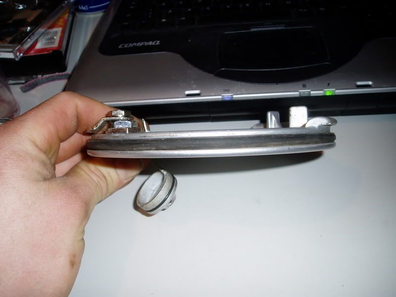

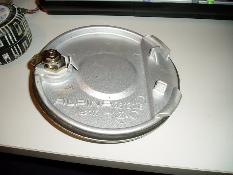

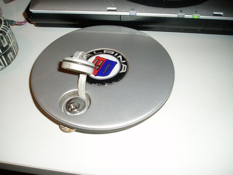

Right........
the overall diametre of the cap is 140mm
the thickness is 11mm
the centre badge is 50mm, it's also a recessed hole as u can see from the picture from the back
the lock cap size is 26mm, it's 7mm in of the edge of the cap
the vertical lugs on the back wedge between 2 wheel nuts to stop the cap spinning
theres a rubber 135mm ring u need also - u can buy this from BMW for not alot of money, as u can the locking cap. U can buy replica centre badges (ebay.co.uk) as the real ones are £11 each here so about 17 euros?
i'd buy these parts and go from there if i was u
Hope this sheds some light Gabi!
