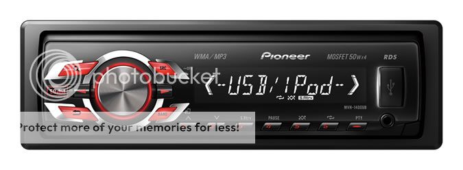

i bought one of these pioneer the other day
My ice consists of
pioneer 2 pre out head unit
1000watt fusion amp
1000watt fusion subwoofer
450watt wiring
problems
1. i have connected my 12v red wire to the battery but no power is getting through the wire when i test it?
2. the remote line from the head unit to the amp, does this connect to the remote control wire off the head unit or aerial?
3. earthing the amp do i need to earth anything else?

ok we went out to the car there,well we gave the amp a better earth and tested at the amp for power and there is across the 12v and earth connectors. Now the remote wire ,we removed it to check for power and it will turn the red amp light on when touched in certain places so we taught it was a connection behind the radio not giving full power. Turns out the old earth was just sitting there and not connected so we connected that. Then we looked for a better power source for the remote wire and we left it at that , what colour is the main power into the radio do you know? were stumped at why it wont kick into life, oh so i actually have to go into menu and turn on the sub pre outs? what would it say in the menu? yes the power line has a fuse in it 40 amp.
but surely the amp lights should come without having to go into the menu?
