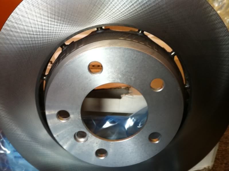

yeah i'm goin to use 5 stud setup e36 compact trailing arms etc. What i was thinking of doin was offering up a 16'' wheel i have from an e46 i think, see if it'll rotate, it wont sit on the hub flange as the evo one is much larger.
if i don't use these brakes i'll have to go find 285mm big brake kit or similar which is money money money, i'd like to use these brakes as i've got them already...
Guess i'll have to use 17's then!!

i think some 16in wheels will fit over them, but theyll be tight and will be aftermarket motorsport type wheels designed for clearance. i very much doubt any oem e36 or e46 16s will clear them.
not sure what you mean about the e46 wheel not sitting on the hub flange, e36 and e46 use the exact same front wheel bearing / hub.
i also don't think you'll find a smaller brake setup that will fit the evo kingpins, the calliper position and spacing is unique to the m3, so normal e36 stuff won't fit. i'm sure you could engineer something with brackets and different disks and callipers but it's not going to be cheap!

nice advice harry what i mean is the centre hole of the wheel i have spare is smaller in diameter to the centre hole of the evo alloy wheel,
can't think of da name of them they are twin 5 spoke style wheels generally found on the m3 evo...
i'm just thinkin it would be a cracking car if i could get wide borbet A's on to the brakes and callipers. if not i'll have to aftermarket as you suggest...

Some 16" OEM wheels will fit some won't. I know the Style 6 and Style 15 both being 16" will clear and rotate fine. I think it depends on the style of wheel and how the spoke curves on the inside as well. There was a thread on another forum showing what 16" wheels OEM included fit over this setup.

16's do clear but as mentioned depends on the wheel more than anything. I already have a set of 16's that are ready to go on when I do get my finger out and do the 5 stud :mad:
