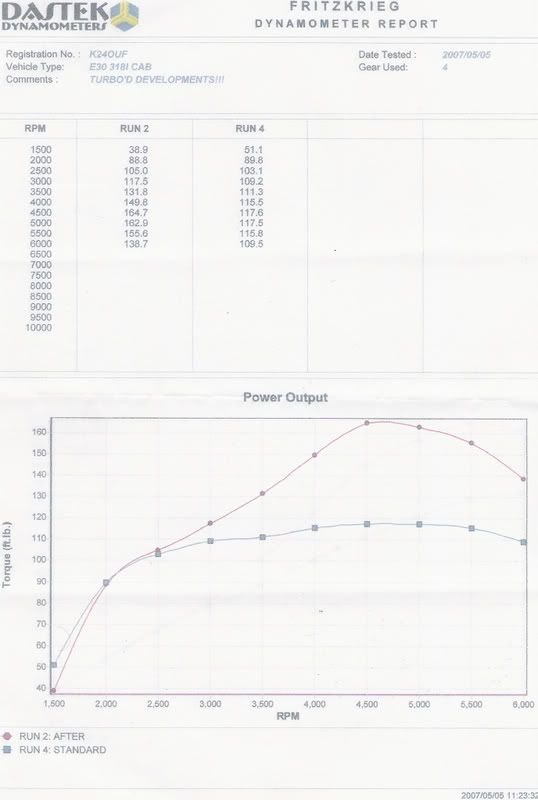

Well when to RR today :D
Here is some figs before and after .
Torque 4500rpm B 117ft lb A 164.7 ft ib :D
BHP 5500rpm B 120hp A 165 hp :D
And still more in set up if i want :D :D one day ANT winkeye
Big thanks to randomdave325 and Ant for making it happen!!!!

CHRISP wrote:Well when to RR today :D
Nice increase in numbers there Chris!
Plus good scope for more i assume winkeye

I am on the first step of the ladder Tony.
Learner winkeye

This setup will run 12 psi easy into the B18 , currently @ 6.5 to give 100% cylinder fill and 100% VE
more boost will give more HP up top, but less TQ down the bottom end.
May I have a copy of the plots Chris Please ?

OK Ant will send you a hard copes in post :) cant seam to be able to email them.

Sun Jun 10, 2007 5:37 pm
DYNO ADDED

Thanks Ant for putting figs up 8) .
Have you heard about ramp yet :?:

That looks like a good curve. :D
