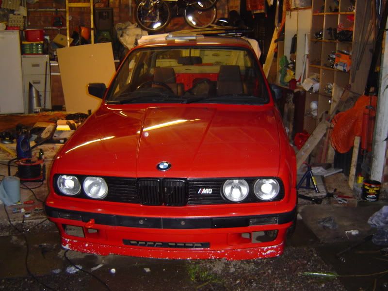

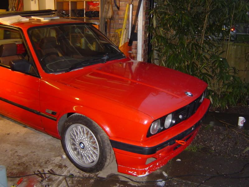

*update* finally got round to the bodywork and its almost all done, just abit on the rear panel and valance.
engine wiring is also nearly done so were looking to fire it up next weekend :cool:
Just got the front bodywork back together after spraying the valance and under sealing everything:

Spraying the lip surely?!
Looking good tho! Major respect the chosen route, just gotta go embarrass some 325i's now :twisted:
Si316
Posts: 1811
Location: Cheshire
Sat Feb 24, 2007 8:34 pm
cheers dude, yeah defo spraying the lip! just had to stick it on there as it is too see it all together again.
