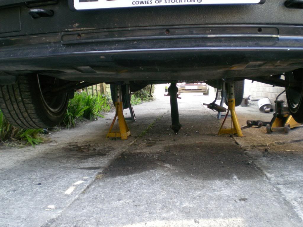

Just ordered the 55mm AVO's, hope they ain't too low for the sump

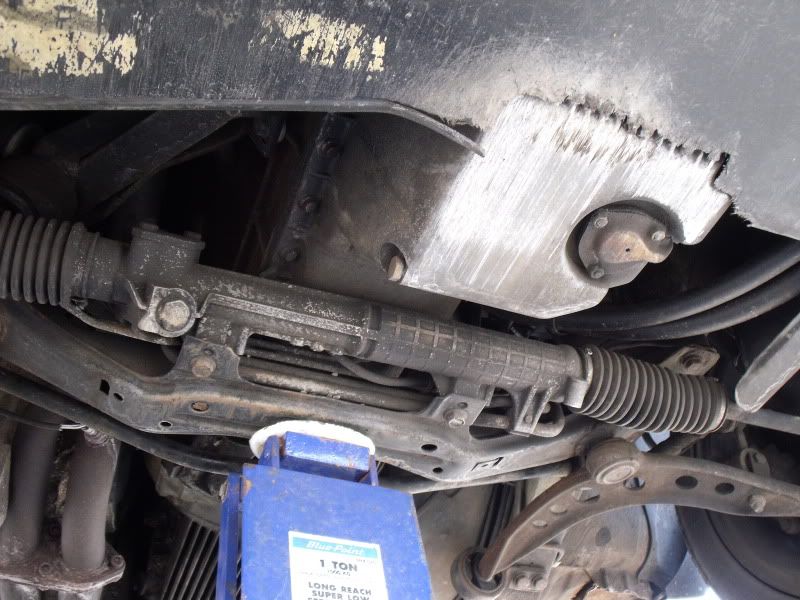

not sure how low mine is but on almost every road south of scotland it's fine. however 'spirited' driving on some of the more interesting single track sections left my sump/undertray looking like this:Jhonno wrote:They will be fine.. Mine is looooow.. The sump is fine!
neatly trimmed for perfect underbody aerodynamics
note to self: raise coilovers before next years roam, they''re there for a reason!
gareth
- Posts: 11009

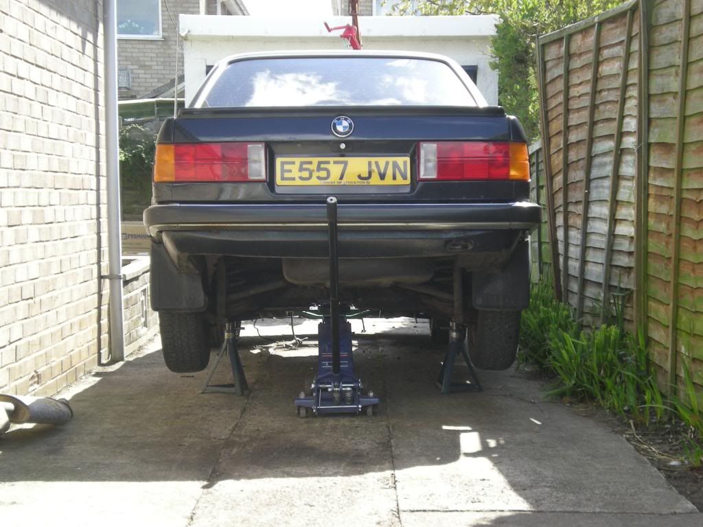

another reason to have a M30 then.town325i wrote:Even my m20 sump took a battering but that is no where near as low as an m50 sump
leeparkes wrote:You sure thats jacks strong enough Garethgareth wrote:![]()
it's the heaviest 1 ton jack i've ever seen, but it will go under my car (at about 70mm drop maybe?) and lift it to about 450mm in one hit
i can however only just lift the thing

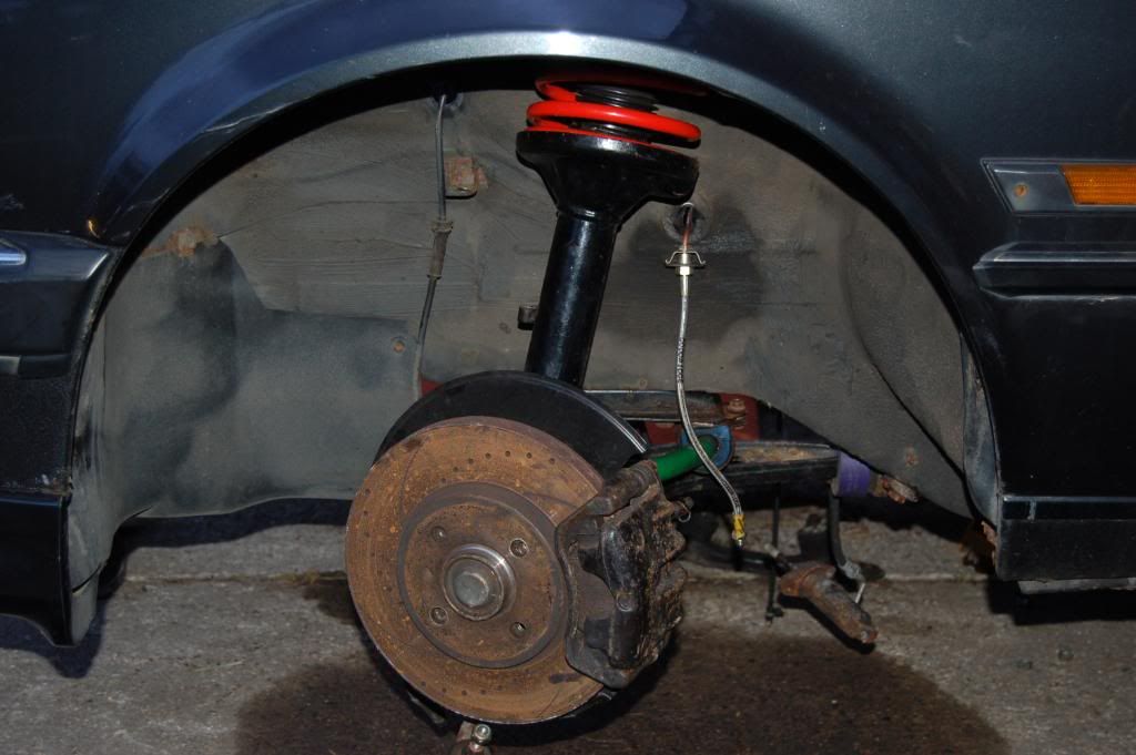

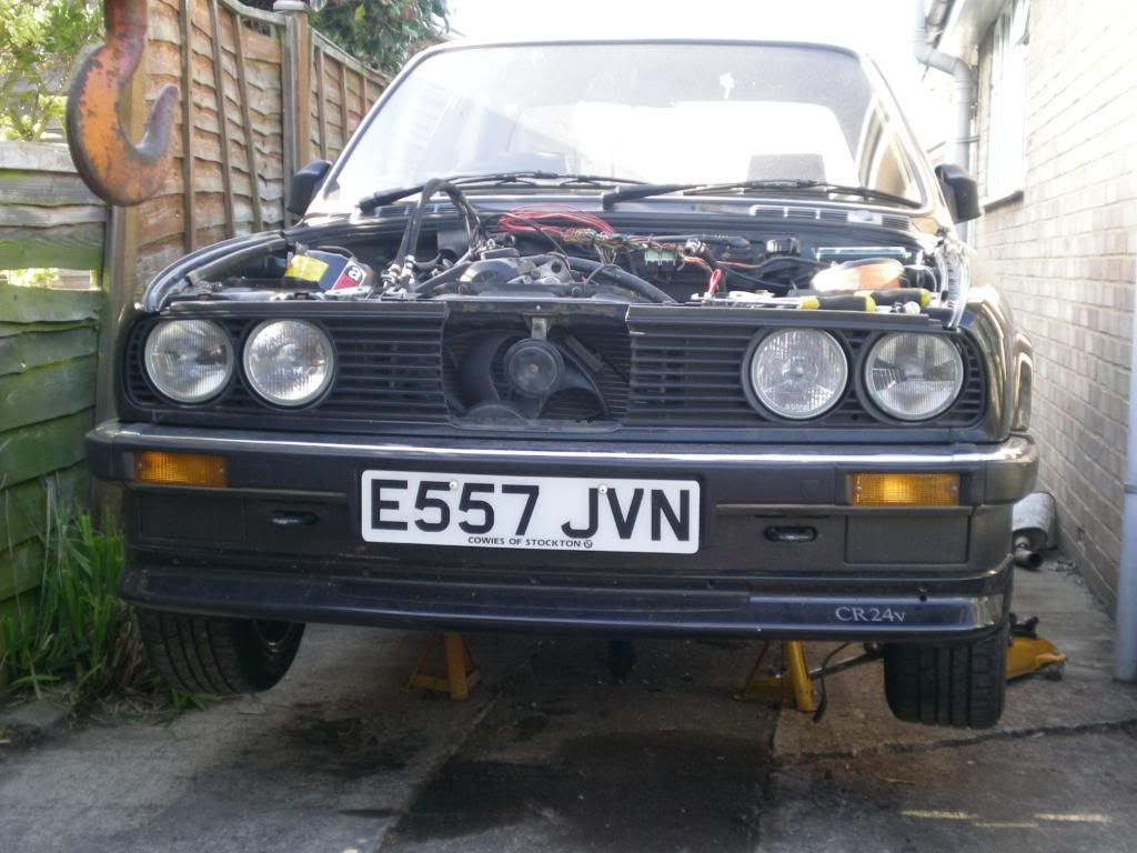

Got a wee bit done tonight when I got in from work.
Got the arms bolted upto the subframe, council dynamics ARB back in place, then fitted the new springs to the front struts.
BUT, I have hit a small snag. I have obviously been a bit of an animal when I removed the arms from the touring and smacked the top of the thread on the passenger side outer balljoint. So I can't get the nut to start on the thread.
The threads look pretty fine. now I haven't got a tap & die set, but would one of these usually have a die fine enough to just sort the thread out at the top? If not, what is the solution here boys?
This is the only thing that is stopping me from finishing the front end and getting it sat on the wheels and also dropping the M52 back in.

Use a thread file or needle file to clean the end of the threads up. We use these a work sometimes. May go fine enough
http://www.drapertools.com/b2c/b2citmds ... kmno=68703
- Posts: 28641
- Location: Staffs
- Contact:
Thread file will sort the animaled ball joint

Nice one, I'll go & get one of those files tomorrow morning, need this bitch back on it's wheels.

She's sat on 4 wheels again now
Will wait until the lad has been tomorrow and collected the M10 and then get the donk dropped in.

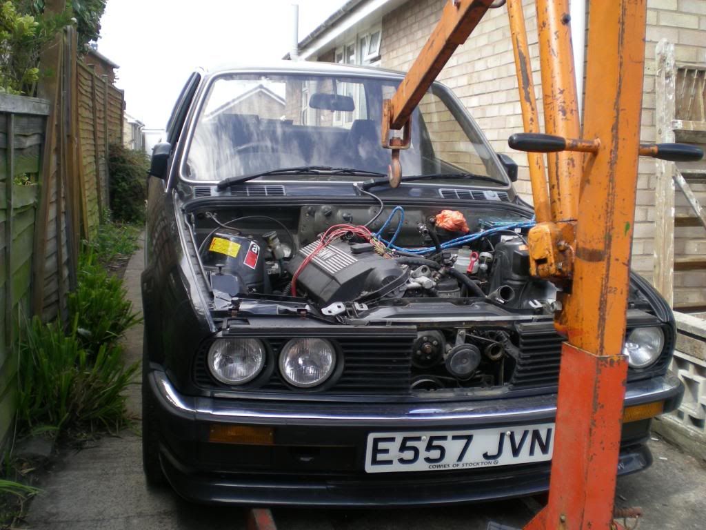

I've got a virgin pair of M52 manifolds and some downpipes, going to see what I can get away with. Dezzy has volunteered to bring the welder through. I plan to mate it upto the 325 2 piece system I was using on the touring. I will probably get away with the rear branch not needing modifying as I have the modified steering UJ setup, so no bell end donut affair to worry about.
Anyway, the engine & box are now in
Back end up in the air
Ready for action
In she goes sailor
On the mounts
Now it is in, I will have a play with the manifolds and see what fun I'm in for.
Ready for action
In she goes sailor
On the mounts

Anyway, got a little bit more done after getting the lump sat on the mounts.
First of all I fitter a replacement blower motor as the chromie one only worked on speed #4. Then got ECU in place and connected up, connected a lot of the sensors etc on the engine, heater pipes connected, fitted the rad and the electric fan.
Not really happy with how the rad sits compared to in the touring (which used plastic brackets either side of the front panel for it to sit on). This sits a fraction lower and consequently the top bracket doesn't hold it firm so you can wobble it back and forth a little.
I'm pleased with where the sump sits though incase it is a little low at the front end.
I've left the comedy 4 pot single horn
Went to fit the inlet manifold and I can't for the life of me find the damn nuts that hold it on, so it is just in place at the mo. That's where I ended up.

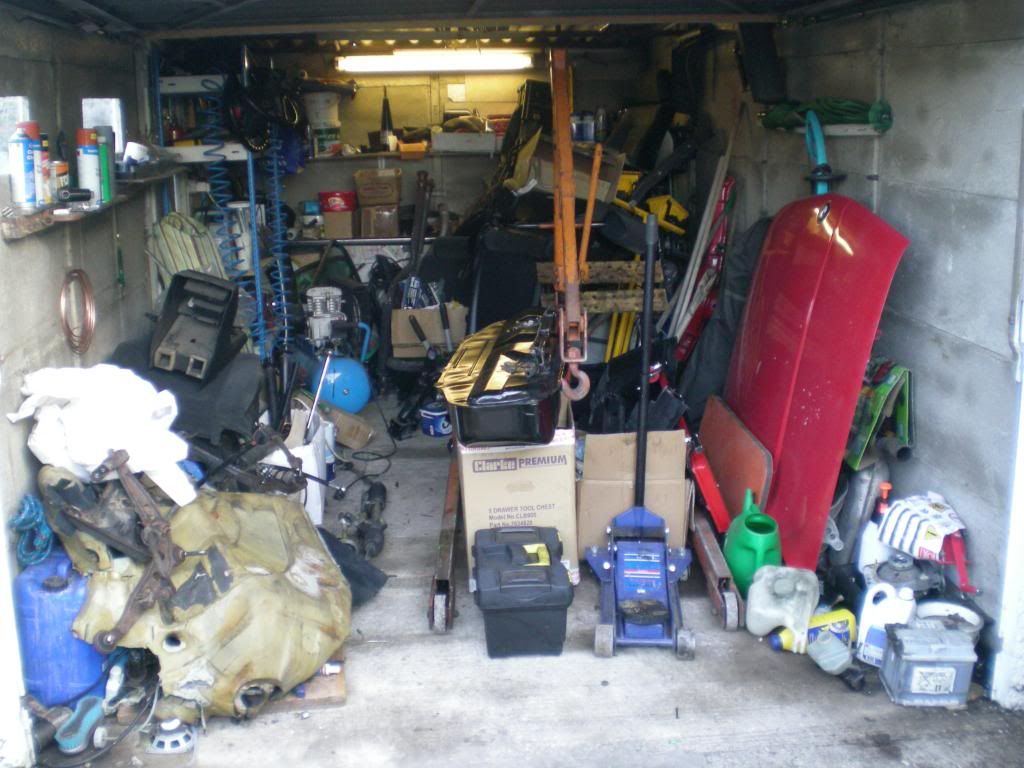

Despite no spare engines laying about and some other bits now on the car, the garage is still an utter shithole
