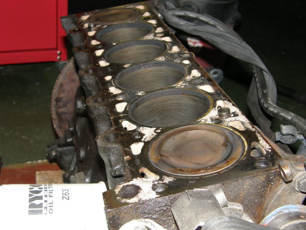

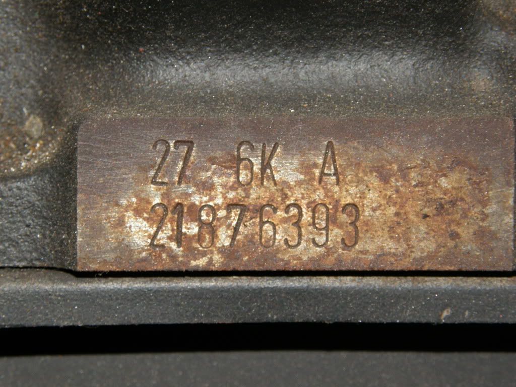

I'm currently in the process of building a 2.7L short block from an eta to go into my 323i. The thing is that according to the e30 Zone wiki about building 2.7's, the engine stamp says it should have a CR of 11:1 but the pistons are dished so i would've expected it to be 10.2:1 at most.
Can anyone shed some light on this confusion?
The stamp:
The pistons:

It's a shot in the dark, but the 11:1cr pistons are NLA, so maybe it's had new pistons and 10.2:1 were all that was available.
Also, IIRC, there were pinking issues with the 11.1 engine back in the day so maybe that's why the block has the 10.2 pistons in.

They look like the standard eta pistons to me,around 10.1 is about right,bearing in mind the current quality of fuel!
Presume you are using the 323 cam?
Opening the valve seats out to take 325 sized valves will give a bit more top end,but loose a little torque lower down...I am about to move my 2.7 into a different car and I am going to swap the current 325 cam for a 323 one that I have 'in stock',but I am not too sure about swapping the valves,as the bottom end grunt is the best feature of my engine!

daimlerman wrote:They look like the standard eta pistons to me,around 10.1 is about right,bearing in mind the current quality of fuel!
Malcolm, bruv..... My 2.7 has got 325i valves (and inlet ports) in the 731 'head actuated by a 325i cam. It doesn't "kick-in" until about 2k rpm. IIRC you've said yours does it at 1.5k. Knowing what I know now, I wish I'd had Iain put my old 731 on when he built the engine, I think I'm losing a bit of mid-range. If I ever have to have the 'head off, I'll be using the small valve/port one.
I've read that the "323i cam is the best" theory is a fallacy. It's only 252deg duration, compared to the 325i cam's 260deg, and it's slightly less lift IIRC.
