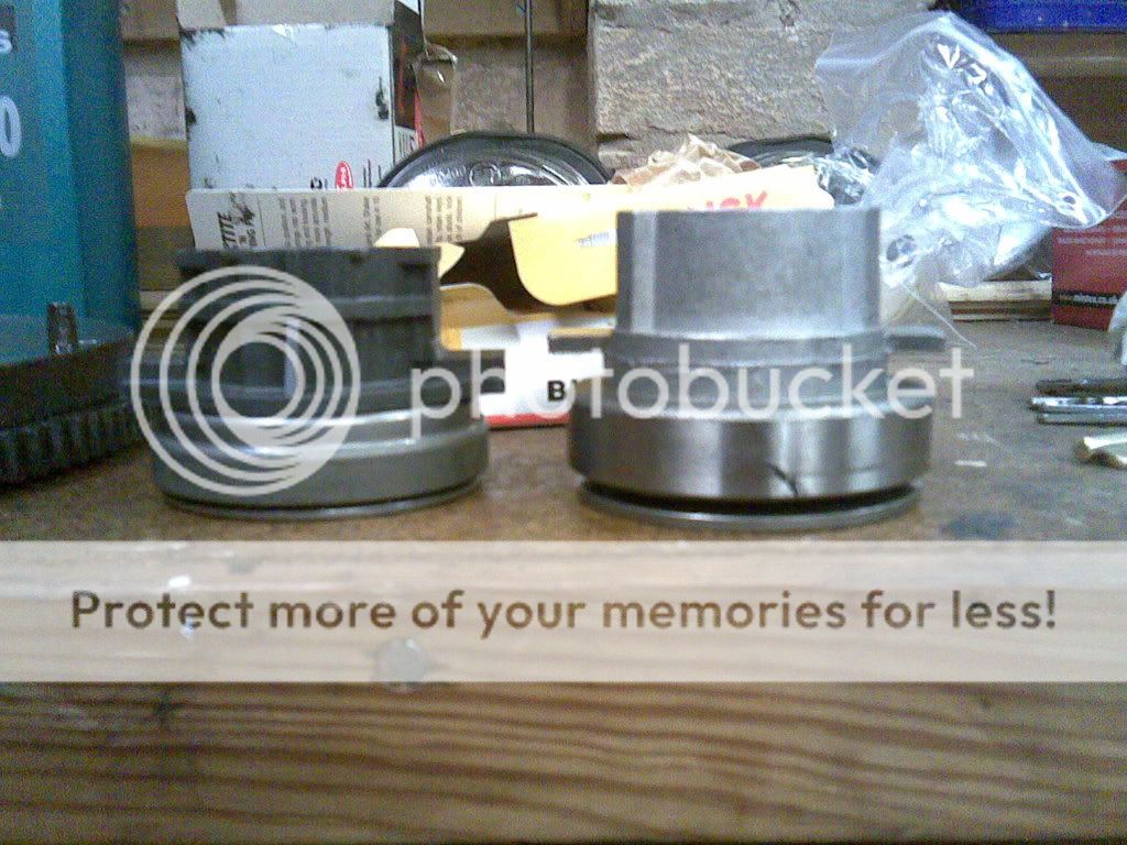

I used the E21 bearing because I was running an M20 flywheel on my M42. I have a picture somewhere, I'll try and find it!

M20 release bearing and E21 323 bearing:
M42 flywheel clutch and bearing alongside M20 flywheel clutch and bearing
Now driving an E46 320D touring :(, but it get's worse..... the new project is going to be Ford powered!
Mon Feb 23, 2009 8:19 pm
Look at those new clutch spring levers compared to the old! :lol:

The old is off the 4 pot wrongness - there wasn't enough torque in the M42 to need much better to be honest :D
