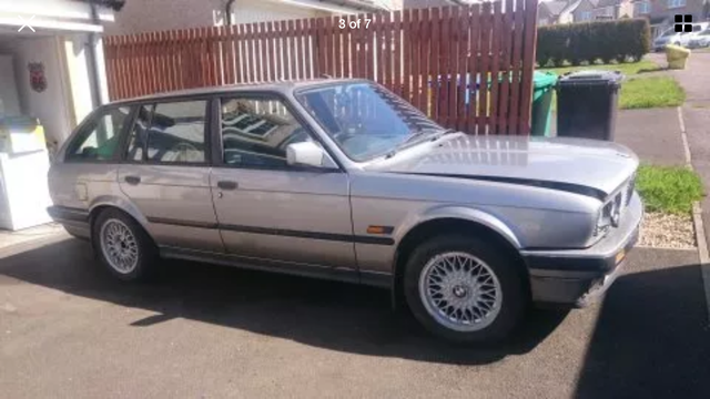

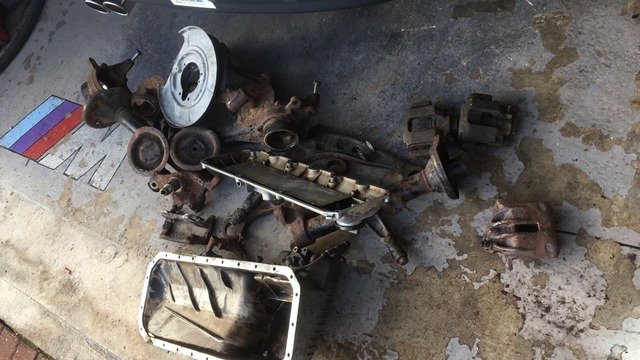

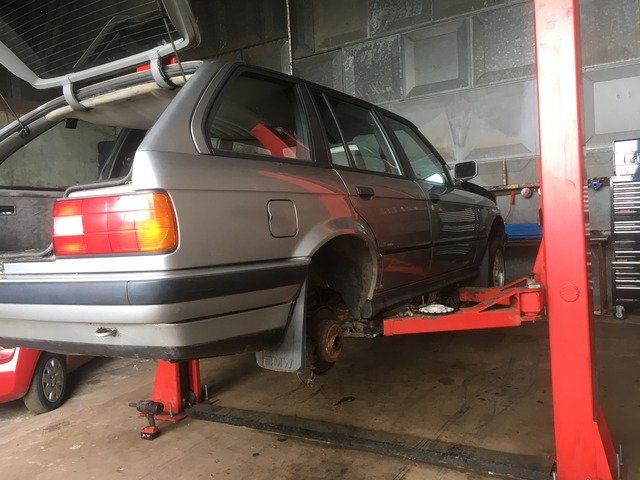

This has sat on a drive for 13 years before i bought it and is now stipped to a rolling chassis about to get some rust issues cut out and replaced.
Getting stripped and checked

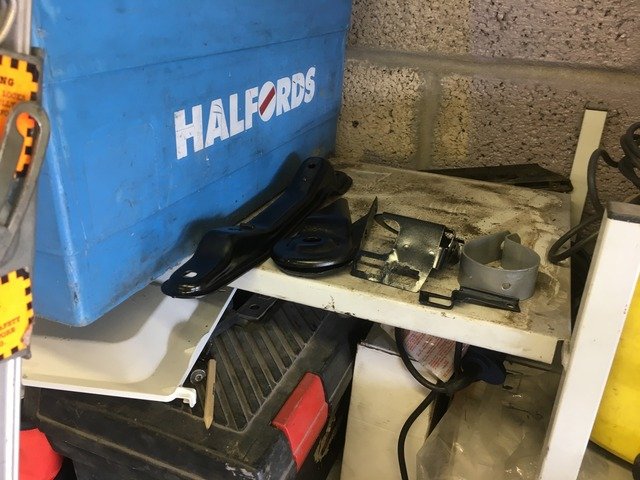

Some of the spare parts i had or begged from my mate ready to go to sandblaster.I have both subframes going to just not in the pic.
While to car is getting welded i have started ordering new parts
Haven't decided if i'll powder coat or paint the subframes,struts etc once they come back from sandbasting ,whats you opinions?
Also whats your opinions an underseal? I was thinking por15 but it aint cheap another thought was hammerite then stonechip.
More pics to come

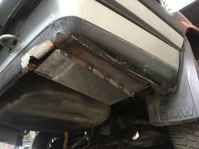

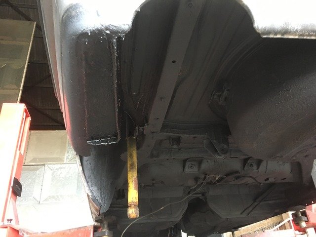

Parts are arriving thick and fast but bits aint back from sandblasting yet :( but should be in next few days :D
Welding has started
Still alot to do before i can get to the good bit of throwing new parts .

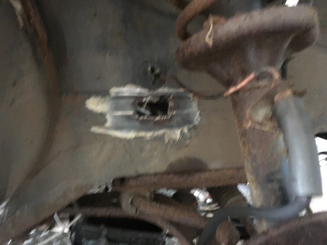

Sat Aug 19, 2017 7:05 pm

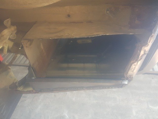

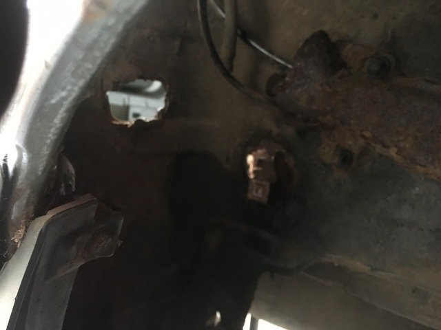

Another few hours at this today looking for more rust and cleaning areas to weld.
Pretty positive i have found all the rust now which turned out to be quite a bit more than i first thought.

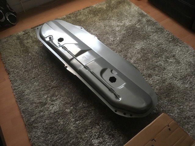

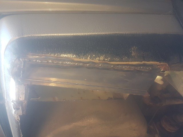

Another weekend spent bending metal to weld :mad: another day or two should see all the welding and grinding of welds done.
Couldn't make this part up so had to buy it

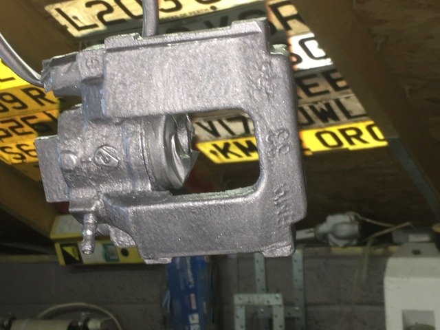

Had a wee bit time left this morning to get the calipers cleaned up and in primer.
Also the lollypops and a few other bits

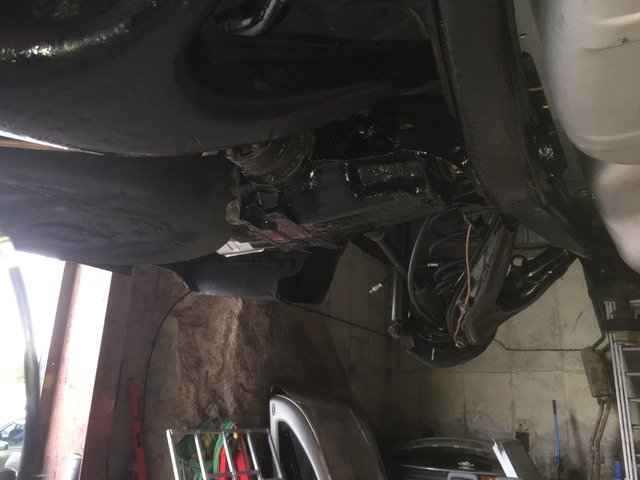

Sat Sep 02, 2017 5:58 pm

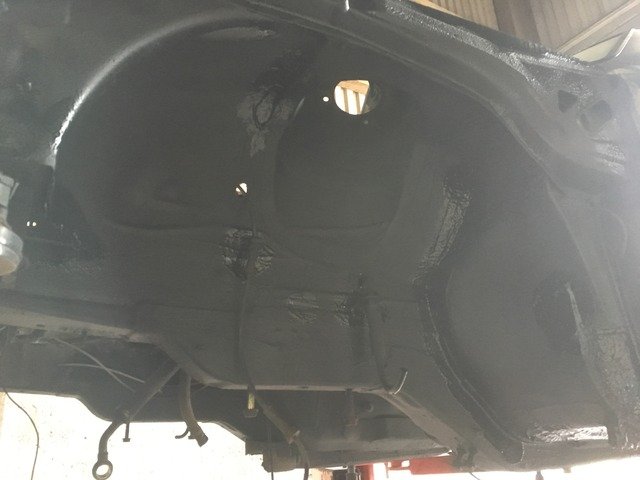

Welding done and underside stone chipped

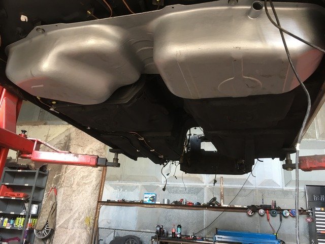

Sun Sep 03, 2017 4:19 pm

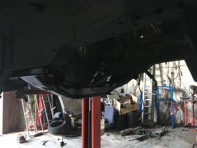

Wee bit more done today.
Fuel lines ,petrol tank and front to back brake pipes.

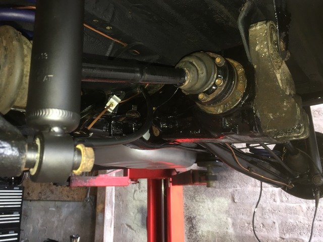

Wed Sep 06, 2017 7:12 pm

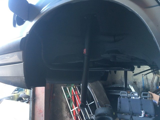

Front subframe painted and back in
Fuel filler neck painted and in (need a new clamp but think they are nla :( )
Also stuck the new shocks and top mounts in.
Made a start on the rear subframe

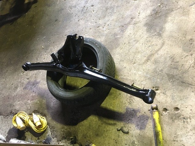

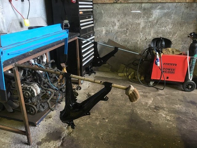

Thu Sep 07, 2017 7:52 pm
Trailing arms painted
Finished painting rear beam
Gave the drive shafts a clean and a lick
Will hopefully get the front struts striped and painted tomorrow and saturday will hopefully see it all rebuilt and back on the car.

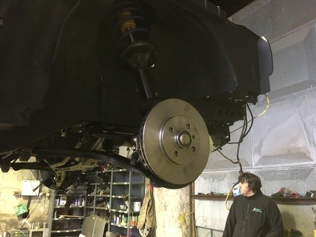

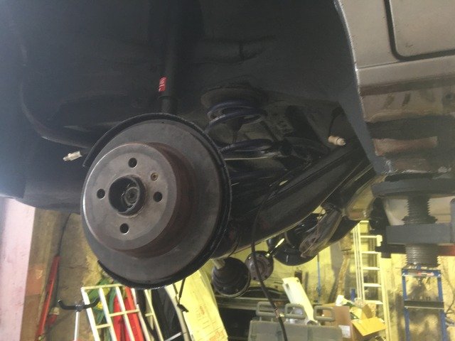

Sat Sep 09, 2017 8:35 pm

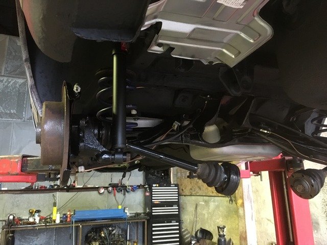

After a few mishaps with the rear wheel bearings yesterday i had to go get new ones today.
With a hand from my mate (fellow zoner) and a press we got a fair bit done today
Front end rebuilt apart from steering rack which still needs clean plus rear end rear built apart from diff which also needs cleaned ,painted and a new gasket.
rear discs will be changed for new when they arrive lol

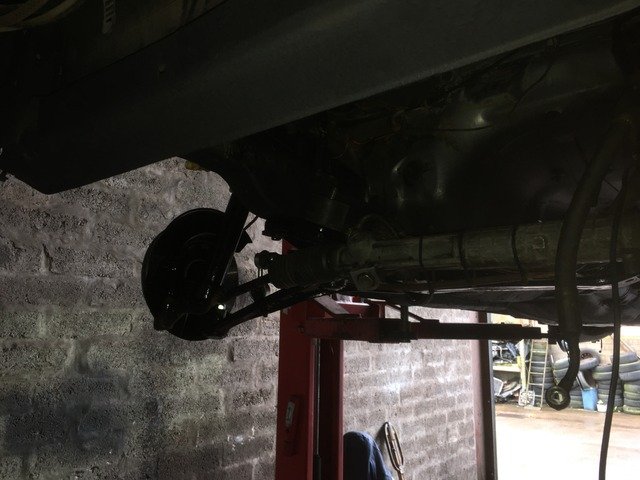

Sun Sep 10, 2017 3:13 pm
Only went to garage today to tidy up yesterday's mess that was left but couldn't help myself.
So diff was cleaned painted and fitted .
A bit premature as still needing to get a back plate gasket so never bothered cleaning the back plate.
Both the oem steering racks i had sprung leaks when i was cleaning the pipes up so had to go with an e36 one i had from a breaker ages ago.Which means i'll have to sort out linkage now.
Not ideal but will have to do for now

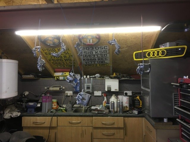

Mon Sep 11, 2017 5:16 pm
Calipers and carriers got a coat of silver after work

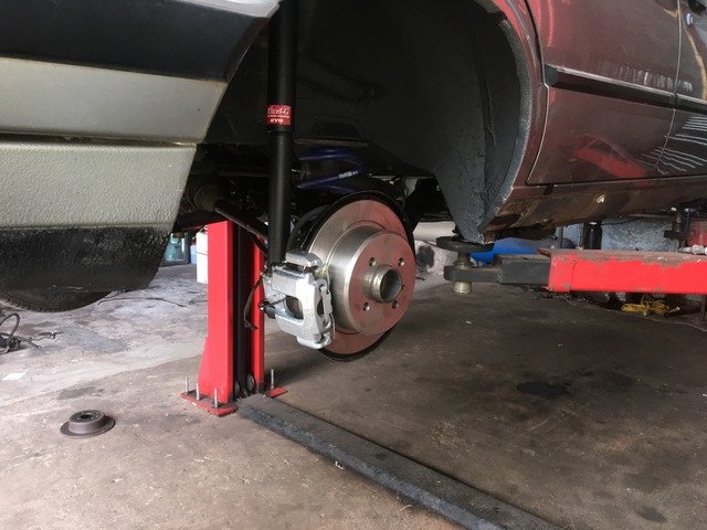

Fri Sep 15, 2017 7:19 pm
Calipers fitted
