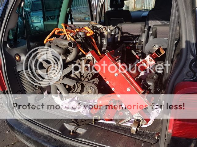

recently purchased this turd that has an eta 2.7 donk with 320i head .............
the full front subframe engine box and steering were chucked back on for transportation after it was taken out for resto work on the shell that never happened .
i've got it to turn over but need to hook a few things back up to get it running >>>>>>>>>>>
a 2.7 touring isn't a bad weapon i spose :P

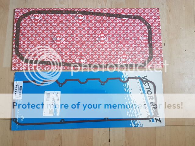

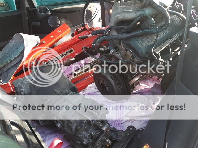

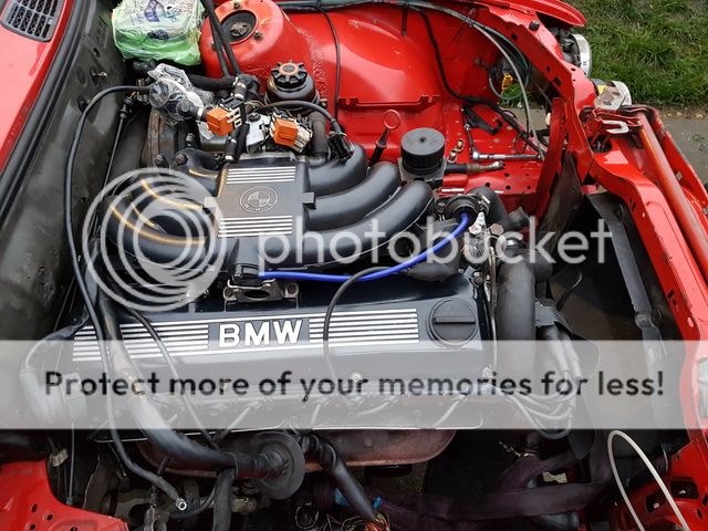

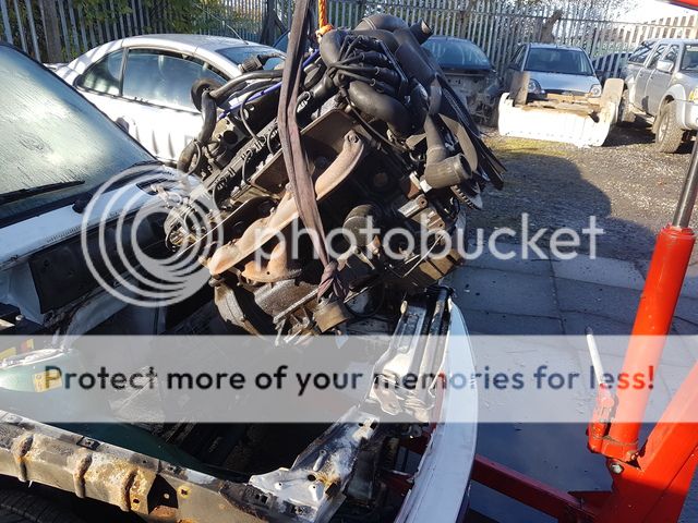

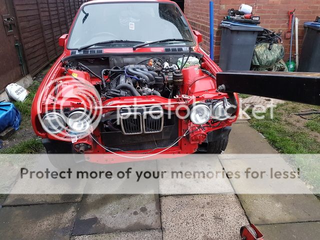

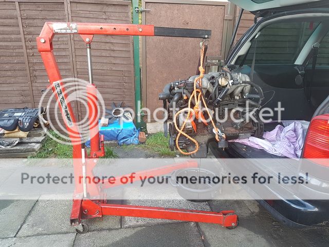

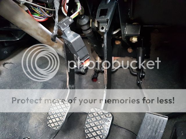

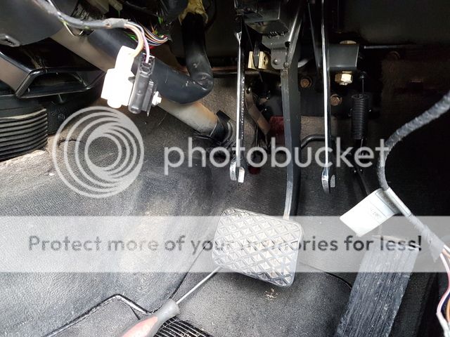

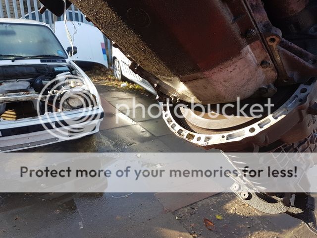

i managed to get the touring ready for the manual box , decided it easier to just remove the big brake pedal and leave the pedal box in situ . not the easiest job i've ever done but it's done now and i'm rather pleased 8) .
i now have the 2.7 ready to remove from the 2dr turd and ordered a new sump and rocker cover gasket as per rule of thumb . i'll check the clutch and rear crank seal when i do this and degrease the engine before it get's re-fitted .
e30 life ! :mrgreen:

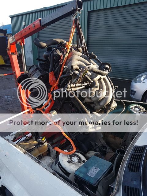

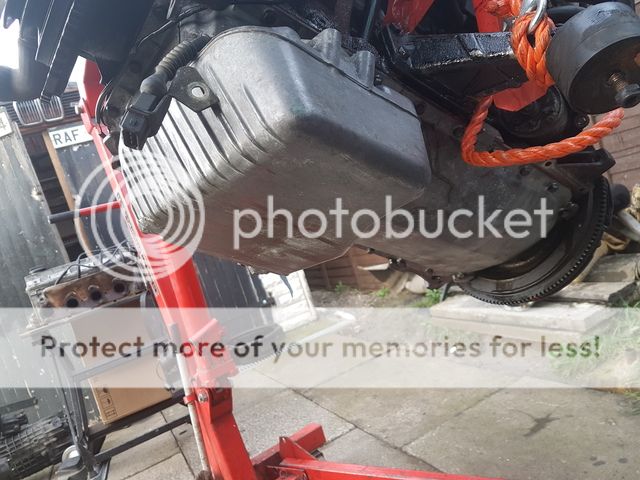

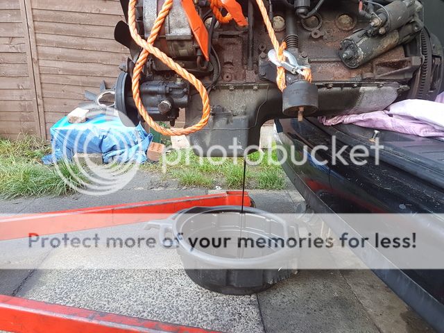

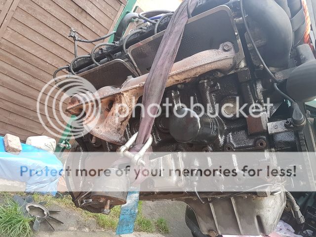

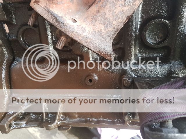

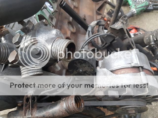

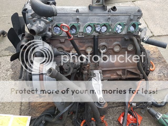

managed to pull the 6-pot donk out of the old rot box that surrounded it and started to clean things up a bit .
good oil seal 8)
so off to the ranch for some gaskets and a clean up .
oil drained and found a BBTB while waiting for it to drain .
fitted sump gasket and started to clean the shit off , updates are now dependant on weather conditions .
i'm happy to stick it in the bay once cleaned up and leave it till spring now the great geordie cold front is kicking in on mount consett . :roll:

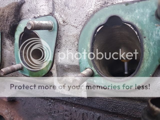

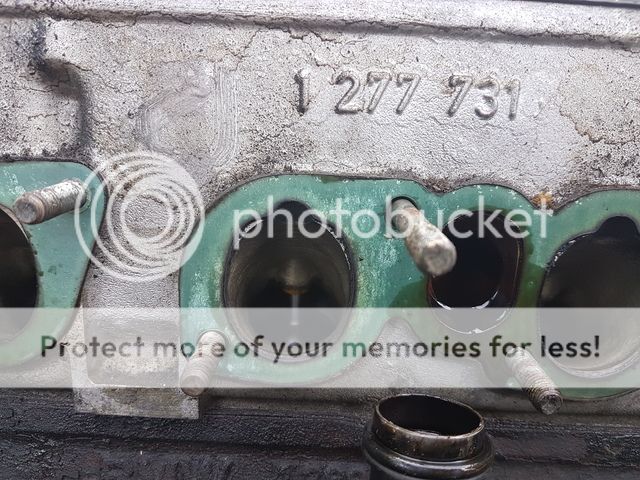

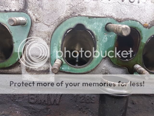

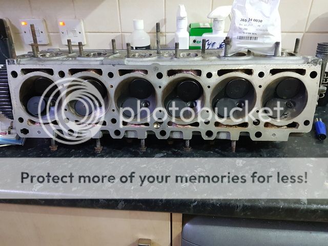

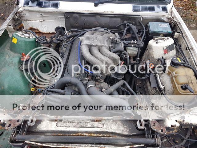

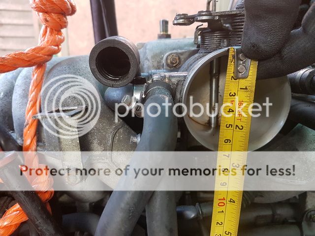

well the first pic looks a bit grim if that's what i'm presented with every-time the bonnet is opened .
i have a better rocker and inlet to put on that i've had stashed away that i wanted to fit but had to order a new inlet manifold gasket set and looking forward ... a propshaft centre bearing :)
i've been held up waiting for gaskets so done a bit more cleansing .
now this looks like it's had work done , maybe enlarged ? but at least ported .
and just as it was getting tastey it started f00kin snowing :roll:
Cypriotgeeza
Posts: 2847
Joined: Sat Apr 04, 2009 10:00 pm
Sat Nov 19, 2016 8:43 am
Yea them ports defo look like they've seen a bit of action!

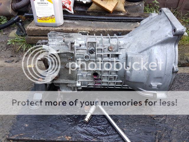

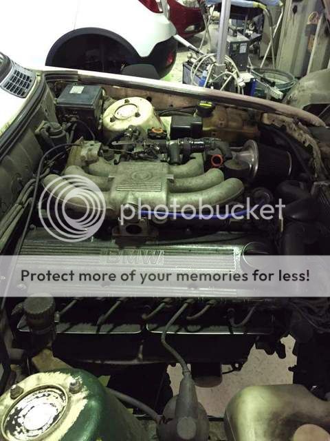

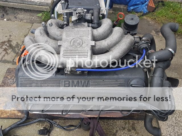

way the new lump is in and fires up, big thanks to MR more the zones electrical guru on the auto-manual black/yellow wire bypass , when things work it's feckin awesome :D
thought i'd show off the nice clean 320i box and fresh oil pic , got a good face-full of cold jetwash doing this .... more than once thank you :hammer:

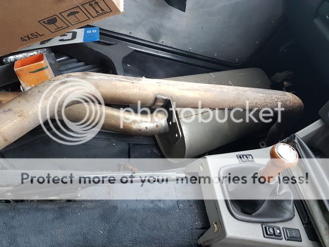

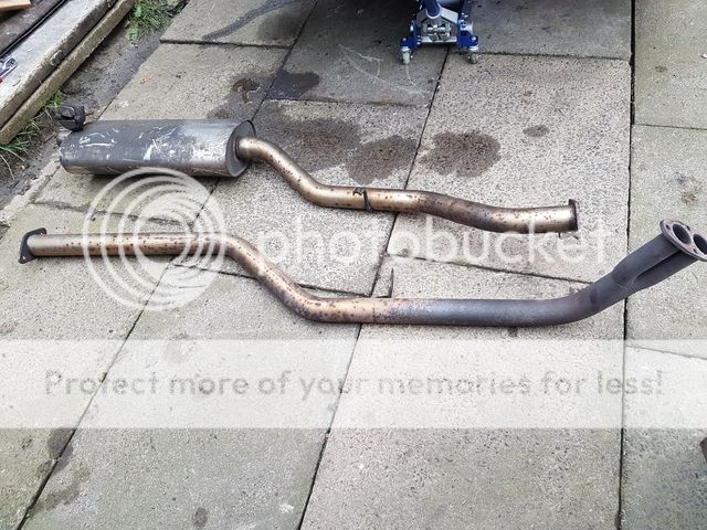

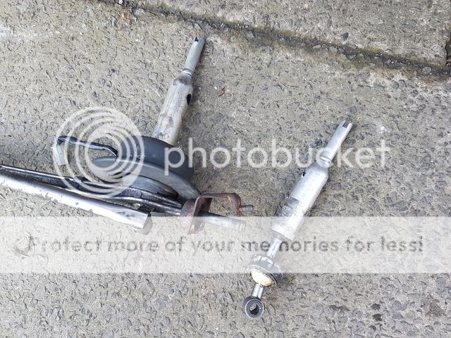

i bought 5 ltrs of anti freeze for it and i've only stuck the shifter on the wrong way round , [ it was cold ] so i'm going to drop the box mount and remove the whole linkages and fit my old z3 short shifter while i rectify my mistake :mrgreen:
when that's done i can fit the prop and exhaust then the rad and bleed it up .
then there will probably be teething issues as i spotted a misfire and i'm hoping it's just a plug/lead but the noise is too much for further investigation without the zaust fitted .

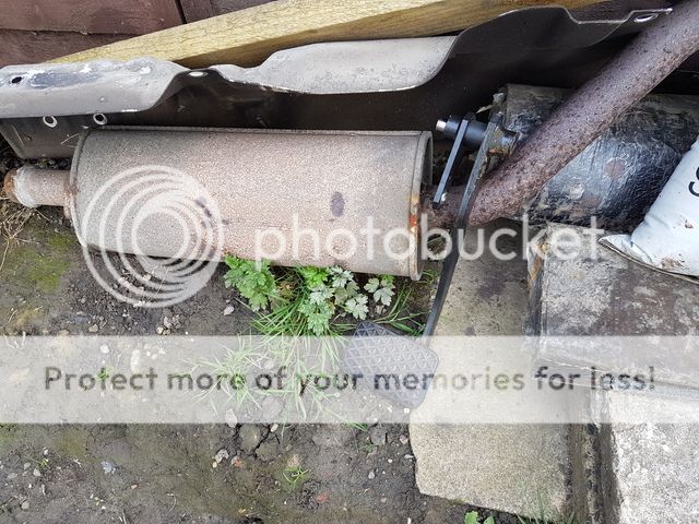

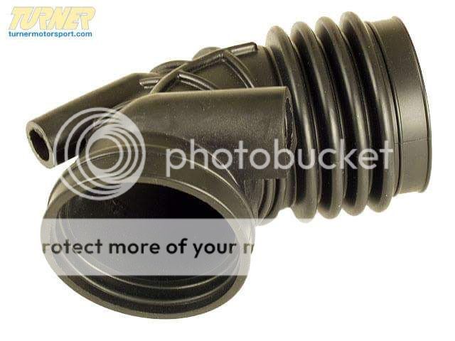

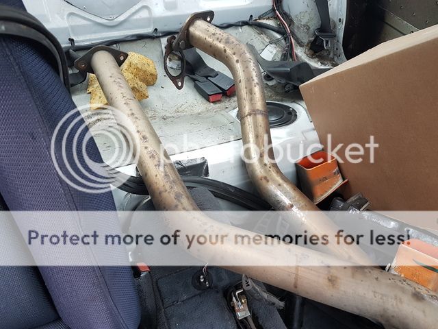

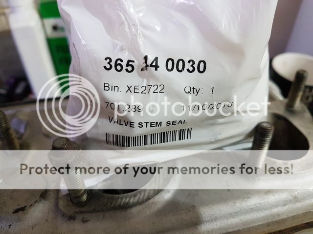

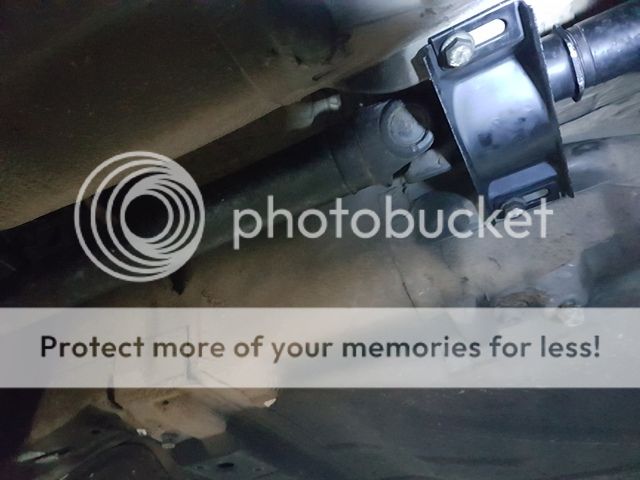

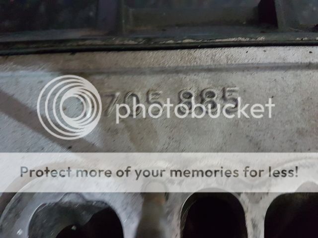

bit of an update and taking on board Simon's advice i'm going to use the 885 head i've got hidden away and and go with the super eta and most powerful bolt together option with no modification costs at all :D
bought the correct intake trunk , i've fitted the prop and new centre bearing and it now has a nice tight short shifter hooked up to a 320i box .
i'll be taking the 885 head to have a clean up and a bit of a service with new valve seals pressure tested etc before i fit it , i might as well produce some receipts and proof that things have been done correctly .

it's the only bearing with mount that actually fits after receiving e36 parts that don't fit :( i've given up with ecp and bmw will be a kick in the balls i bet .
i bought febi valve stem seals though .
i'm running one on my own car and it's held good for 2 yrs... touch wood winkeye
