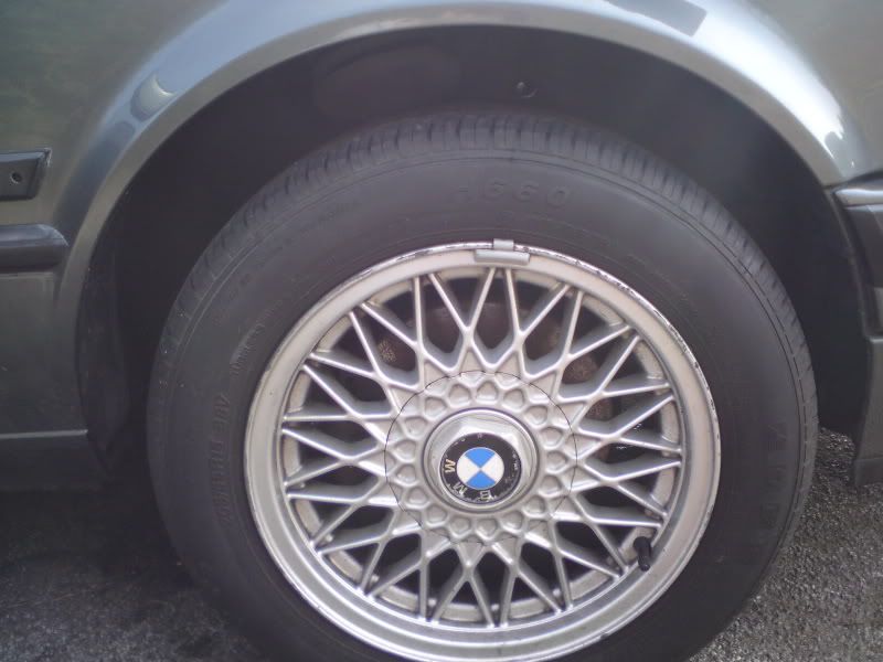

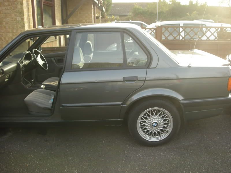

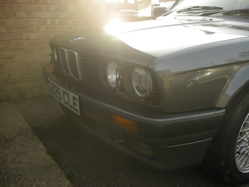

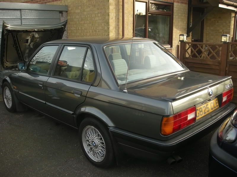

so, i bought this, a dolphin grey 325i with 167k on it, its pretty clean with the main obvious flaw the tiny dent in the door (see pic), progress pics to follow
It seems to sit stupidly high at the moment (even for a standard car) so on the list is to drop it, it just needs a gear selector to make it scompletely manual, there is a list of parts needed for it but we are hoping that in 2-3 weeks it should be driveable, then its just changing the details with the DVLA, tax, MOT and drive, woo.
Im on the look out for new wheels, steering wheel, HU, speakers, smoked side repeaters, and if i can find one then front splitter, i think thats about it at the moment.
It'll eventually have LSD too, and hopefully make it over to Nurburg.

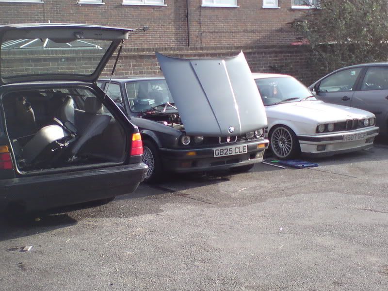

The donor car, my E30 and the inspiration, my friends E30

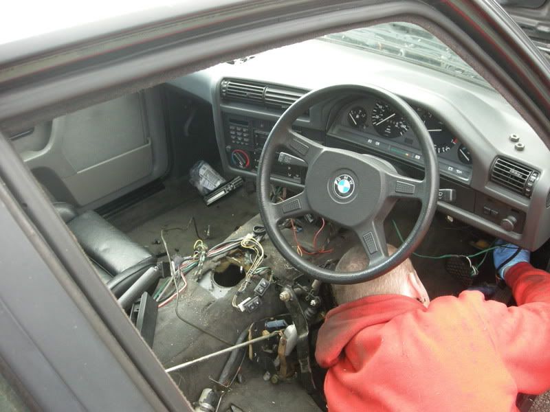

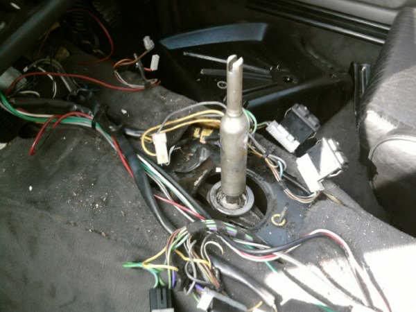

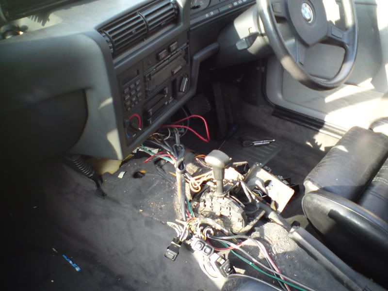

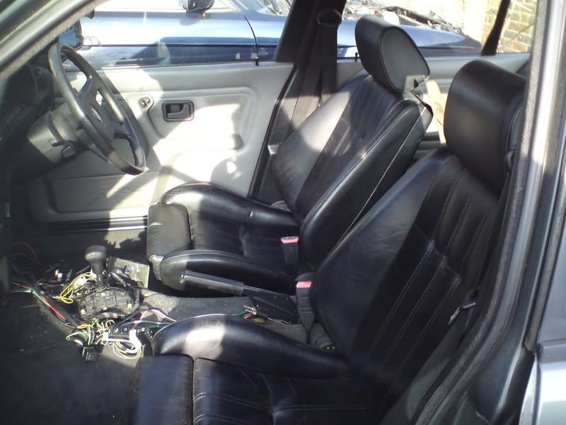

The auto-manual conversion begins
Leather in

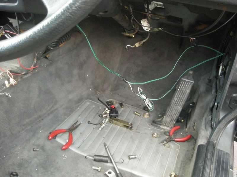

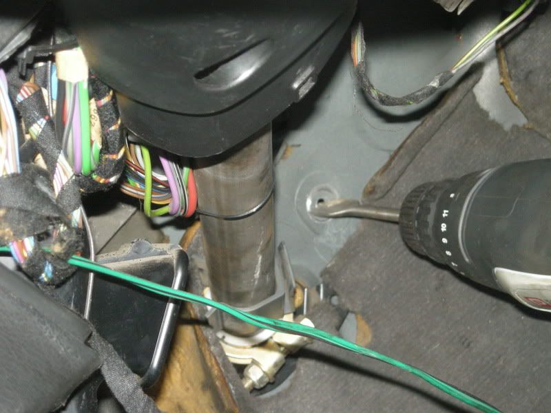

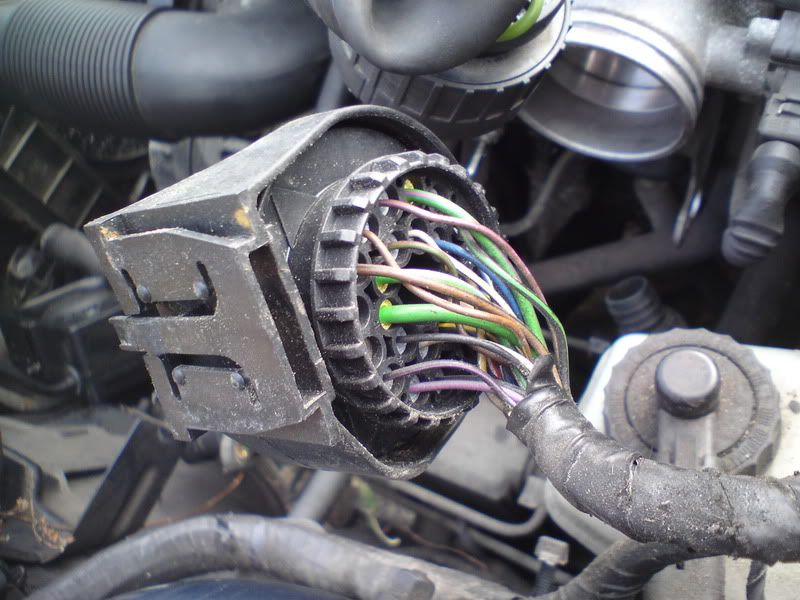

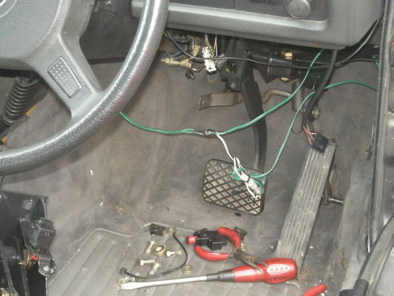

Im not technical minded so i got given the job of writing down the wiring

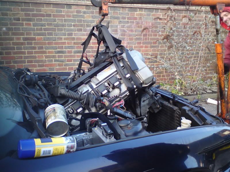

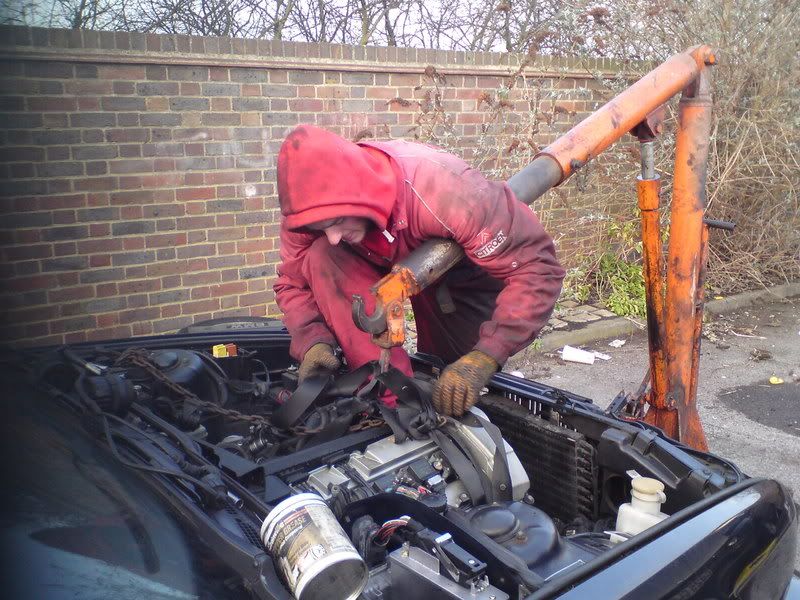

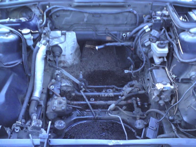

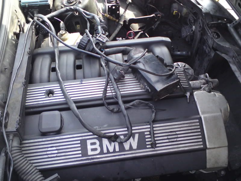

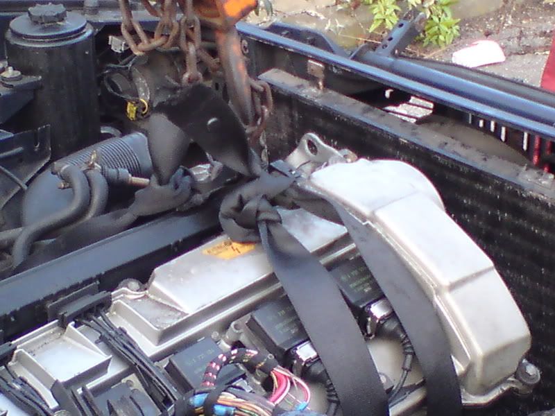

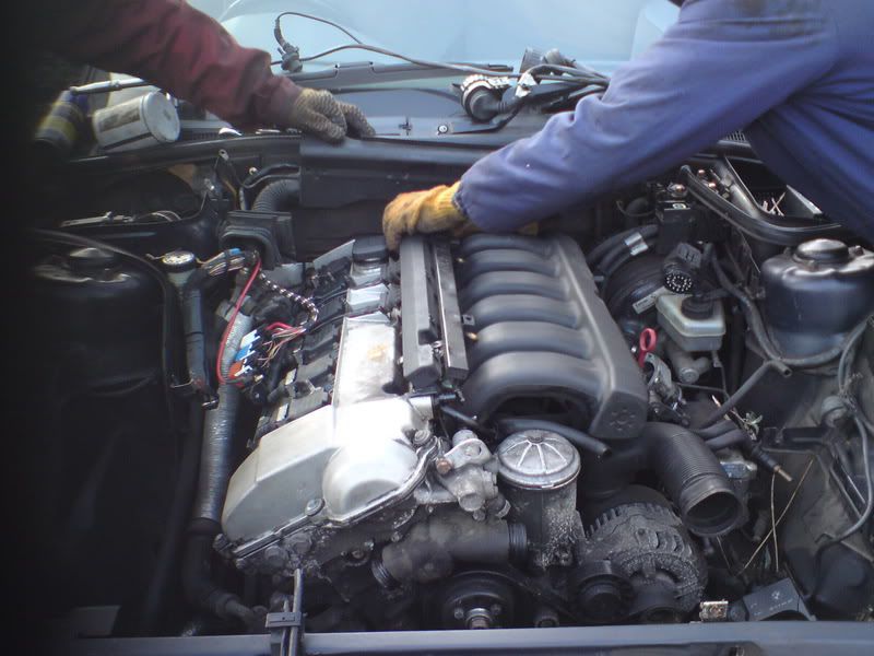

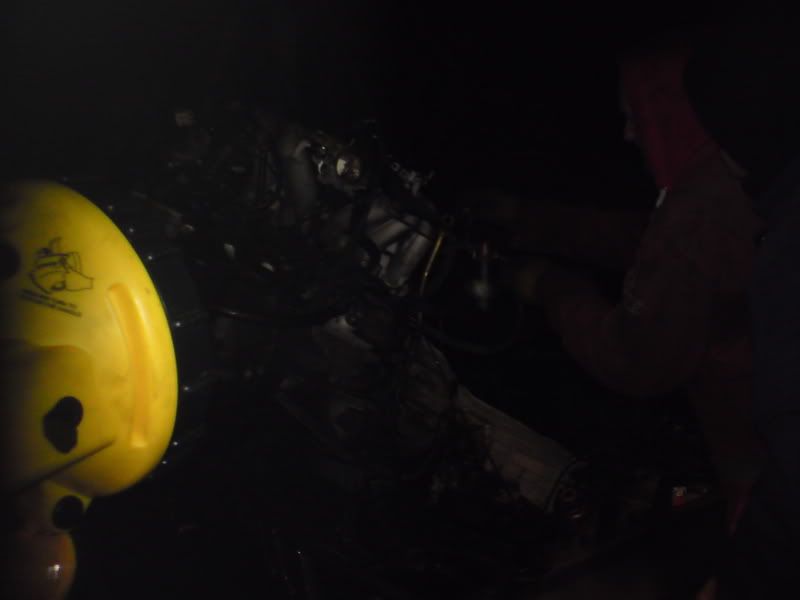

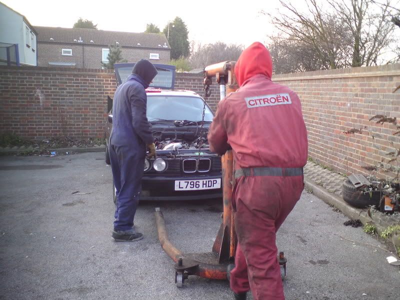

Various engine in/out pics

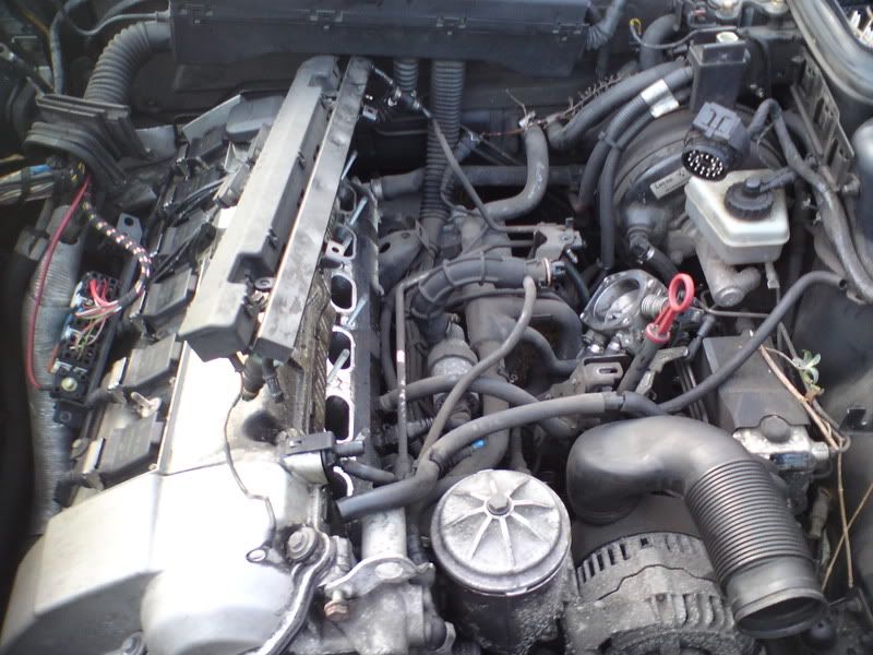

Update, taken from another forum, the car is coming along very nicely and is almost finished.
The following weekend i visited the car again, the aim for today was to get the gear box sorted and the auto-manual conversion completed, which was achieved all bar a gear selector
bula_82
Posts: 20
Joined: Mon Nov 17, 2008 11:00 pm
Location: Basildon, Essex
Tue Apr 28, 2009 8:05 pm
No pictures of the weekends work as i wasnt there but i am assured there is pics on the way at some point,

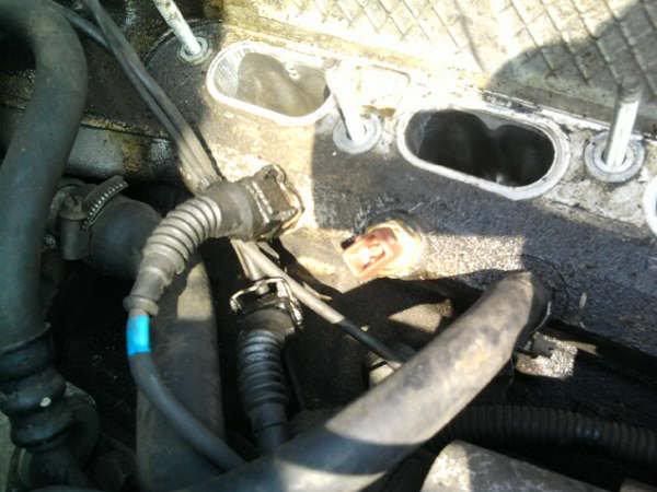

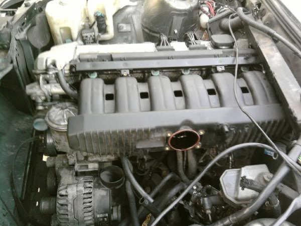

However, after much fuss and the car being a right pain, the following has been completed over the weekend.
Brown temp sender fitted.

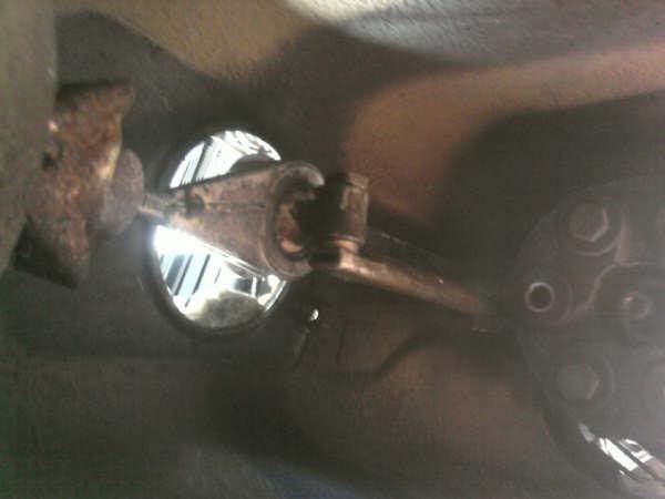

Gear selectors fitted, link bar modified for the perfect shift.
Powersteering pump fitted, new line half fitted.
Pulleys refitted, plus belts.
Starter motor wiring done.
Inlet manifold fitted.
Connectors and vacuum lines on inlet fitted.
Petrol lines traced and fitted.
we are well on the way there now. weather permitting work continures this friday / saturday

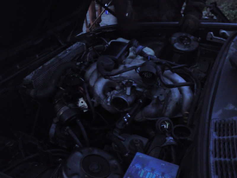

Then torqued up all the inlet manifold bolts and throttle body, need to fit accelerator cable to that. Then work out how the inlet tubing to MAF is going to run.
Removing ABS this weekend so that gives space for the air filter.

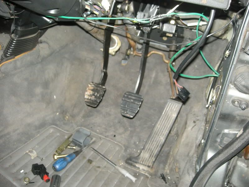

Bled the clutch.
Andy mounted the clutch reserviour and removed the ABS unit, then repeatedly failed to make a brake line.
So I had to do the brake lines on the saturday, which I did all three with ease and actually looks pretty neat.
Bleed the brakes, and its the best feeling peddle ever!!! So everything that way is tip top.

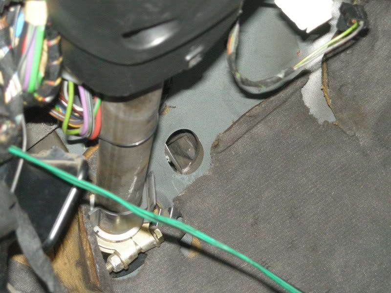

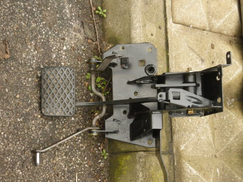

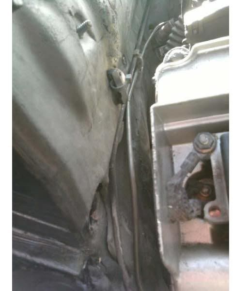

a few randoms -

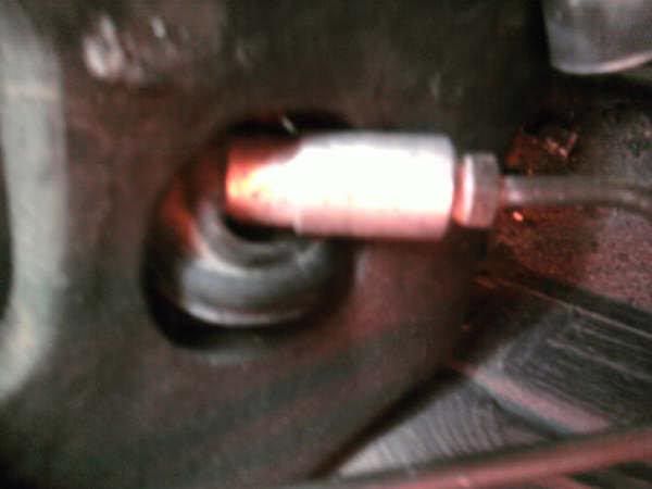

Clutch master connected
Clutch slave

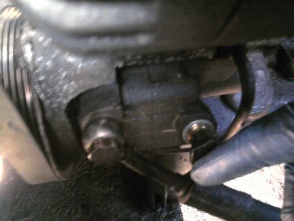

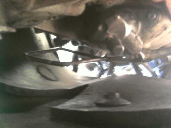

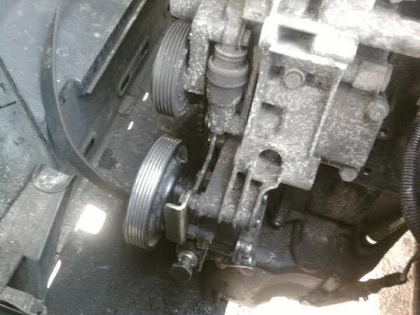

Power steering pump out
Clutch line routed
Gear selector
New pump on and the modified bracket
Manifold on and looking slightly more normal

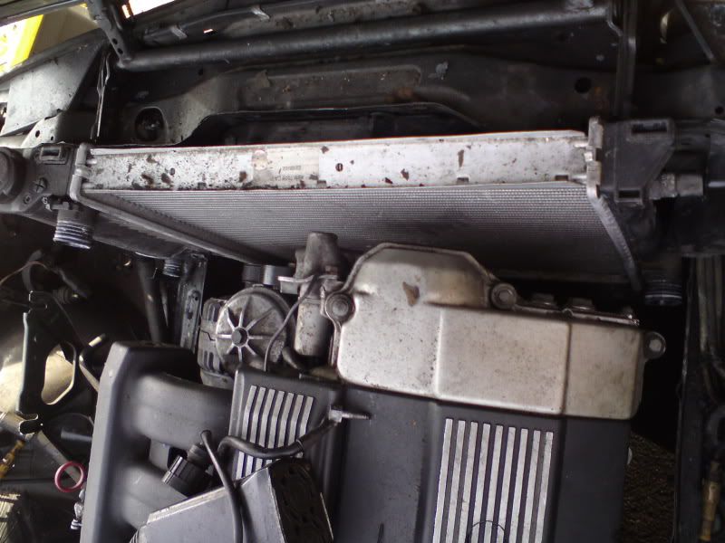

The 525 rad wont fit! we got another....

The car is pretty much there now, im after a standard exhaust and the the manifolds can be worked on, a few other bits and bobs and then the car is done :)
