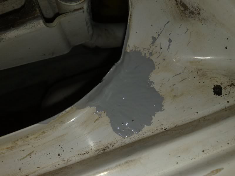

Alex I'm not trying to piss on your work but unless that rust is grind or cut out it won't take long to come back, sanding and wire brush will not go deep enough to get rid of the rust.
I would hate to see all your hard work go to waste.

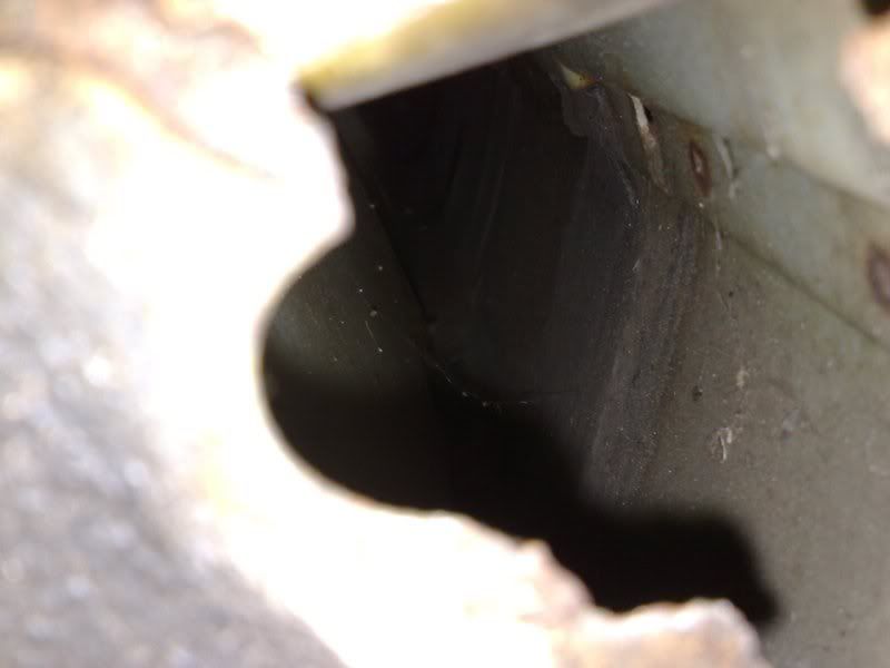

A break down of the rust is as follows
Possibly New rear panel
New drivers side Cubby pocket in boot along with New Lower Right quarter
Drivers side Inner arch needs either a plate or a new section welding in at the front ive not dug into it much
Drivers side outer arch could do with a new lip
Above the sill on drivers side where lower long bit of trim goes, needs a long plate putting in it may even grind back to smooth bare metal ?
Inside the door shut needs a plate welding flush
ive always wanted to have a bit of a resto so why not? Most people would scrap it. People weld worse tech 1s back together, and i would imagine most sports or original tech I and II fitted cars out there are hiding a lot of rust that the owners dont even know about
its all on the drivers side, the passanger side doesnt even have a small pin head scab around the inner arches or outer arches :mad:

You are correct, kind of rushed that
To be fair the anit rust primer isnt the correct thing to use either :chuckle:
Once i get myself a cordless grinder i will re do it

^So you'd grind it down to bare metal?
Sorry just trying to understand the procedure on this. My E30 isn't as bad as this but i fear the worst for my passenger footwell.. :cry:
cheers
Wed Apr 28, 2010 12:39 pm
The footwells are hot spots, luckly there good on this
bare metal is always best, if there are any holes new metal will need to go in
I'am learning too :)

Ive just purchased this from bmminiparts for £52.59 Deliverd 8)
Cabby rear inner arch for drivers side, i think there around £70 from the dealers?
i will probably only require the front section of it
this is what the inner arch currently looks like at the bottom, goes all the way up :eek:
I'am learning too
I heard the arches were hotspots winkeye mine seem to be fine on this, even the sills apart from one surface rust patch on the driver side..these will eventually see tech 1 skirts - done right so no scope for rust in the future!

Alex wrote:
Steve wrote:
Alex I'm not trying to pee pee on your work but unless that rust is grind or cut out it won't take long to come back, sanding and wire brush will not go deep enough to get rid of the rust.
I've got that primer in a aerosol. I though it was just just a primer with anti rust properties. Obviously all rust has to be removed before using it.
You could use this to remove it 100% as long as its not terminal.
http://www.bilthamber.com/deoxgel.html
and this before paint
http://www.bilthamber.com/hydrate80.html
