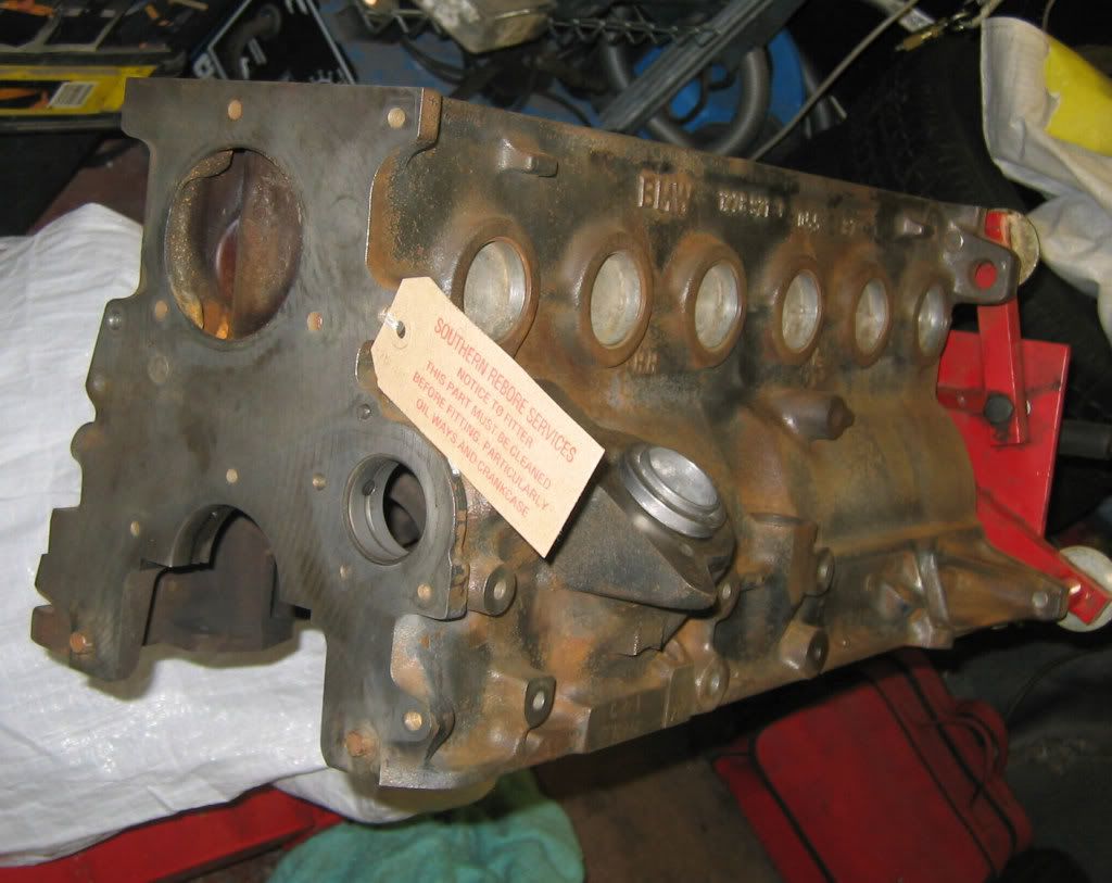

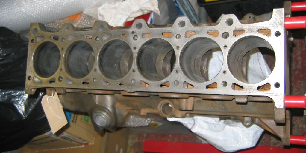

I've been waiting for a guy I know to sort the sheared sump bolt out but I can't wait no longer so today the bare block was taken to southern rebore for them to sort it. it will be back on monday and I can start bolting big oily bits back into it.
The block is now honed and cleaned and is ready for paint, I have a box full of parts, a head built sitting on the bench..........sit tight peeps. It's all go from here.

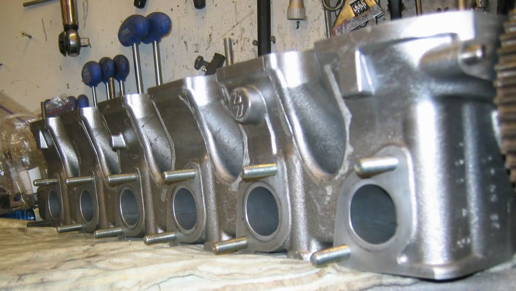

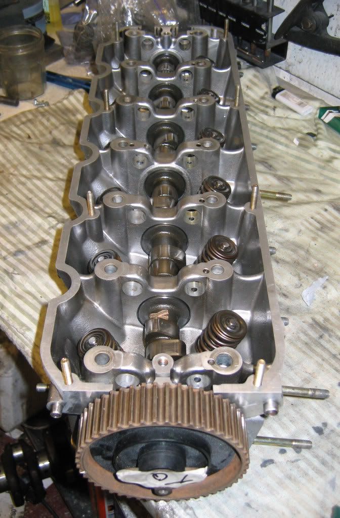

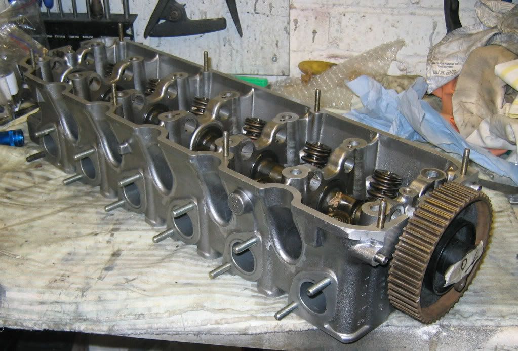

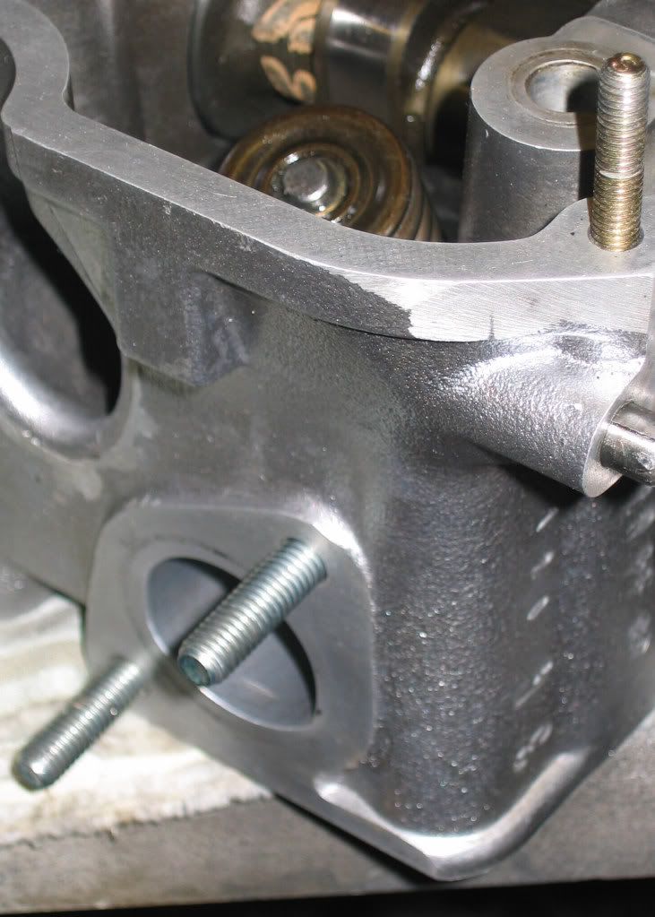

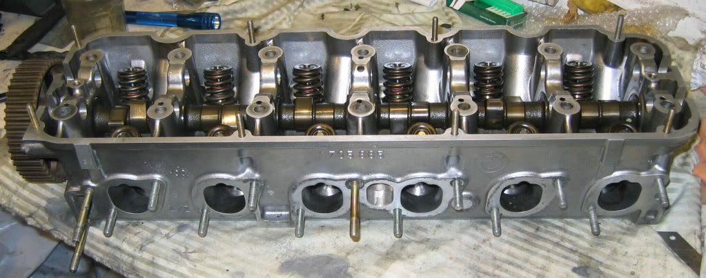

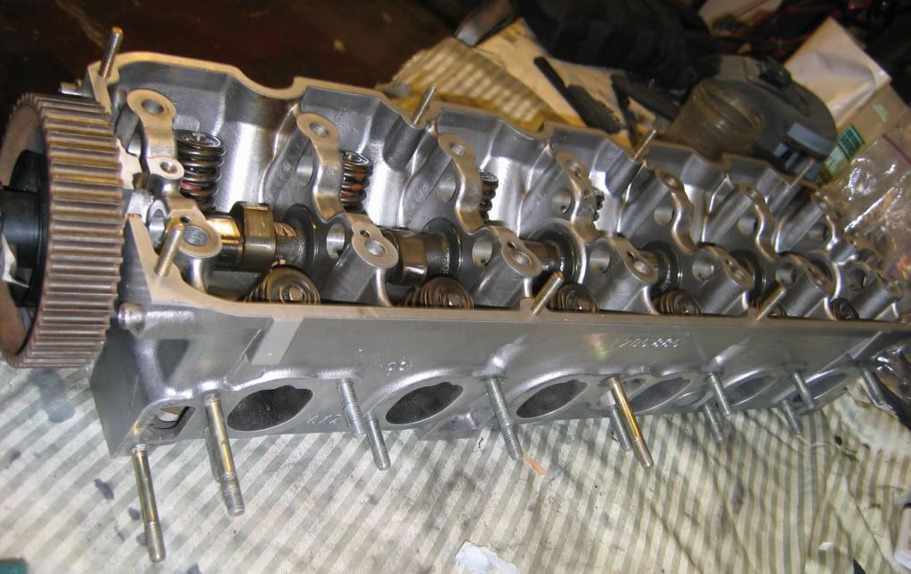

Well, the head is as far as it can go now until I actually fit it at which time I'll fit the rocker gear. I don't want to leave pressure on the valve gear when it's not torqued down. Heres a few shotes with all the new studs etc. Now all wrapped up awaiting for the block to return.
Sat Mar 21, 2009 10:50 am
Softcore porn :D :cool:
Looking good Trevor!

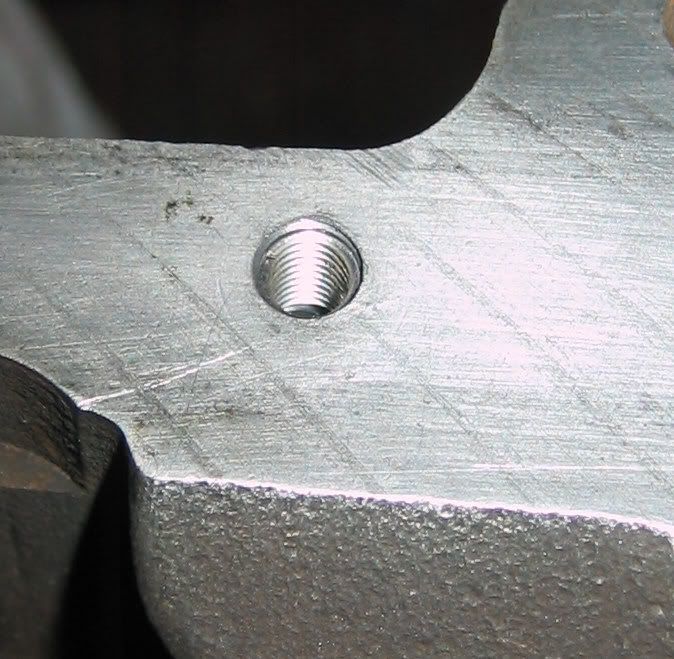

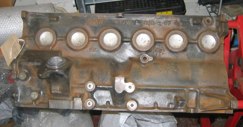

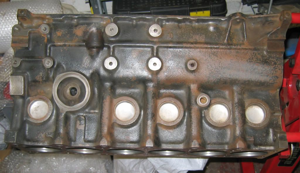

Today i rushed down to Southern rebore to collect the block. They've had to helicoil the sheared sump bolt thread due to some muppet :o: :o: trying to drill it out!
Heres the helicoil. A lovely job and all for 13 quid!!! RESULT!

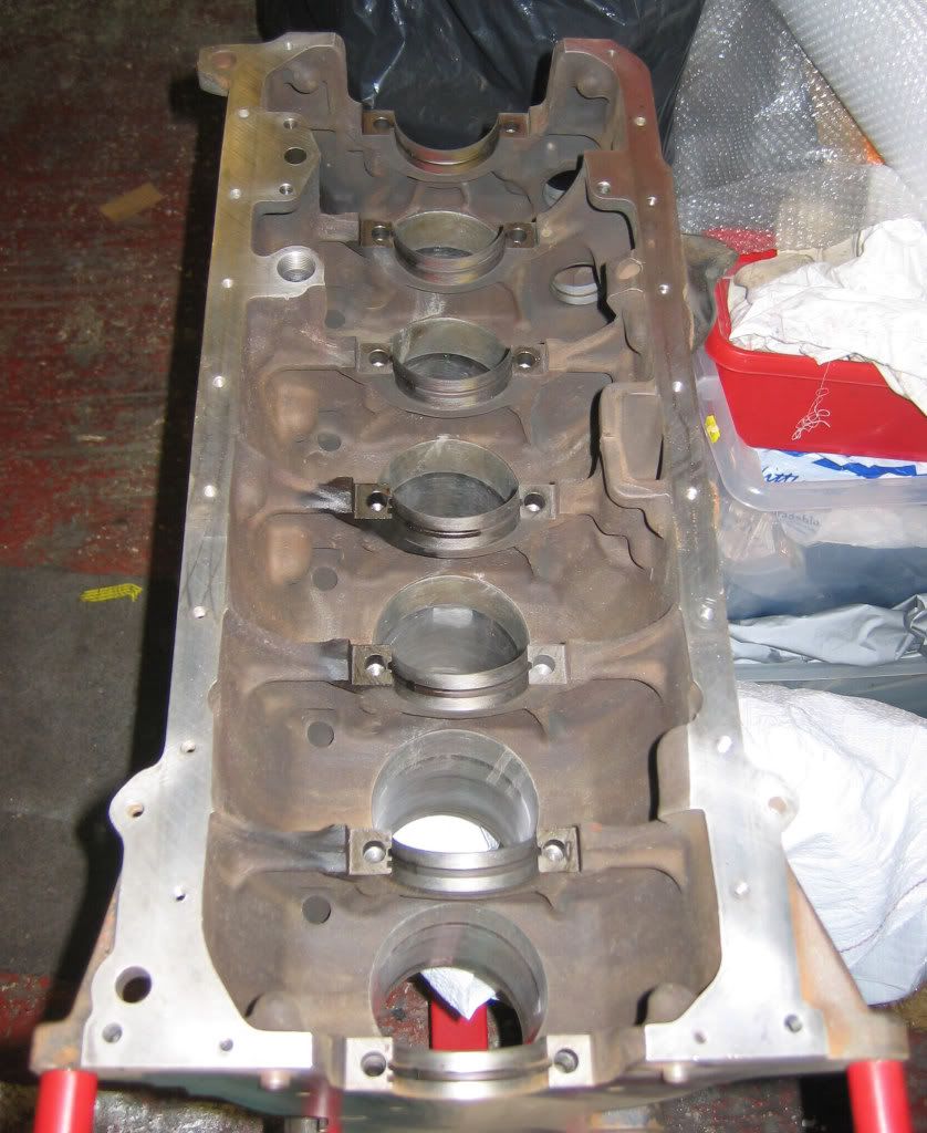

So heres where we are now. Blocks back on the stand (barry I promise you'll have it back soon, cheers mate. All degreased and Honed and just requiring a thinners down before paint. It will be Black (obviously) but i want it to be as close to original as possible. This isn't gloss and it's not true satin. It's a cross between the two. So out with the mixing pot it'll be.

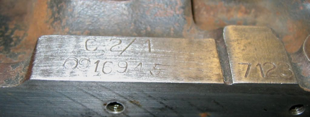

and the all important C2 stamping. You'd think they's have made a better job of it but hey ho. It's the real deal at least.
So from here I have no excuses anymore. Lets get painting and throwing lots of clean bits at it!!!

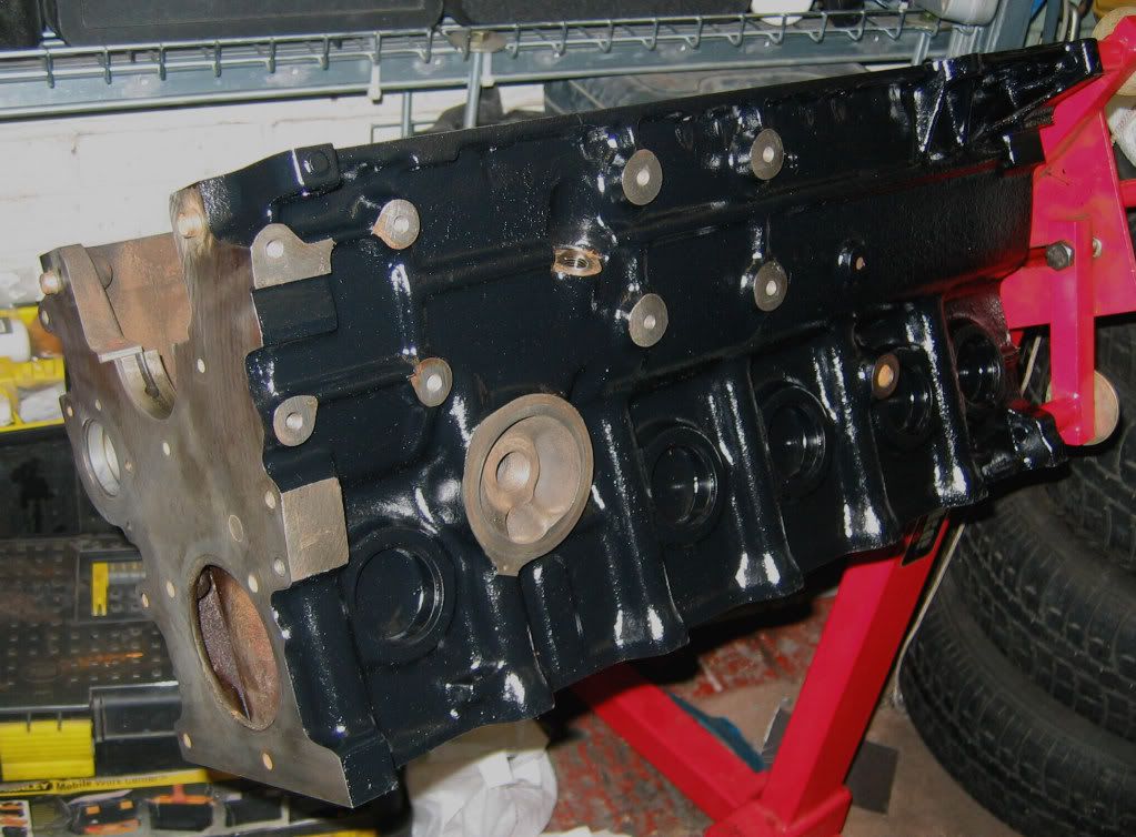

Sat Mar 28, 2009 8:52 am
:cry: :cry: :cry: Not happy with this. It's supposed to be f*cking Satin Black. Too glossy for my liking.
Sat Mar 28, 2009 10:35 am
Stop being such tart! :D
Shouldn't the core plugs unpainted though?
powelly
Posts: 1649
Joined: Wed Dec 06, 2006 11:00 pm
Location: On the scrap heap
Sat Mar 28, 2009 11:26 am
Trev, assuming you used VHT type paint, it might dull down a bit after running it up, it's my understanding that heat fully cures the paint. Looks good though.
Image Le Mans Classic 2006
Posts: 15846
Sat Mar 28, 2009 12:21 pm
bss325i wrote:Stop being such tart! :D
Yes they should. But it' didn't look right!
It's still dulling down now as it happens so I reckon heat will cure it more.
