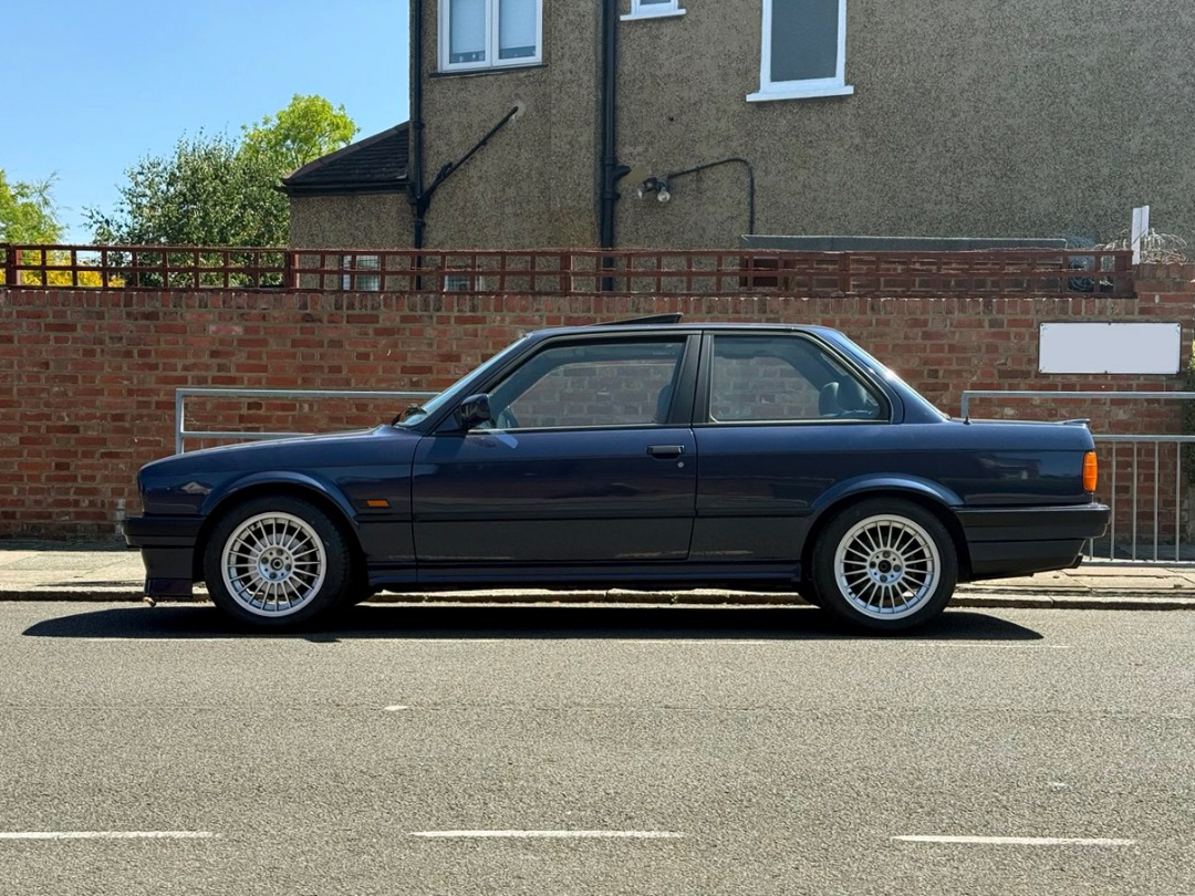

Got the beast out of storeage and time to spruce up the suspension. All new B4s fitted here, new top mounts and bump stops etc with new Eibachs but just on the front. New Toyos also. Wasn't gassed about the extra -15mm drop over MTEC but wanted to see how it looks and pretty happy. The new dampers on the rear also perked it up a touch so sits quite well. Not so much of that E30 front wheel gap and the 8Js on the rear get a touch more space now. I may not fit the new rear springs if it drives okay. Tyres are 50 front and 45 rear.

Hi Ratch,
Great to hear from you again, and nice to see you still have your 318is from way back (Nov 1997, so nearly 28 years - that's good going !) What mileage has it now covered?

I think it sits well :thumb: Personally I have always thought the FL looked better with a bit of forward rake with the lower rear arches. I am going to try and squeeze 8.5 in the rear of my FL so may ending up having to give the middle bit of the arch a gentle roll to even it out, but it will have a touch higher rear end for definite.

Hey man. Maybe done 140K? It hasn't done 1,000 miles in the past ten years tho! Trying to use it more now rather than let it rot away in storeage. It's not mint enough to be a garage queen / value position.
It does feel good to drive such a thing today tho and in London, a clean E30 gets you 2-3 questions / compliments minimum from all sorts every time you head out.

140,000 miles is very low, considering the age. I currently have a 2009 Abarth Grande Punto on just under that.
Are those real Alpina wheels or replicas? Whichever, they suit it nicely. I presume you managed to get the new diff fitted in the end?

Yep genuine Alpina staggered rears etc. LSD fitted ages ago and running well.

Brave! given the state of the roads these days I'm not sure my C1 323 is going to get them back when it gets on the road! might get a set of maxilites and keep the originals for best.

Looking mega. My iS always sat a little high at the front. Never thought of combining the spring options to level it out. Looks good for it.

Cheers dude. Was worried it might mess with the ride but it's totally fine. Clearance at the back for 16 X 8 and no chance of rubbing at the front but also no nasty wheel arch gap either.
