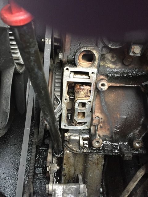

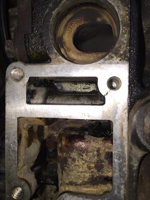

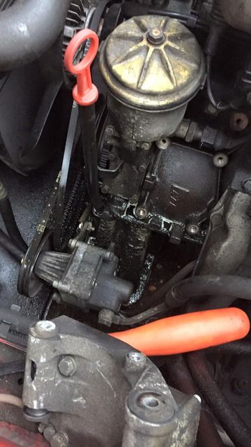

i found the culprit after some investigation. damn oil filter housing.
so proceeded to remove it to fit the new gasket and seal on the housing.
cleaned up the mating surfaces on the housing.

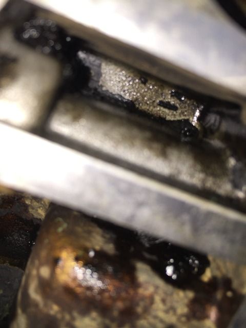

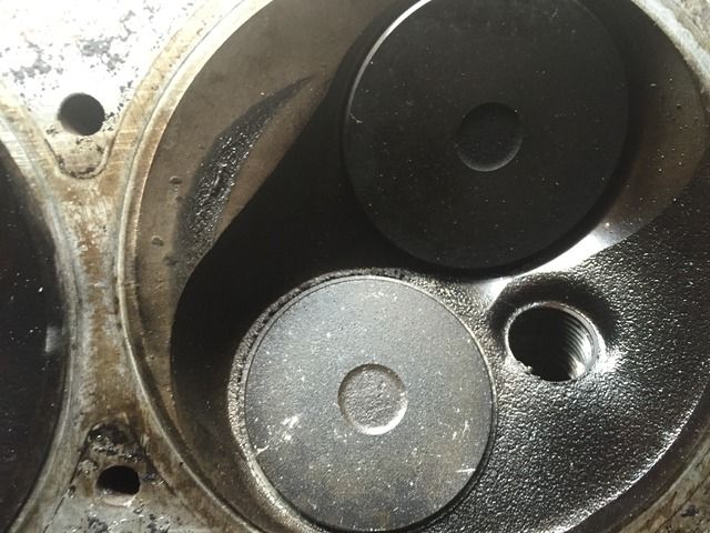

if anyone's is reading this with a m40 engine be worth changing the gasket if it hasn't already been done as they go hard brittle and leak. but the main thing is the top oil way drain galley from the oil filter housing was blacked solid of crap on mine. i spent 20 mins cleaning it out on the bloack and the housing its self. i didnt get a photo before but the photo underneath will show what i mean after its cleaned as its the galley at the top between the two bolt holes. no wonder these engines are prone for failure.

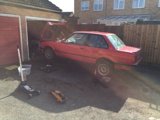

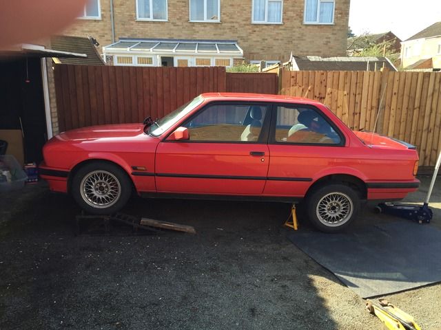

got the car jacked up

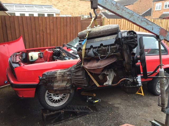

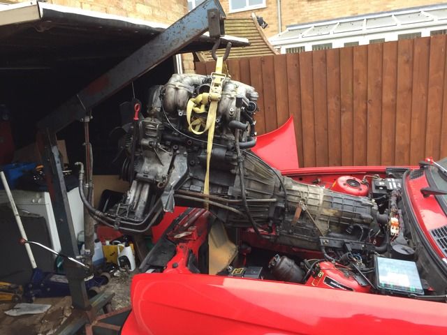

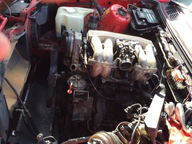

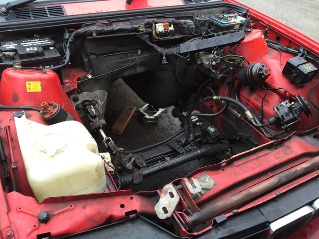

getting the engine ready to take it out for the manual conversion yea i could done it in situ but i thought sod it take it out lol

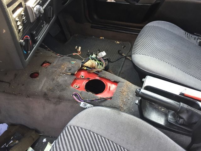

took the auto gear stick out and disconnected it

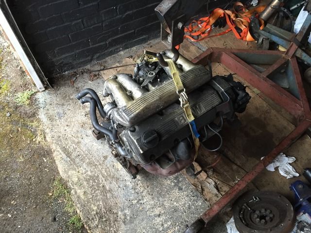

finally got there now time to take it out :D

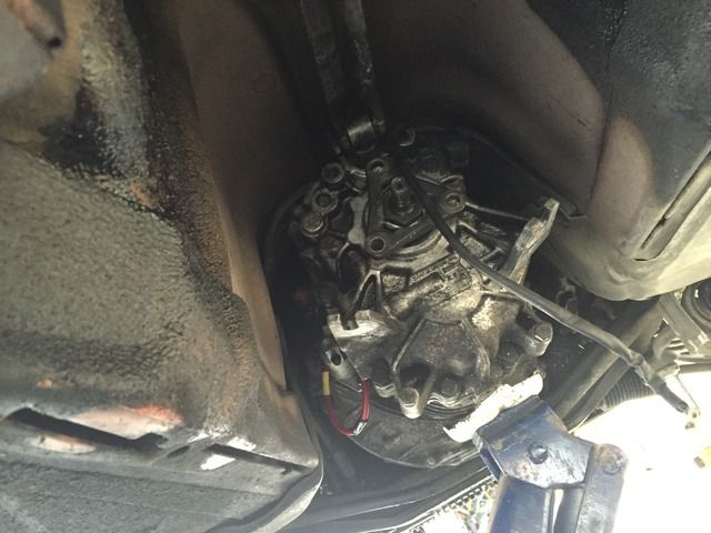

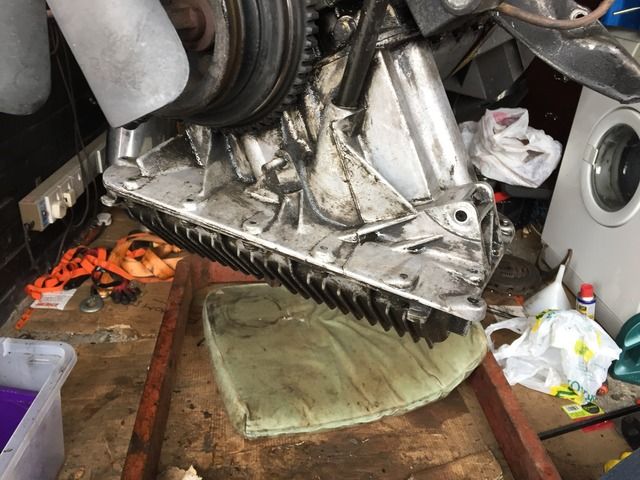

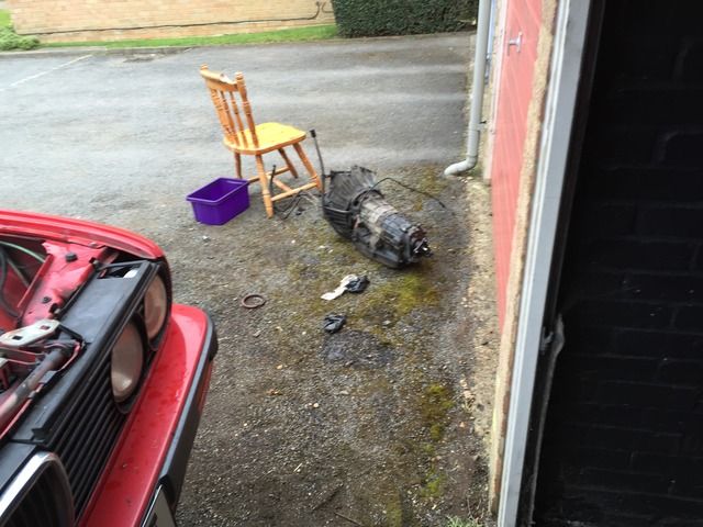

immediately took of the auto box. my god that things weighs more than the engine lol

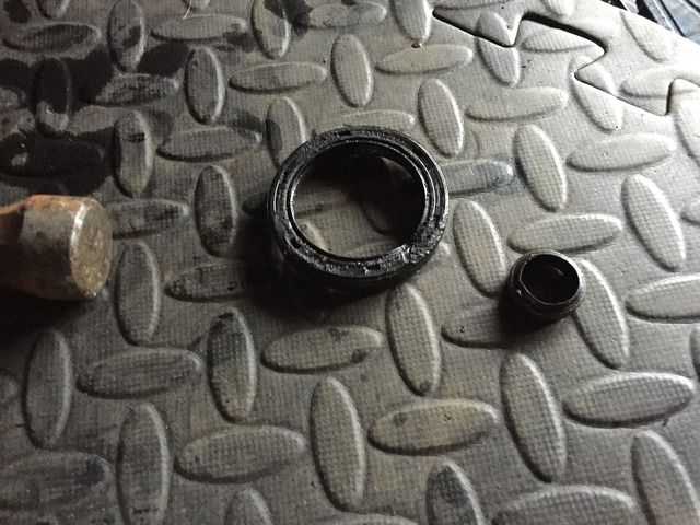

drained the new manual box ready for fresh oil and changed the out put shaft and gear linkage seals whilst i was there

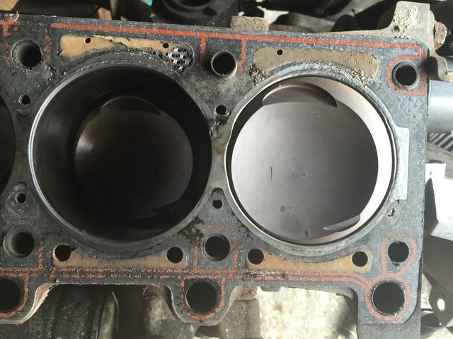

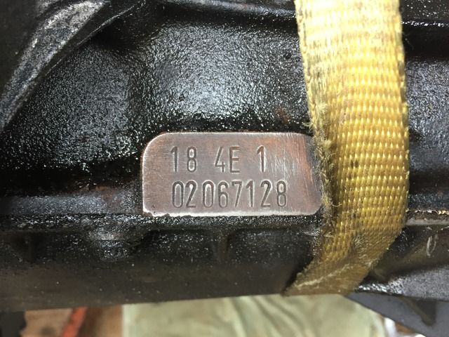

i made sure the engine was a 1.8 .

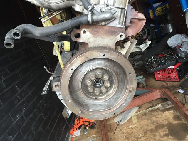

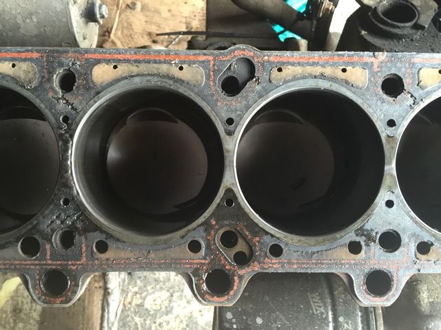

i took of the auto flywheel ready for the manual one. also gave the engine a bit of a clean whilst i was there.
fitting the manual flywheel and new sachs clutch with the spigot bearing.

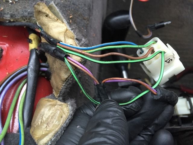

i sorted the wiring and it started back up nicley :D

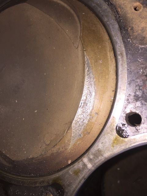

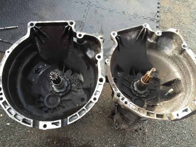

had a major issue once i started driving the manual box sounded awful :/ did like 15 miles and had to take the gearbox off and fit a new one. i found the reason it went as the input shaft was the wrong size as the first box looked like it was a 240 from a 2.0 so the spigot bearing wasnt supporting the input shaft properly. once the correct box was fitted its been fine since well so far anyway lol ive done 8k since i fitted it.

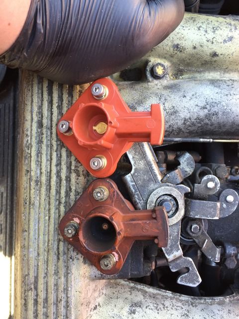

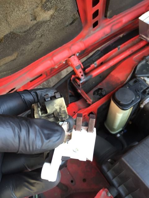

i did some well deserved TLC changed the dizzy cap, rotor arm and the voltage regulator in the alternator which i think i did at the right time :D
