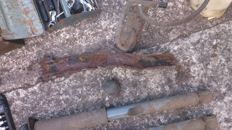

Discovered the rear shock had signs of leaking, which would explain some of the undesired handling characteristics
So I've got a spare set, not new but in better condition from a lower mileage donor. The top mounts weren't as bad as I was expecting but new ones are going in anyway.
Also even though I did the centre bearing I never got round to doing this last time I dropped the prop so I can finish this job properly now, just waiting on delivery.
And a few other rusty bits that are getting replaced
