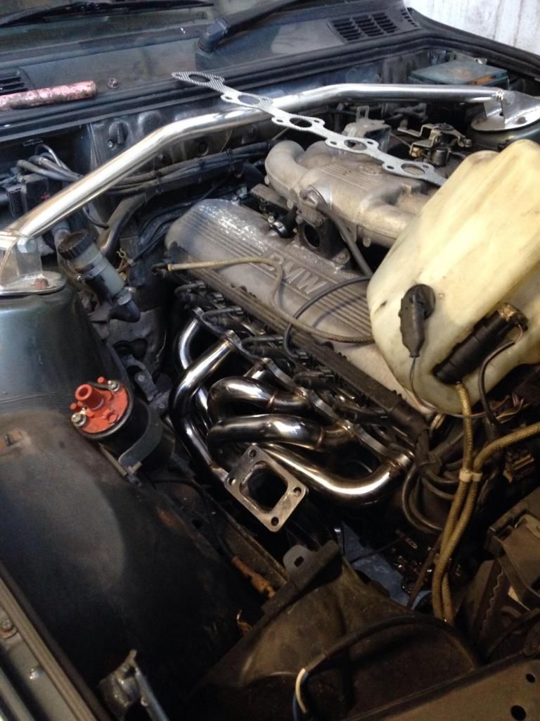

Hey my names sam or box I own a e30 325 2 door that I have just decided it's time to turbo iv took 2 weeks off work to get as much as possible done to her
The manifold arrived this morning (that doesent fit!! Cheap ebay rubbish) so iv spent most of today making that fit oil cooler pipes in the way! So iv had to remove that! And now the bolt holes don't line up so iv sorted that and she's ready to be bolted on today
But on the bright side I have got the turbo housing painted lol

Welcome to the zone !!! - you can rotate the oil cooler thermostat so that it faces forwards, this might help your clearance issues if the filters in the way. The pipes bend easily to.
like this - http://www.e30tech.com/forum/showthread.php?t=115118
I'm sure iPhone pictures can be hosted - i only know how to link photos from picas web etc, you put [img]link[/img]

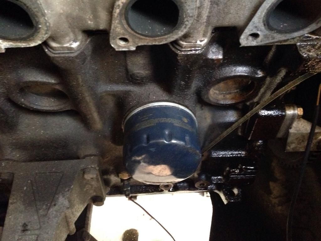

Cheers man just took the cooler off for the time being and put a Clio oil filter on that seemed to clear for me lol

That's todays efforts going to fetch intercooler and pipe kit in the morning so hopefully I will have got a bit more done by end of play tomorrow

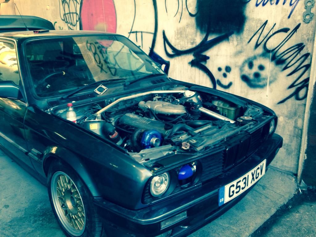

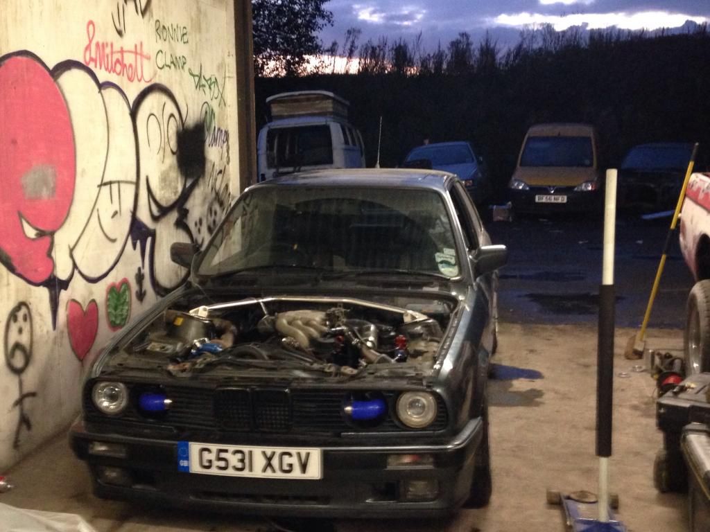

Ino it doesent look like iv done a lot these last few days mainly because I haven't!! :) but intercooler on and mounted turbo is bolted on and were I want it to be just waiting for some braided lines to arrive to pipe up the feed and return
The pressure switch for the 7th injector is in place and just waiting for the exhaust flange to arrive to start making the exhaust thinking about having it straight out the drivers side wing just for the flames and bangs lol
What do you all think!?

Looking good so far... i am not sure about the blue turbo though

No me either only did it because there was paint left in the gun lol just going to paint it silver again lol

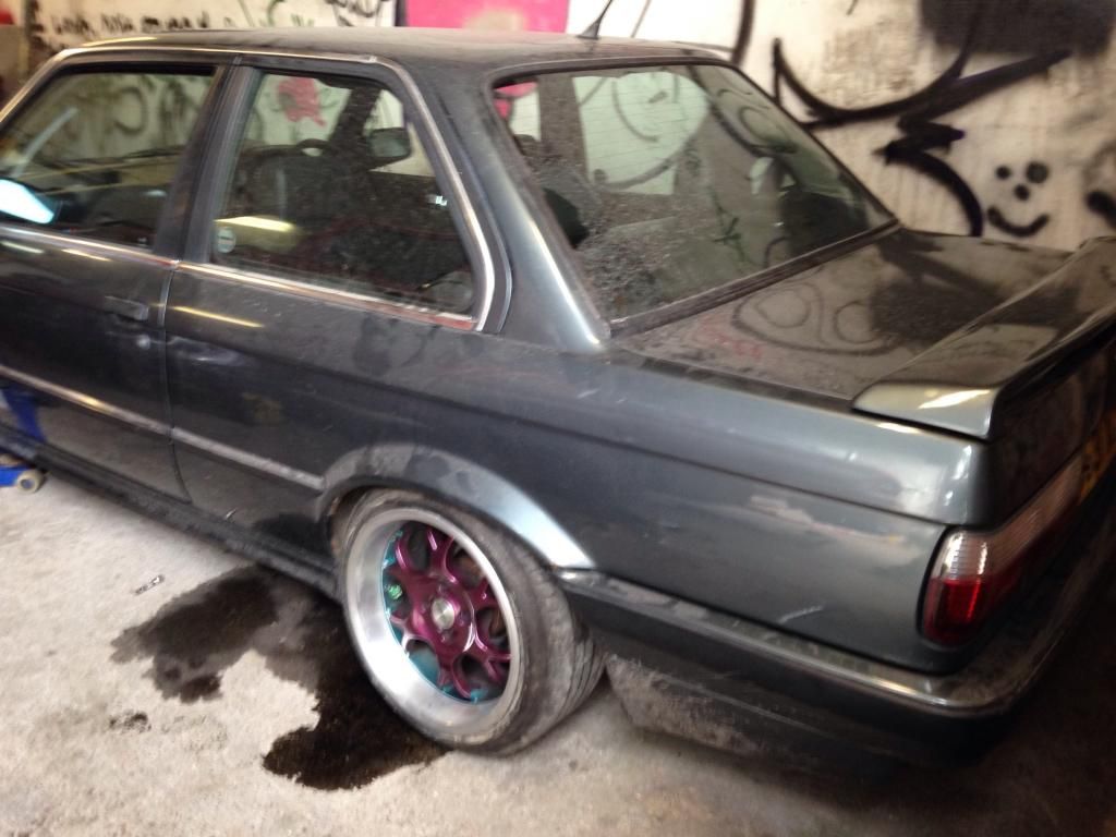

nice project , have you had the rear beam bushes changed in your ownership ?

Thanks and supposedly the car had been restored before i had it so didn't think Id need to lol
Fri Oct 10, 2014 8:33 am
would check them before this happens .

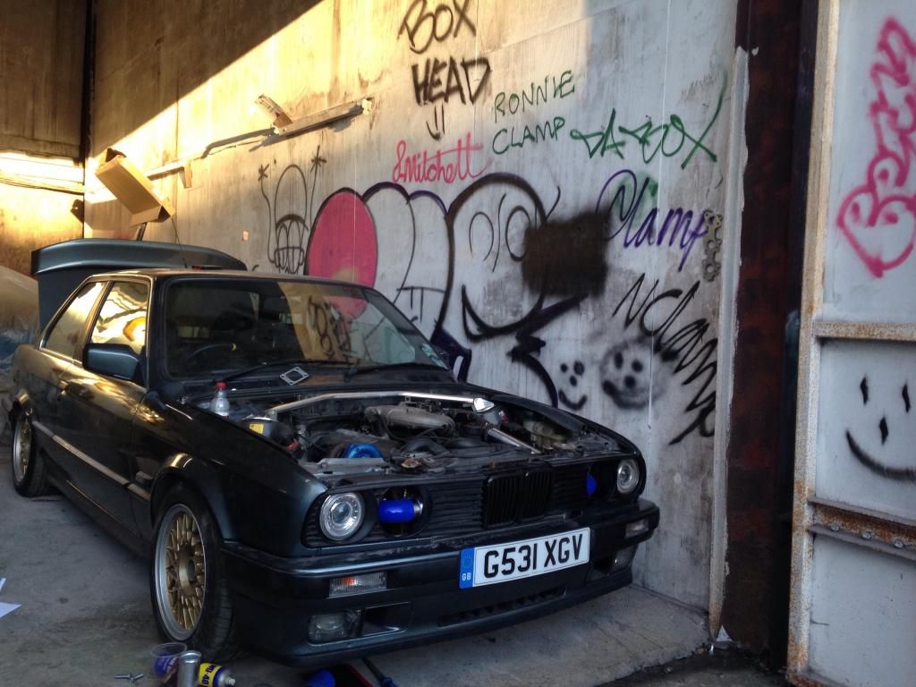

Some new borbets for the dirty 30 had to swap them for my go kart though :(
Also checked my diff mount and that had a nice shiney powerflex? Bush in there

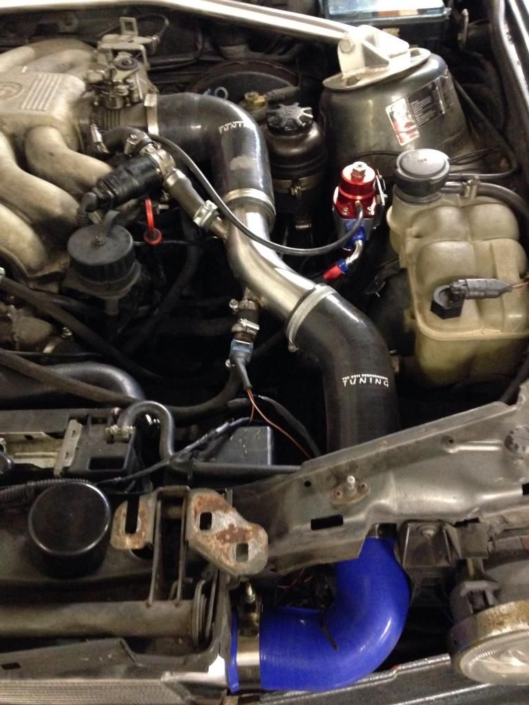

Little picture of under the bonnet still not finished yet but it's getting there :)
Exhaust has no restrictions ;) it does spit flames!! Lol
Nice little car cover off eBay £10 bargin
And saving the best till last we took her for a test drive!(slide)
