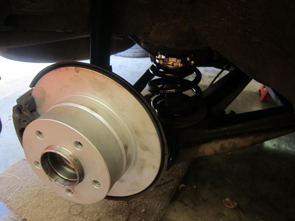

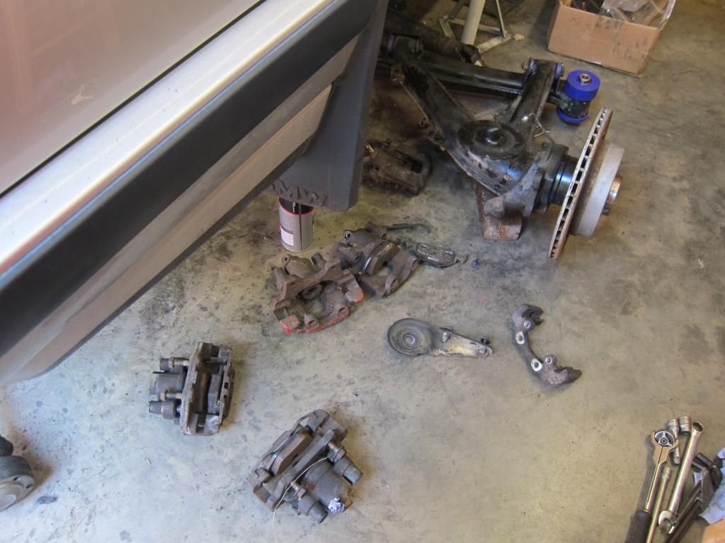

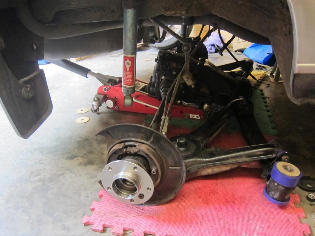

Pressed Z3 hub and bearings into my trailing arms and assembled the rear end:

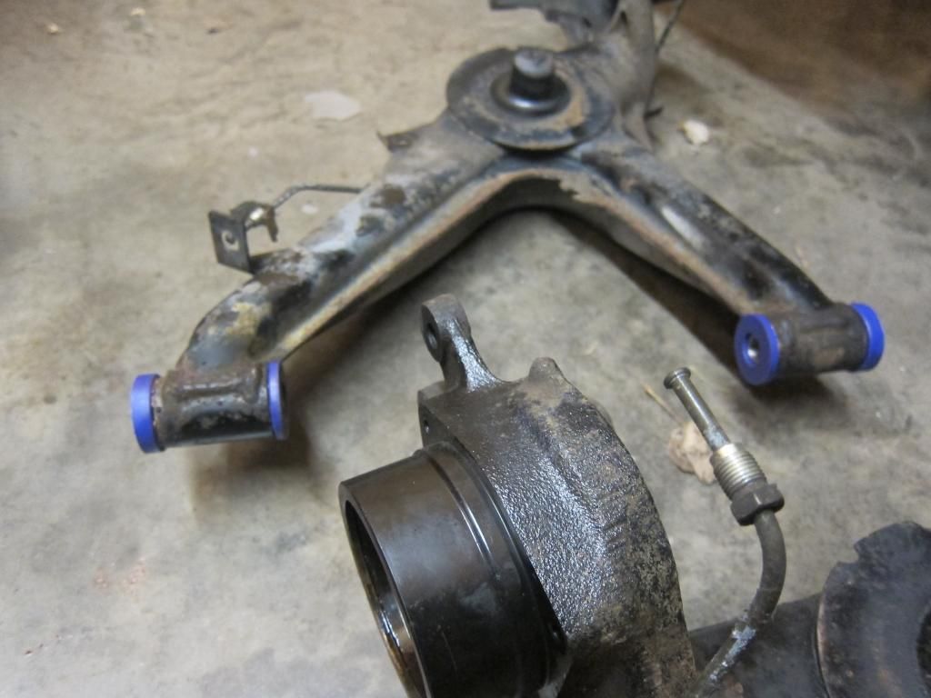

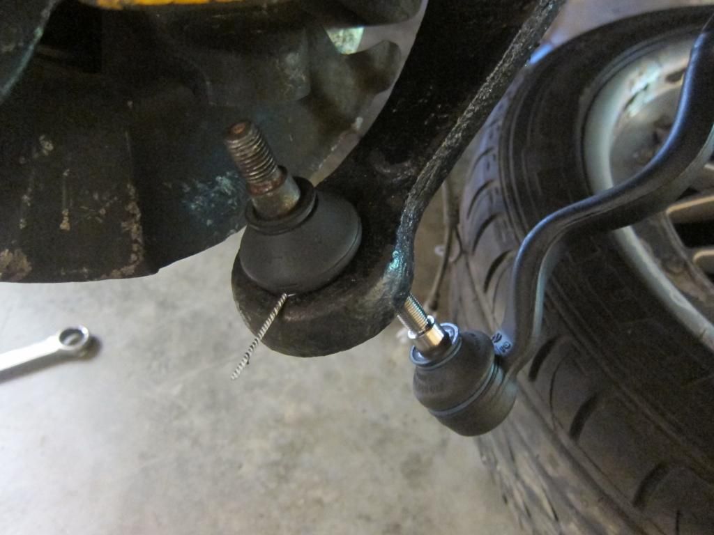

Realised that I'd forgotten the backing plates, threw a few choice words out there and then undid all of that work ready to do it all again later. Secured the replacement boot on my decidedly secondhand M3 Evo arms before I forgot (then trimmed the lockwire a bit after taking the photo, of course):

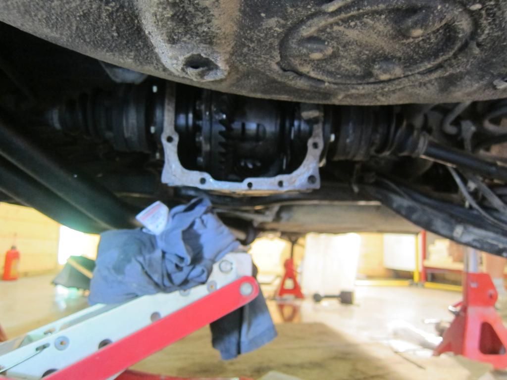

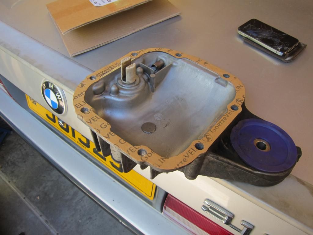

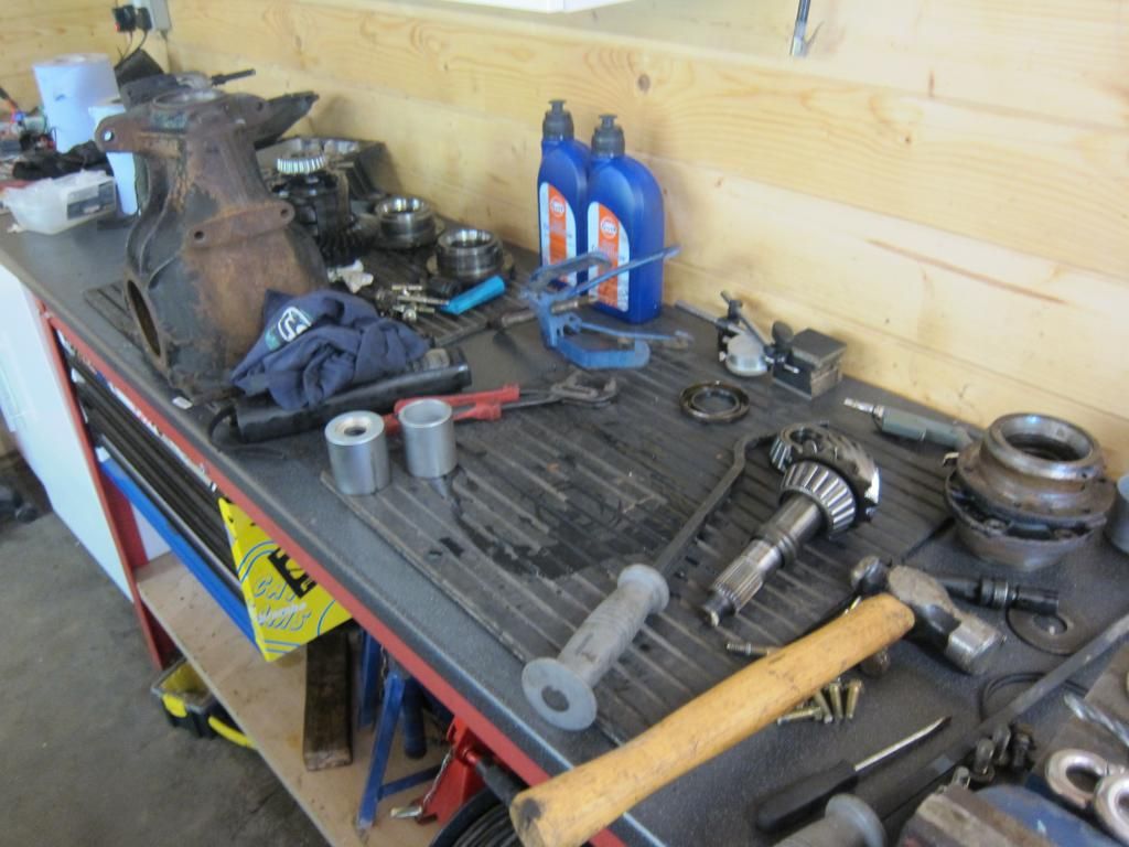

Tris built my LSD up in the meantime. Judging by the amount of swearing and loud exhalation I gather that he doesn't particularly enjoy it, but he's good at it and has all of the kit to measure the backlash and whatnot so unfortunately he managed to get lumbered with it. It didn't help that it was about 80 degrees centigrade in the sun and the press was outside, in the sun:

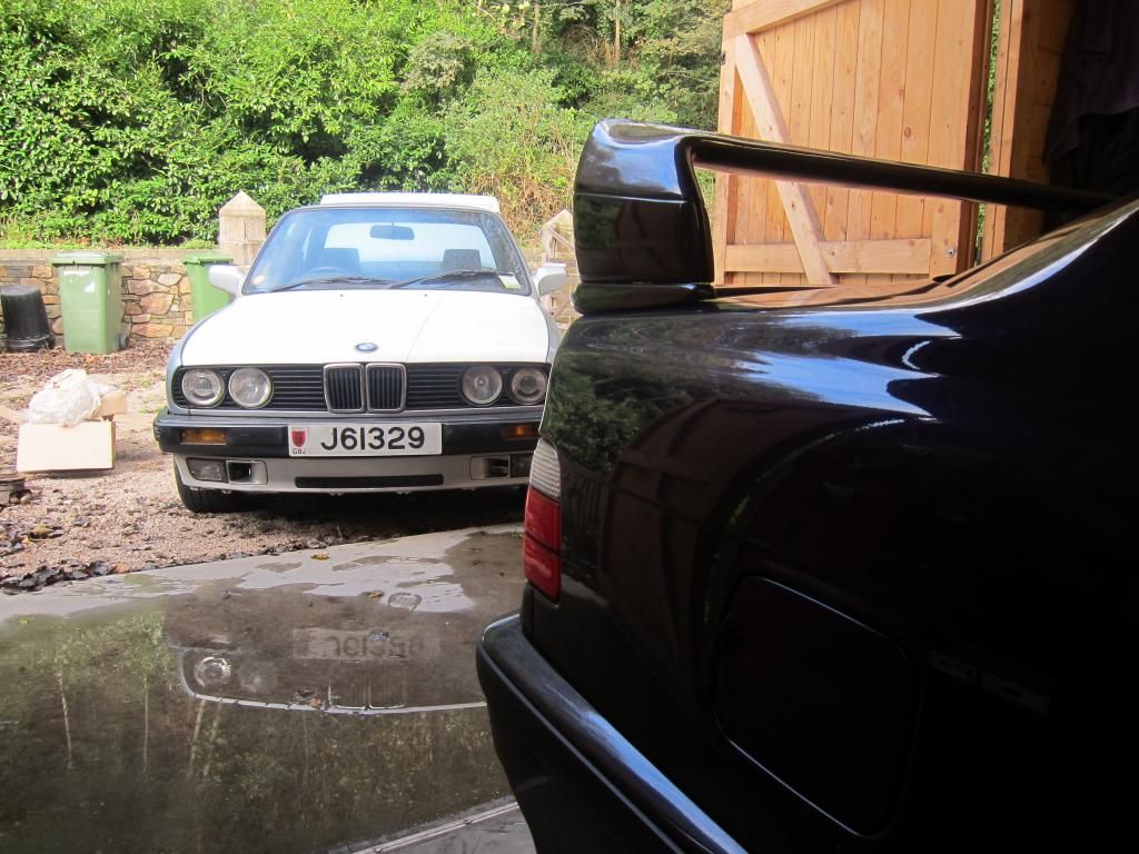

This would be a demoralising scene but thankfully two of the visitors to the shed didn't own the cars they rocked up in. My haggard looking (but very solid) E30 didn't really compare:
This actually
was a demoralising scene.

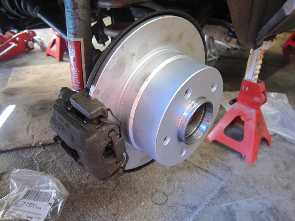

MYTH: using Z3 2.8 hubs will allow you to bolt any non-M rear discs and calipers onto your rear-end set up. That'll be a pair of Z3 discs and calipers I'll be needing to source then as no amount of trying to hybridise the E30 carrier with the E36 caliper to get the fixing points to align and/or machining a spacer was going to work if I wanted a fully functioning handbrake. Which I do. Here's the proof:
Diff built, rear-end pieced back together for about the sixth time and in place ready to lift up using the 328i discs just for now to get her rolled out of the shed:

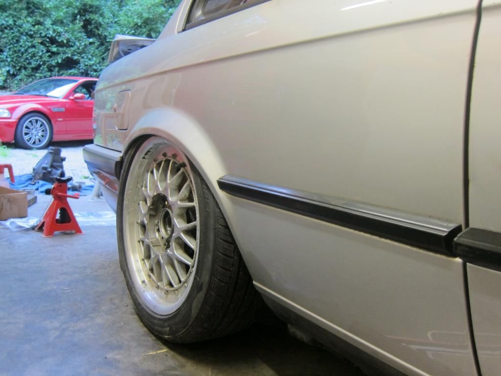

what the actual f*** moments where you can't realise why it's decked on one side but fine on the other:
Cue letting air out of the tyre to avoid shredding it or annihilating the arch before planning on cracking out the arch roller. Bent the tyre valve in the process trying to speed things up. Oops. Then the sudden realisation that the other rear spring was still on the floor outside, that'll be why then...

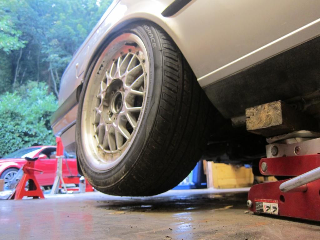

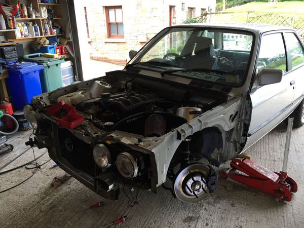

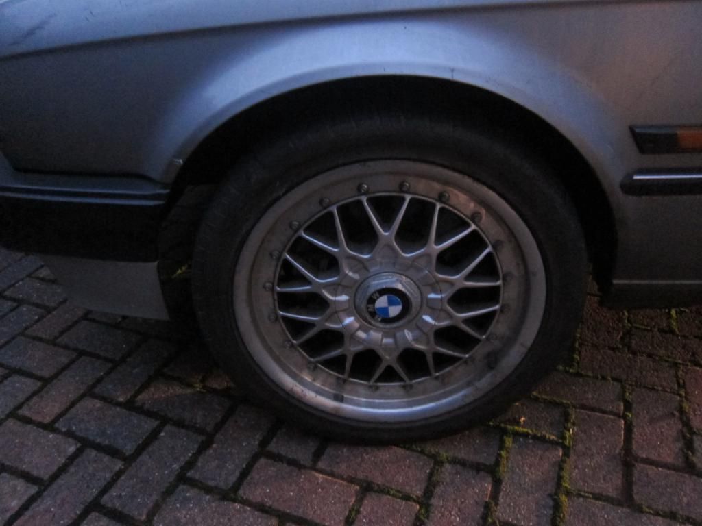

A new day, new problems. Checked the speedo sensor compatibility from small to medium case, RealOEM confirmed they're the same so I swapped them over. Result. Had another issue that made me have a minor meltdown but more on that later. Back on the deck and ready to roll outside before realising that I hadn't put the steering linkage back on properly. I guess it's just one of those weekends. Put it all on properly, calmed down a bit.
Ignoring the odd ride height I'd say the wheels don't look as offensive as I'd thought they might do as I'm not a fan of anything bigger than a 16 on an E30. Unless something else turns up soon I'll most likely refurb these in the new year and get some slightly lower profile rubber once I kill these ones. Offset seems pretty decent too which is probably more luck than anything else, especially as the Z3 hubs seem to have added between 20mm and 30mm to the rear track.

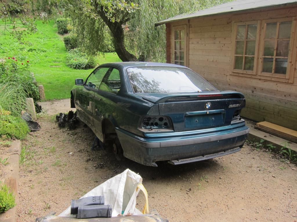

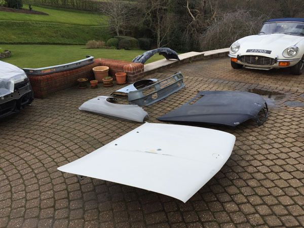

As the body work is in desperate need of some new paint I turned my attention to what's left of the donor car to make myself feel better. Must get the last few morsels off of that soon and get it cubed:
