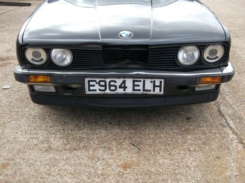

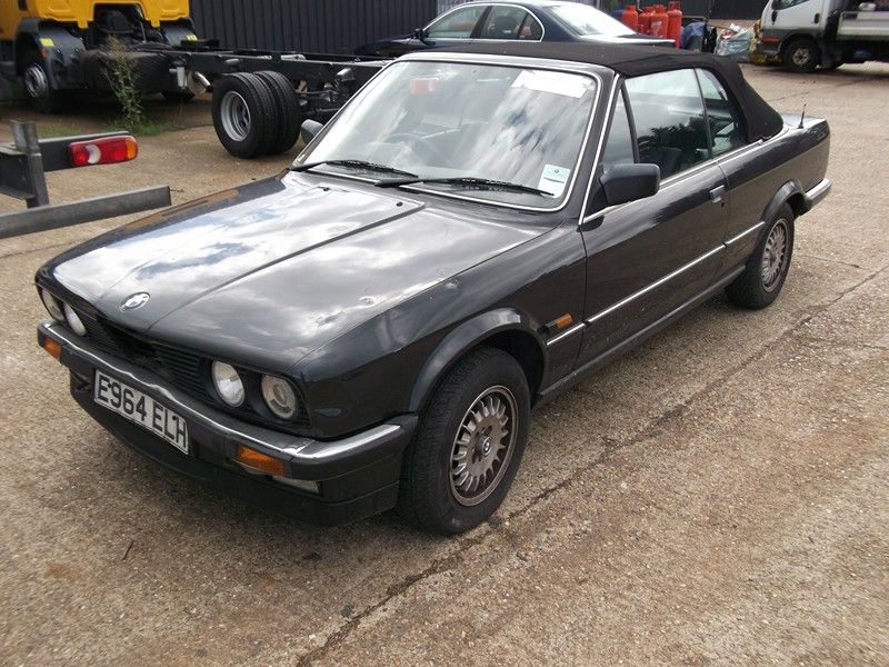

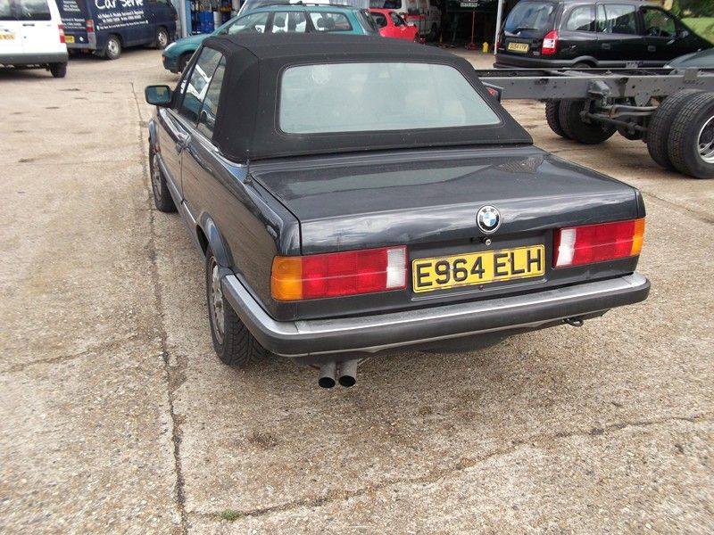

I was looking through a car auction catalogue and came across an 'E' reg black 320 manual cabrio going through as a non-runner and thought i'd give it a look. It turned out to be a reposession for non-payment of parking fines and had some front end damage but beneath the shit i think i saw a nice car (or had the dream goggles on, one of the two) :mad: . I thought i'd chuck a couple of bids in and it ended up being mine!
As i got it:

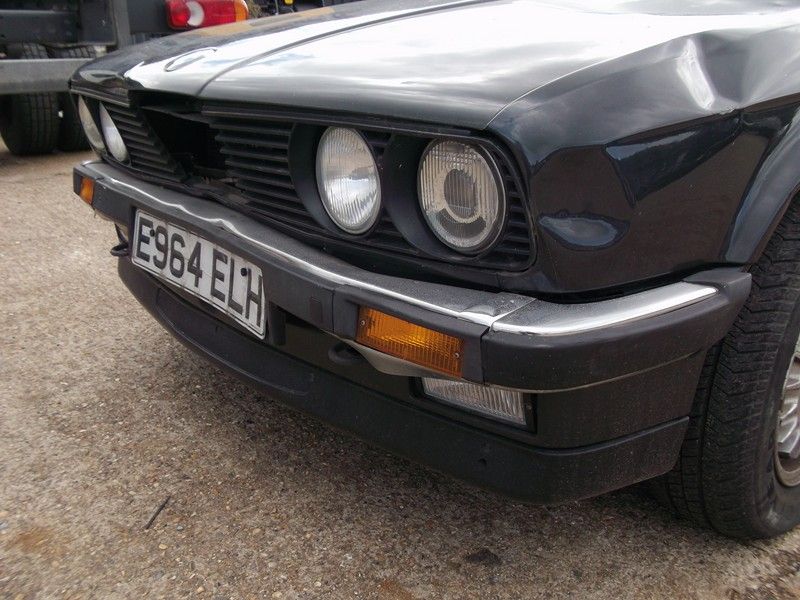

Front end tickle
Front end and wing damage
Now because this was a reposession there was obviously no keys for the car, also there was a steering wheel disklock on :-x

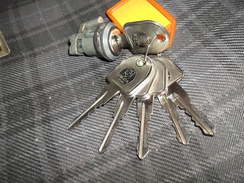

Steering lock delicately removed

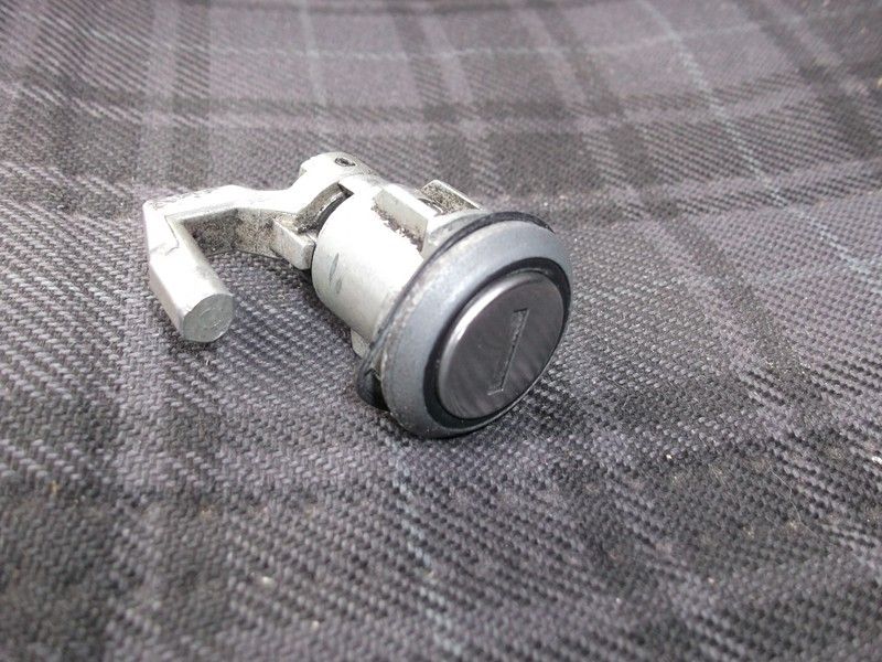

Door barrel removed for key to be cut
Got my key man to cut a key, he gave me a few choices to select from. For some reason, they all fit so i have gone from having none to 6 keys for the car!

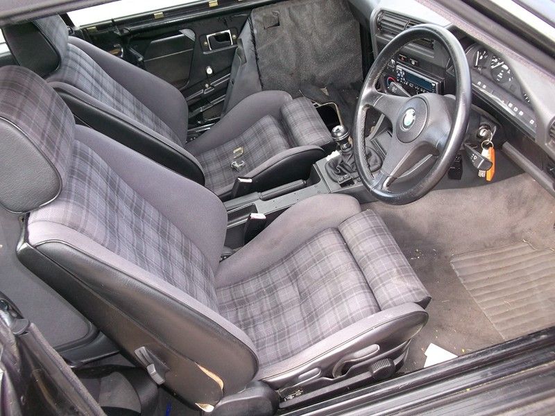

Interior in not bad nick

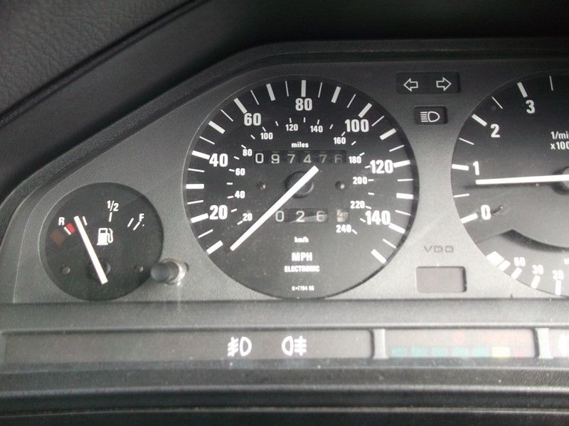

Apparently only done 97k (obviously nothing to back this up with)

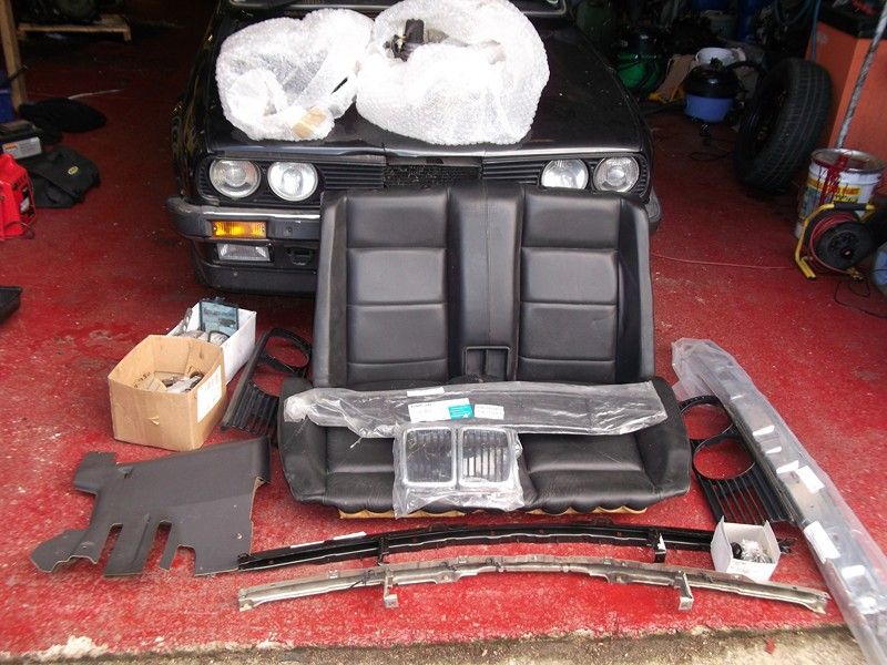

Opening the boot, i found this little lot of "spares"
There is a black leather rear bench, pair of headlights, headlight grilles, brand new front bumper, brand new centre bumper insert, brand new grille, brand new BMW bumper fitting kit, 2x valance top rail panels, lower dash trim and a box full of bits like switches, alternator, fuse box, fuel pump and more. Winner! :D

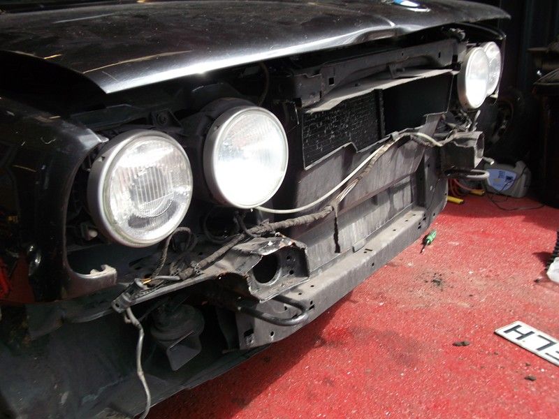

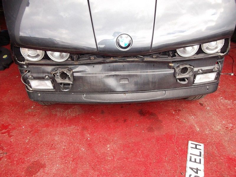

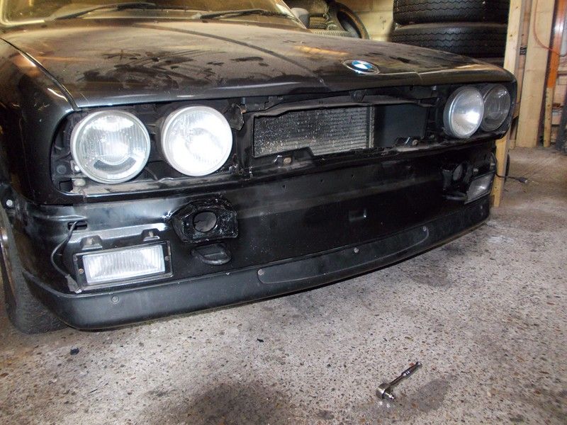

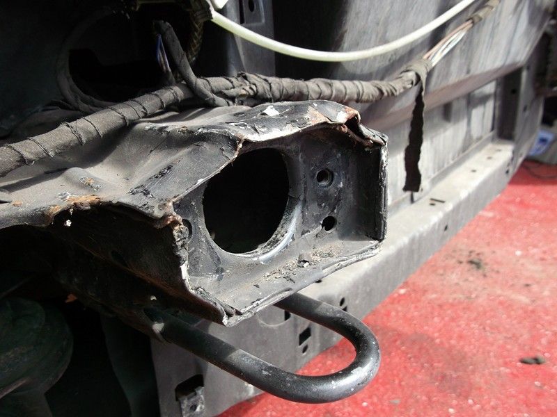

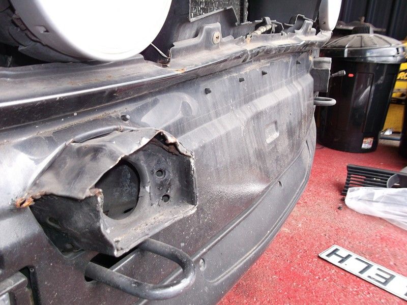

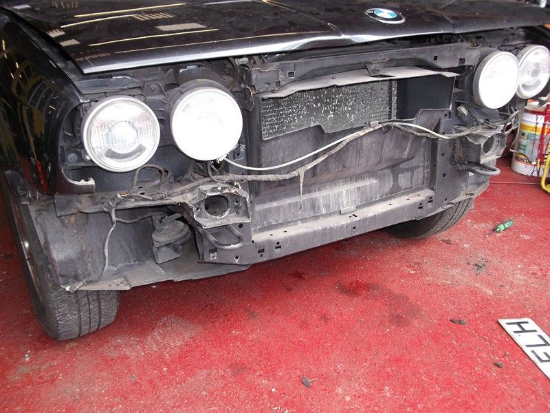

Eventually i went about taking off the front end to see how bad the damage was:
Bumper off
Bendy valance and chassis leg end
Valance off
That's definitely a bit out of shape
So out came the slide-hammer and the chassis leg ends were given some gentle persuasion into my way of thinking (straight). They are, as you would expect, pretty bloody solid so much so that i broke a slide hammer in the process (no pictures of that).

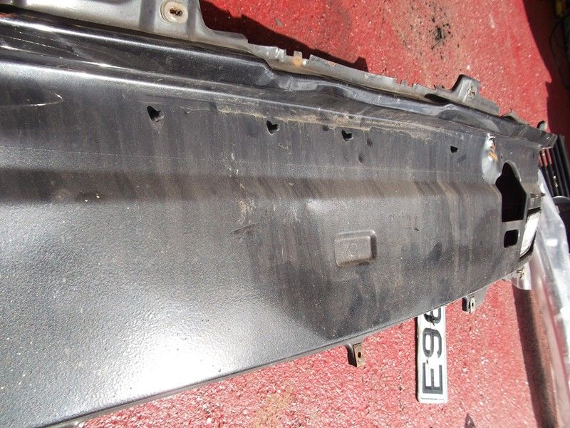

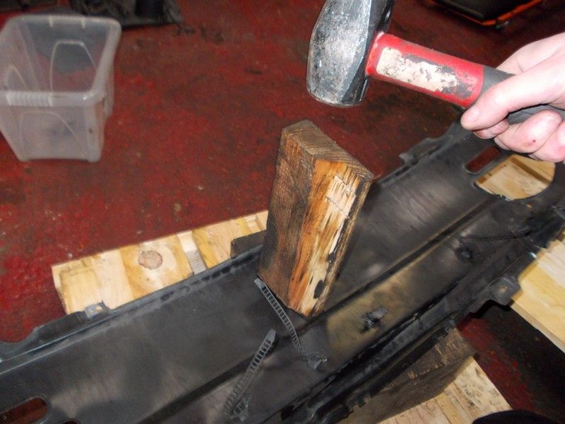

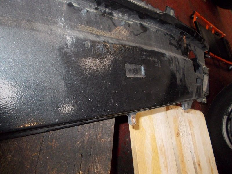

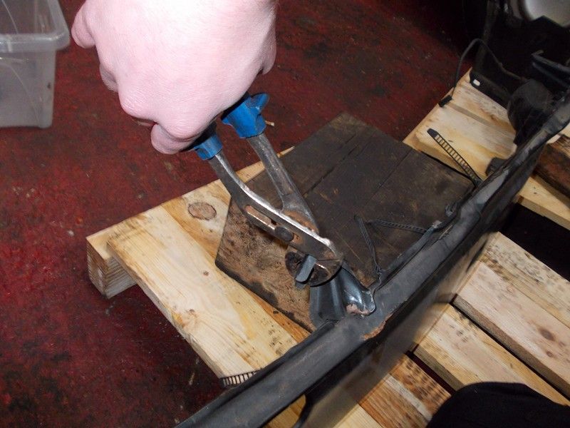

With the valance off i could see how curly the valance was and thought i have a go at panel beating
Quite bendy (hard to see in pictures)
Caution- professional at work
Looking better (still hard to see in pictures)

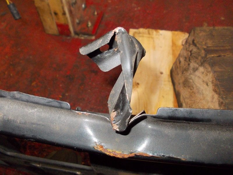

Bent bracket
More precision bodyworking techniques
The dent on the front of the rail behind this bracket is still there because it's impossible to get in behind to bang it straight.
So i threw it back at the car and it stuck
Then i toshed some random black paint over the bare paint bits and screwed the bottom lip back on. Looks alright in the picture

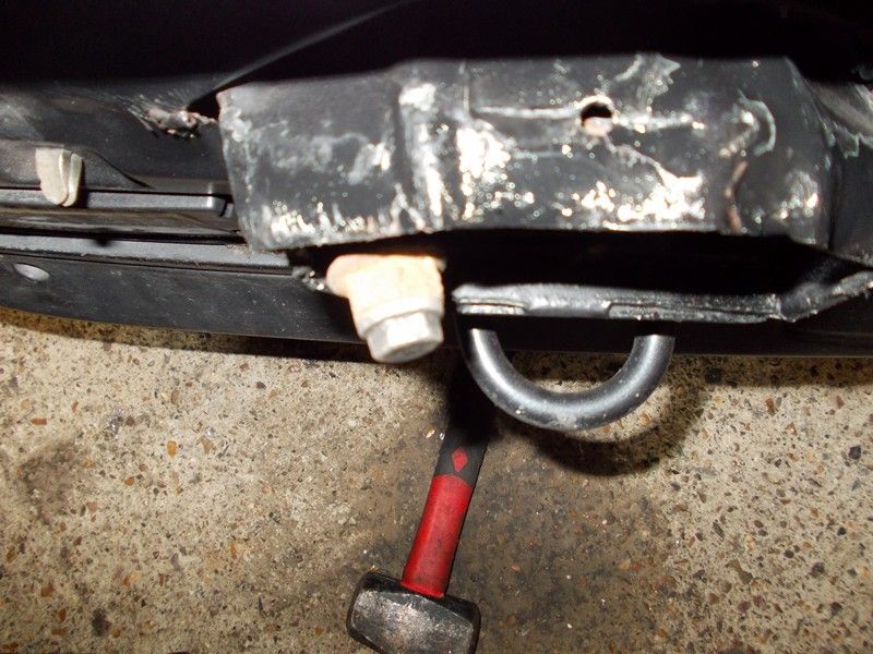

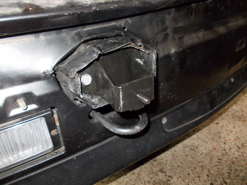

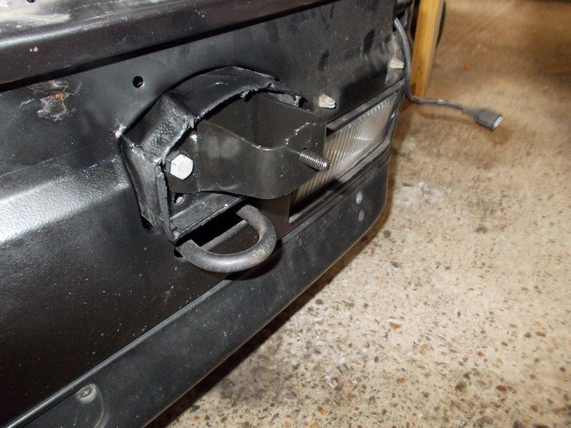

Next up i went about sticking the new bumper brackets on but the bolt holes were not playing ball. The big muthafunk slide hammer i now had wouldn't fit into the hole to straighten these out so i had to improvise
Long bolt with nut on it for increased surface area to whack
This started to move it a bit closer to true but also dislodged the captive nuts behind the chassis leg end, d'doh! However, all was not lost as this meant there was more wiggle room to get the bracket seated
Voila!
And the other side
I'm not bothered about that nasty bit to the left of the bracket as it's not visible when the bumper is fitted

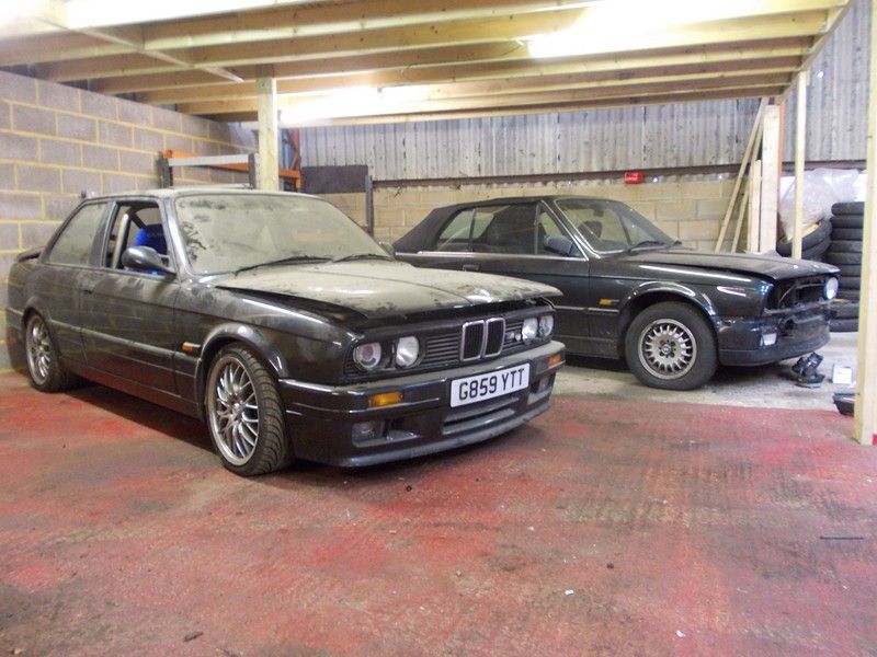

Shameless 'i've got 2 sheddy E30s' shot
The cab's little-big brother (please note i did NOT put that pipe in the grille :roll: )

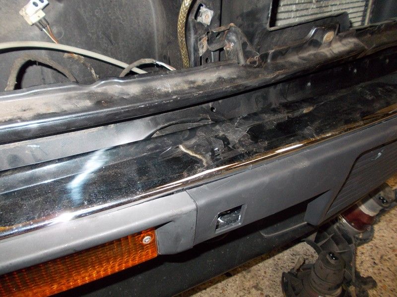

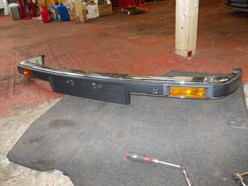

New centre bumper section lashed together with the old bits

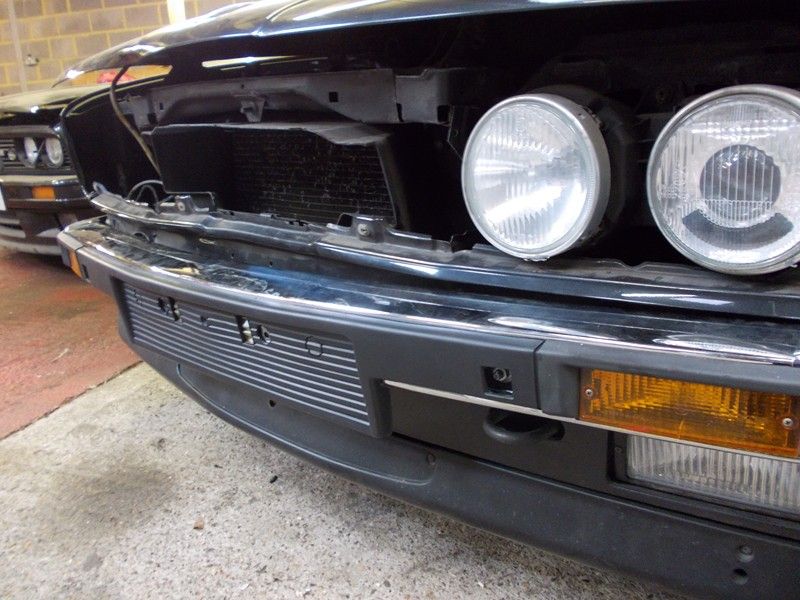

Slung it on the car
Oh, something is a little bit pissed!
So that means that either my valance is still very curly and/or the bumper bracket needs some more gentle persuasion. I've put a wanted post up for a replacement valance as i might as well get a better one than make it nice on top and still have a bent grille rail. I'll get onto the bumper brackets again when i know the valance is good.

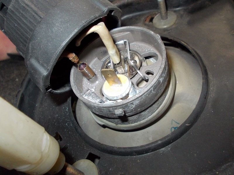

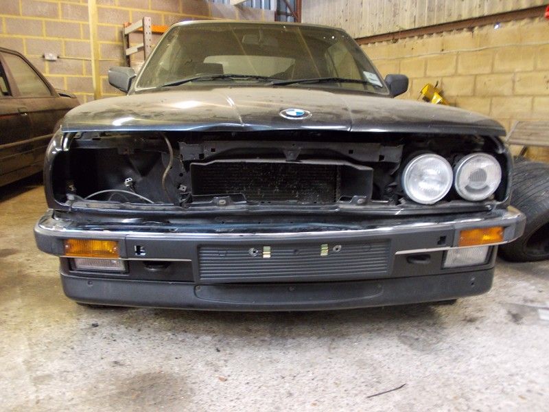

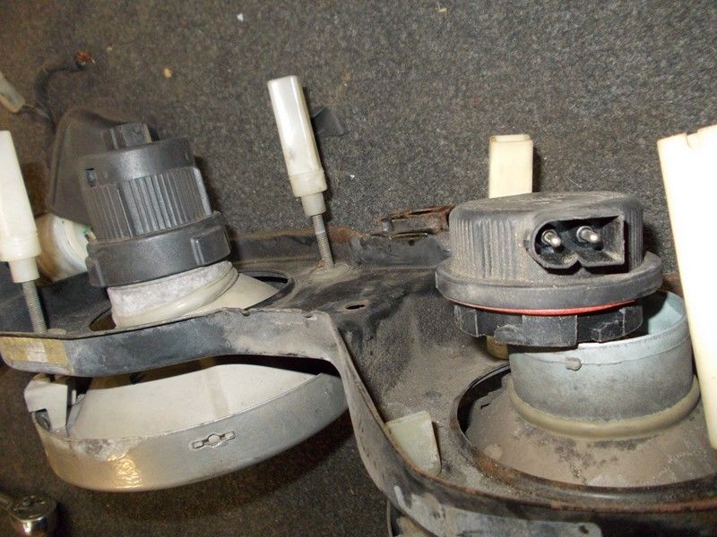

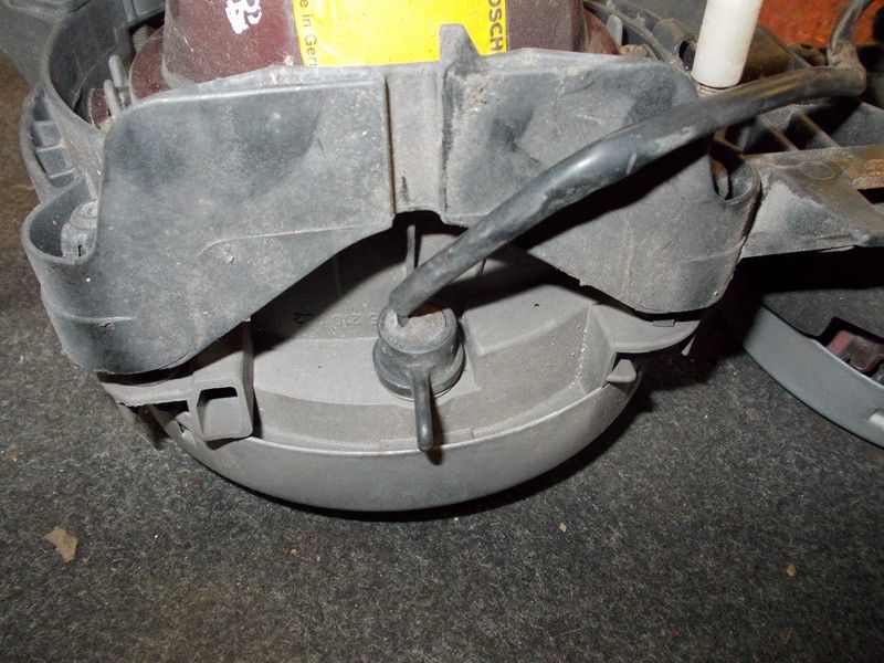

I thought i'd replace the damaged headlight for one of the spares with the car, but immediately noticed a problem
Different plugs, hmmm
Different sidelight locations
Original
New one
I had a go at swapping some bits around and remarkably the main beam plug fitted fine. Unfortunately the dipped beam unit wasn't playing ball so i was left with this
Mine is an 88 so it has the smiley face lights, i guess i'll have to source some replacements or will bullseyes fit?

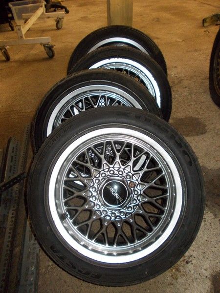

They're Ronal LS 7.5x15" and should look a bit better than the pony 14's that are on there at the moment.

Sun Mar 03, 2013 6:45 pm
Put the origional Headlights back.
They're the correct ones.
The other "New" ones a crap earlier type.
If the plastic bucket is all that is broken, you can replace them easily.

Rav335uk wrote:Put the origional Headlights back.
It is just the plastic cage/bucket that is smashed, i'll keep an eye out for one (the other side is still intact). Cheers fella
