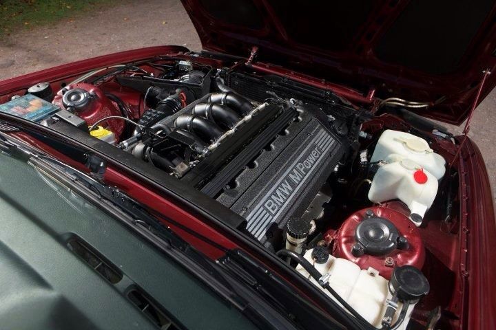

In the mean time my other mate was building this. M3 3.2 evo engined e30. The level of detail on this car is awesome, one of my favourite cars ever, but the idiot he is thought he put it for sale as it was finished, after 1 day it was sold. Such a shame.
Both have been in pbmw.
The m3 engine one you could give to your mum to drive, so easy to use, but the v8 one is a bit more of a handful.

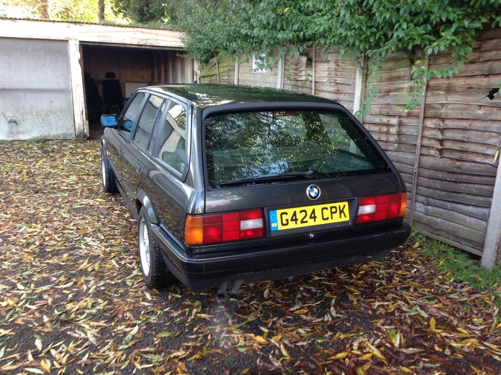

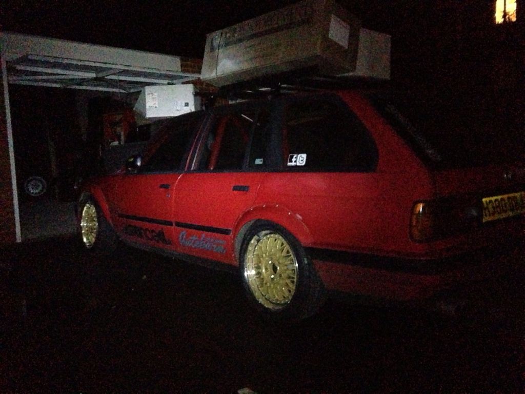

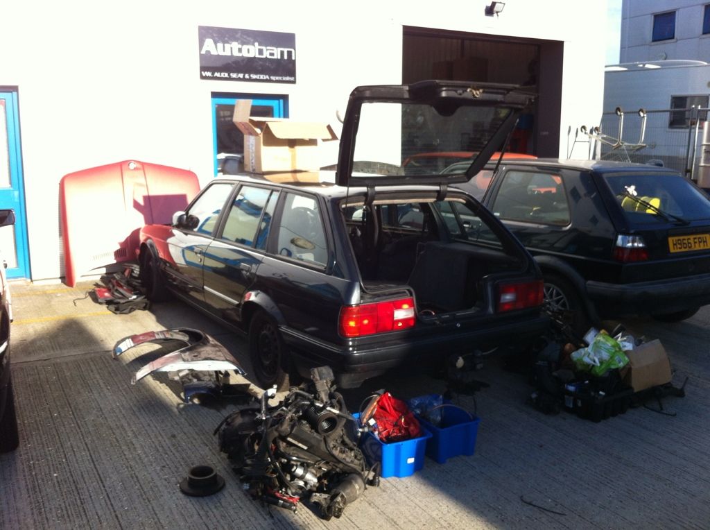

Anyway, my car. I was on the hunt and was going to do it to an e21. After looking I found the under pinning of an e21 involved a lot of work, money and hassel to get it driving like I wanted. Then by fluke I found the only ever e21 v8 I've ever seen pop up on eBay ( that green 3.0 one doesn't count), the engine just didn't suit the car. It didn't gel well and the car was a shed so I walked away.
Then mine popped up, half built car. It started life as a 318 touring and had a 325 back end and 335 in it. The guy pulled out the 335 as it kept over heating and dropped in a 4.0 m60 v8 and that's as far as he got. The engine was just resting in there. It had loads of bits with it I could sell so I took a punt on it. It was 400 miles away in near Dundee in Scotland and I'm very much in the south. So I brought a tow bar for my car and hired a trailer. My mate and I set off to get it.
It was spot on so much better than I thought. The guy had decided to concentrate on his lovely 2002 BMW and sell this.

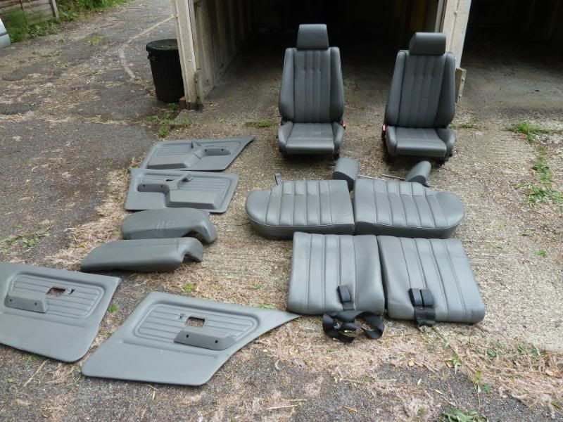

After I got it back I stripped it. Leather sold, wheels sold, horrid m tech 2 kit gone, etc.
Then I planned to supercharge it and change all the suspension, brakes the lot.
I brought the roll cage, had the engine out and resting on axel stands, sub frame off, stripped to pretty much a shell and then thought, well I'm kind of back to square one. So maybe I change the engine too.
I was planning on putting an e36 m5 engine in and scrap the touring shell.
I then decided if I was going to do that I was mad to do it to this car. It is sooooo solid and not a patch of rust. The more i took off the better i found it was.
So I thought I'd go mad with another shell and put the touring back together. I do do some stupid things sometimes.
I love early cars and thought if an e21 isn't right for me the an early chrome e30 it is.
I ended up with these :)
Oh and a vortech v1 charger with a straight cut gear set and some 440 injectors :), but that's for another day.

So I thought I'd turn my touring into a nice road going one and the gold one my out and out drift car.

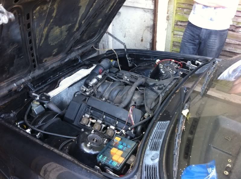

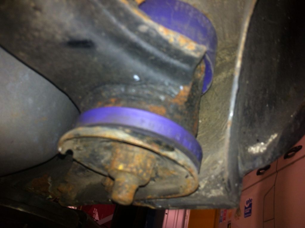

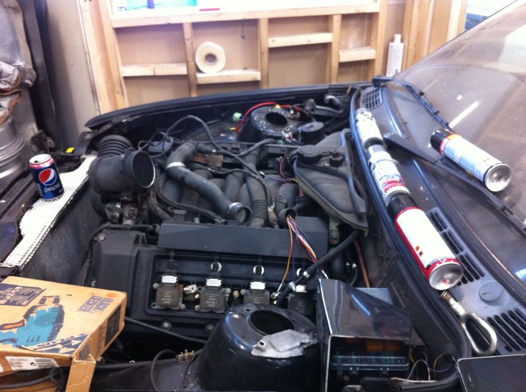

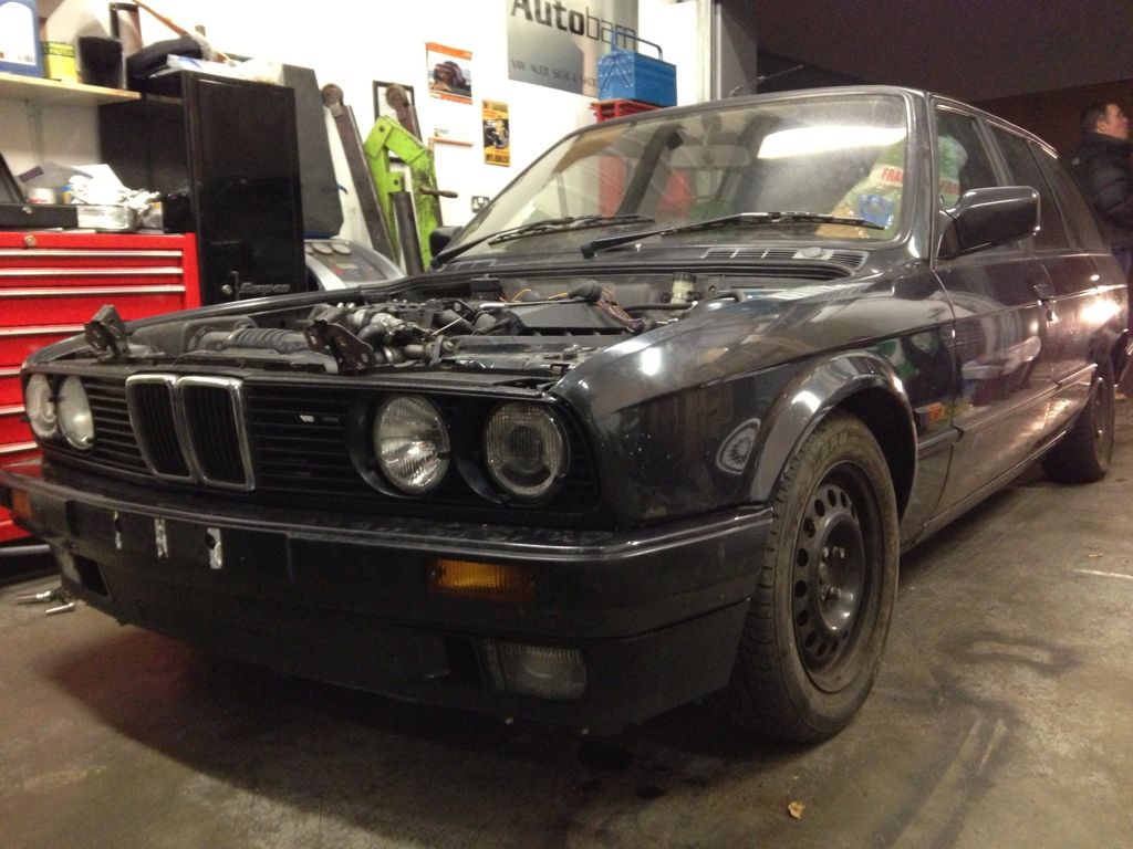

So back in with the engine, 325 front and rear subframe, polly bushes, rear discs, new lines, new rad, mocal remote oil filter, non niscal engine, new oil spray bars, z3 rack, short shift, e34 530 5 speed gear box, new engine mounts made, gaz rear shocks and Koni front (came with car).

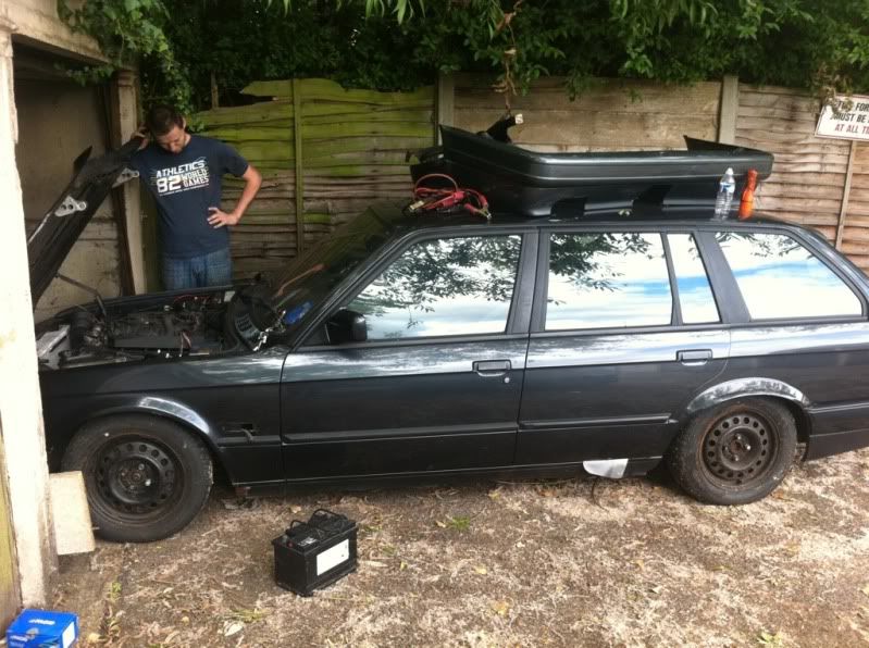

Engine is now in and part wired, it starts on the key and is a tad loud with no headers :).
540 accelerator cable fitted.
Everything is staying under the bonnet because it will be a full interior car. The brake servo was already half fitted in the bay so i will decide what to do with that.
I sold my cage and now annoying need to buy up loads of interior bits I sold last year.

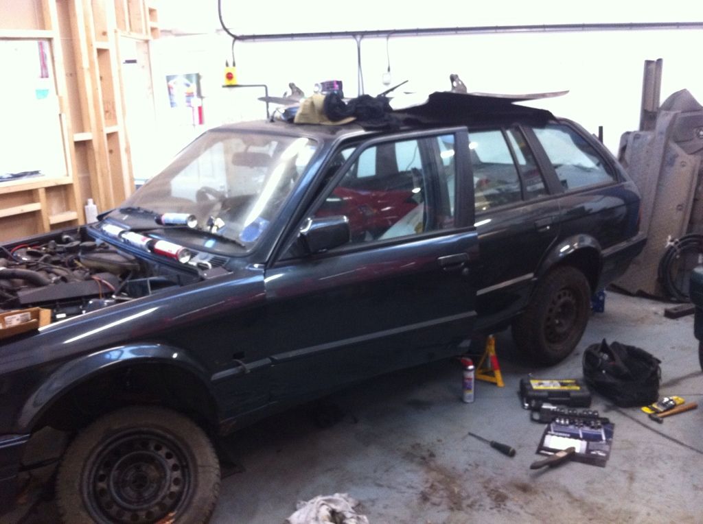

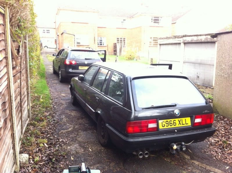

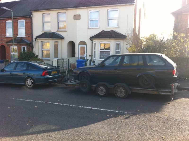

After I brought the car it sat for 6 months in my mates garage. I then moved it to my friends work shop which is next door to xsport hence the pics of there lorry.
I'm sure I have missed tons, but I'll updat as I remember.
As it leaves my friends garage.
Seats all out and sold
Horrid kit gone

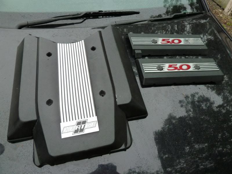

Rare Hartge covers sold, it's not a 5.0 so wanted them nowhere near the car.
Wheels gone

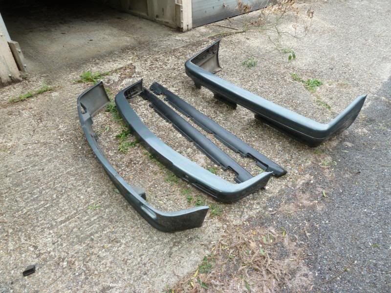

All this helped fund more bits for the car. It came with a boot full of bolt on bits which i sold.
I still have to put std rear lights on, amber indicators, std front lights, etc.

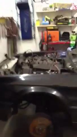

Here's it on its first start up.
http://img.photobucket.com/albums/v662/ ... db06ed.mp4

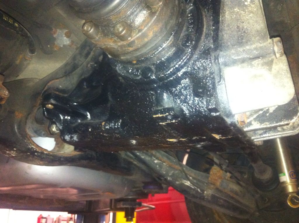

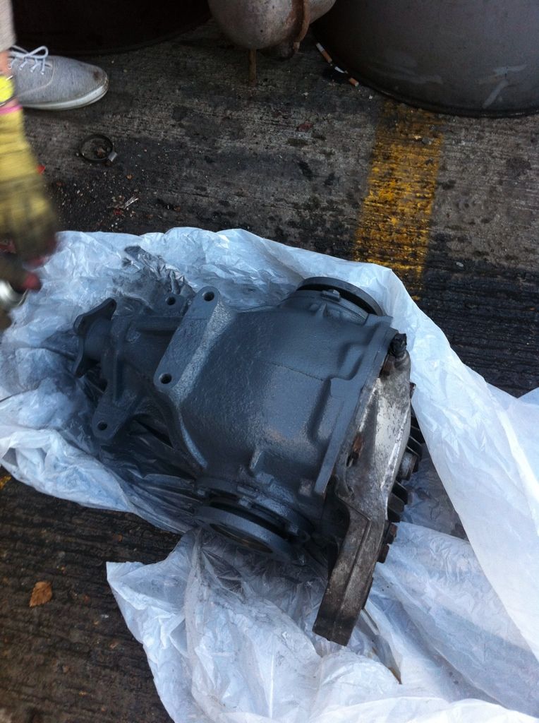

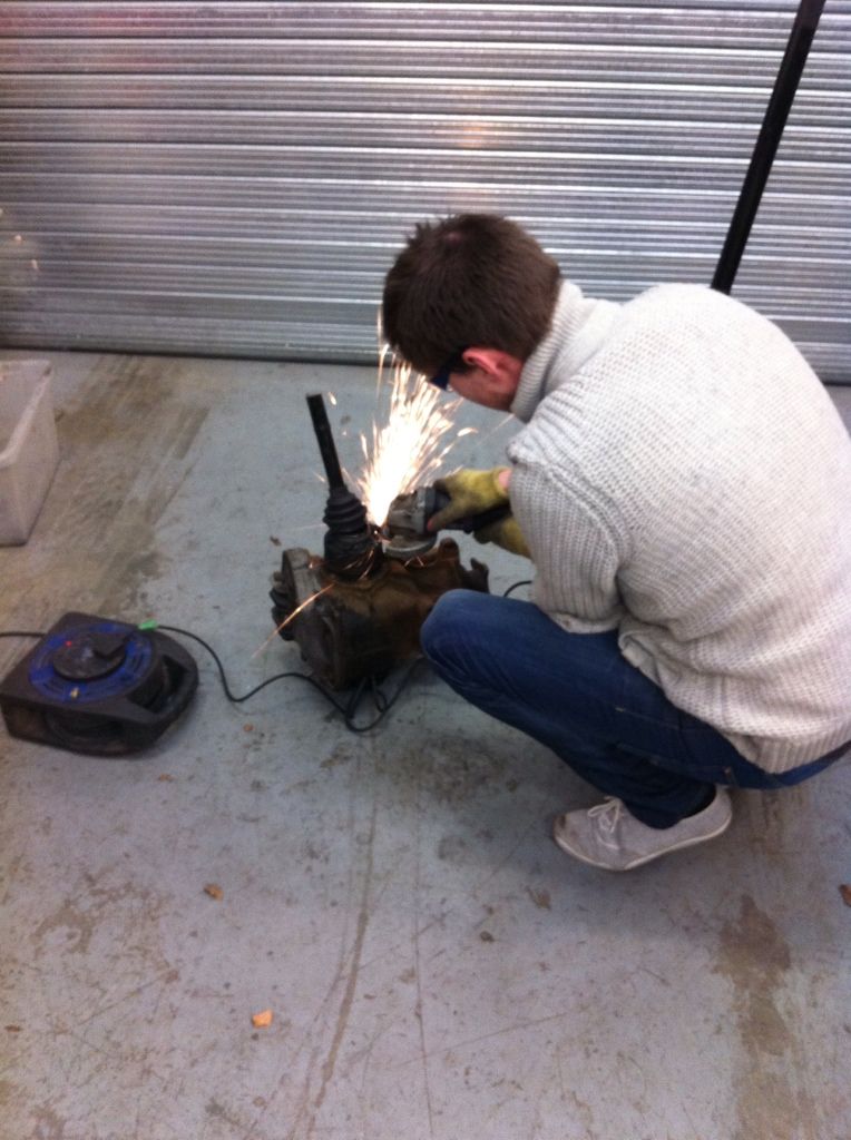

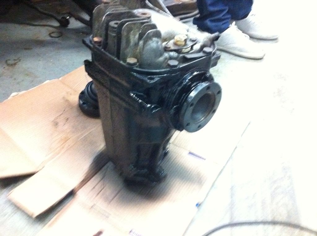

3.64 LSD painted and fitted

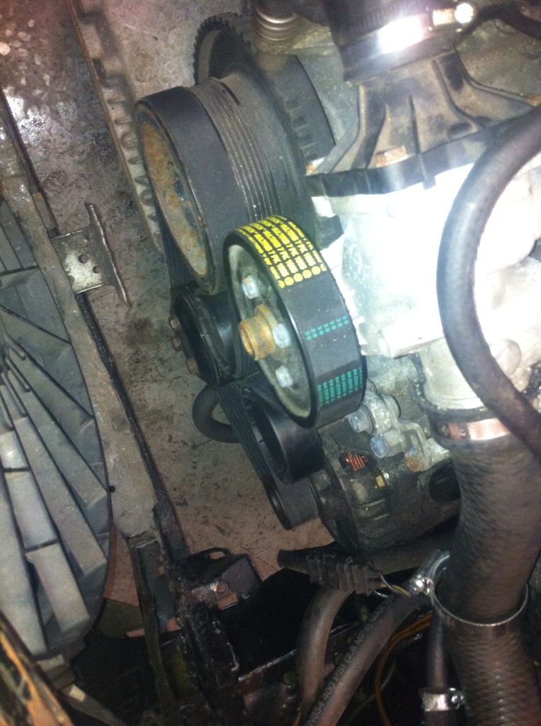

New water pump Drive belt fitted

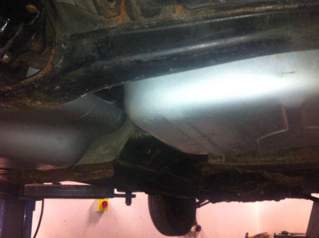

New fuel tank

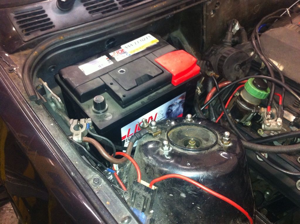

New battery, but I have decided I may move it to the boot as I want the header tank to go in this space.

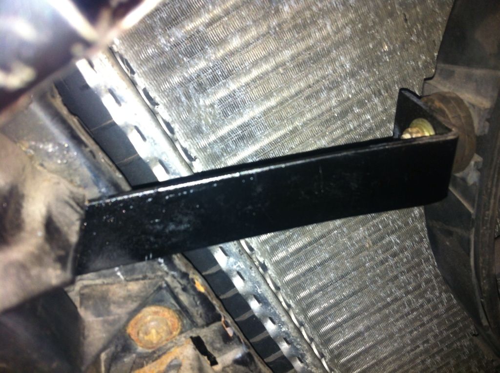

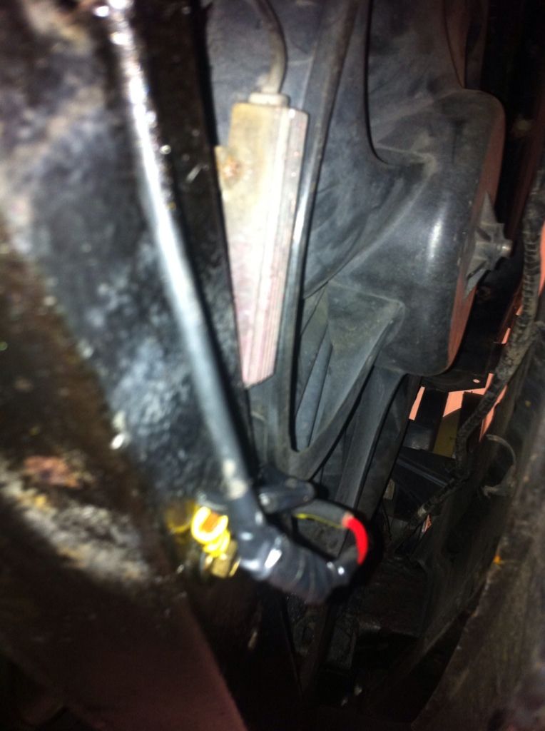

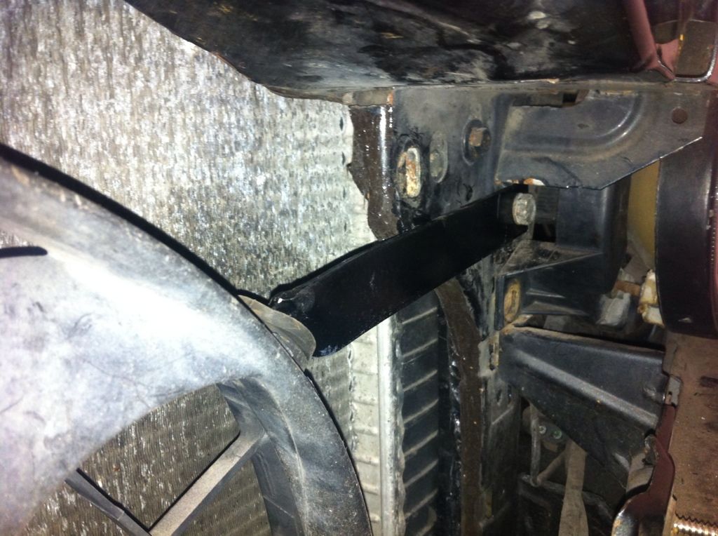

Metal brackets made painted and fitted for the electric fan

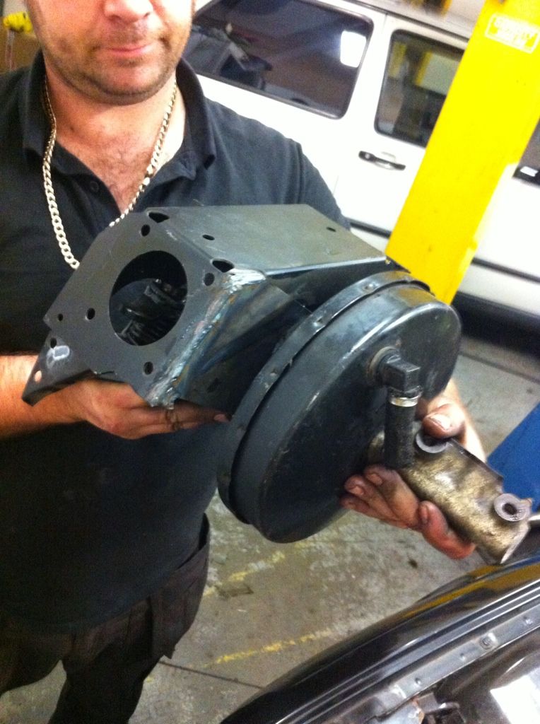

At some point the brake servo has been fitted here in the past, I think I may move it inside the car as I'm not a fan of the look of it here.

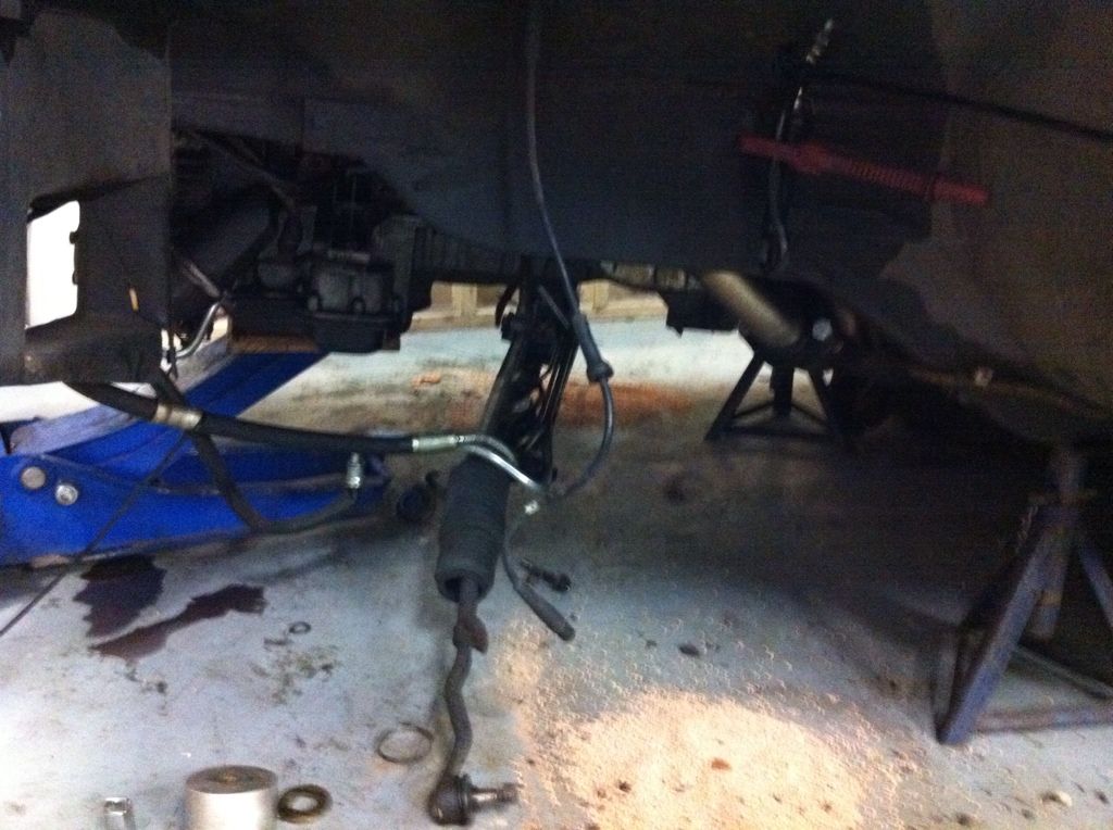

Subframe off, suspension and brakes being changed.

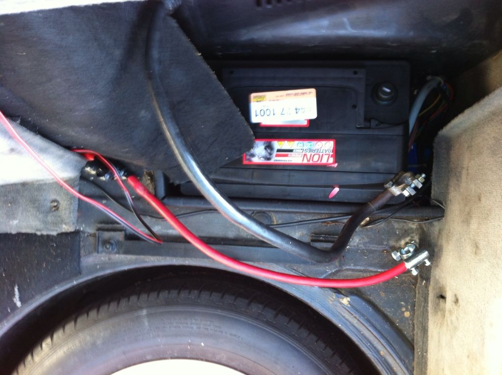

Another new battery, bigger and now in the boot with 4 gauge cable up the car.

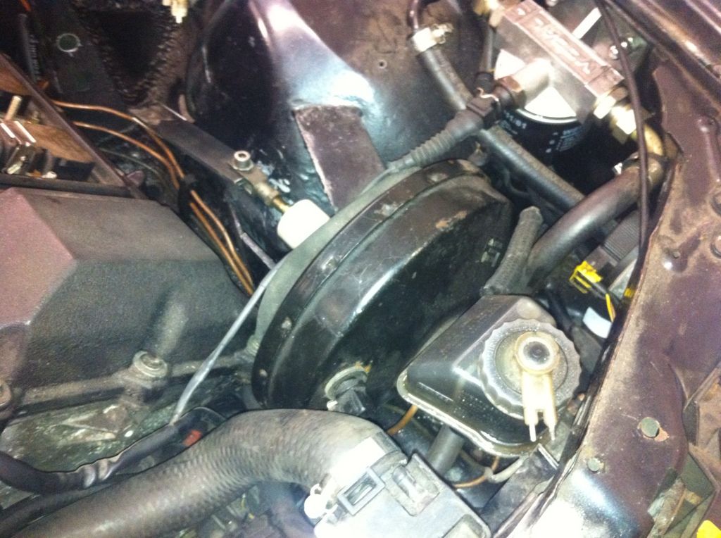

Brake servo moved inside the car, the old brackets on the wing were cut off, smoothed, filled and painted so the wing looks like stock now.

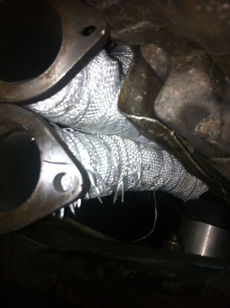

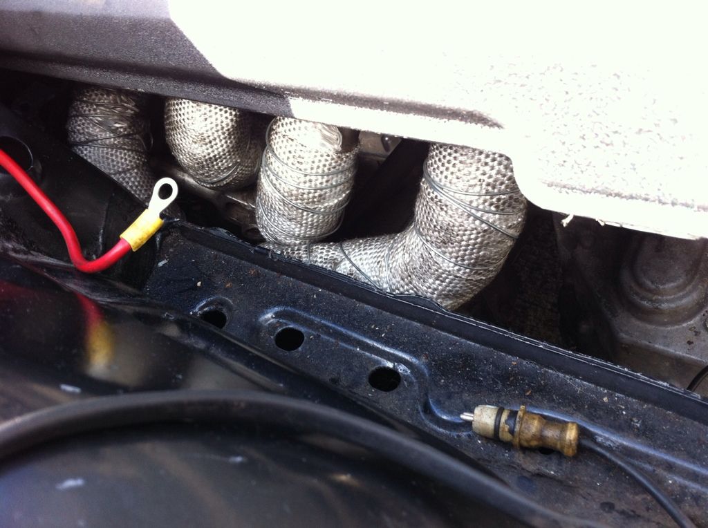

Headers wrapped and fitted with new gaskets and copper studs.

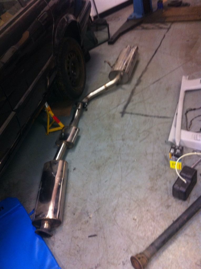

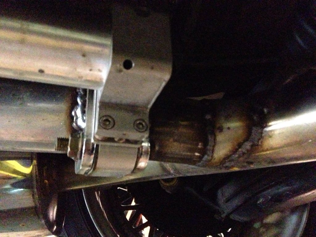

Exhaust fitted, too quiet so the centre box came out.

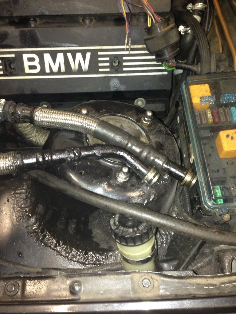

New oil lines made and fitted.

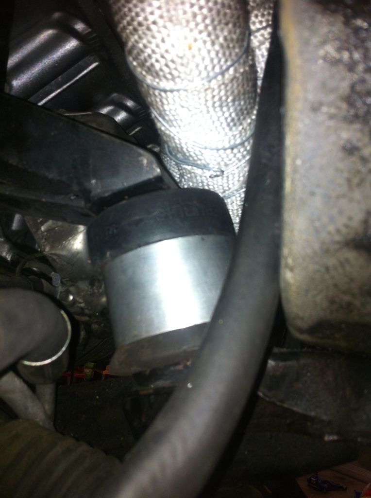

New engine mounts, trusty hockey puck in one side to balance it out.

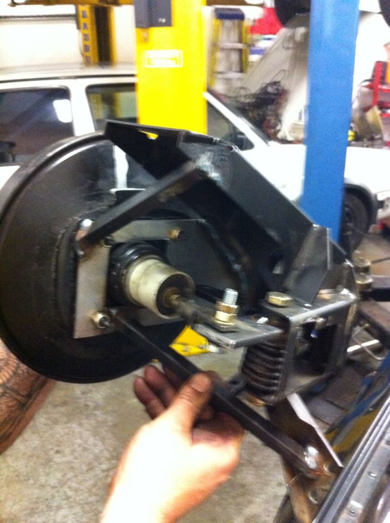

Brake servo bracket made, painted and fitted into the car. The resivour will be remote mounted in the bay. I don't like how most people leave this on top and you can't access it.

Polly bushes.

Oil lines, these were a sod to get right.

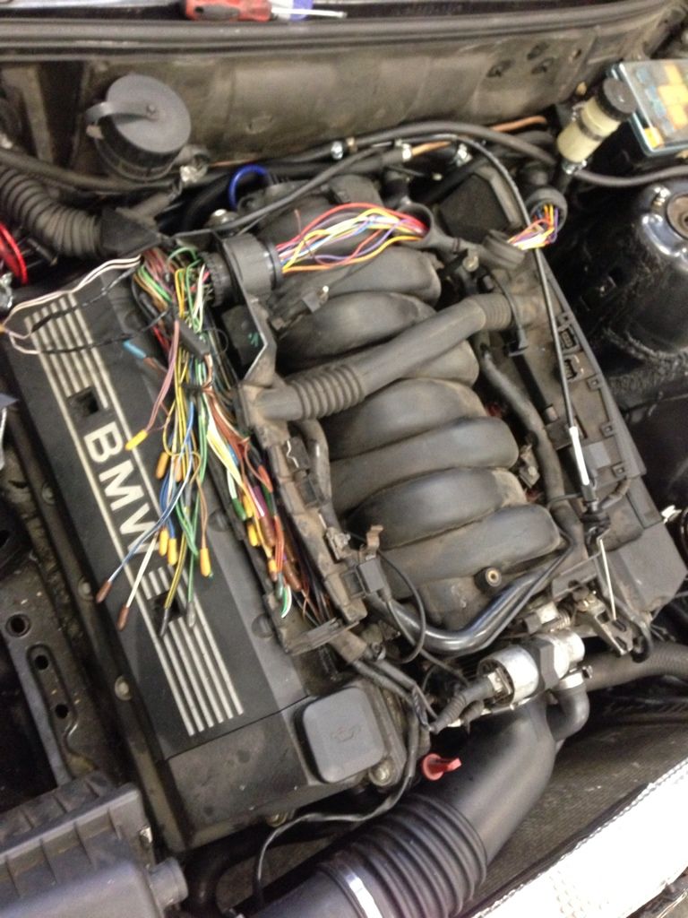

A bit of wiring.

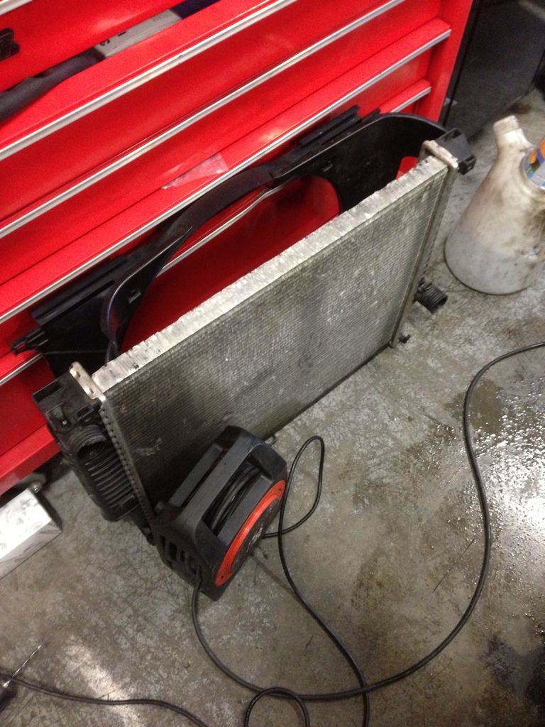

Old rad out
Touch up the paint a little
Them the new thicker 3.2 evo m3 rad in with some new mounting brackets made.

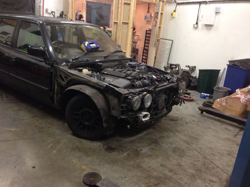

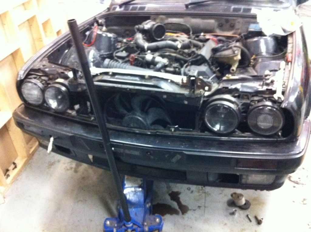

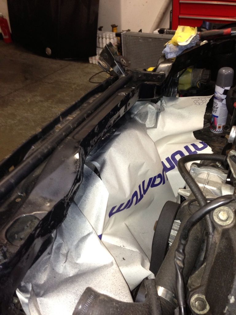

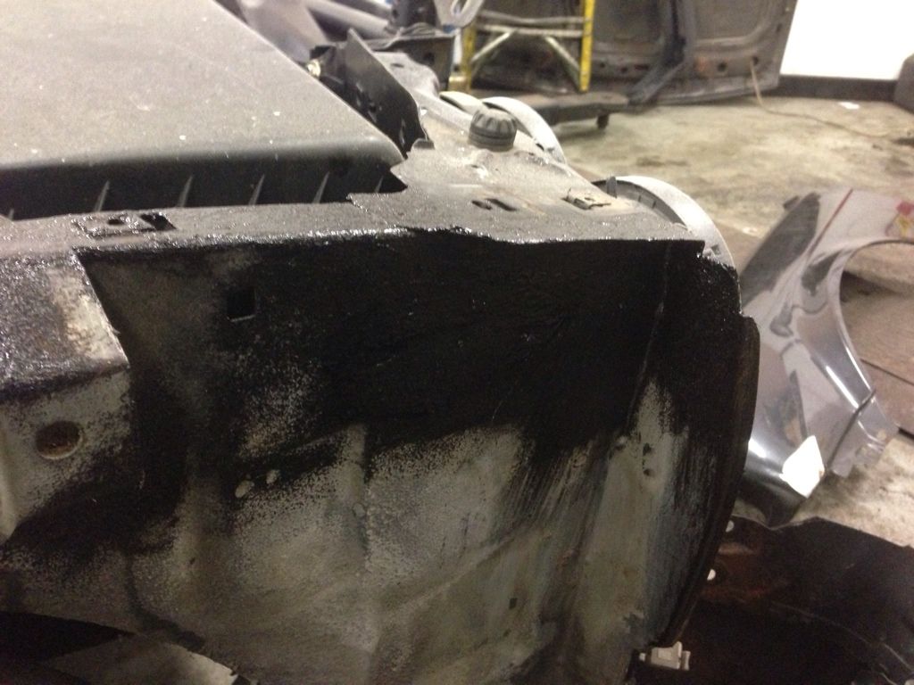

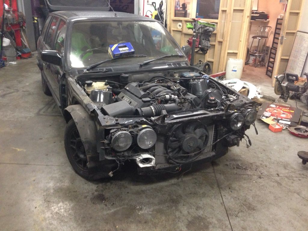

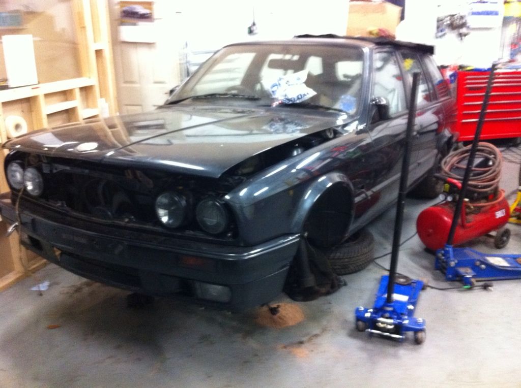

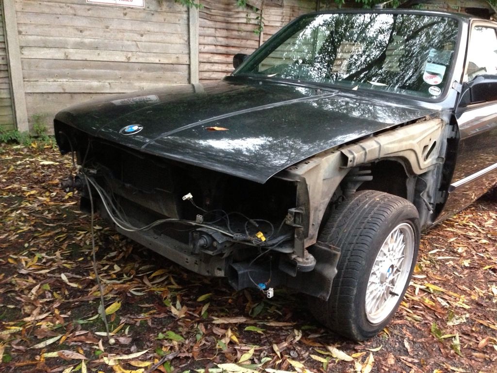

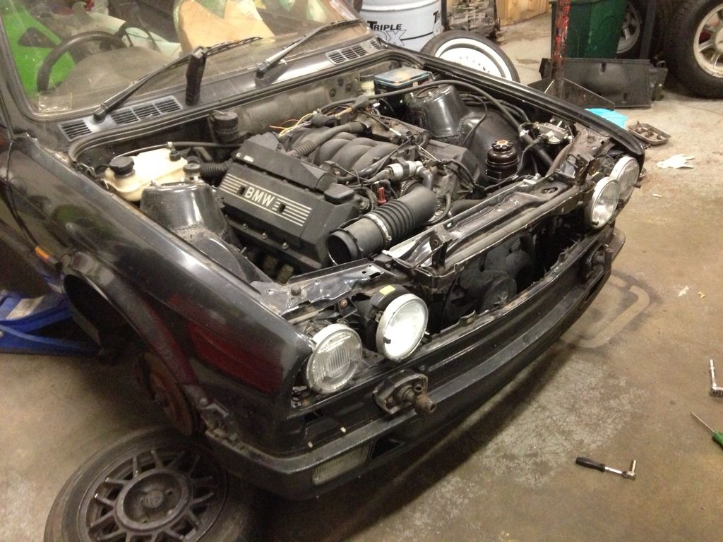

All the front stripped off.

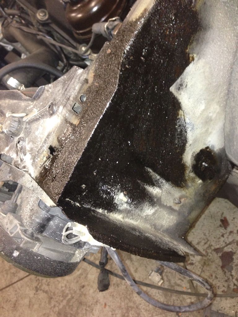

Just gave a few bits a sand back and some underseal just because I'm fussy.
Brakes are all fitted and bled too :)

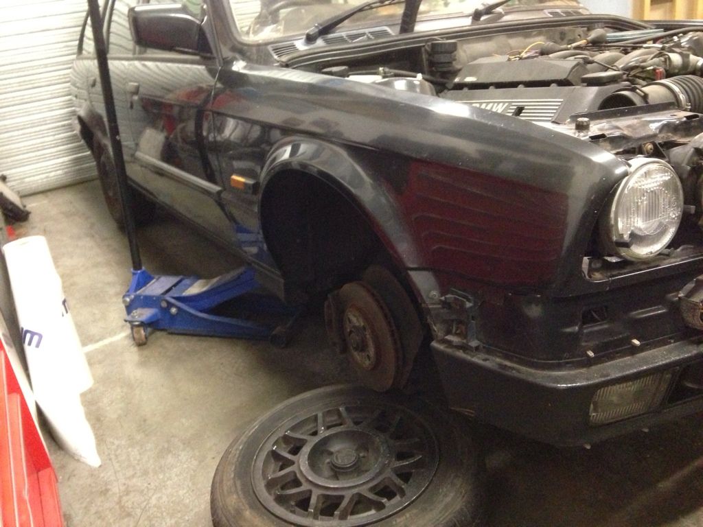

After moving house and a holiday I've finally had some time to crack on with the e30.

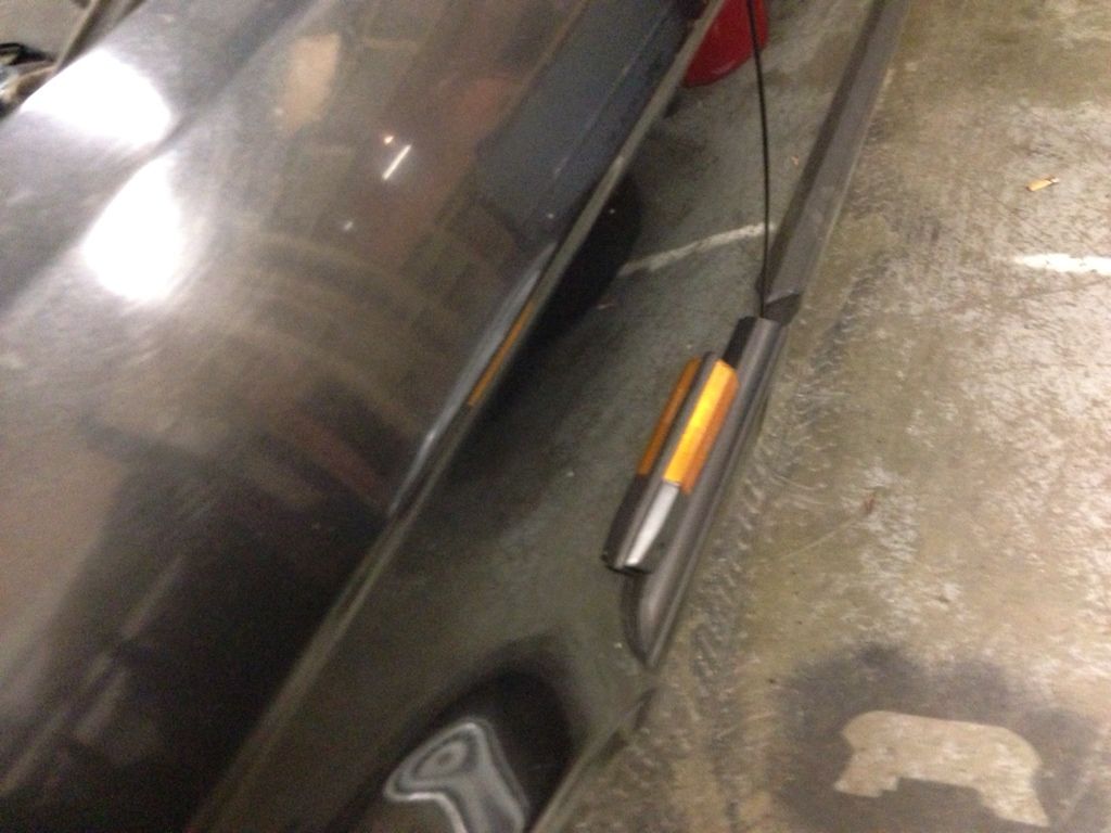

Fitted up wings, front panel, bumper off the doner car, put standard lights, grill and Amber's back on it.
Fog lights and brake ducts all in. The car loooooks sooooo much better for it.

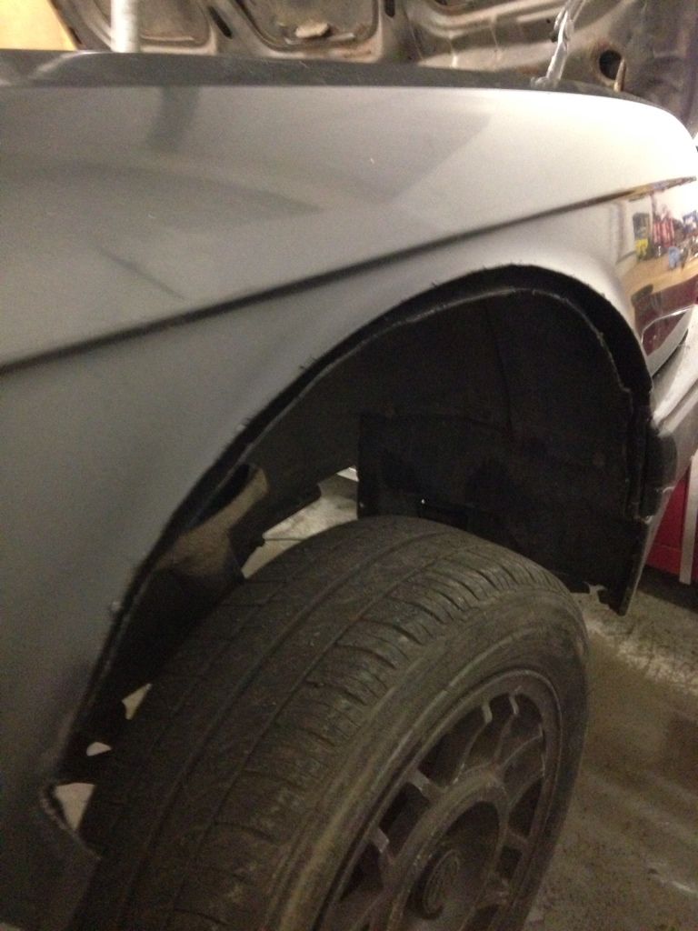

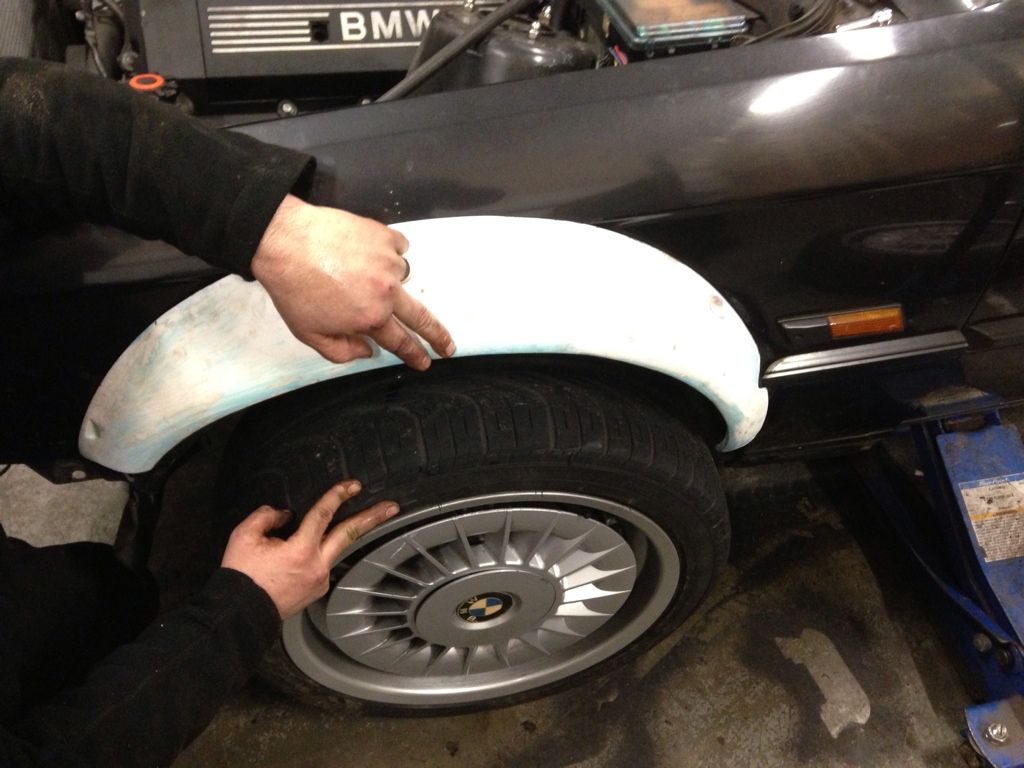

Then trial fitting wheels and making the arches.

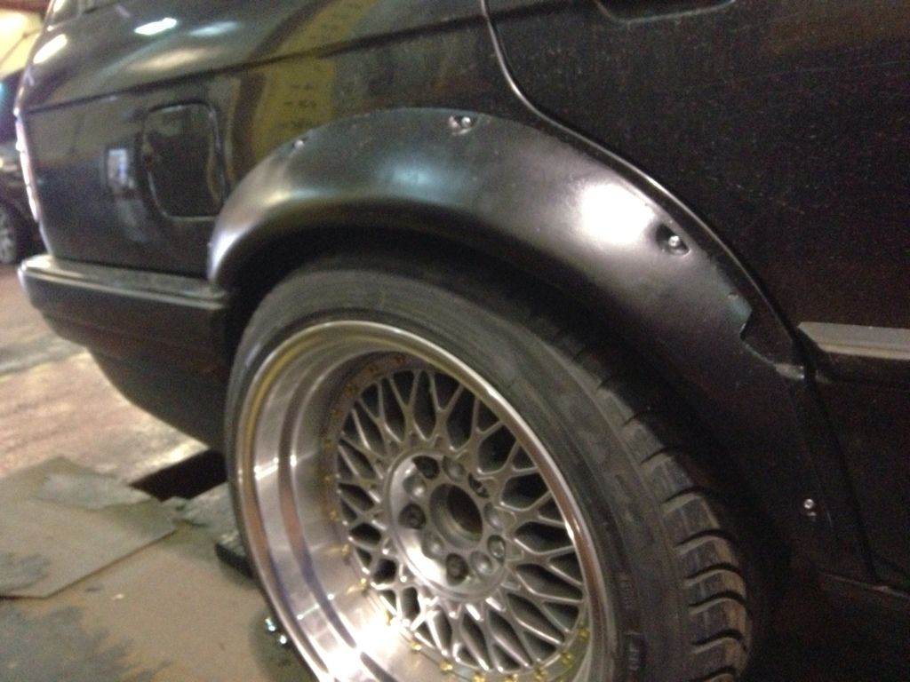

More done to it.

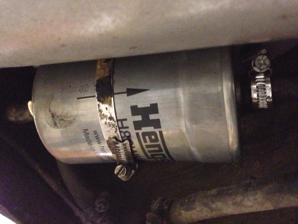

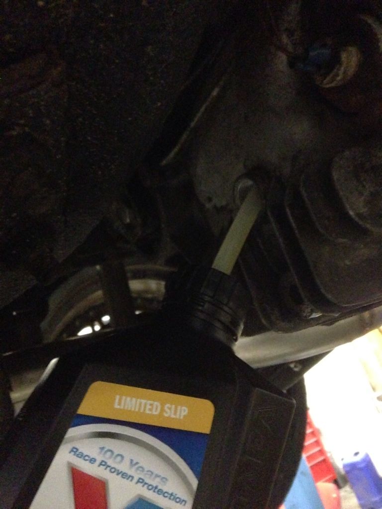

LSD diff oil changed, the old stuff looked like new which is good.
Fuel filter done.

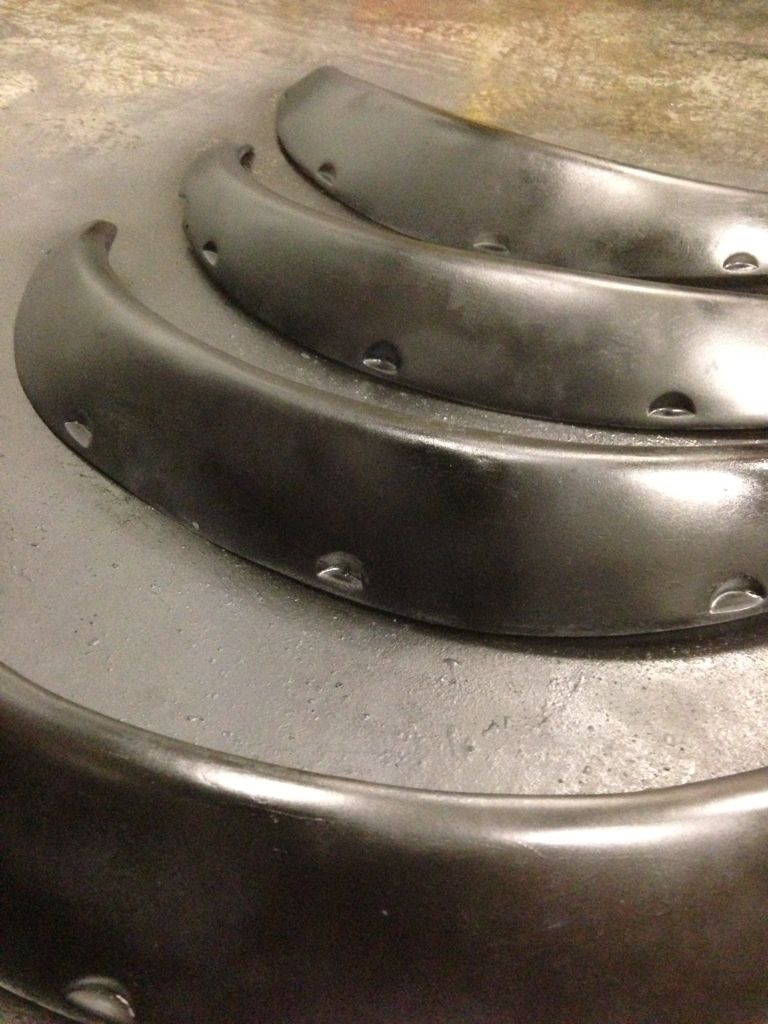

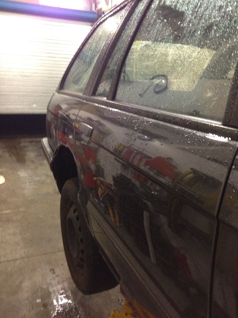

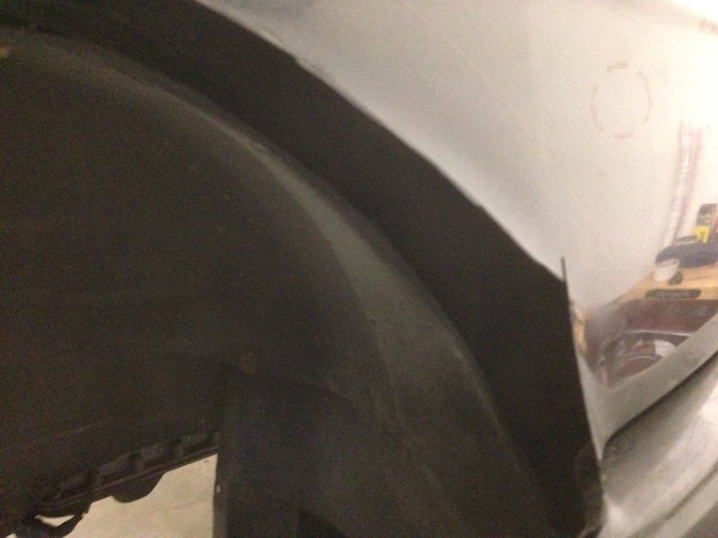

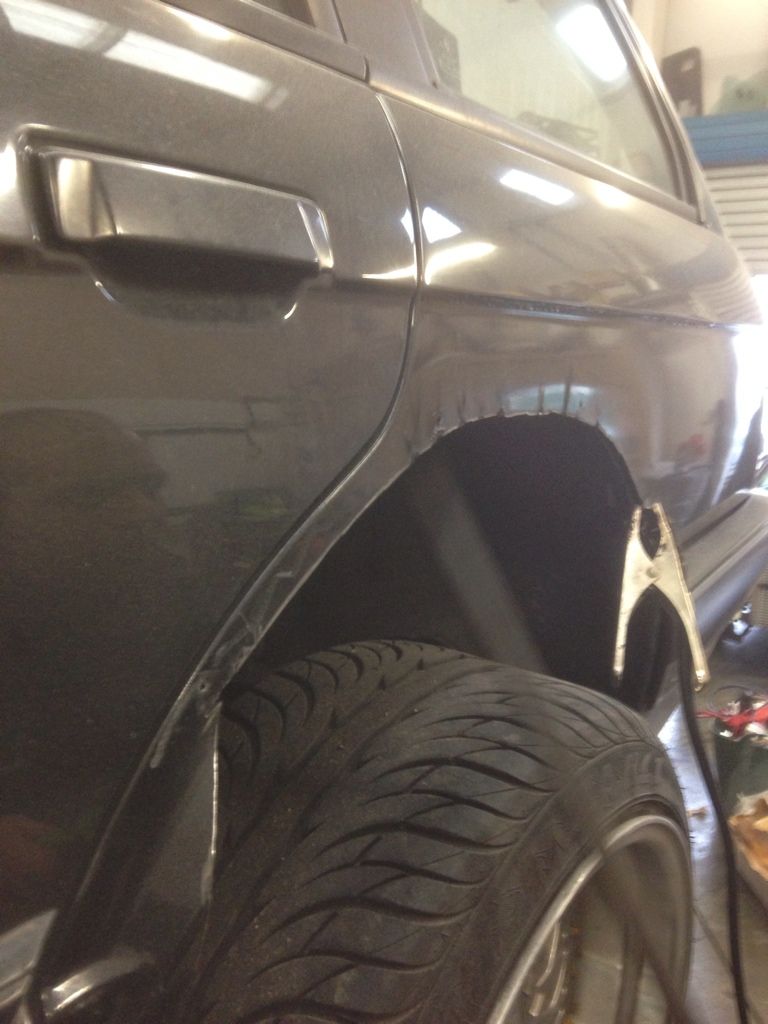

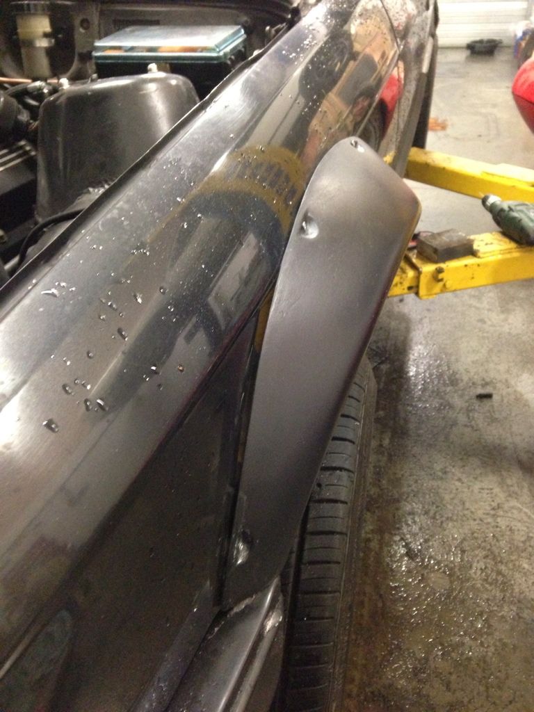

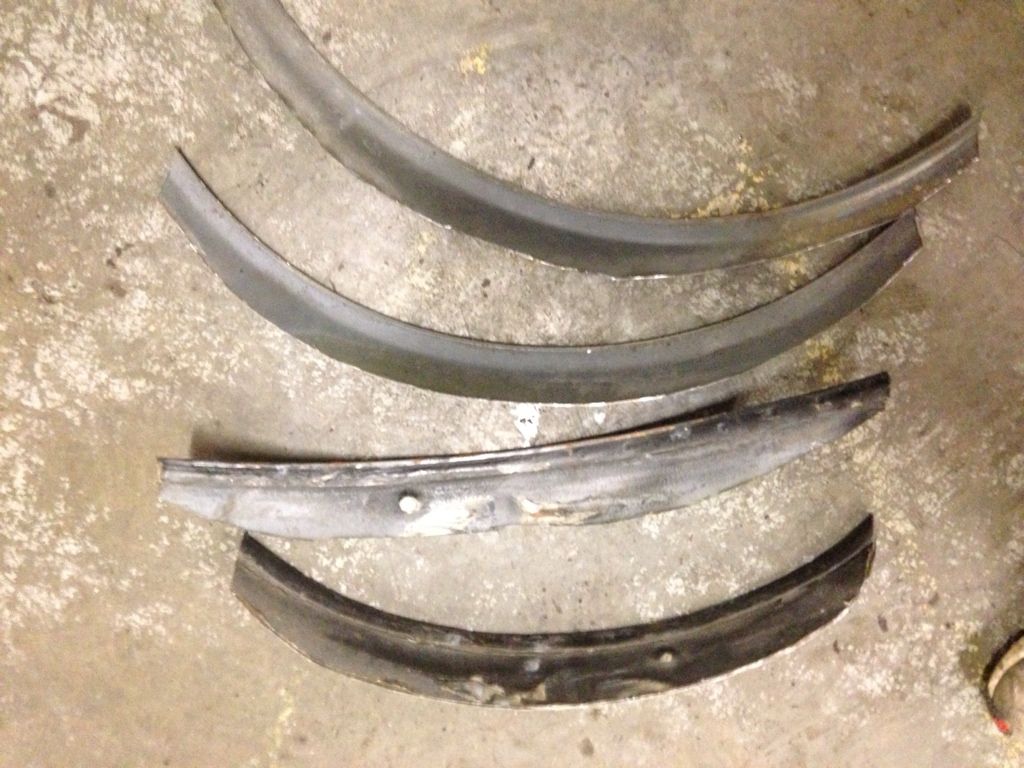

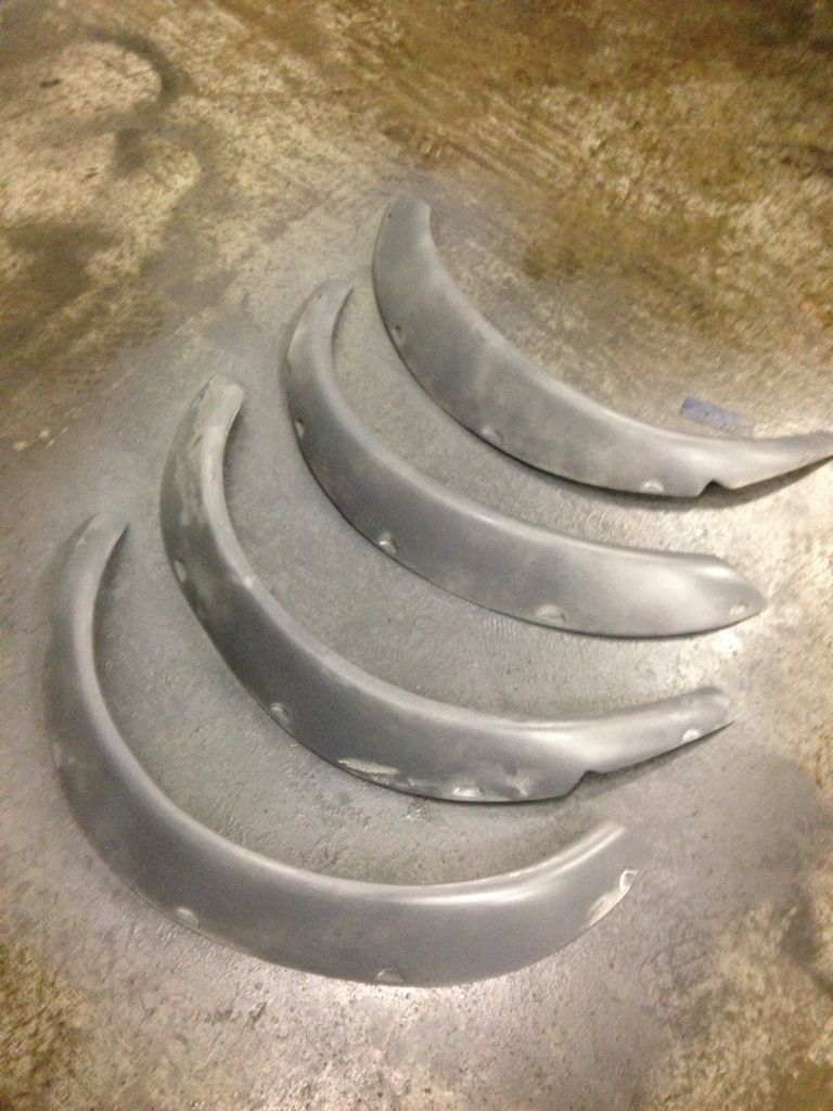

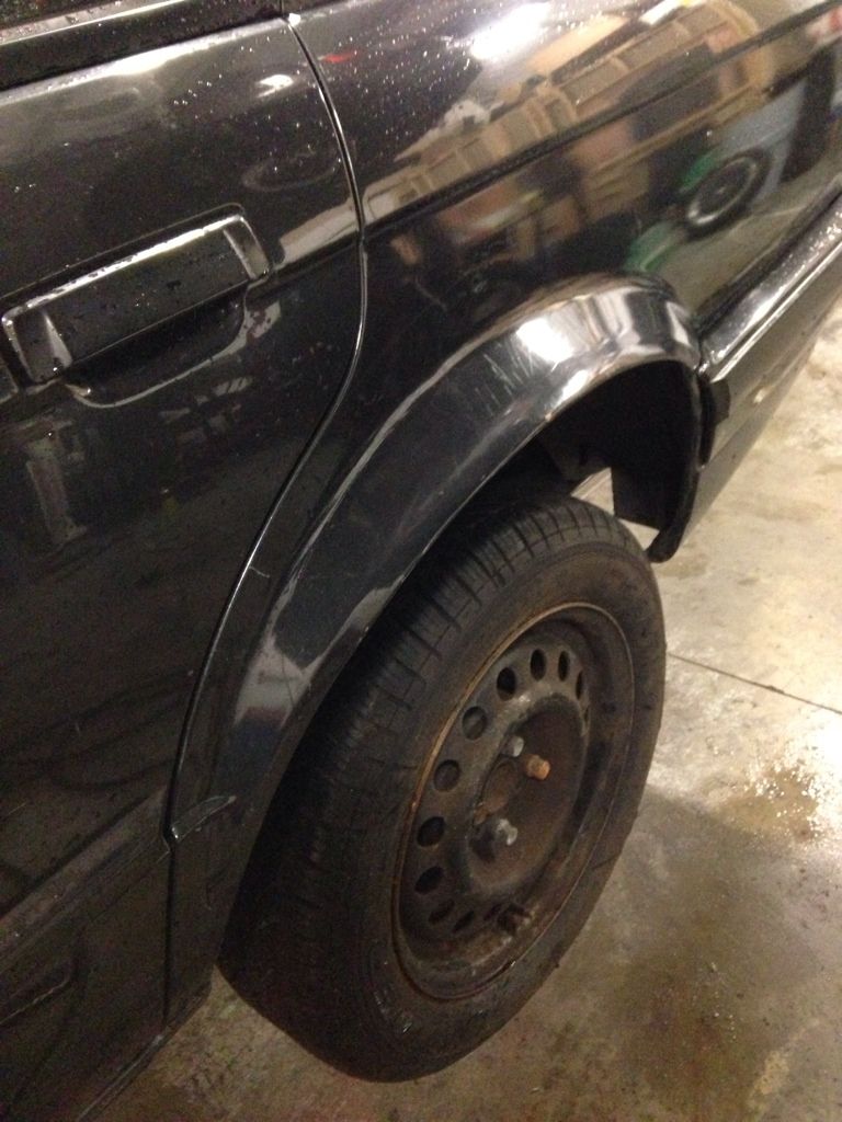

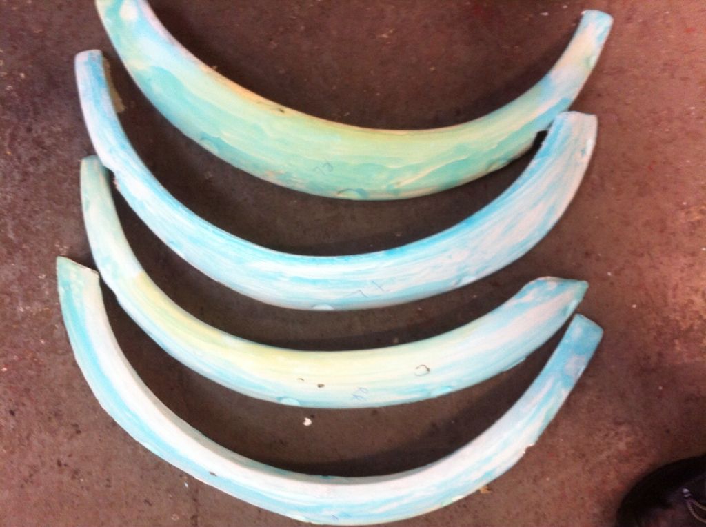

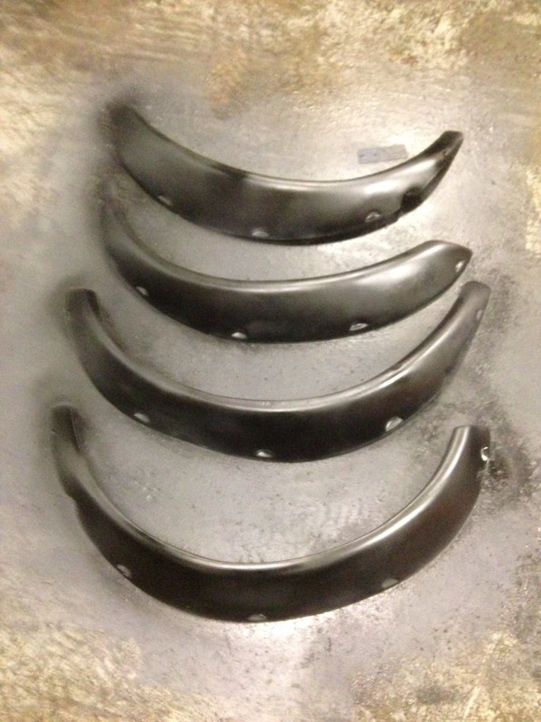

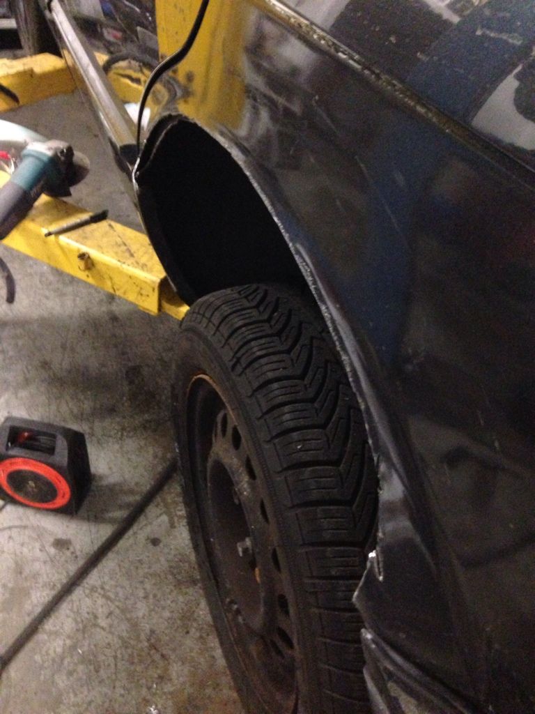

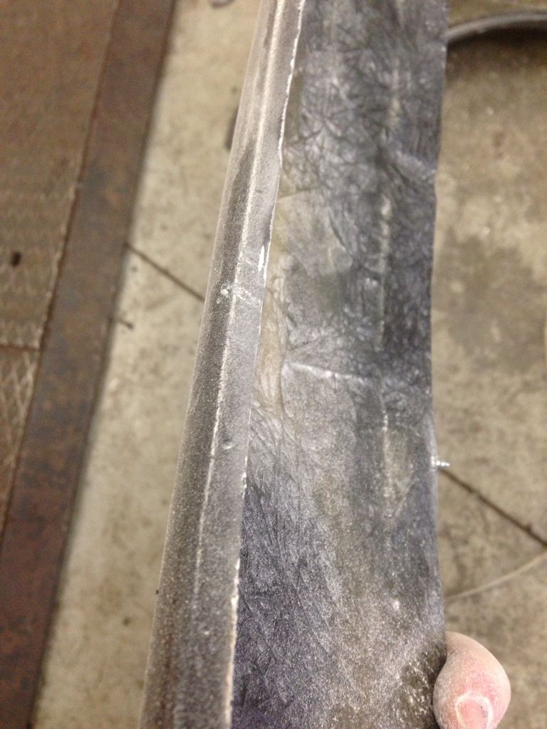

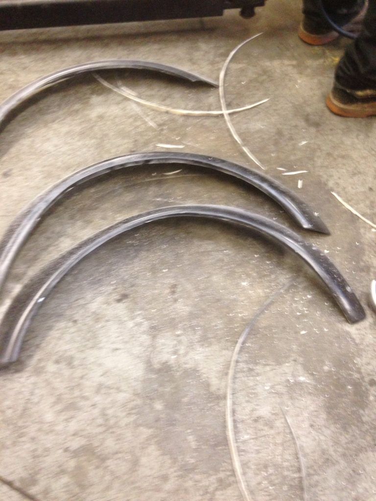

Arches smoothed and welded, then painted and just to make sure they were them filled with sealant.
Vabric Arches painted ready for trial fitting.
I didn't have any wheels for it, so these have gone on. Tyres aren't dot on either, but I didn't want massive stretch on it.

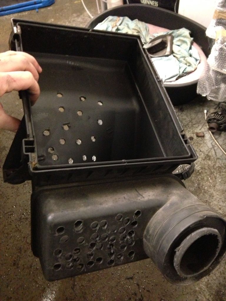

A 3.0L v8 air box is a bit smaller and with some chopping it fits nicely. I've drilled it too so it gets a bit of air. These engines like air boxes and not cones.
New std filter in too.

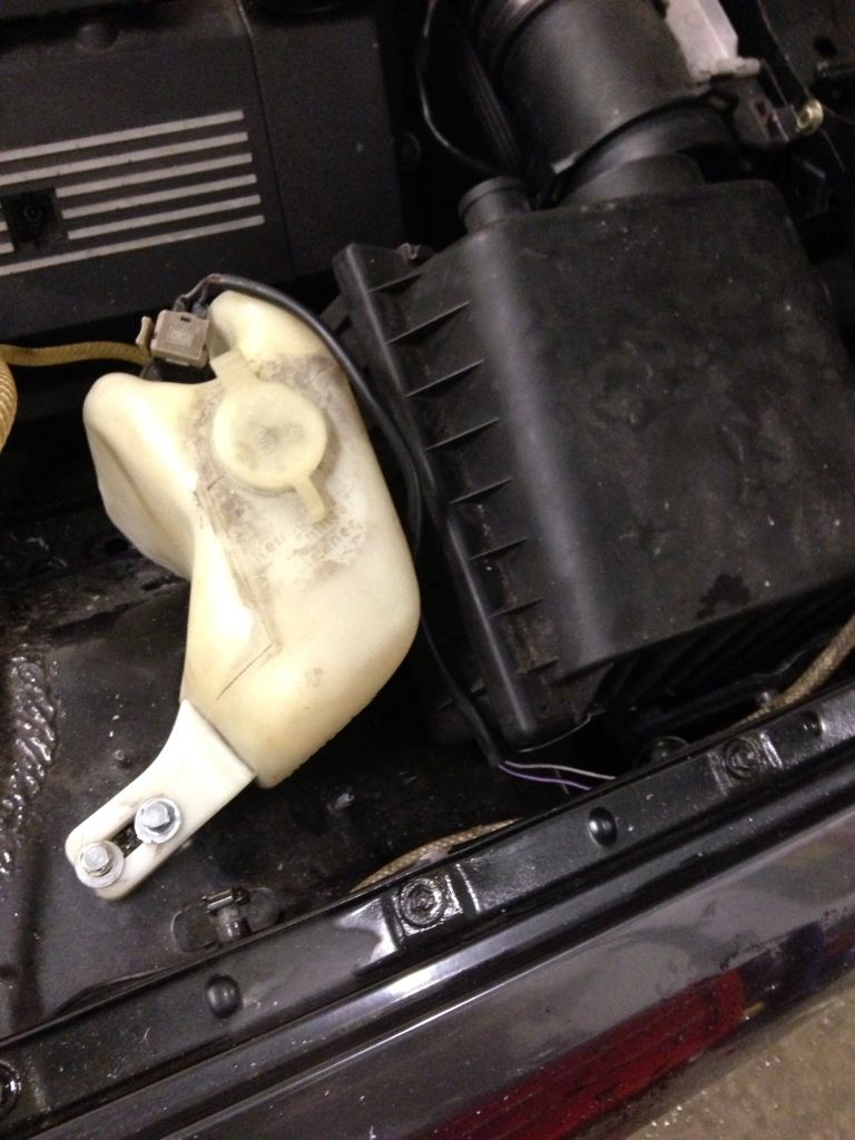

It needed a washer bottle so I took the std one and chopped off the headlight washer part, sanded it and fitted that to the inner wing.

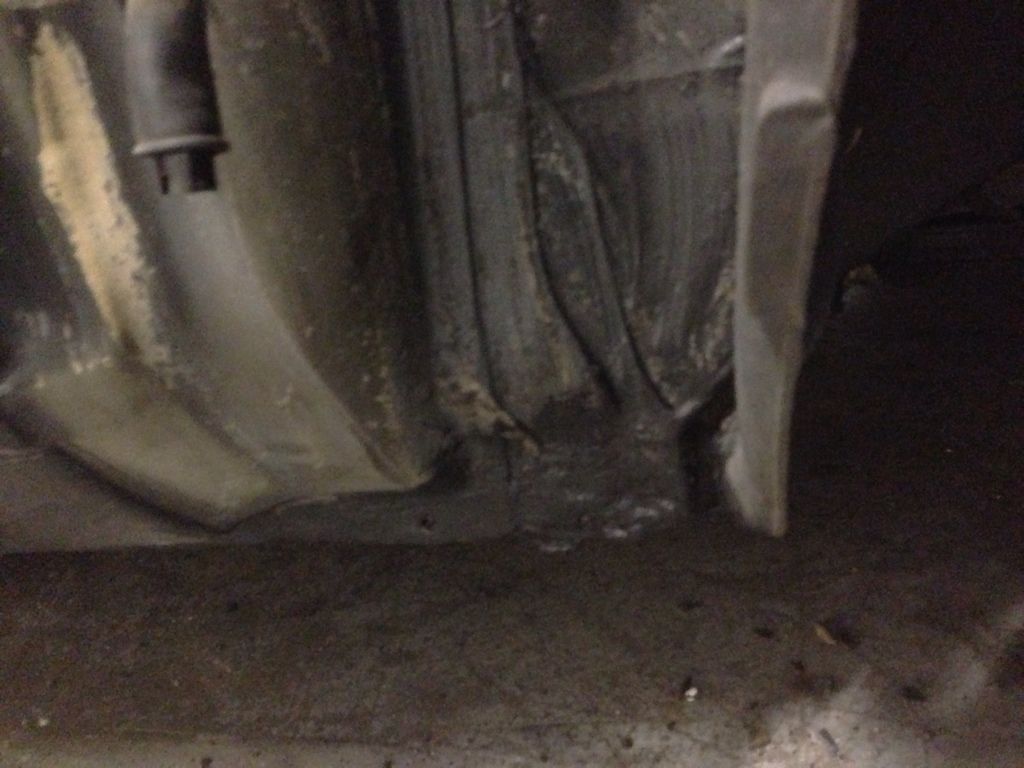

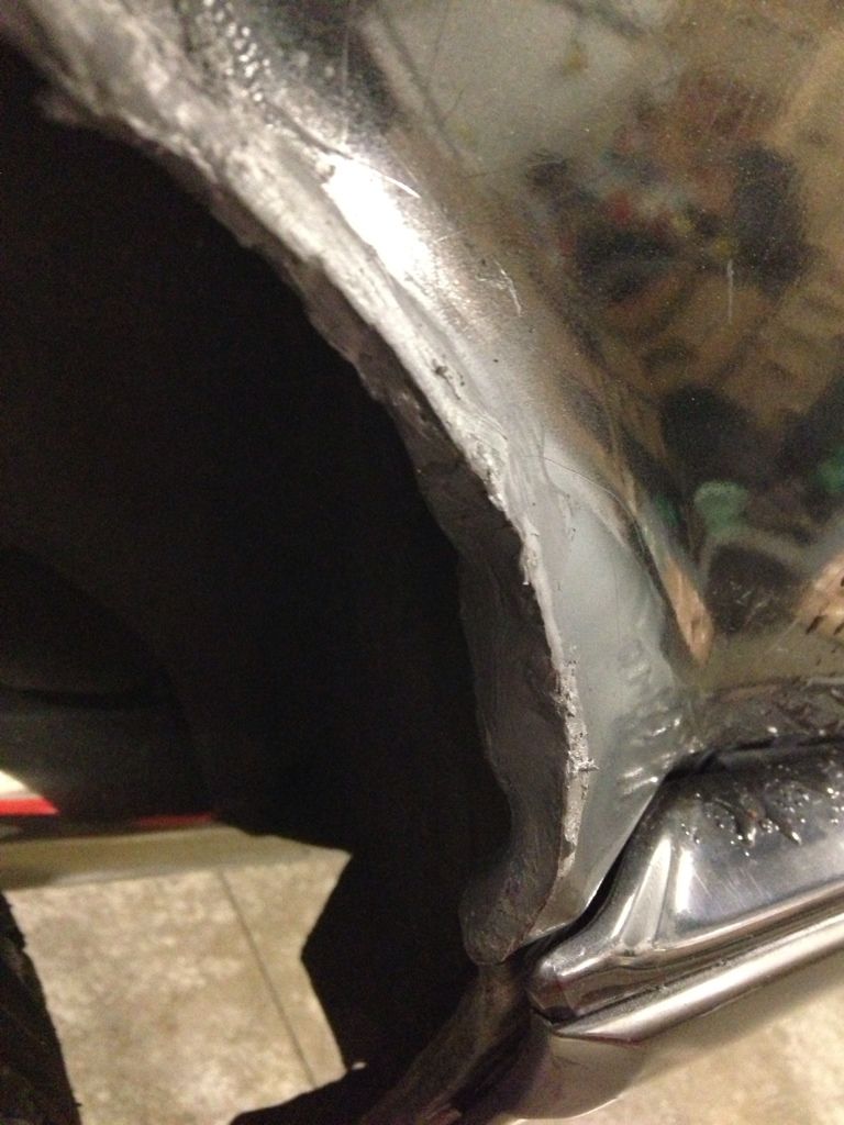

There's also a place in e30 hell for me, all the arches were totally rust free.
Rear of the cut off arches.

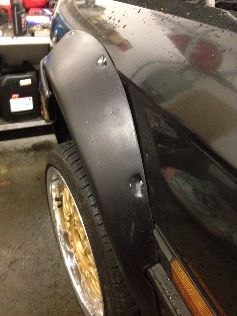

Posts: 228
Mon Jan 07, 2013 1:56 pm

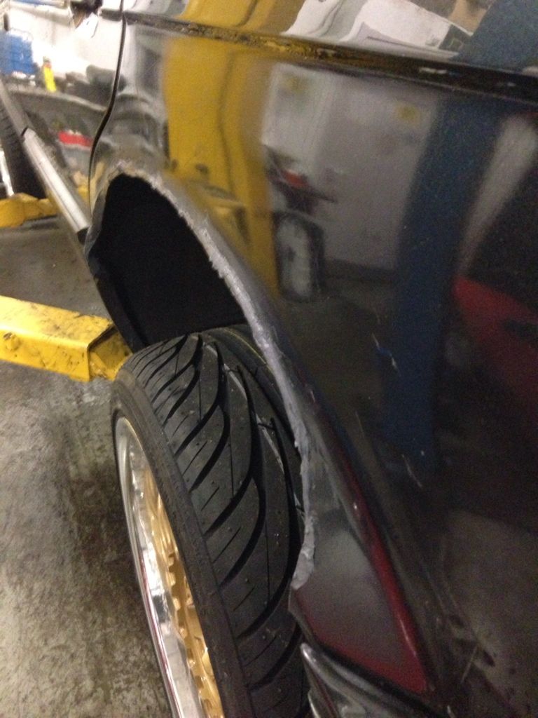

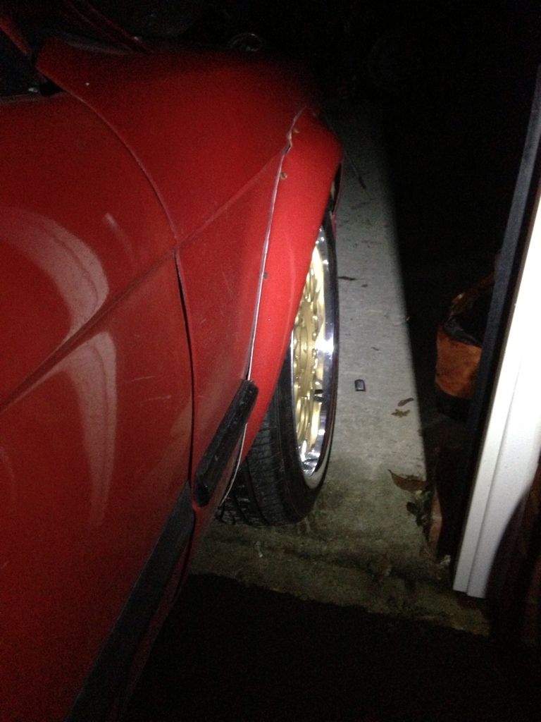

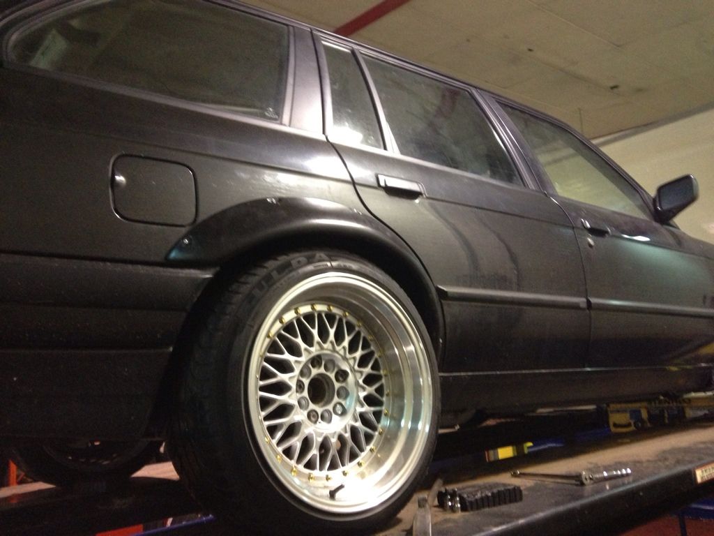

Wheels still rubbed so even more came off. We then rewelded them again and cut the bolt on arches too.
It still sodding rubs, the fact it's on 10's with 20mm adapters and 235 tyres won't help.

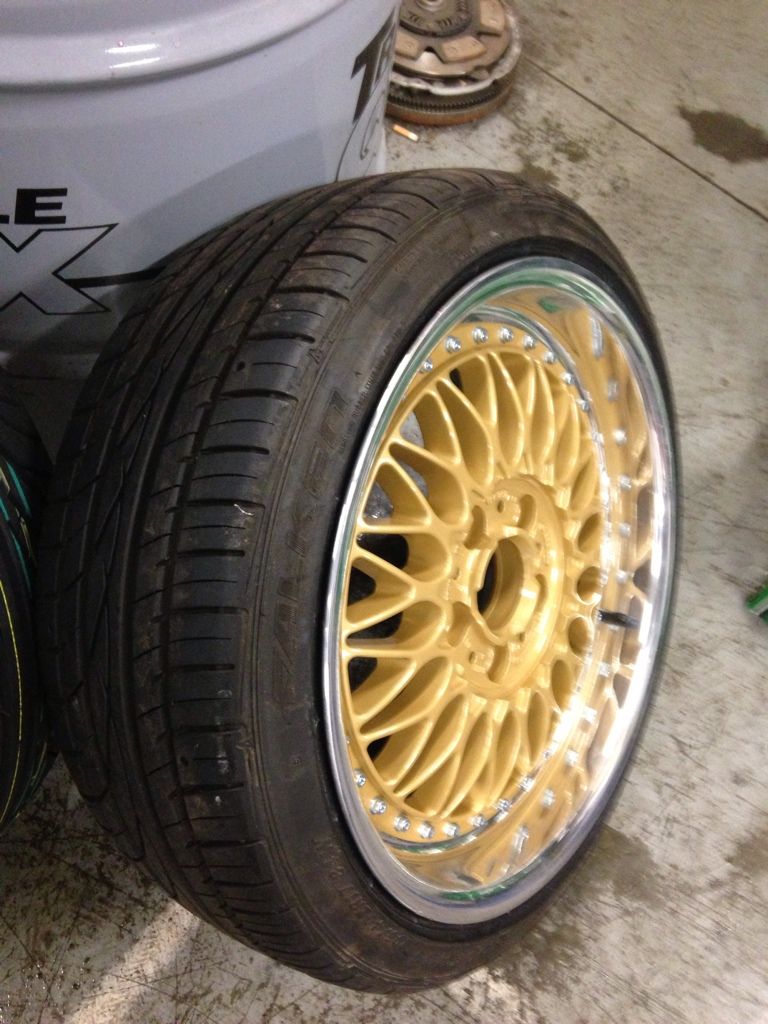

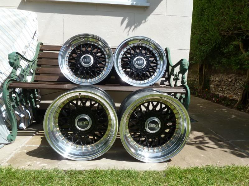

The style 5's didn't fill the arches even with 45 mm spacers so they came off.
Wheels off mine and as my mate is away for Christmas I stole his wheels to try on mine.
So the style 5 are now sat on his in his garage.

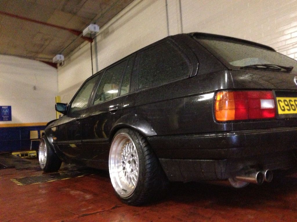

More stuff done to it.

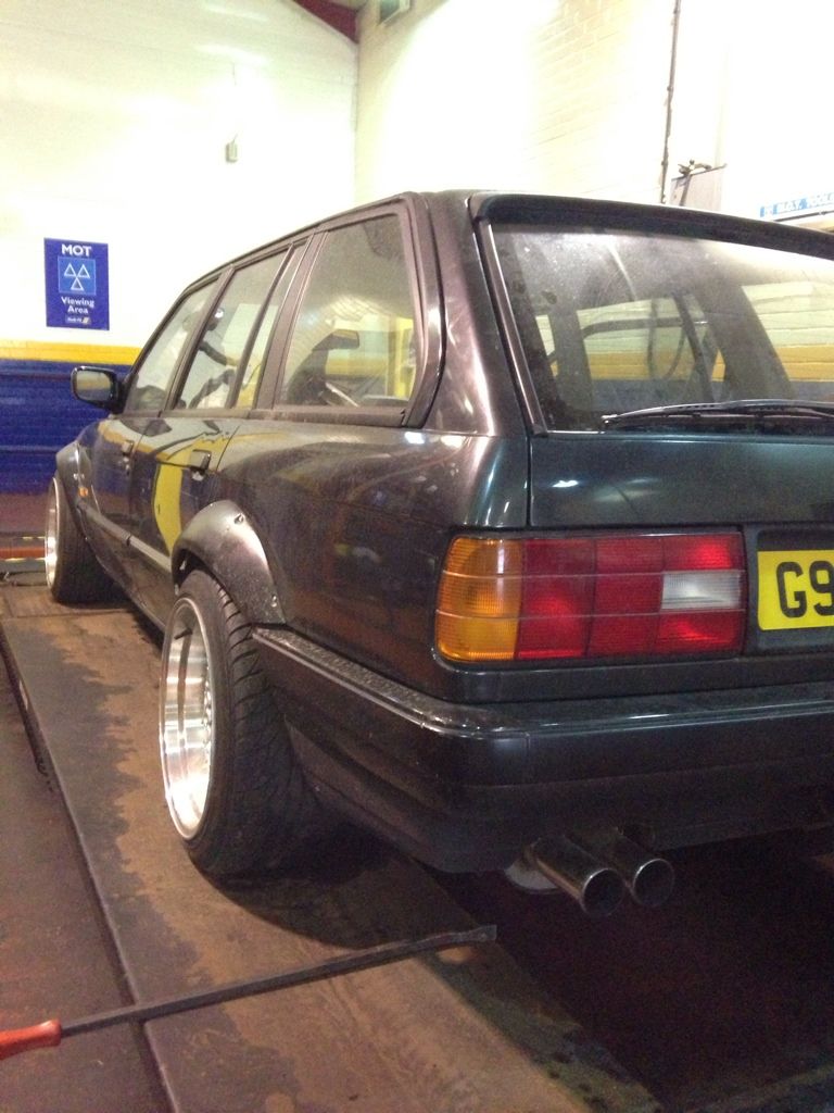

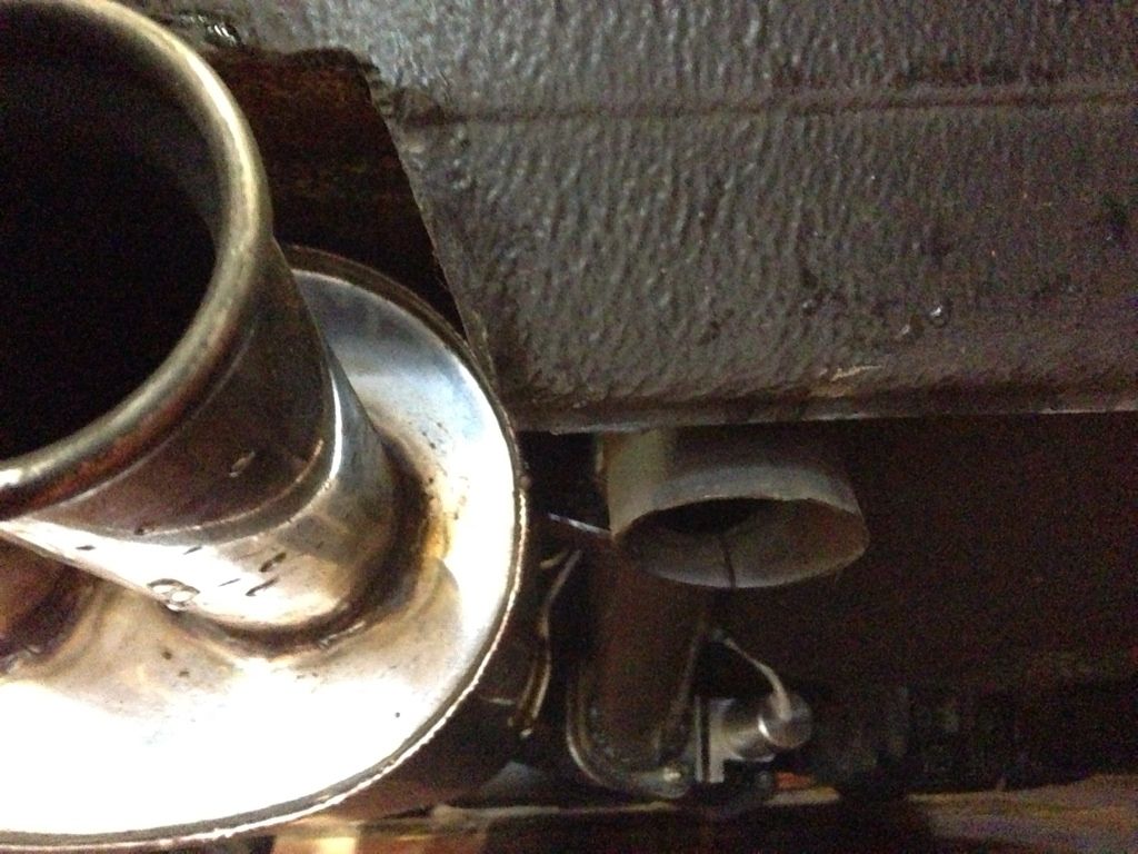

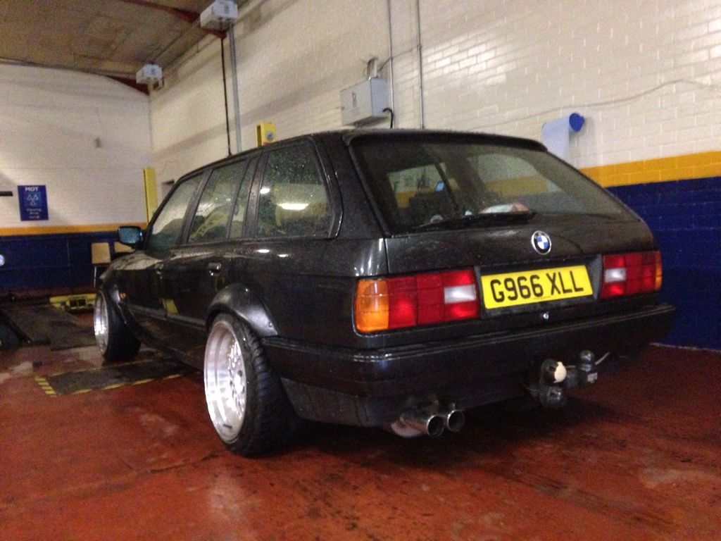

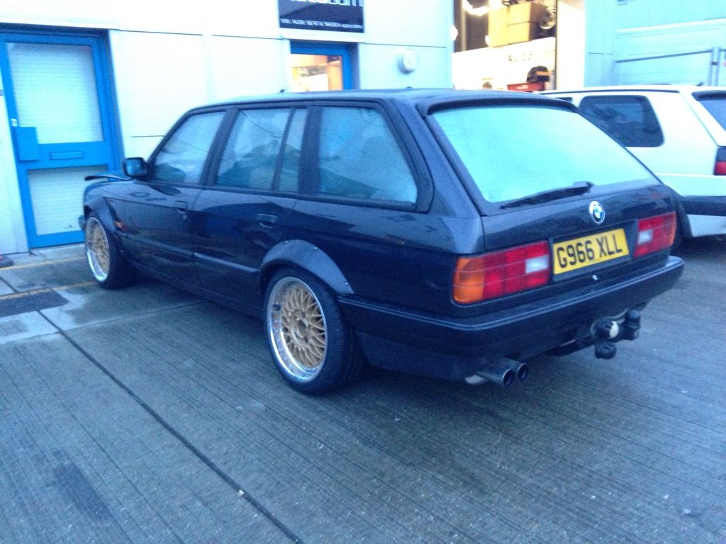

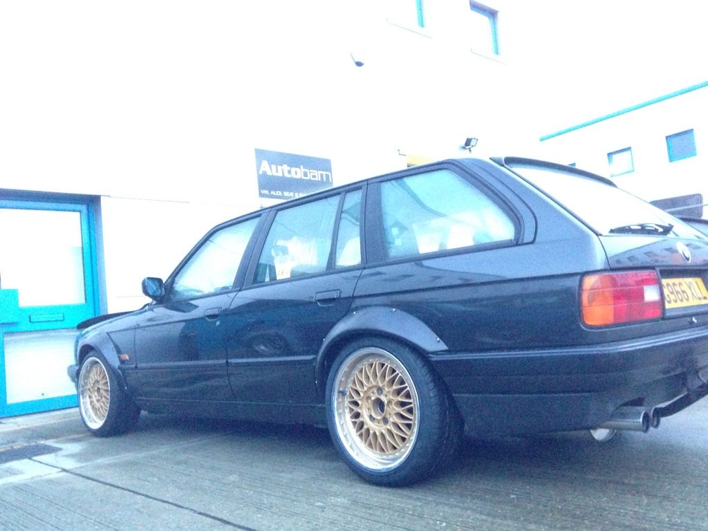

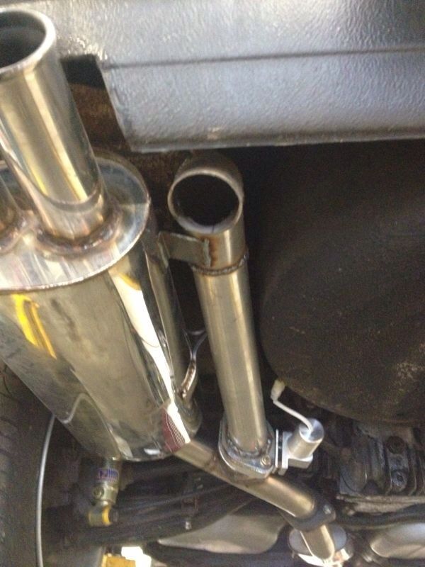

Vabric wireless exhaust valve fitted, awesome bit of kit. I went for a hidden tail pipe.
Off to the mot station.
My wheels didn't fit right so I borrowed my mates wheels. A squeeze even under the massive arches, but they are on.
The loud valve!
Hidden

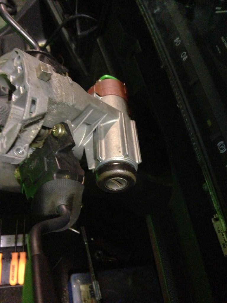

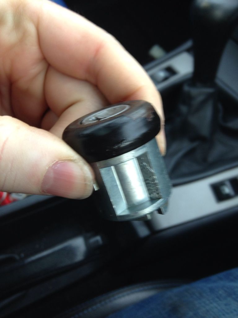

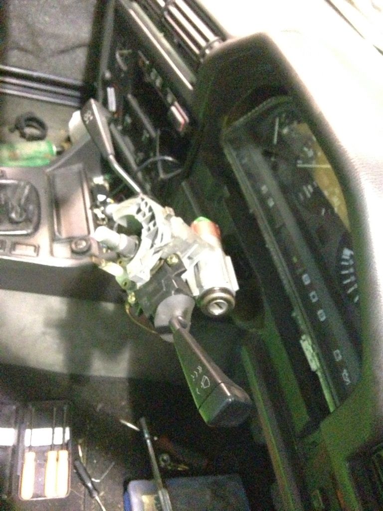

A few more bits, new barrel and wiper stalk is now fitted.
While I was at it I dropped the whole steering column lower as it sits high as standard.
All fixed

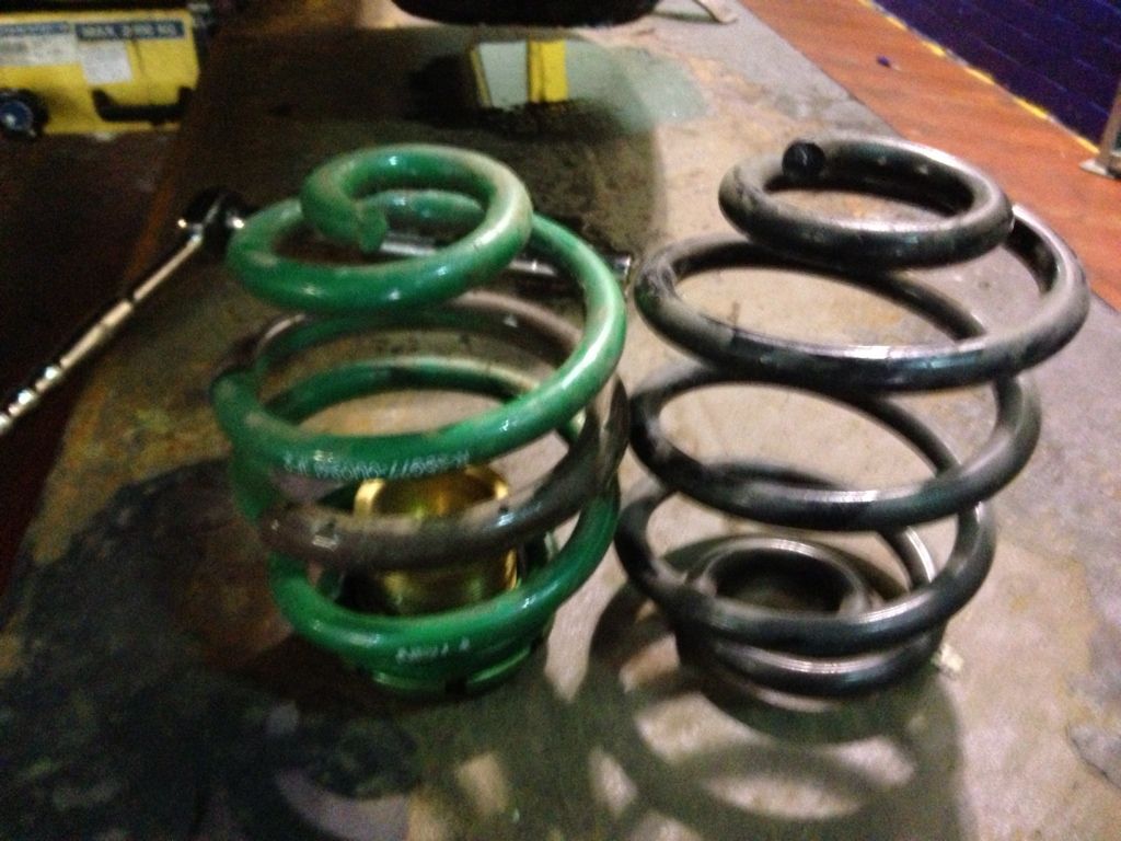

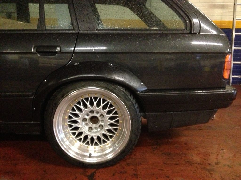

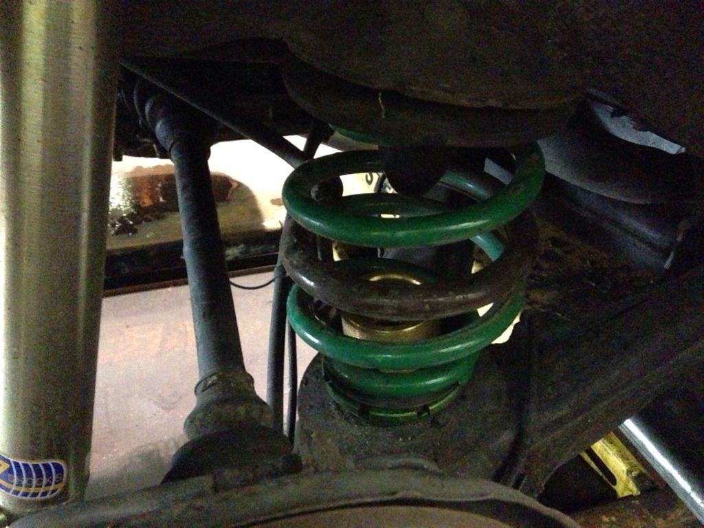

The back tyres were rubbing really really bad and I didn't want to wreck my arches. So until I get thinner tyres I've had to raise it.
I used my e36 Tein springs with the adjusters on. It may look silly, but is only a temporary.
Sky high now :(

s1oww
Posts: 228
Mon Jan 07, 2013 2:00 pm

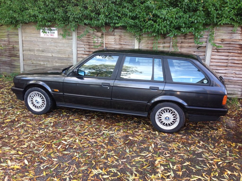

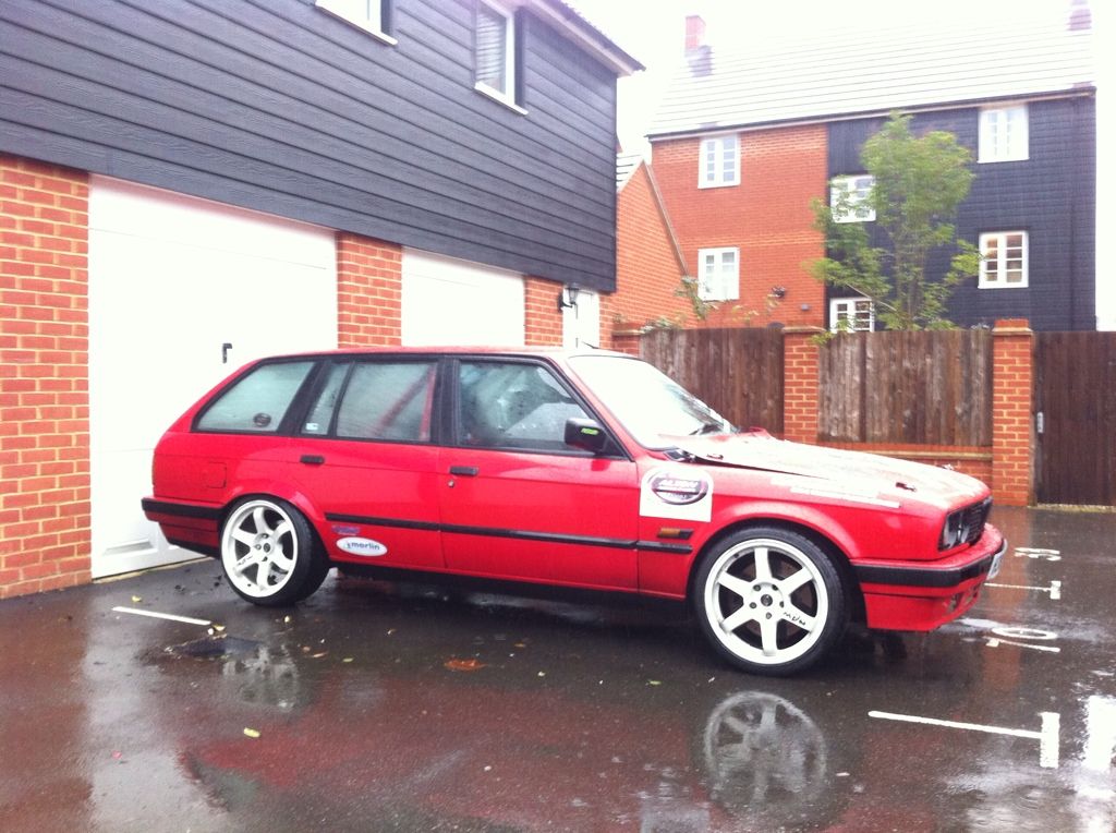

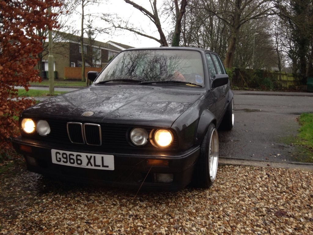

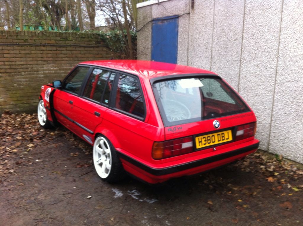

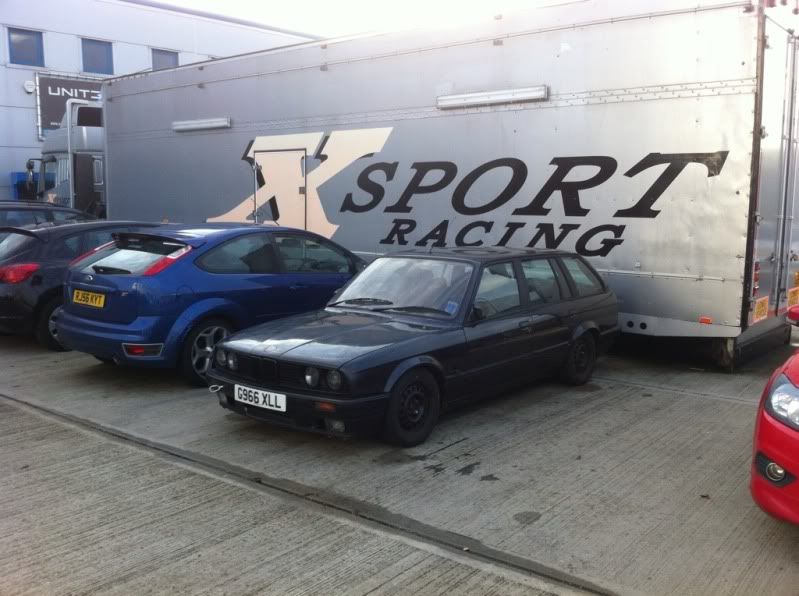

Mot'd and first drive home. Has about a million little issues I need to sort, but it made the journey.
It still needs to go back to being low.
