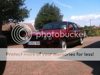

e30 2dr 1 off oil cooler grill fitted 8-)

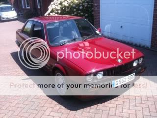

Coops90 wrote:Nice car.
Sure it isn't Burgundrot though? Doesn't look like calypso to me?

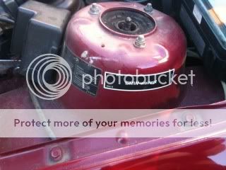

I'm not sure of the colour tbh, I was told it is calypso, where is the paint code and what code am I looking for....
The colour and code should be on the passenger side suspension turret in the engine bay.
I could be wrong but calypso seems brighter to me. Both nice colours anyway.

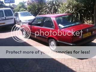

Laurence wrote:Some pictures from the autotest i did on saturday, was having problems with snap understeer which i have pinned on worn balljoints and having an open diff, all of which will be changed shortly :)
The LSD could actually make it understeer more..

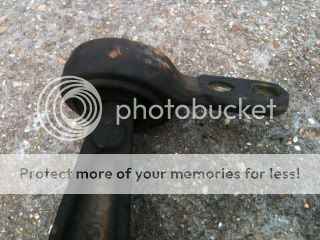

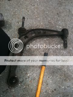

Well I've replaced both wishbones and bushes on the front, had to get hold of a few parts that were broken. Next on the list is some droplinks as they look worn, any reccomendations on what droplinks are the best to get? Bmw ones or are ebay items just as good?
RE: the colour, I will look at the colour in the bay today, take a picture and stick it up :)

Some boring pictures of replacement of the front arms lol:

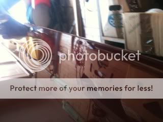

Gave her a bit of a clean yesterday. Will take some more pictures later :)
And the colour...

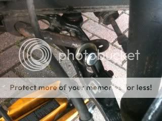

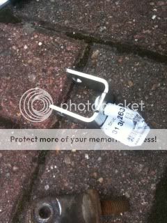

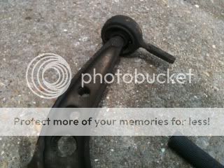

Right, well i have started replacing the drop links on the fron tof the car.
Did one, was a pain in the arse :-/ Had to cut it off and grind it back as the bush was just spinning so couldn't get a grip on it. I refitted the new one but it seems like its at a funny angle... took some pictures to show you guys, is that the right hole on the arb ive put it on?
A quick response would be great as im planning on tackling the other side today

In the above droplink pictures. If I put the droplink on the further mounting hole that should soften it shouldn't it? And I think I will be investing in some stiffer springs soon :) what do all the track boys run on the front around 155lb?
Tue Jul 26, 2011 10:56 am
Erm...
Try 350lb minimum as a starting point. I was running 510lb on something I still drove on the road.
B6?/B8? (the beefier ones) Billies will run out of damping around 400lb.
Lengthen the lever arm to soften, shorted to stiffen.

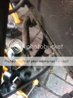

Knocked up a new oil cooler grill at work as mine was missing. What do you guys think?
Just need to etch prime it then paint it satin black.

Can't see it properly when fitted, but it's different.
