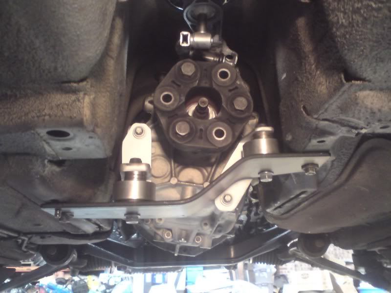

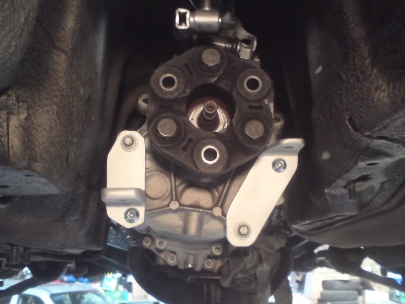

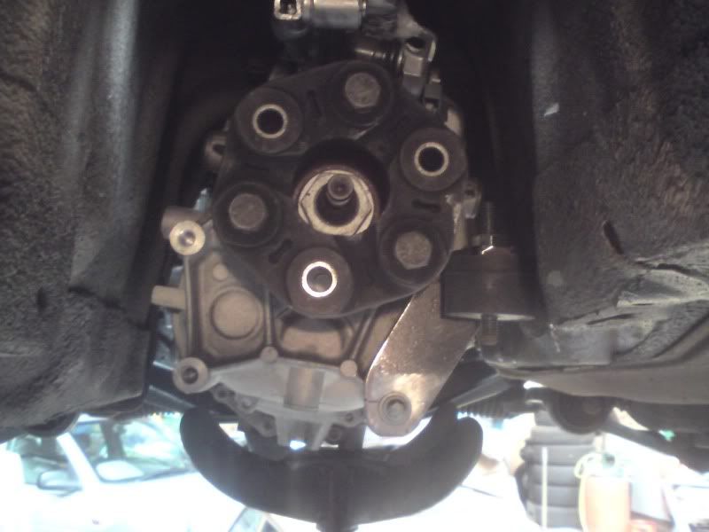

A few pics of the mount I made for the E46 gearbox, this was a bit of a pain as there is just no room, the slots right at the back which are used with an auto box is where I had to mount it. Standard alloy mount is useless here so got busy with some angle iron and the welder
Drivers side first, you can see just how tight it all is
Both painted and bolted up, had to use 2 button head bolts as the rubber mounts need to be so close to the box they would collide with standard bolts
All bolted up with the suppoting brace, this was made from steel plate bent to the shape of the trans tunnel
The E21 rubber mounts were spaced for final fit and reinforced with some alloy cups which restrict the movement (much needed)
If you hadnt noticed the E46 box sits at a different angle, this is the same angle as an M20 box would be when bolted to an M50, approx 10 degrees out, this added to the gear selector hell I had to go through and would rather not mention it as im still having nightmares :cry:

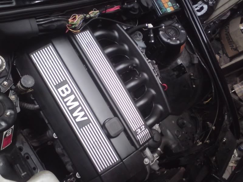

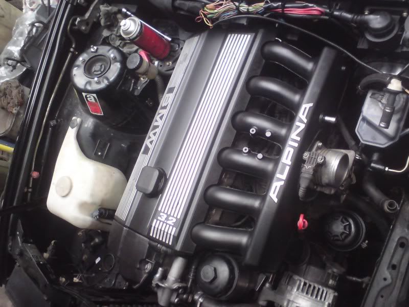

Heres a couple of engine pics for Dezzy :)

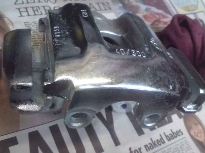

Picked these up yesterday, what do we think?
They turned out much brighter than I expected, im considering having them shot blasted and zinc plated again to give a more textured finish :?

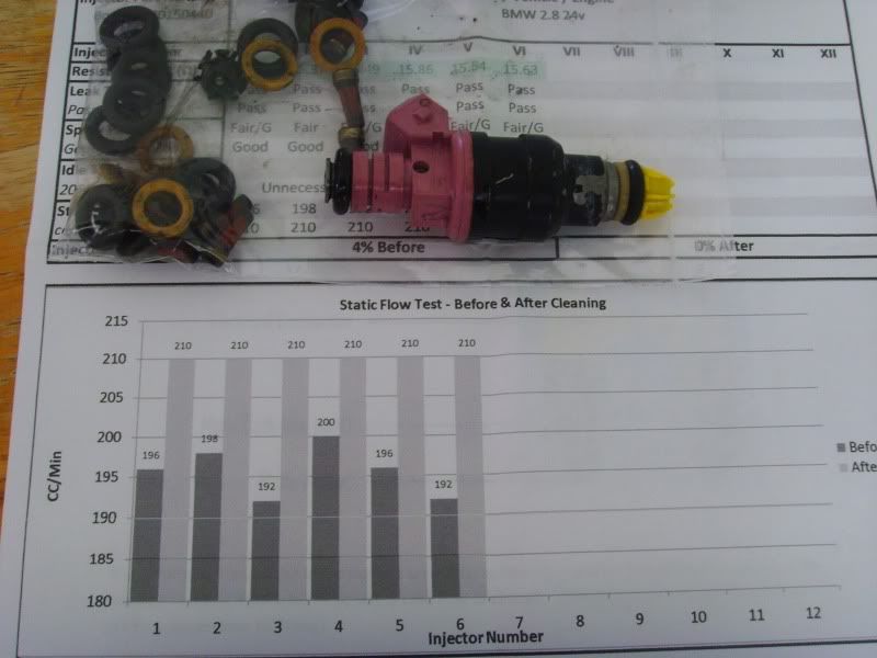

Just got these back from James @ Injectortune
Well impressed with the work, top job James! :thumb:
Also shocked at how crap they were considering they came out of an engine with under 50k miles! The engine had been in storage for a long time and the injectors were actually stuck shut which was the main reason for me sending them off for servicing

town325i
Posts: 7050
Sat Jun 12, 2010 11:24 am
Bloody hell those injectors where all over the shop
