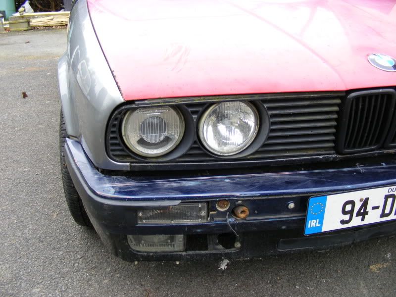

Here she is as I got her home
Bit of a mix and match of colours but it's all there
And then the bit that needed attention:

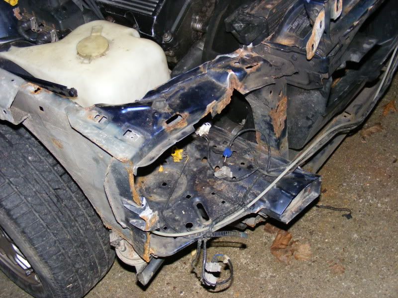

So, started to strip the grill, lights, bumper and lower valance today and ended up with this:
Looking from the drivers door forward:
Front again:
Some bent panels but not a lot else wrong with her. Plan was to cut out and replace the whole panel with some help of my brother (welder) and some encouragement and criticizing from dad :mad:
Initially I wanted to replace the whole panel but they deemed it to much work and half a panel would work out the same if done right. And so work began, stripped the whole front end and got cutting
Panel was cut along with the majority of rust it had. Part of the inner wing was also cut of, it was a little bent.
Replacement panel mocked up, think it needed a bit of trimming for a better fit but we were getting there.

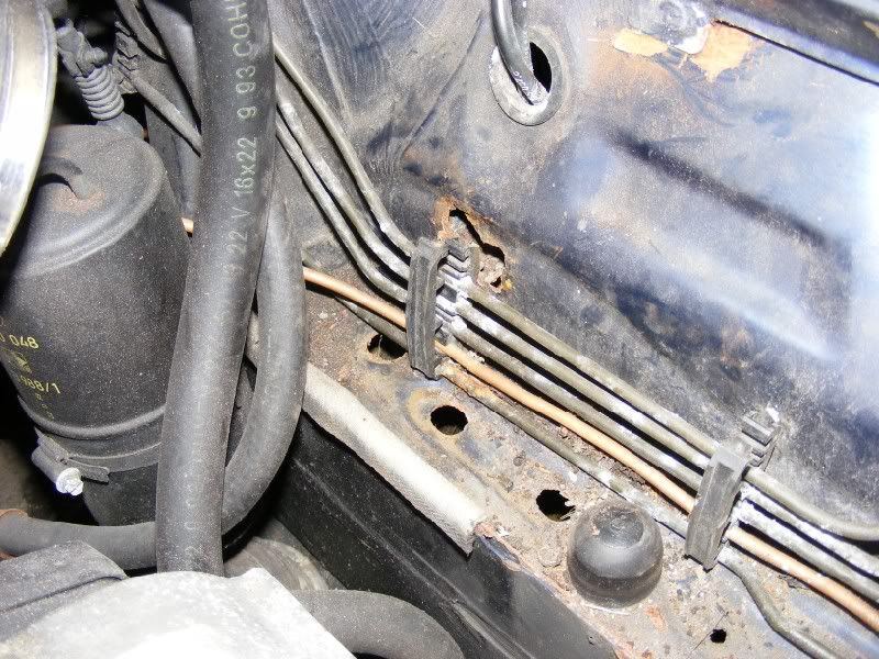

Bit of rust treatment while I was at it

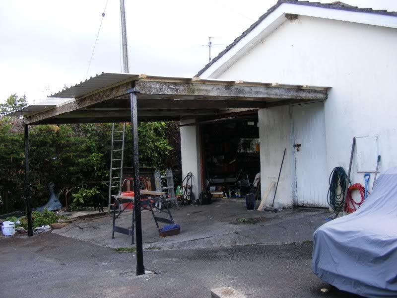

Car got moved under the lean to and started to get tones more done with the car.

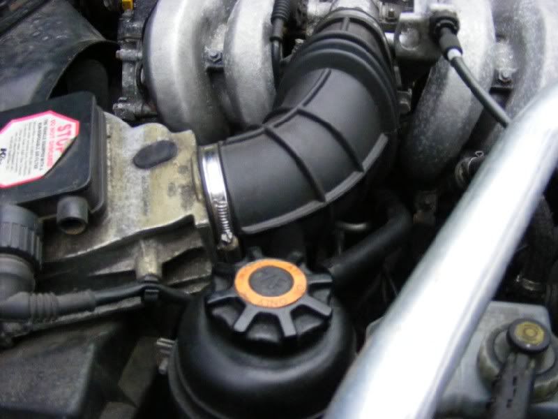

Had some engine problems, she was nearly cutting out and then revving quite high. Looking under the bonnet found 2 cracks one in the elbow the other in the hose connecting to it:
Put some clips on them and she's running more like normal (had to use tape as astop gap before getting clips :p) There's still a very little amount of hunting at idle which I'm hoping is a result from them cracked hoses.

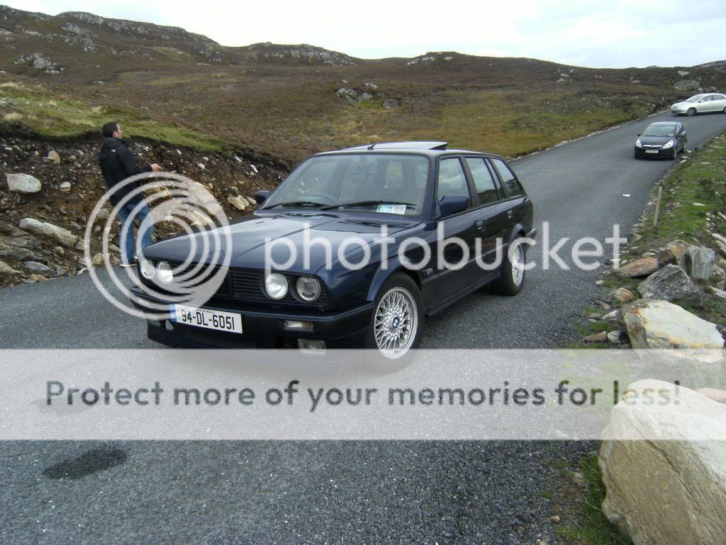

Thats about where she's at now. We (E30owners.com) had a meet last weekend, 16 cars, and she went quite well.

There's a bad spot of rust at the filler lid that needs lots of attention
Some surface rust on the bottom edge of the doors

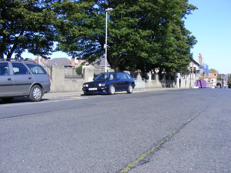

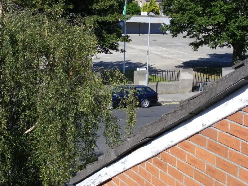

Few pics from a few days ago when it was nice and sunny

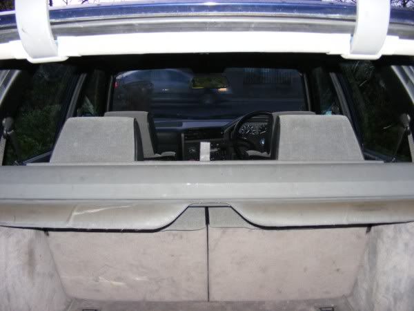

Just got the rear head rests fitted, only took about an hr to take the seat backs of, cut the holes, fit washers and fit them back in.
Not to hard to do, did feckup 1 hole a little so the washer isn't exactly where it should be but not to noticeable the other fits perfect. Took a few pics as I went along if there's interest I can do a little tutorial?

I was gonna do a tutorial but I found this by accident a few days ago: http://www.e30zone.net/e30zonewiki/inde ... _Headrests
Only thing I did differently was that I stuck a thick marker in the head rest hole and then cut the material pushed up by the marker of to get a nice round hole thats the right size for the washers. One of them didnt quite work out perfectly as it's a little to far forward but not to noticeable. Maybe mark the holes first and then use the marker method to cut nice holes?
