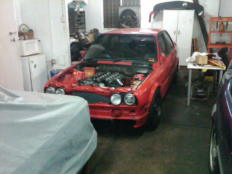

Well the engine hasn't lasted too long and the result is this..
July 28th the engine died.
Back onto jack stands...
once the head was lifted off this was the poor sight that was to be seen.
The block... the sleeve has been pulled down (through the seat and oil squirters and onto the crank
And the piston.....
so a new engine was purchased..
This time a M52b28
August 18th
A customer of the place im doing the work at was having a S50B30 conversion done and had not received a lot of the crucial parts one being the entire EWS set up.
His engine was also down on compression on cylinders 3 and 6. So after a couple of beers the decision was made to swap engines.
So on the 21st i removed the S50 out of the customers E30 and put it on a engine stand and bolted the supercharger up to it..
I then started pulling the S50 down and installed the M52b28 into the customers car
S50 pulled down
Found this damage to the bore on cylinder 3
the spacers that go in between the throttle bodies and the head

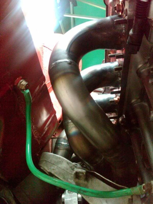

And now i also have the headers that Matt at the workshop modified for the customer. Im not 100% sure what i going to do with these yet.
Yesterday i took the block up to the machinist to check what size pistons to order. He will be bore the block, be checking the eccentricity of the crank mounting, shave the block mounting surface, finish the cranks conrod mounting surface's and the cranks mounting surfaces. The head is also going to be reconditioned.
I will be ordering the internal parts as soon as he lets me know what size pistons to order.

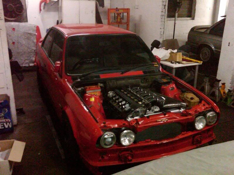

Tue Dec 16, 2008 12:26 pm
Just a small update. been busy with work
got my engine back a fair while ago. cleaned it all up, sanded the outside and painted it.
installed the crank, pistons and rods..
mmmmm coated bearings for the rods and mains
block finished
Just waiting on 3 boxs with all brand new genuine parts to complete the base build of the engine. then i can assemble the rest of the engine over Christmas

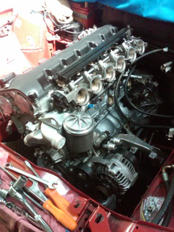

So with all my boxs of parts it all down to building the rest of the damn thing.
Here is the new oil pump that has to be converted to 5 series pick up. (s50 is the longer arm)
new crank nose swapped over and all new timing chain and oil pump chain guides and the oil pump installed
Found out the old oil pressure relief valve was full of silicon so would have not worked.. so installed the new one
timing case goes on
pistons 1 & 6 are moved to top dead center ready for head install. I am using a VAC motorsport multi layered steel gasket

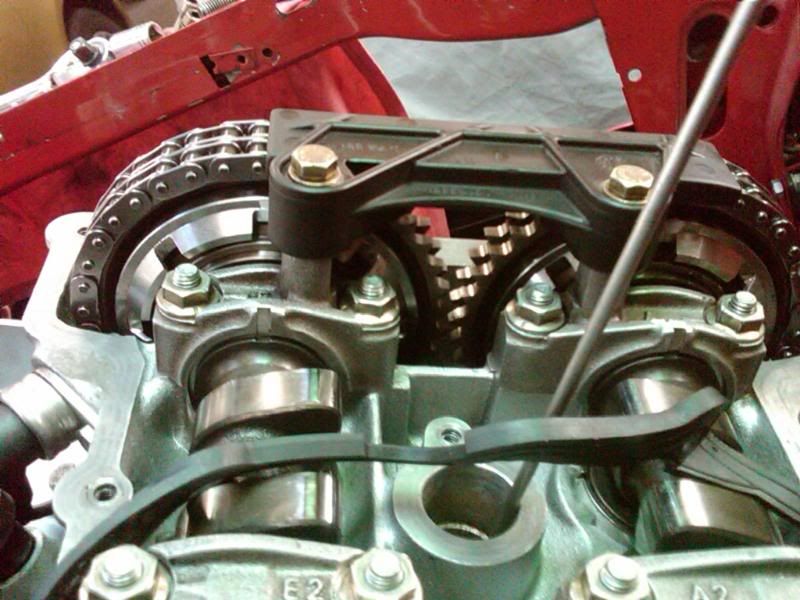

exhaust cam put in so that the valve clearances can be checked which seem to be a fair way out. Then shims will need to be swapped or new ones bought
Does anyone know the specs for a S50B30 valve clearance?
boybimmerm3
Posts: 391
Location: Berkshire
Sat Jan 10, 2009 9:11 pm
Inlet and exhaust clearances are the same for the s50 b30 which are 0.28-0.33mm. ( cold ).

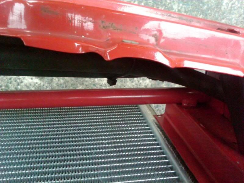

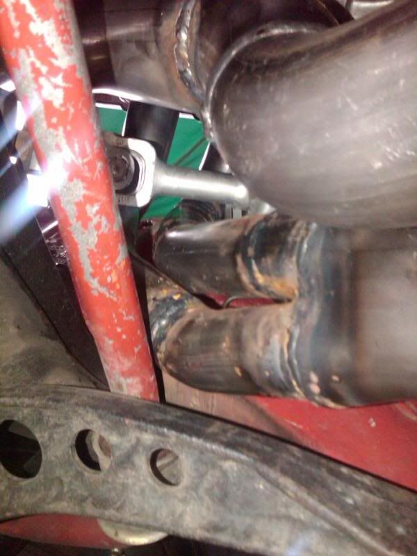

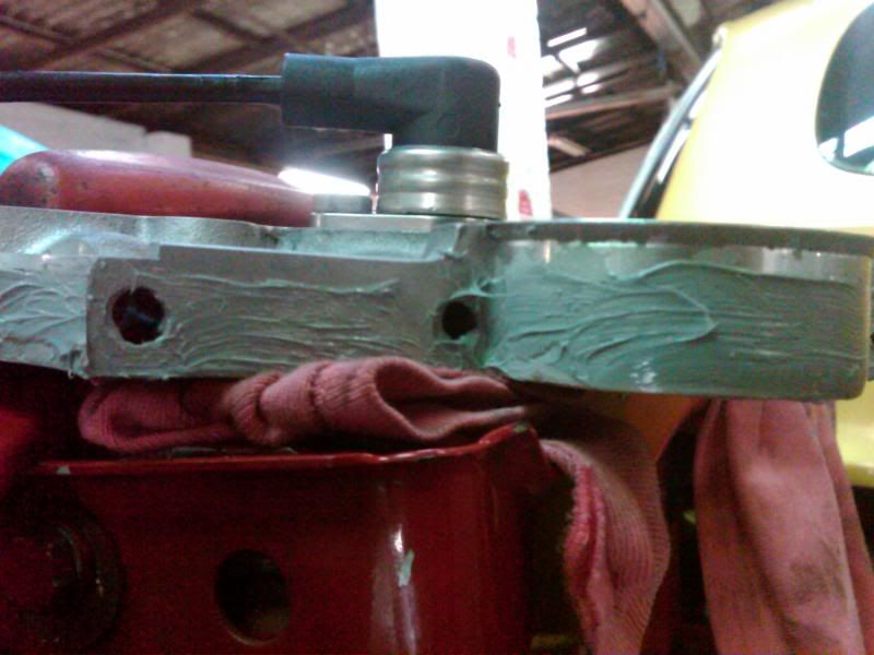

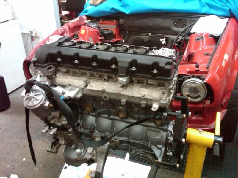

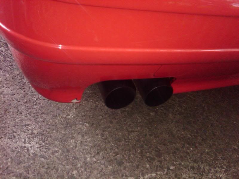

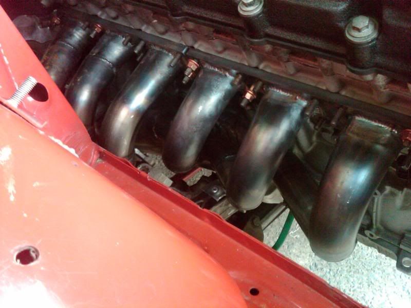

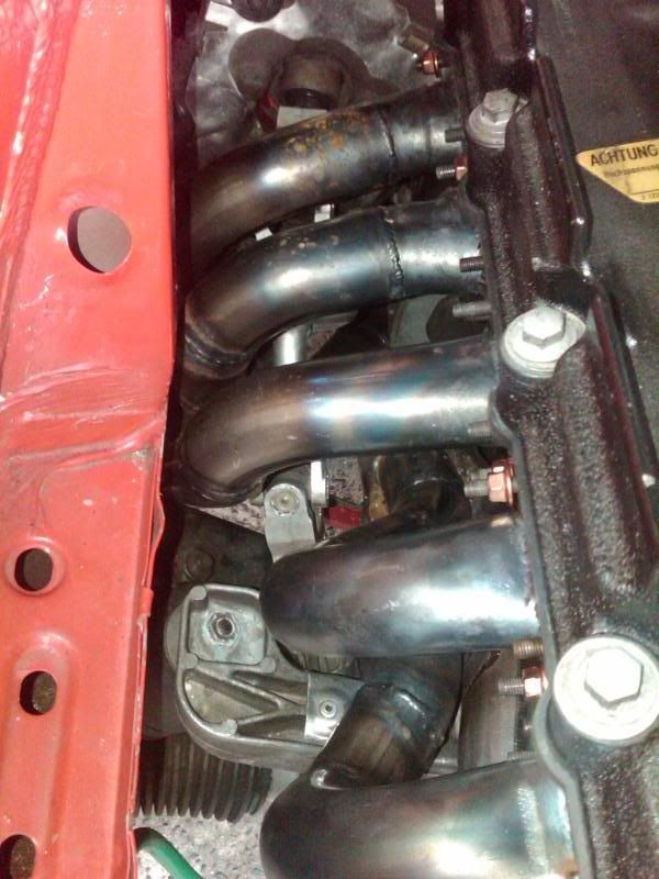

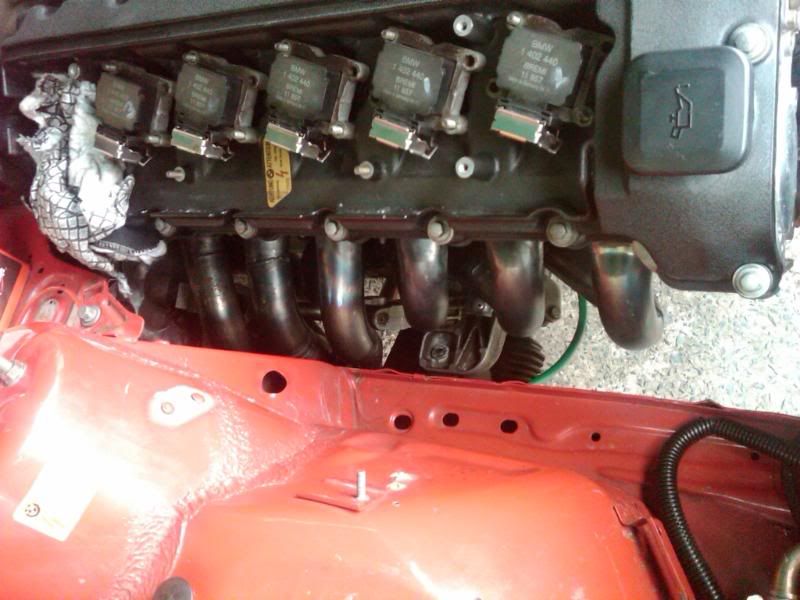

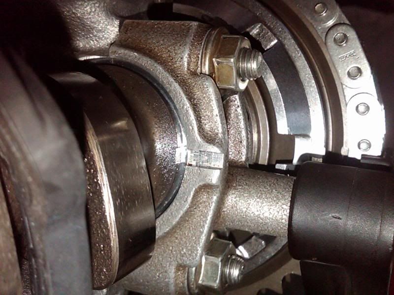

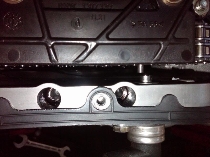

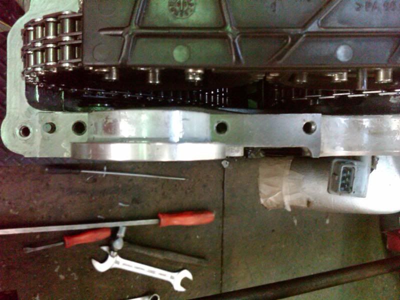

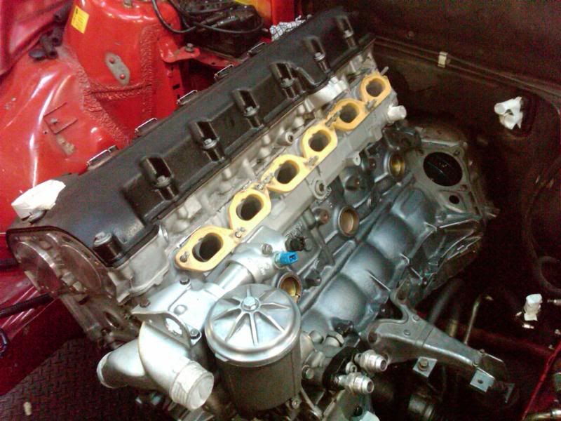

So after spending some time away from the project i decided to go back to NA and had to rebuild the engine again with forged CP stock compression pistons. I have run out of time and motivation to turbo or supercharge this car. Plus we are running out of tracks to go on in this part of australia and the prices are only going up.
had to put in a locating dowel for the magnet to pick up the cam angle
underside of the plugs
there are also plugs for the rear cam sensor pick up holes
reinforcement bar for the front

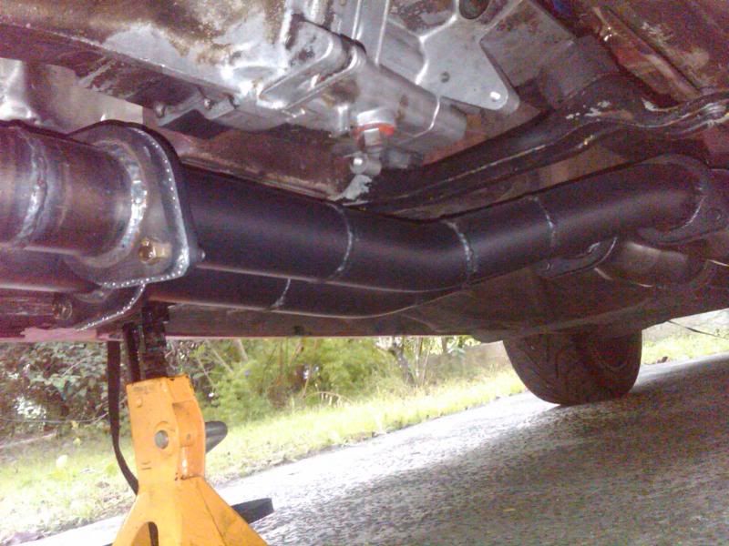

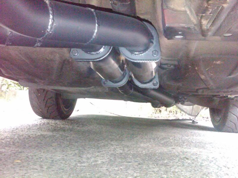

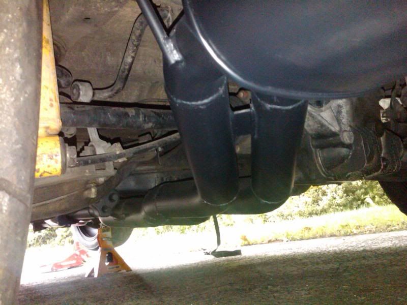

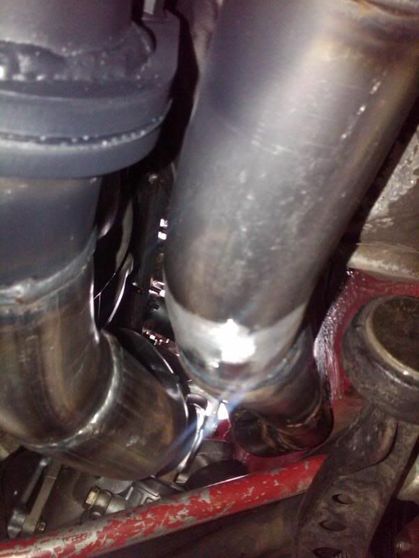

ready to leave to go to the exhaust shop. first time its hit the ground in 2 years...
exhaust work
now back at home to finish off
