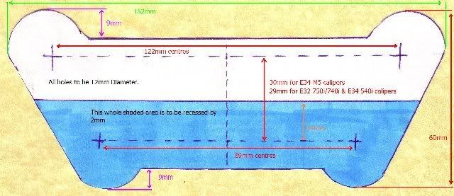

You can either get the brackets made, here's a template: -

Not cheap though.
I'm going to enquire at a local engineering company when I get the chance.

are the brackets for salee on 30mm.de for the m5 brakes or the 750i ones? plus i cant understand a think on that site is there anyway of putting it into english?

what material are you going to get the brackets made out of?

I made mine out of 15mm thick steel, no special grade.

15mm steel? bit of overkill isnt it?

Martinaston wrote:Templ8e30, how have you treated the brackets to stop them rusting ?
I painted them with some stuff from work called Galvafroid, basicly a zinc paint. Works very well on the steel brackets I put outside 7 years ago, still look new.
