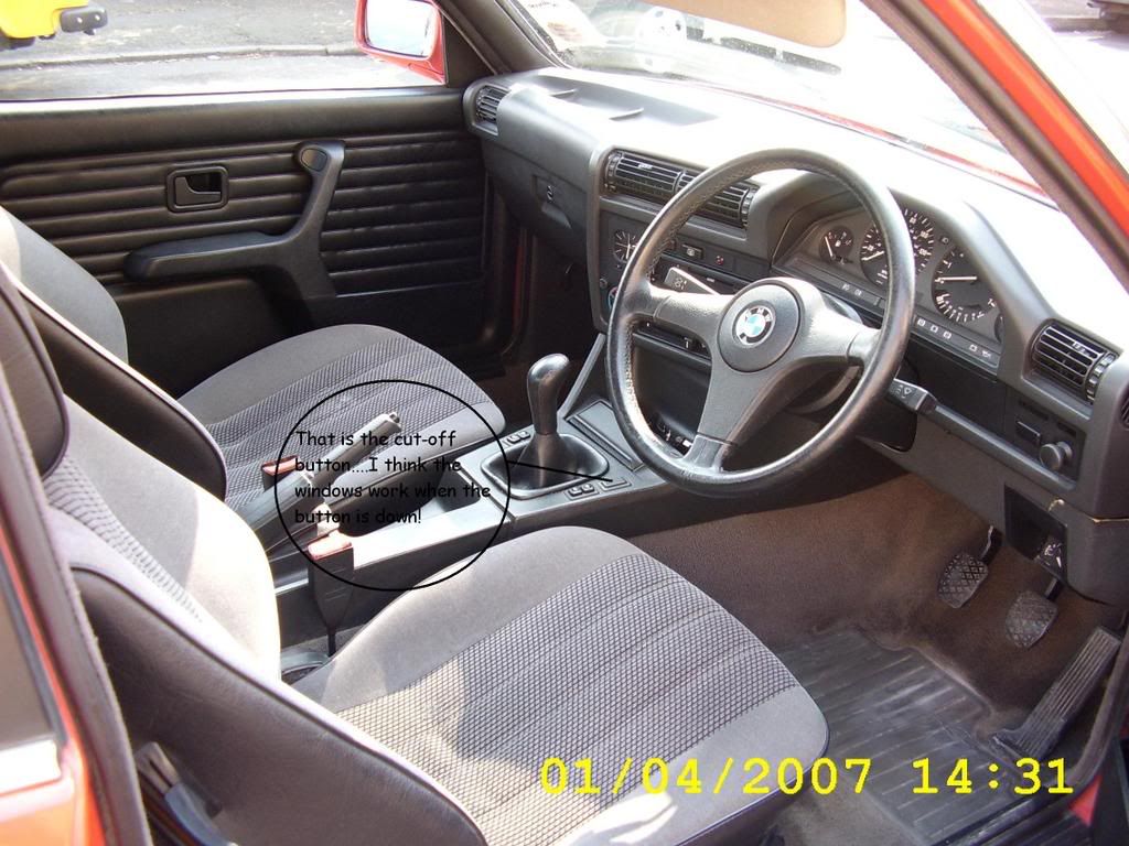

rossle wrote:just took a look and mine is a none pressable dummy, its just a cover for a hole... :cry:
any other ideas its really doing my nut cos i cant open my windows and it baking hot over here!!!!!!!!!!!!
if the lights in the actual window switches are off aswell, then it does sound like you've pressed the cut-off....
see pic....
I thought my switch was a dummy aswell because it was so stiff....i have to press mine really hard for it to pop-out, and disable the windows!
If you have the same button as in the pic, then play about with it, as that's probably the problem!
